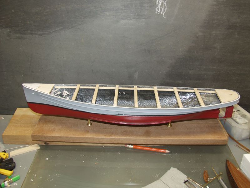

Been visiting this site for awhile now and now have enough material on my build I can start posting something. This is the first time I have used styrene as a building medium.
I served on the Takelma from 72-75 home ported in Pearl Harbor. I started this project with a prebuilt fiberglass hull and basic deck house. Knowing what I now know I would have built my own. Since I had already bought them I am using them.
First steps were cutting off the molded bulwarks as they were to thick for scale and adding bilge keels and building the rudder.
Made some mounts with a temporary build board. Used some .060 styrene for the main deck.

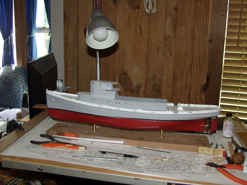

Here's a picture of the Takelma to show what a ATF looks like and what I am building.
She was 205 ft long beam of 39ft draft of 17ft complement of 6 officers and 70 enlisted.
Here are a few more photo's of my build.
Also some of the smaller parts
