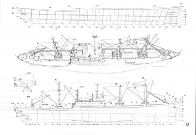

It will be built 1 meter long, 1/160. It is my first scratch project but I have done long study and have great patience as well. As a prototype I will use a 1/200 paper model of the ship. First I will scale up the parts then paste them on wood panels.

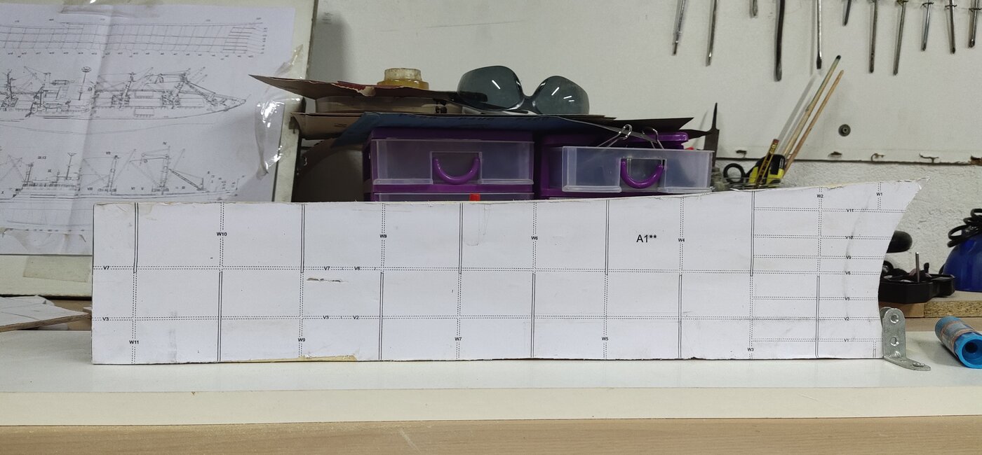

So progress has began a few weeks ago. I m lucky i have free time every day and also weekends.
Since its my first scratch built i only used basic electric tools, specifically a dremel type tool with multiple accessories. Others are hand tools.
I first printed the plans enlarged by 31%. Normally 28% would be ok but i noticed while printing in 1:1 scale total model length was almost 3 cm shorter than advertised. So i had to recalculate.

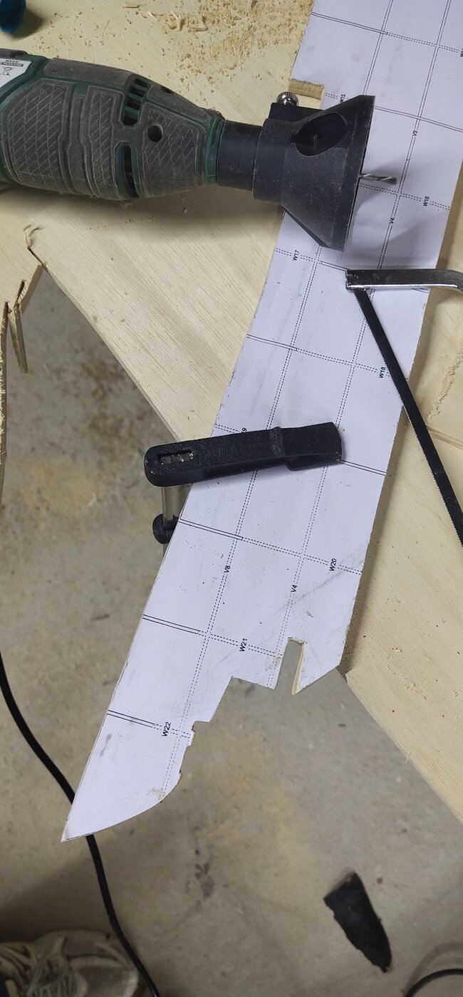

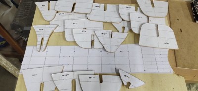

Then i cut them and stick them on 4mm MDF which had in hand. Then i cut all, using my multitool and sand them. Lots of sand. It took me more than a week of daily evening work.
Main frame came in 2 pieces. Used a 8mm plywood.

First difficulty from trasfering the paper model to wood: The frame slots for the bulkheads to be fitted in were only 1 mm wide. Since these are 4mm thick i had to redraw them to 3mm (i saved 1mm in case i make any mistake while cutting). I marked them with orange modelling tape. Same for bulkheads: Instead of 1mm wide they were cut to 8mm.
Ofcourse cuting them with the rotary tool for first time wasnt easy. Mismatches occured, some minor, few greater ones. So fitting the bulkheads to frame vertically was not the only problem. I had to measure the distance from the edges to the frame as well, for each bulkhead to make sure they were installed evenly.

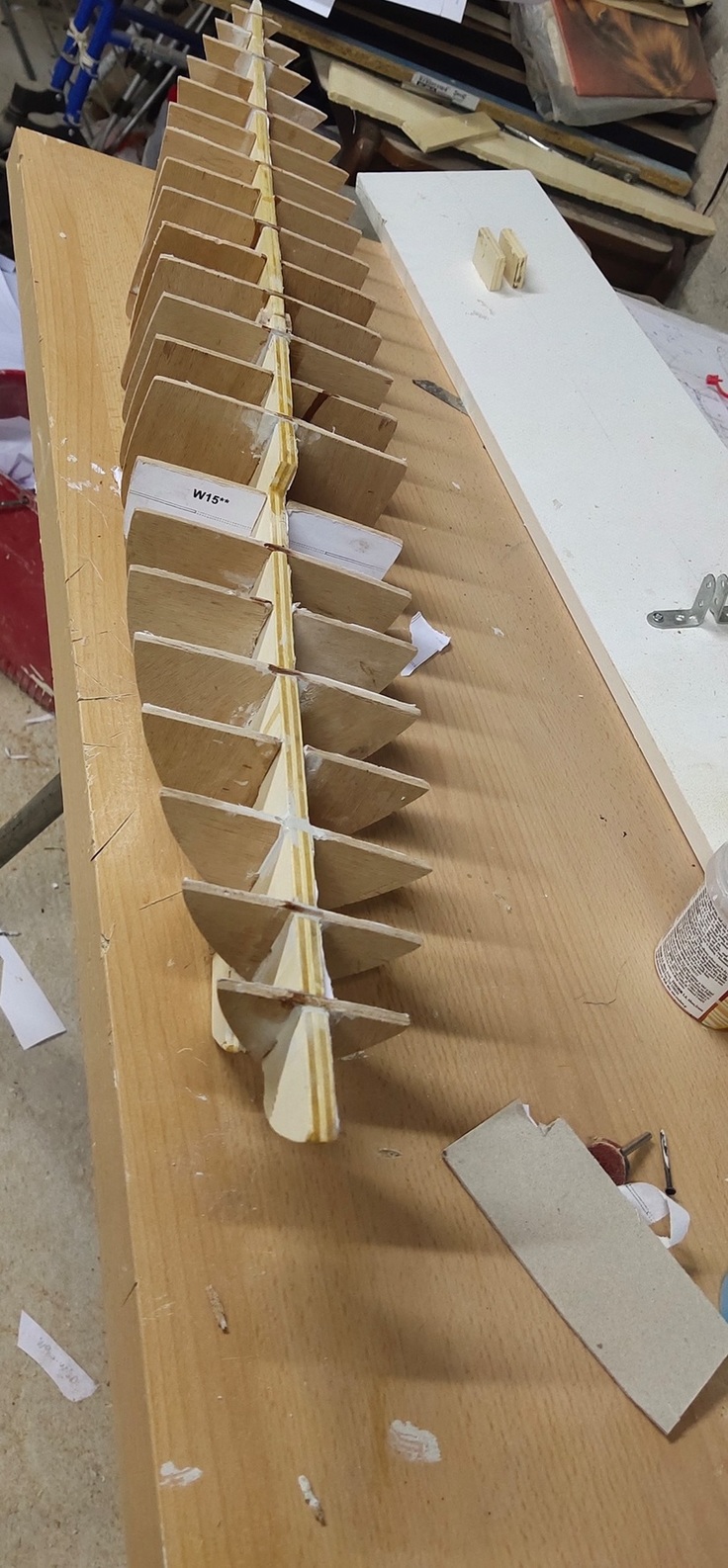

Posts: 229
I have finished fitting the bulkheads on frame. I did some trimming and used filler as well in the slots

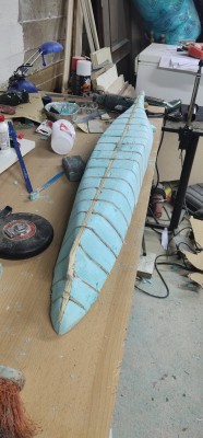

i have almost finished the filling with polysterene. Cause of the 8mm thick central frame, correction must be performed to bow snd stern, both ends should be sharpened, will do it tomorrow if weather not very cold.

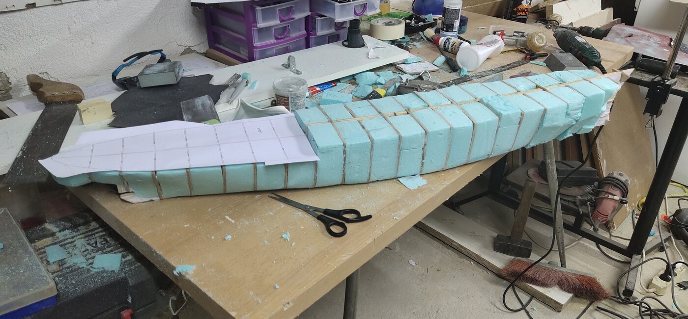

hello again
I finished the styrowork on the hull. I also trimmed the bulkheads to give the right inclination to the deck. I used 3 mm MDF. I painted it with 3 coats of special primer.
I used superfine car filler to certain areas. It it said to be the most superfine, making it apropriate to model work. It proved to be a failure so i used acrylic putty for builders which turned to be exeptional, creamy, smooth and easy to work with without getting dry too early like car filler.
Next started making the superstructure. Unlike most commercial vessels this accomodation has many curves making it distinctive and more challenging to build.
