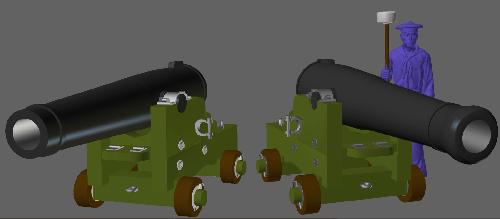

What is on my list is an 8" shell gun on a Naval truck carriage, which I modeled inside of a day by re-scaling the 10" shell gun's tube, and stealing some parts from the Marsilly carriage. I haven't printed this yet.
File comment: 8 inch shell gun on Naval carriage
File comment: 10 inch shell gun on pivot with 8 inch shell gun

The 32pdr is for my list, and I'll need a 100pdr Parrott as well.
I'll need an XI inch Dahlgren on an iron pivot carriage, but since I made the tube and the slide, might as well make the carriage too.
I found new data on the bigger Parrotts, and I resized them to this new data which included dimensions for the trunnions, which I didn't have. Now I'm to working on the cascables to get all the tubes finished.

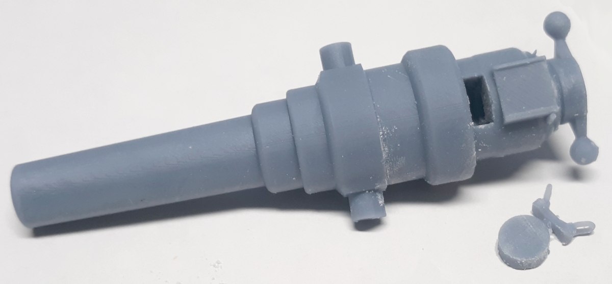

As for other people's guns, I made a 7" Armstrong breech loading rifle, and had to print it to see how my simple breech plug would turn out.
The plug just slips in, the screw breech mechanism doesn't function, though I'm tempted to make one that does, maybe.

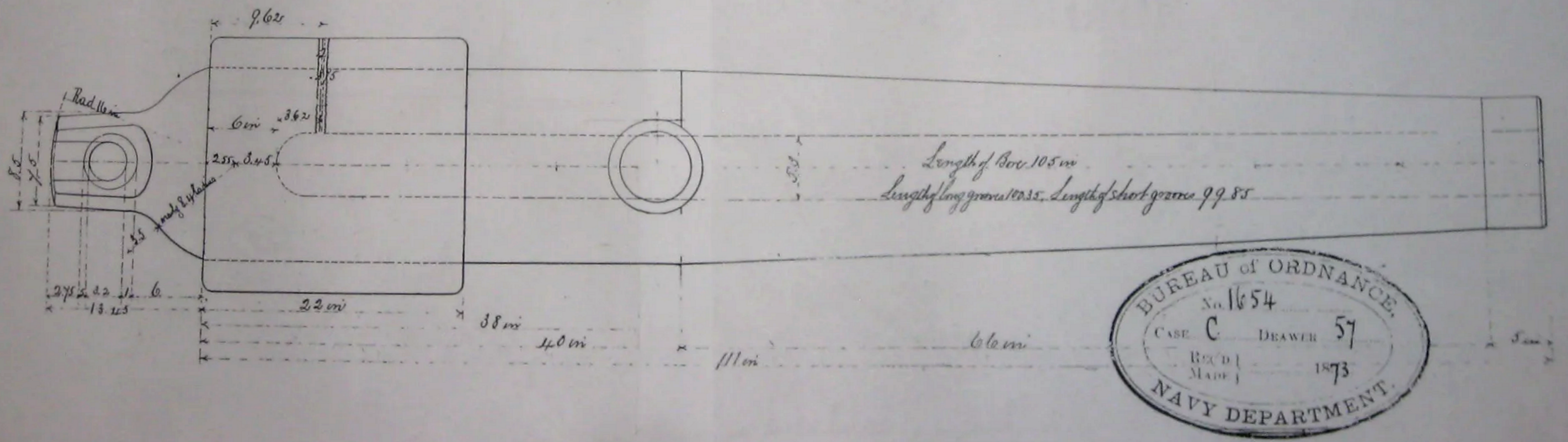

I always thought the gun was a 30# Parrott, but this recent attention to the images, and the other images of the New Hampshire crewmen posing next to it had me realizing that wasn't right.
The gun's too big, relative to the men (and boys). So I looked up the New Hampshire's armament and found she had 4 100# Parrotts in addition to her broadside pieces. That wasn't right either; the end of the cascable of this gun stopped right even with the back of the carriage, a 100# Parrott would have stuck out aft much further than that from where the trunnions were.
Digging around again, I found that the gun was a 60# Parrott, and I found actual plans for it. Well, pictures of plans, but the measurements were marked, so I could use them.
When I thought I could just pop my existing 3D model 30# Parrott on my already existing 3D model Marsilly carriage, and have another model made - it's turns out I have to start almost from scratch for this one.
I got the tube done, and added to the collection, but I have to come back to the carriage...

A discussion on 3D modeling guns on another forum ;ed to a data exchange with a fellow in Italy named Carlo, that likes to model cannon in CAD.
He passed me some data not only on the 110# Armstrong, but several other Armstrong guns.
I passed him some data he lacked, like how the parts of the breech-screw went together.
This got me interested in revisiting my 110# BLR and making the breech functional. Initially I was just going to make the breech-screw (BS) shallow threaded and the breech smoth, so the BS would friction-fit, and printing in smaller scales wouldn't be an issue.
But Carlo sent me an STL of the breech with it's threaded insides, and the breech-screw with matching threads. I just had to see if this would work, so I scaled this to 1:36 and printed just this bit to test it. The scale threads were much too fine to work without some hand-work with a file, and if scaled wouldn't work at all. Instead of giving up, I made coarser threads. I couldn't use Carlos' breech, so I made a new breech from scratch with my coarser threads in it.
File comment: Breech given coarser threads to let it scale better
A YouTube video of a 110# Armstrong being loaded and fired at Fort Nelson in Britain shows how the "lever" spins on the breech-screw to work as a hammer to tighten or loosen the breech-scew.
I recommend right-clicking and opening the video in a "new tab"
https://youtu.be/LqUkDQ3BQ1A?si=-ATPpYwuslyXLWXe
I separated the "lever" from the BS, and modeled a groove in the back-end of the BS to accept the "keeper-pins that would hold the lever on the BS.
It's all a bit awkward to describe, but hopefully pictures will help:
File comment: How the "lever" attaches to the "breech-tcrew/Tappet ring"
File comment: Breech screw assembly printed
File comment: All the gun parts, looking into the breech
File comment: Gun with improved, albiet not scale, breech-screw theads printed.
The holes for the keeper-pins needed to be drilled out after printing, and I need to fine some wire for the pins, but it should be functional, allowing the lever to spin as in the video. The coarser threds on the breech work great without any hand-work, and should scale down to 1:96 and still work. The lever's function, on the other hand, I don't think will scale small at all, so I made a BS with the lever attached and not spin that will scale just fine.
