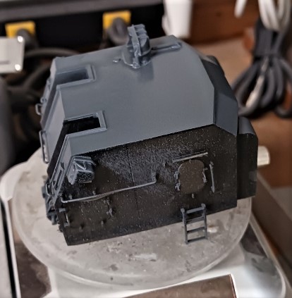

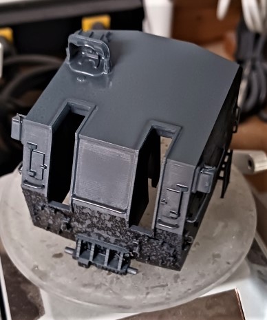

So, here is the 2nd edition mount body with modifications here & there. It is drying overnight from the deck gray spraying this evening. The floor fits rather well this time around with little sanding, etc. I've got the other parts in the painting stage and hope to have things ready for assembly shortly -

Hank,
As I understand it, this mount was never actually built. This is your interpretation of what it might have looked like. Right?
Like Tom, I think the mount Captain's hatch position is odd. It places him right over the starboard gun mechanism. When the gun is lowered to it's lowest depression it would be right under his feet. To get into the hatch he would have to climb over the gun.
It was normal to position the mount/turret Captain/Officers station behind the gun mechanisms. In the 5"/38 mounts the Mount Captain was positioned behind the guns, and in the twin mounts he was between the shell casing chutes.
Do you know of any mounts where the Mount Captain's position was not at the rear and on the center line of the mount?

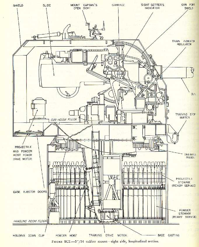

Phil,
Thanks for checking this out! First, YES- my mount design is a "conceptual" version based on the drawings of the actual single barrel 5"-54, Mk. 39 that was installed on the MIDWAY class CVs in 1945. I agree with your comments regarding the position of the Mount Captain's hatch/hood but I based this on the location of the existing mount. Here is the 1945 U.S. Navy Mount & Turret catalog drawing of the single mount -
And here are the accompanying interior illustrations (side/top) of the mount -
It would appear that the location was situated ahead of the ventilating motor and behind the trainer's station on the stbd side.
So, beyond that I can't explain why it was designed that way. I simply expanded the width and made a couple individual mods to the location & so forth of access doors, etc. Again, this is my interpretation and thus no "right or wrong" way to explain how it would be done. Perhaps given some thought about a 2-gun mount, one could come up with a different interior arrangement from this. There is one of these singlel mounts situated at White Sands N.M. at the Army artillery range. Any others remaining in existance I'm not aware of - very well could be. Here's a shot of CORAL SEA's port side in the early 1950's -

PostPosted: Sun Mar 26, 2023 3:37 pm
Posts: 3841
Hank,
Your effort is conceptual and no known plans of the twin mount are available (but quite likely did exist since development started during WWII, but was never finalized and may have been trash canned or is sitting in a BuShips files somewhere). But, I would have to agree with others, that I think the Gun Captain's hatch should logically be on the centerline between the two 5-in guns. The hatch on the single mounts was made off-set to be out of the way of the gun breech and ejector chutes. If you look at photos of the MIDWAY class carriers, the Gun Captain's hatch is on the left side for "Forward stowed" 5-in mounts and on the right side on "Aft stowed" 5-in mounts. In effect a mirror image installation so that the Gun Captain's hatch was "outside" under the overhanging flight deck.
The 5-in/38 mounts were designed based on common (left and right) single mounts mated for twin mounts and explains why there are "left and right" single mounts on destroyers. So I'm guessing that similar arrangements may have been used in designing these new twin mounts.

Rick,
Thanks also for your input regarding the location of the mt. captn's hatch. I'll have to give some thought about that as I can see both locations as viable although when you consider moving the stbd gun closer to the side, it would leave little space for the hatch to remain in it's current location on the single mount.
Since my latest extremely nice 2nd edition will now be obsolete even before the paint dries, I may have to bring you up on "delay of design" charges at Capitan's Mast!! :big_grin:
Here's what it will look like (also moved the hatch back slightly, as well -
NTS 5in 54 Mk. 16 Mod 0 1945 Dual Mount_4 - Final Version.JPG [ 46.88 KiB | Viewed 1923 times ]
Yes, I do think you, Phil, and Tom have all made a good point here and I thank you for bringing this to my attention. :thumbs_up_1:

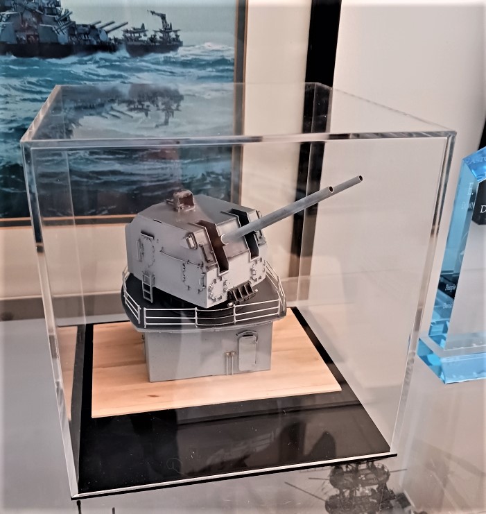

Yes, Tom - it has been an interesting project. So, after some redesigning and printing, the end result is finalized -
The mount is located over a 5" Upper Handling Room on the 01 Level on a "conceptual" MONTANA class BB.
Now, on to finish my Mk. 38 Rangefinder w/Mk. 13 RADAR which is my next mini-project.
