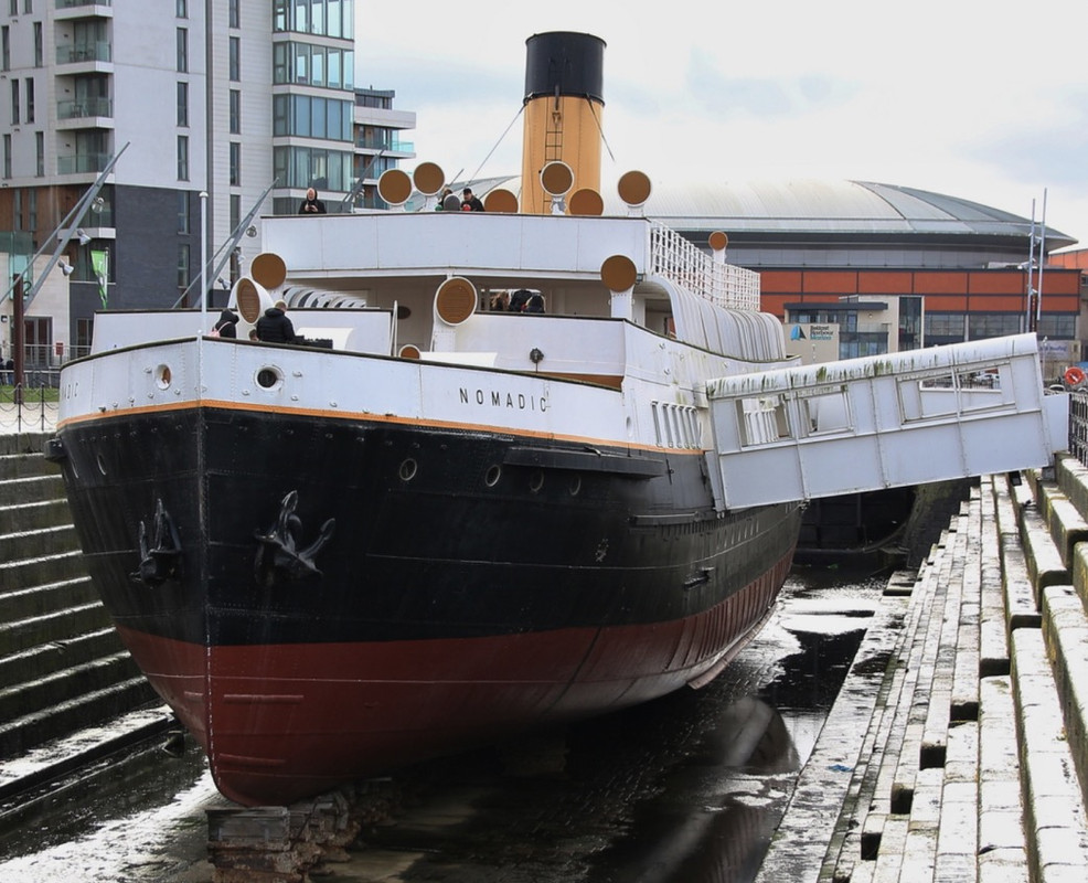

SS Nomadic, Transborder, the little sister of the Titanic, at 1/200.
Launch at the Harland & Wolff shipyard in Belfast:
The ship in Cherbourg, France, its home port:

My version will be that of the first two photos, just before the installation of a bridge shelter in Cherbourg to shelter the sailors, the wheelhouse and the chadburn.
http://rms-titanic.fr/otb/index_nomadic.html

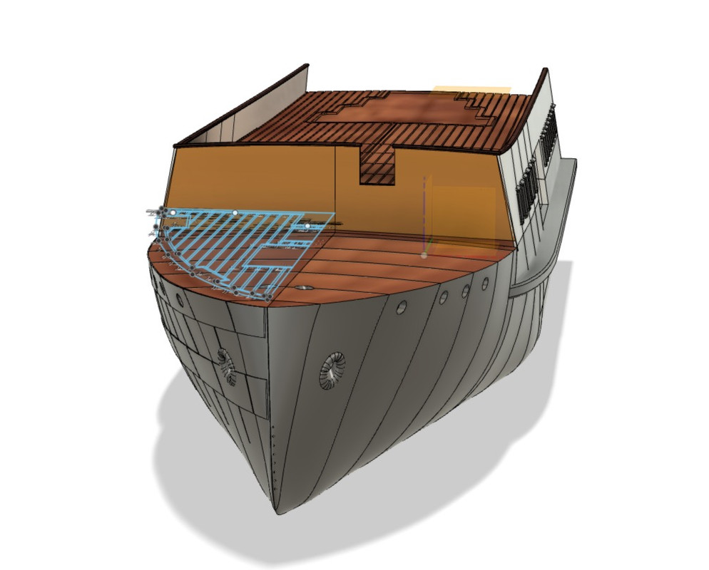

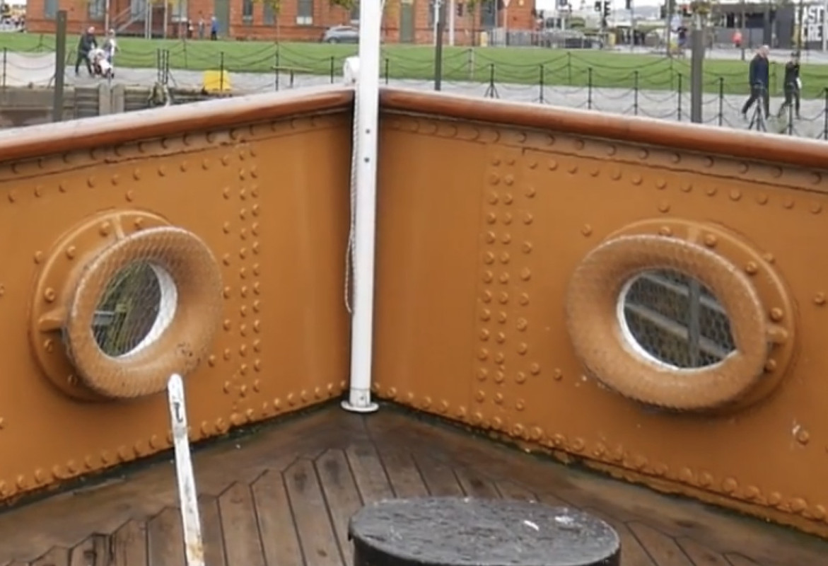

I worked this weekend on the teak floor of the first deck that I grooved, and on a sheet line test, it's a first, and it's very time consuming, but it looks pretty good.
For the sheet metal lines I did as I could because of the limitations of the program's functions regarding the projection of a plane sheet metal line plane on the curved hull.
Boilermaking day today, it's very long to realize. I had a little thought for the workers who installed the sheets and rivets at the time...!
I would do the rivet lines with the rivet roulette wheel, once the ship is printed, especially since the hull may need to be sanded a bit.

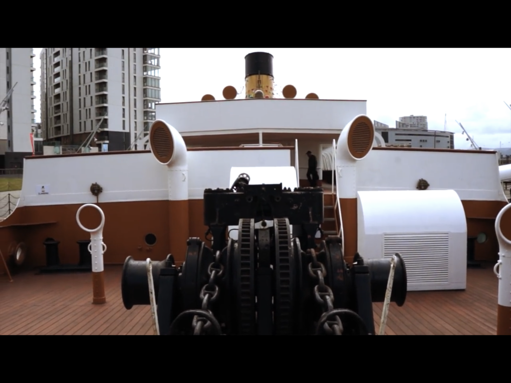

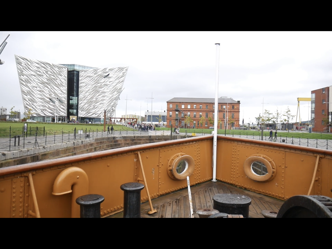

It can now be seen at the Titanic Museum in Belfast, after it was saved in 2006. Its restoration cost 10 millions euros, but it is a symbol for this country.
https://youtu.be/hFPz3_jANVs
https://youtu.be/rybZx56umPA

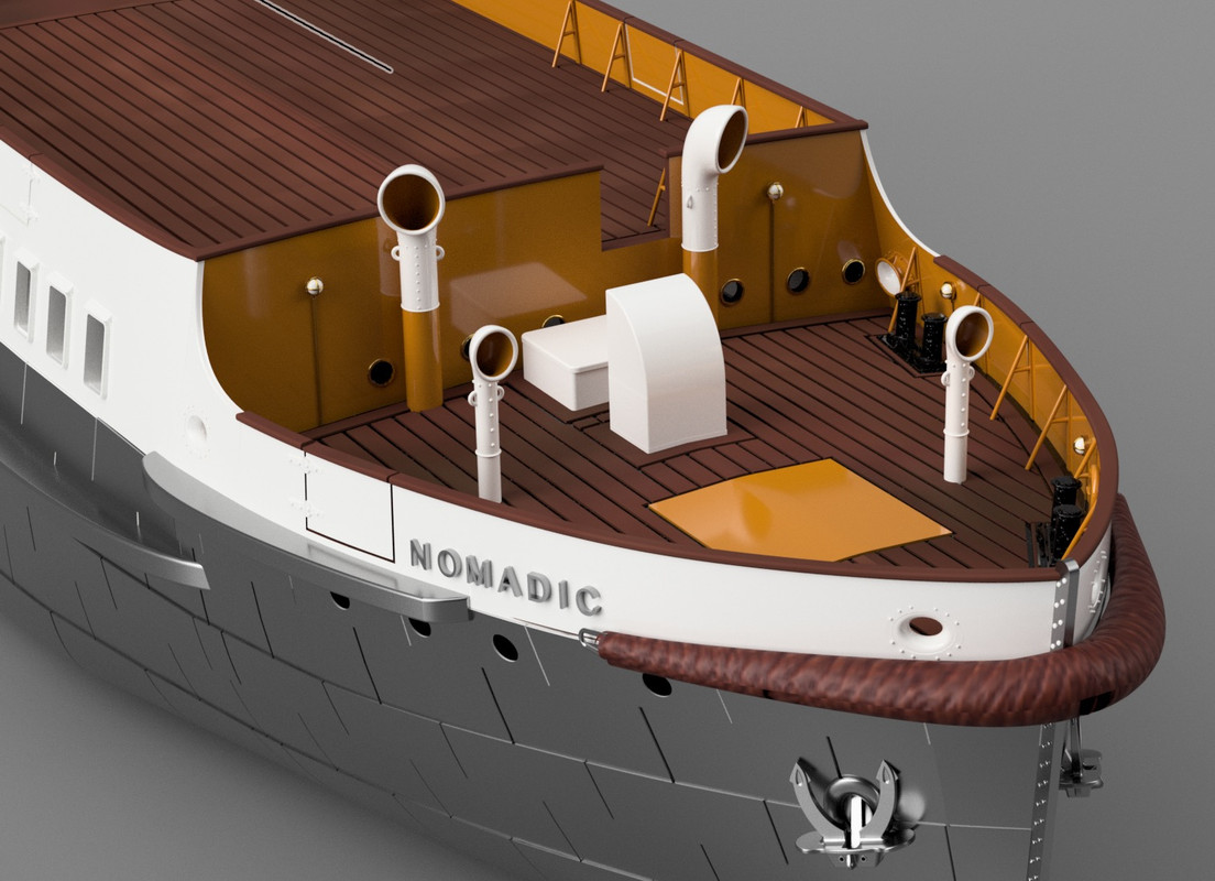

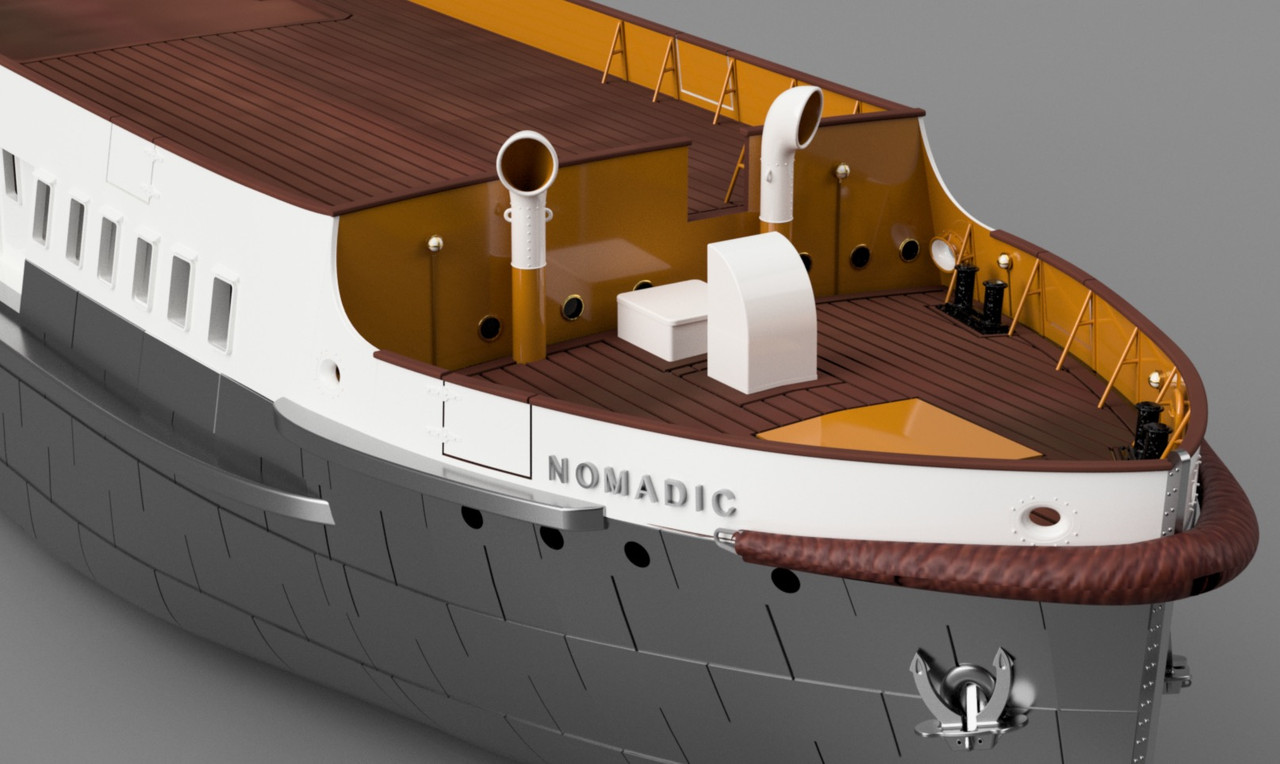

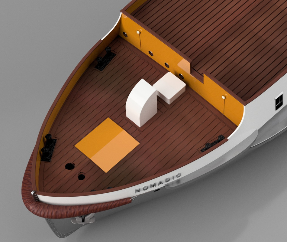

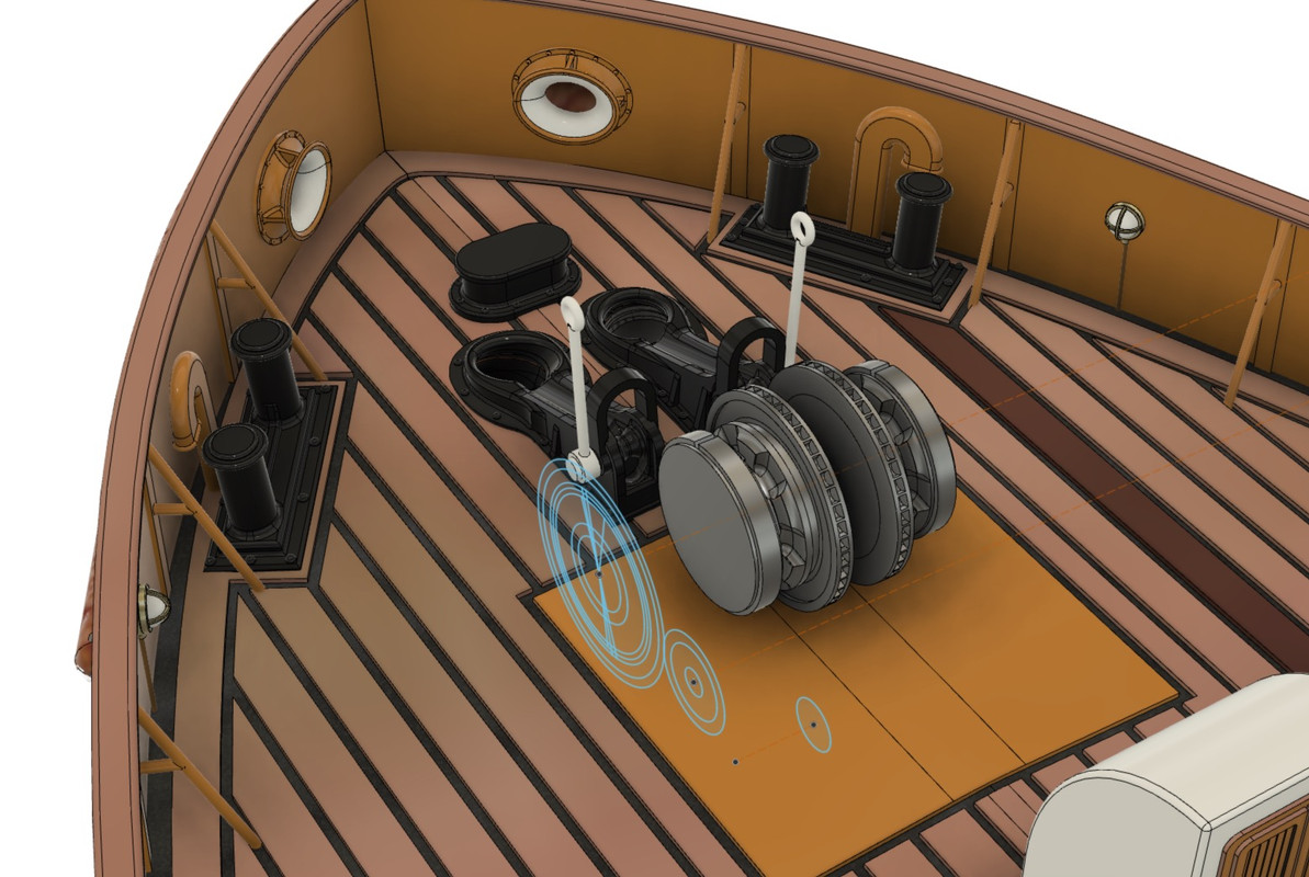

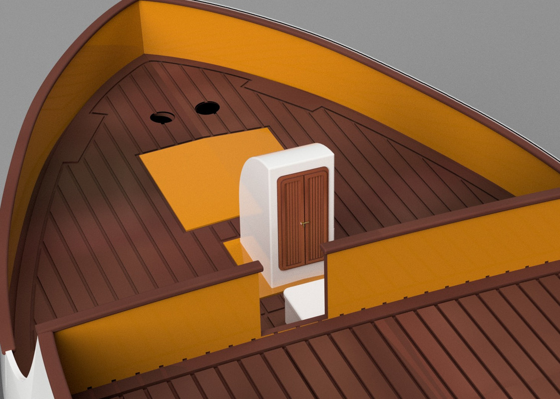

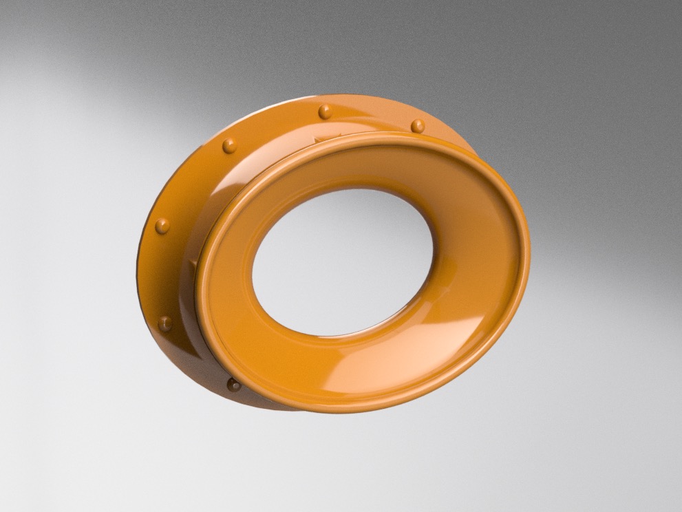

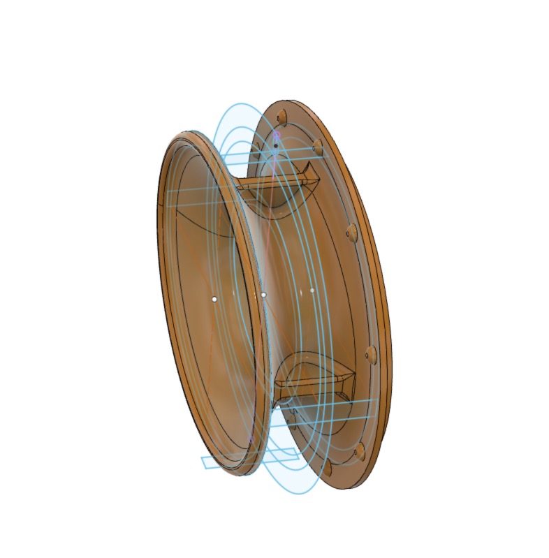

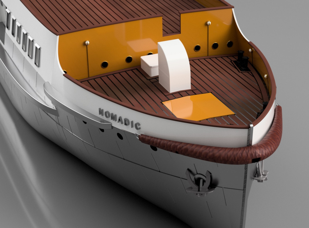

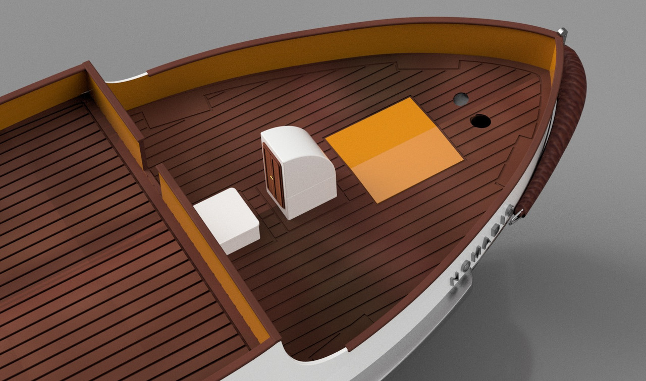

I moved forward on the forecastle, laid the teck, designed the bollards, portholes, lighting and hatches. Modify the shape of the bow.
Titanic Bollard, typical Harland & Wolff shipyard design.
Pascal

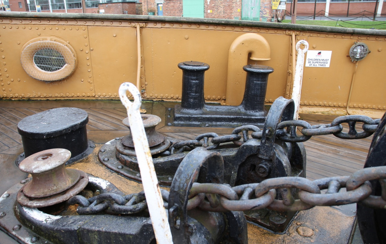

Inside, under the main deck, aft. Before restoration.
Pascal

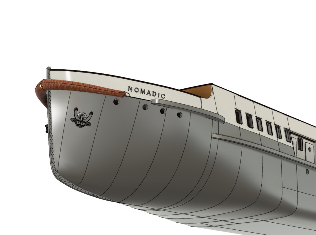

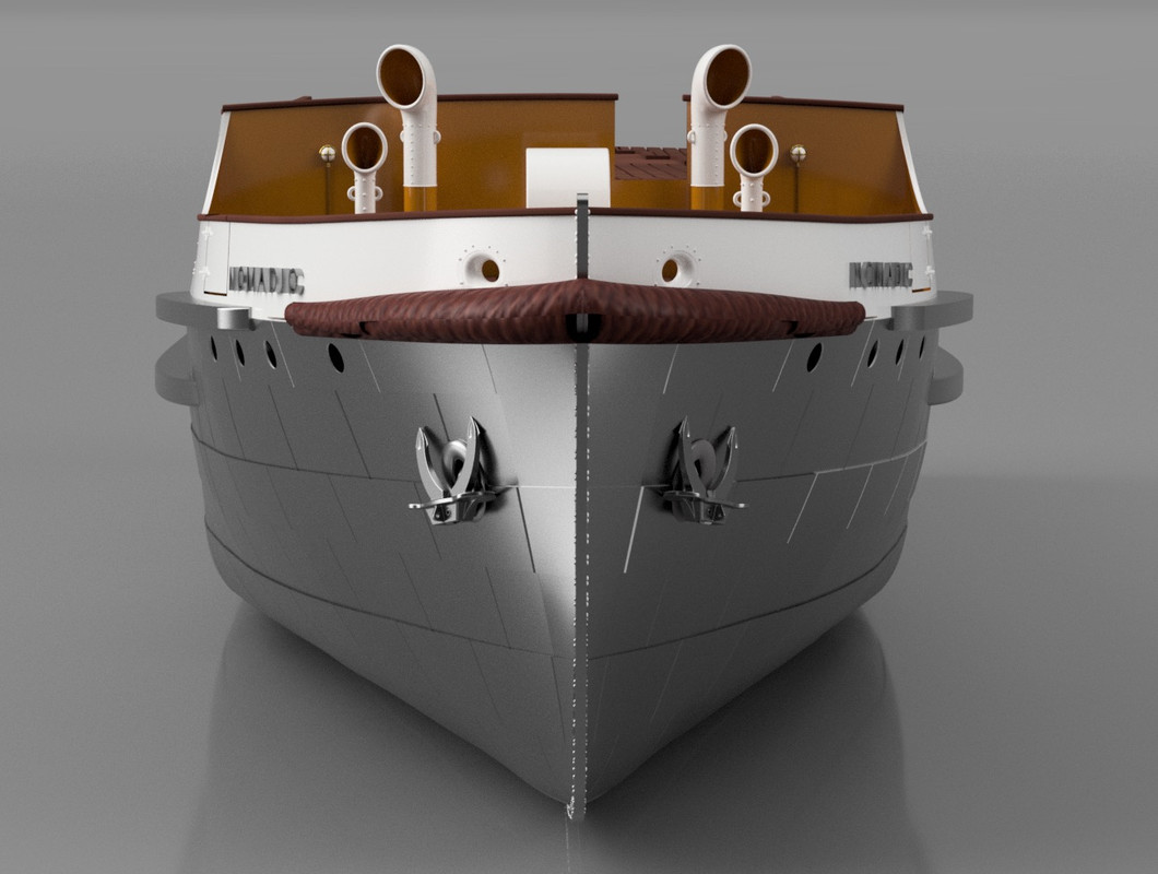

I added some details today, the bulwark reinforcement legs, air clearance, doors for transhipment, corrected a few mistakes.
Pascal

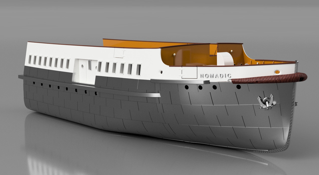

Today I have almost finished the fitting of the hull sheets. Drawing of the ventilation ducts of the forecastle.
Adding the middle transhipment doors.
Corrected some errors.
Pascal

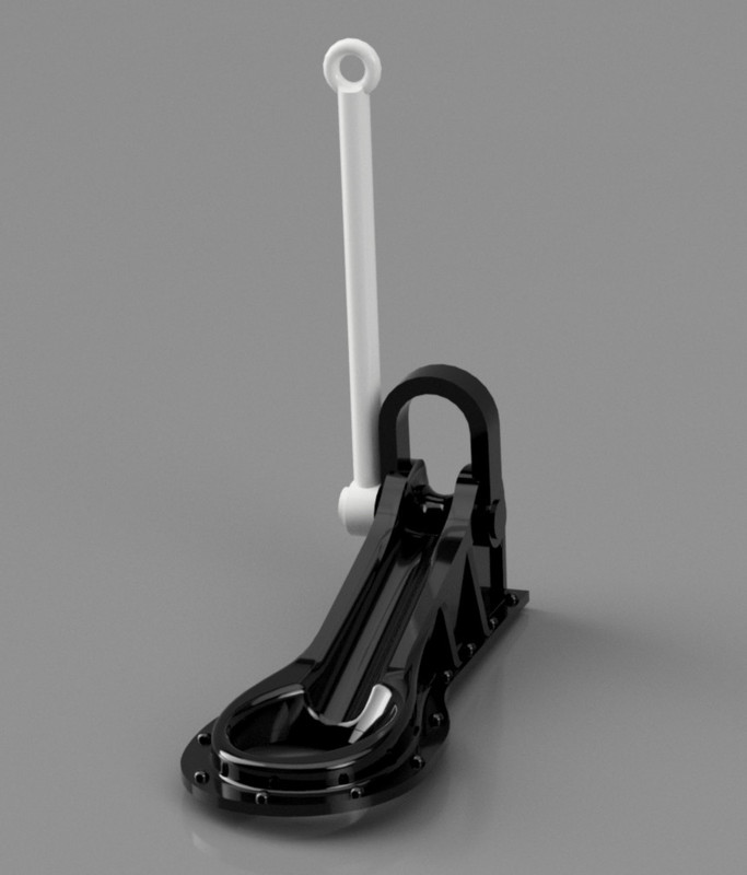

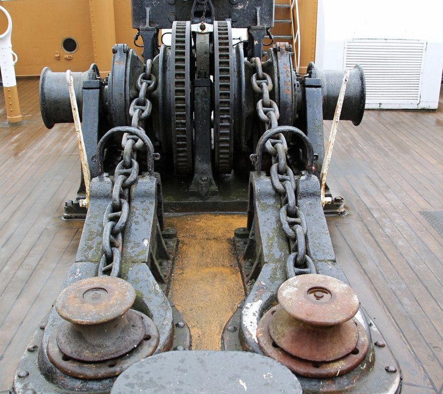

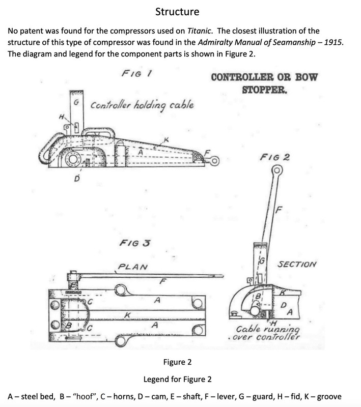

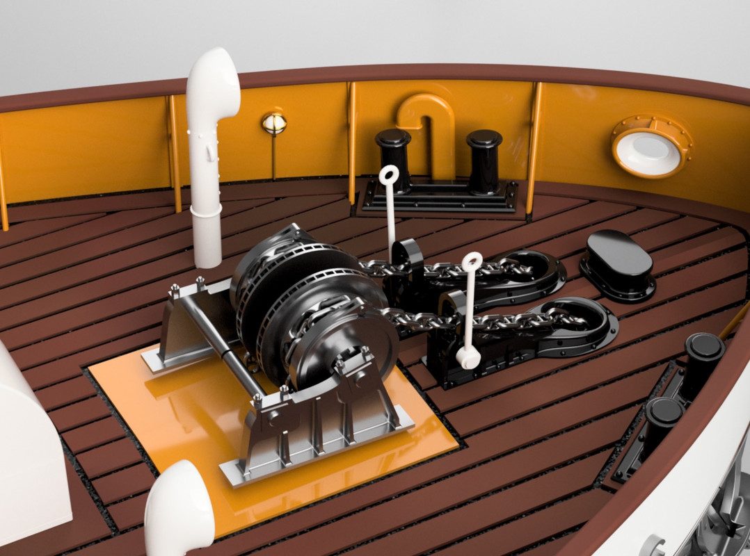

Simplified drawing of the stoppers. I have some modifications to make.
It looks like the Titanic's, but mechanically simpler because of the very low weight of the anchor chain links on the Nomadic.
Titanic:
Pascal

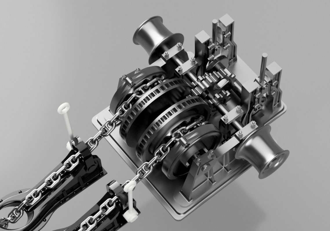

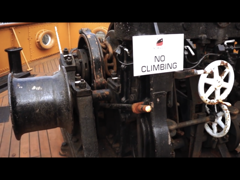

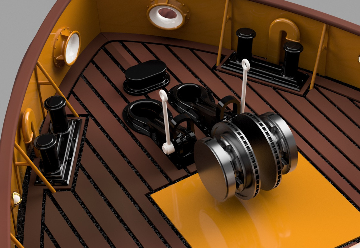

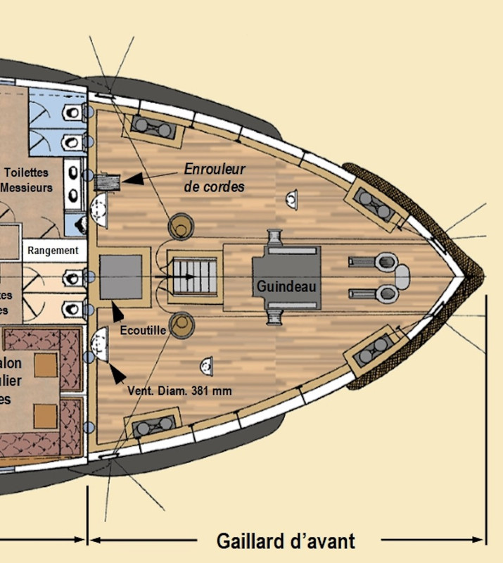

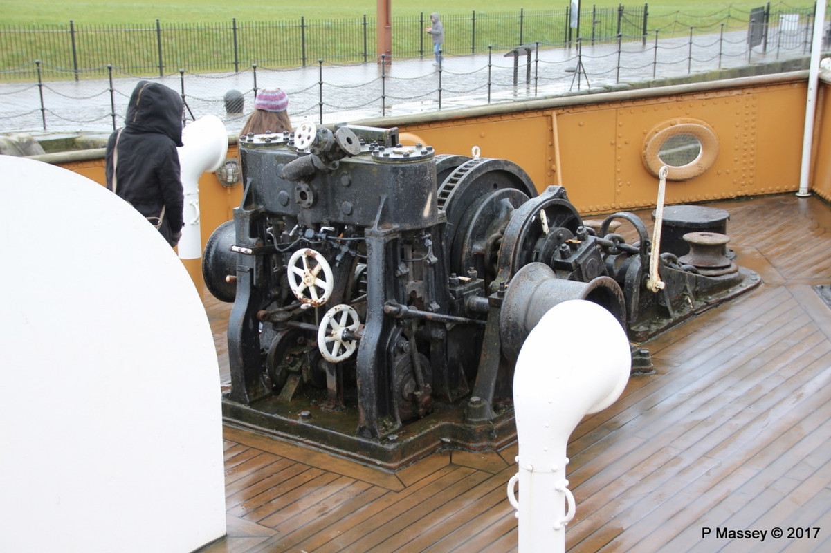

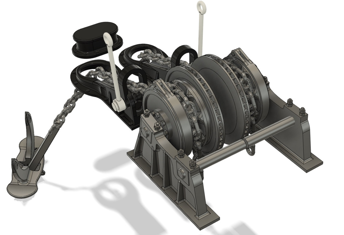

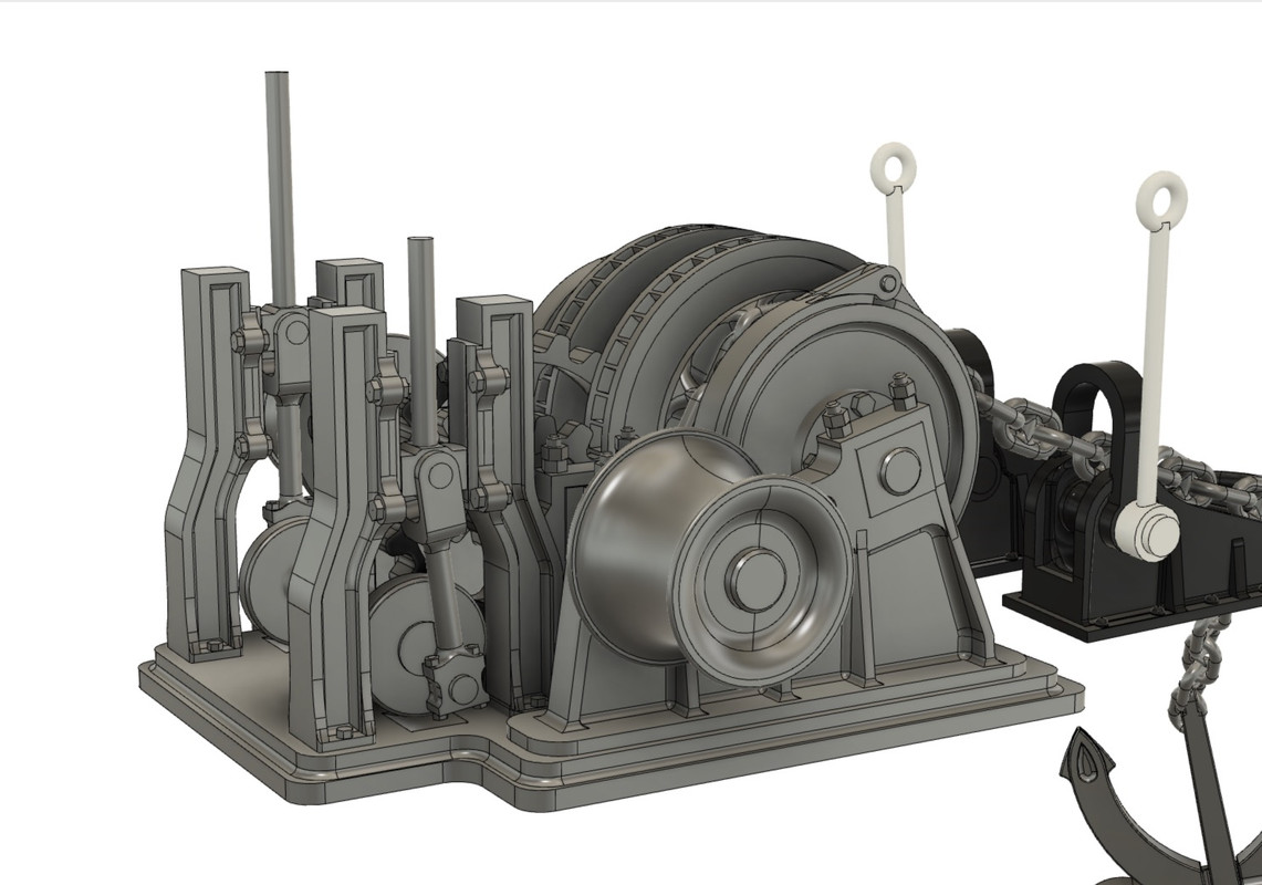

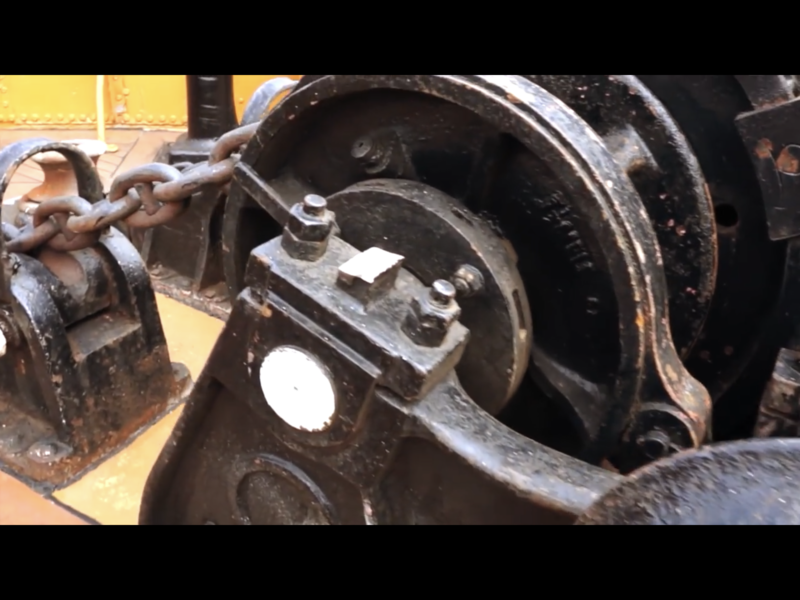

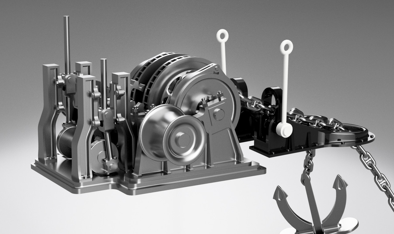

Small advance today, the windlass. A piece always delicate to draw without a plan. It remains an "evocation"...
Pascal

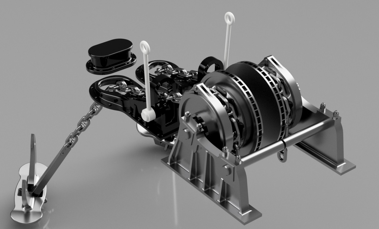

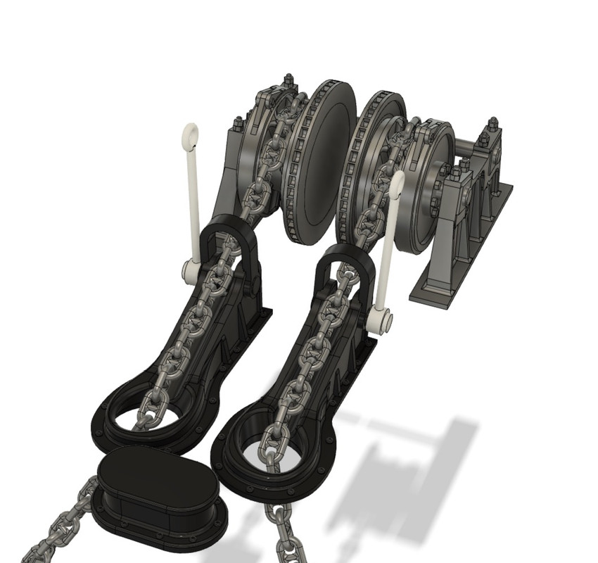

The Mono X printer is repaired, the film in the tray is replaced.
The day's progress, attempt to draw an anchor chain for fun. Anyway... I'll print it to see what it looks like. And I continued with the windlass.

PostPosted: Mon Nov 23, 2020 12:44 am
Posts: 1677
The chain and windlass look good.
I can't make out clearly what you have connecting the chain and the anchor, but normally there would be a shackle connecting the two.
You have done an excellent job creating your model from the 3D CAD drawings to the 3D print.

Yes Phil, it's not done yet, the job is in progress.. Priority goes to the pieces I'm going to print, chains are just here for a 3D drawing exercice and for the general view of the windlass. :thumbs_up_1:
The design in general is optimised for 3D printing, this windlass will be very small at 1/200. I must not go below 0.3 mm for some parts.
Pascal

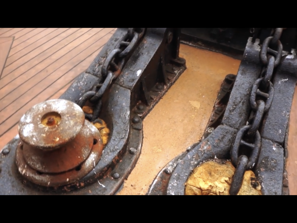

Dismantling a Kenter shackle:
Personal pictures.
Keppel Shipyard Singapore:
Pascal

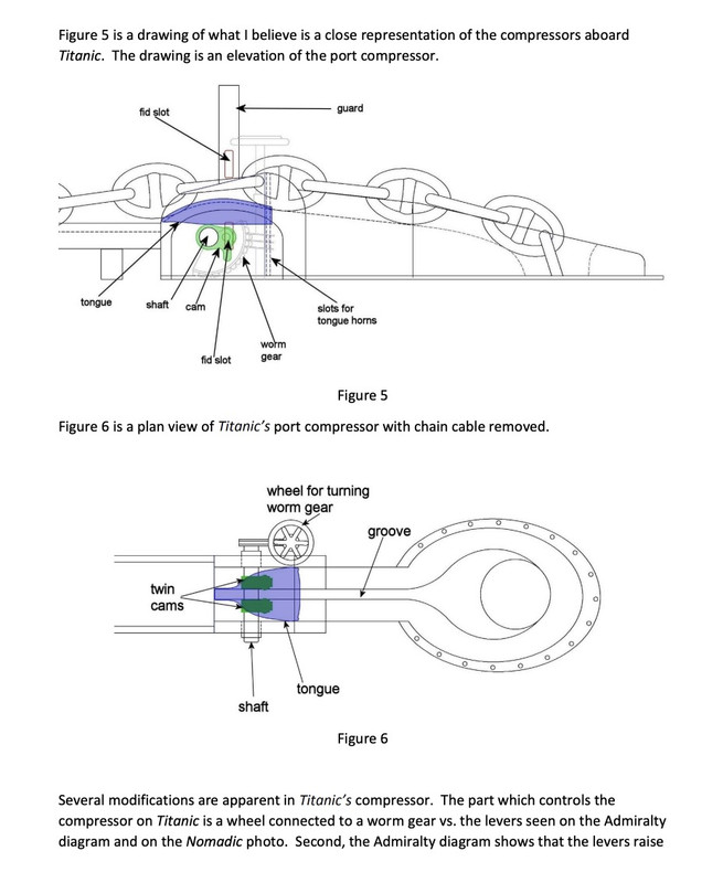

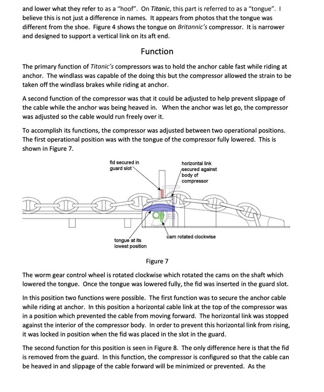

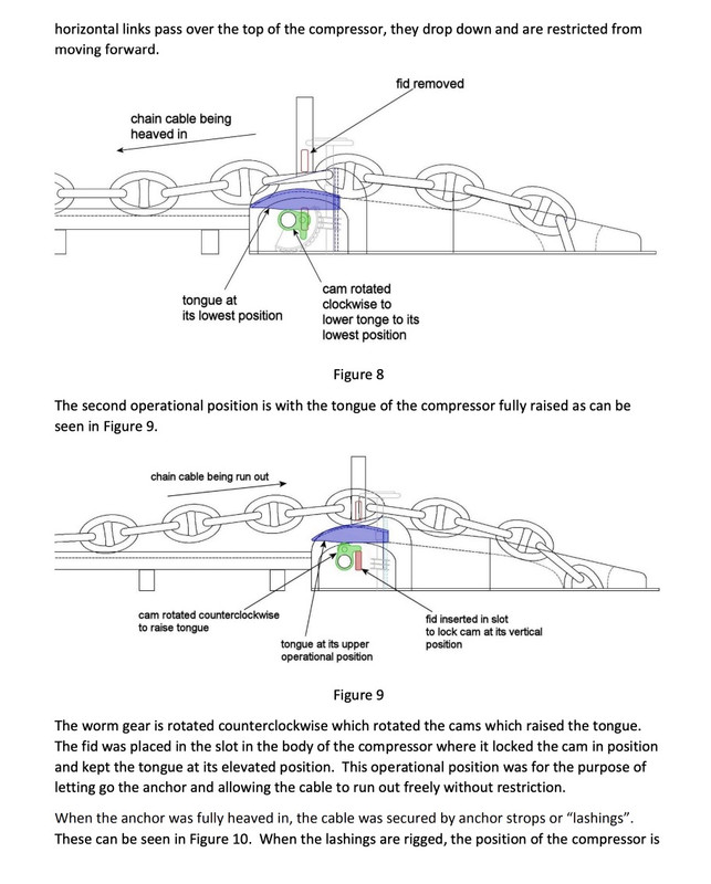

The connection scheme must be close to the Titanic's/Olympic's anchors in 1900:
https://www.encyclopedia-titanica.org/c ... ize.39247/
https://www.birminghammail.co.uk/news/m ... on-9214506
