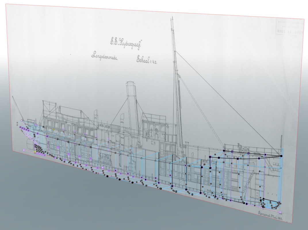

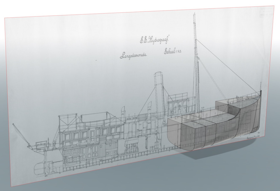

Thanks to Roland for finding me the necessary plans to draw the hull in 3D.
At 1/100 the ship will be 40.5 cm long overall.

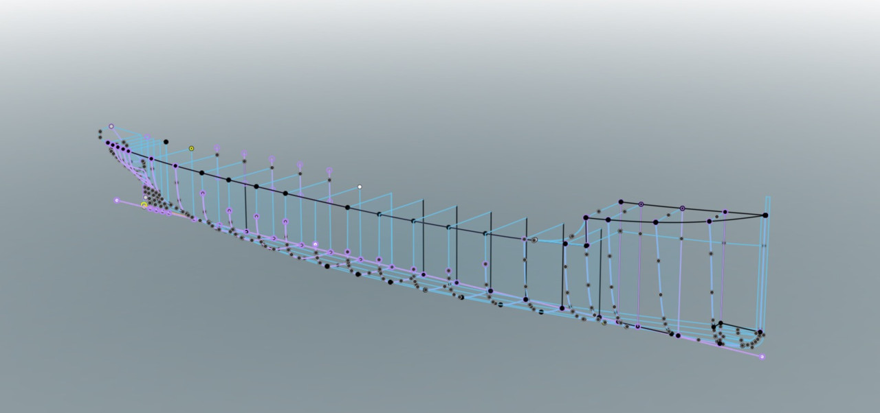

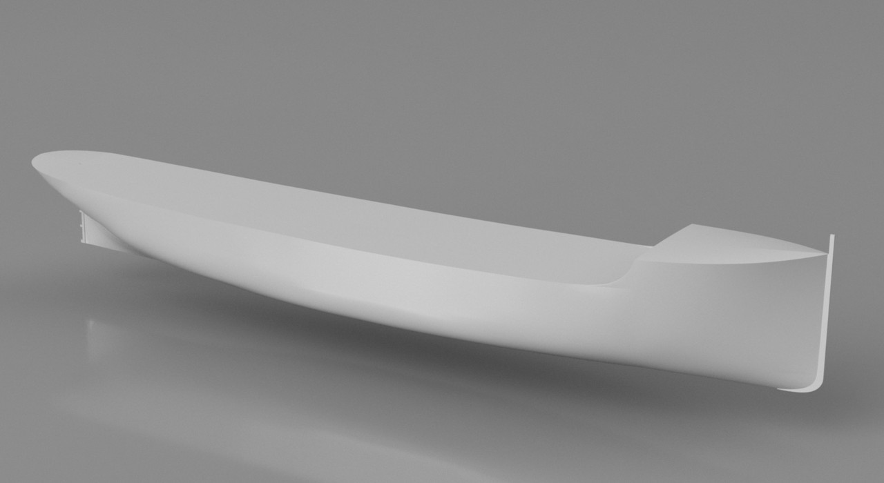

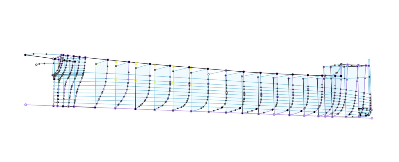

1/100th scale sketch of the hull, nothing final, nothing finished:

Pascal:
An interesting era transitioning between sail and steam. The counter stern, raked masts and ratlines but with the straight stem and little bow flair. Even a spoked wheel on the fantail! I think there is a bit of a visual transition when one moves across scales, though perhaps this is a lesser challenge when 3D printing is used rather than traditional scratch methods.
Quite the transition from reciprocating dual (coal?) steam plants to diesel. I can appreciate the change! I would guess by now that the MAN (Machinefabrik Augsburg Nuremburg) are now excellent. Some (barely) pre war US submarines used MAN engines and they were very troublesome, much better result was had with the Fairbanks Morse engines. A little know fact was the USN pioneered the conversion of US Rail to Diesel pre war in order to develop tested and reliable power plants for the sub fleet.
Should be an interesting project!
Regards: Tom

Nice to see someone working on a model based on the NL national archives drawings. I've seen Hydrograaf lots of times when she had her winter quarters in Amsterdam and she is a beauty. And Tom, triple/quadruple expansion to diesel happened to most ships from the early 20s onward as it was the most economical in fuel costs and it did no mean a full re-design of the ship (like turbine or diesel-electric). Note that most of the dutch merchant ship owners never used turbines or diesel-electric.

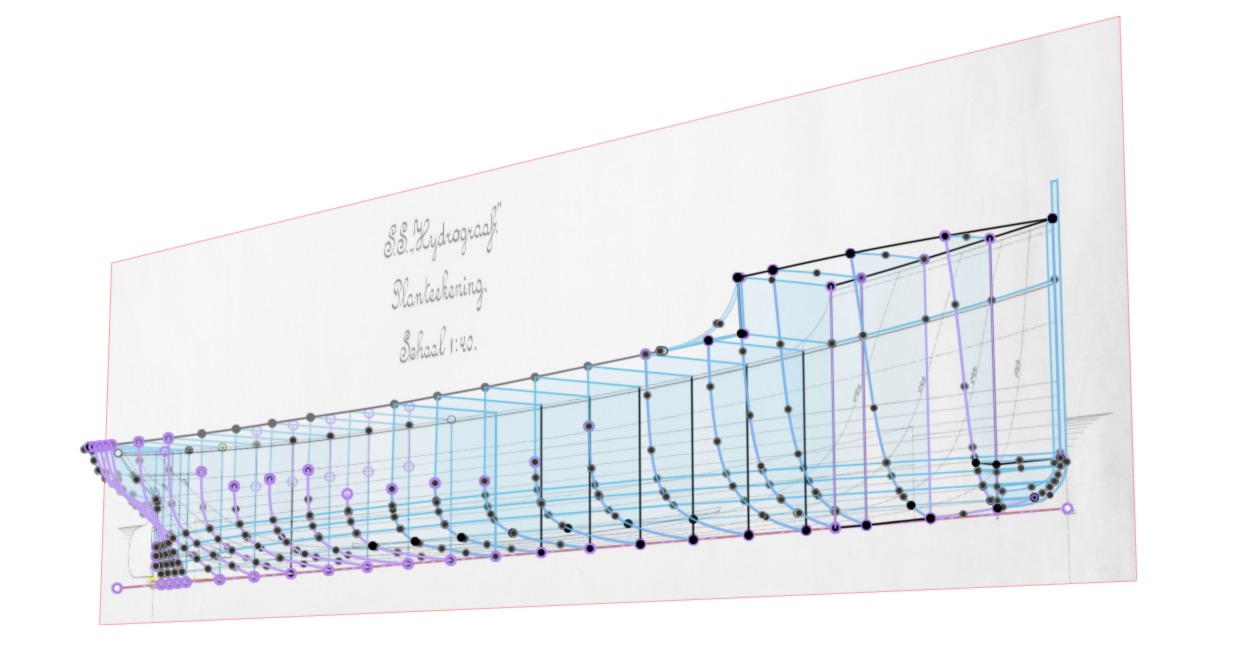

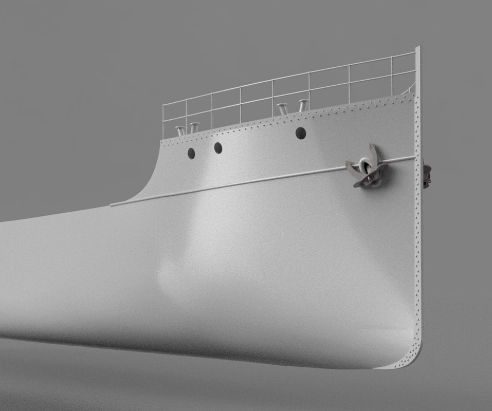

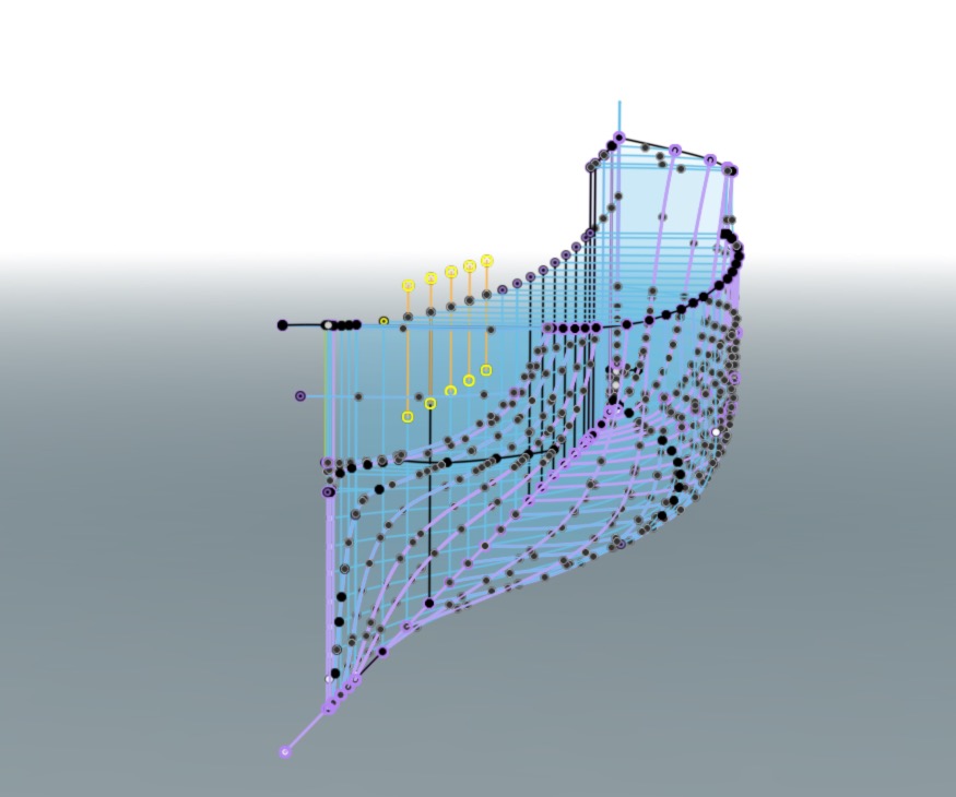

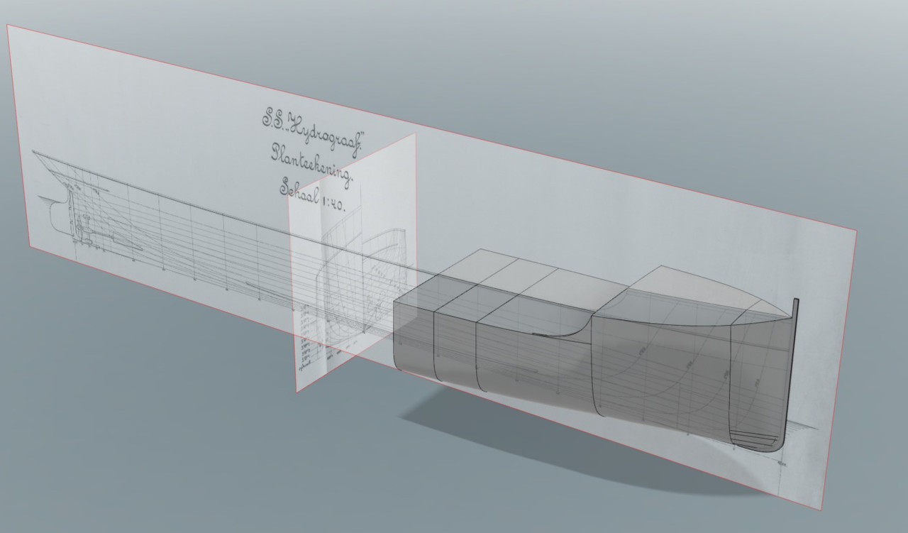

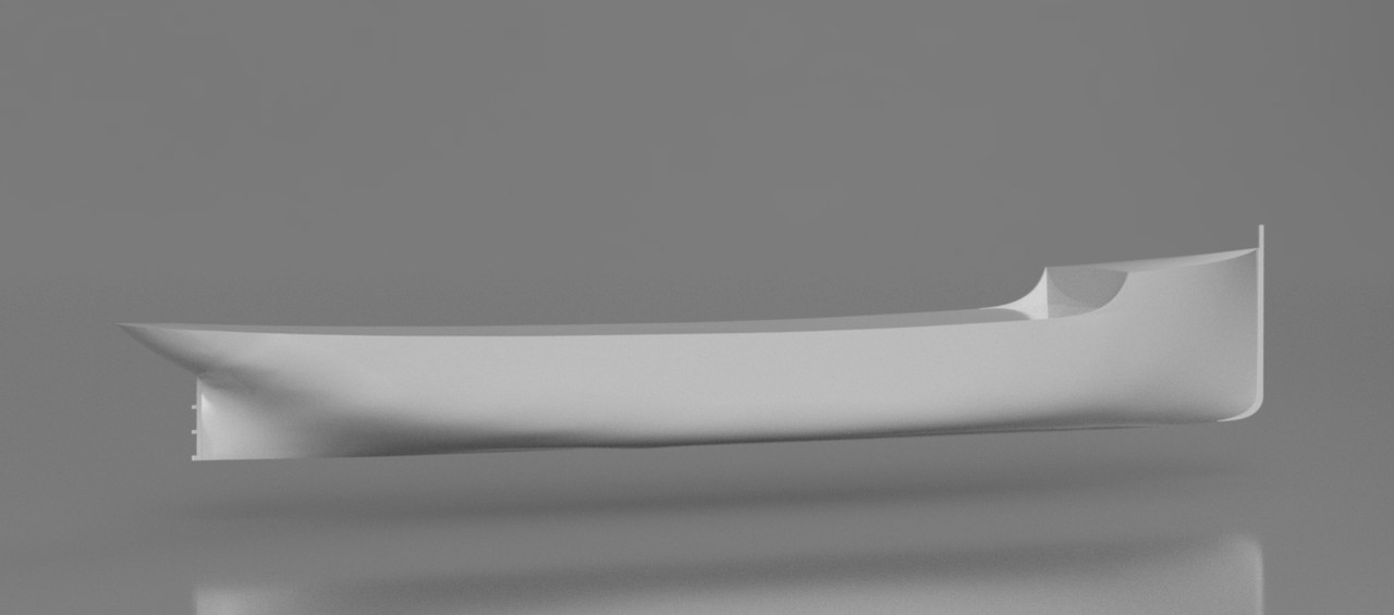

I'm still drawing the hull lines according to the plan, I had to add some more because of the limitations of my 3D program and to refine the surfaces, it's taking quite some time, but I'm getting the hang of it.
Good progress today. There are some minor modifications to do.

Interesting change at the stern counter for the computer drawings. one can only imagine the experience and skill of the marine engineers, draftsmen and shipwrights turning a concept from an idea to iron and steel with the tools of the day. The project will be colorful and in 1:100 provide a pallet for display of excellent detail!

Indeed Tom, the stern is quite complex to draw in 3D. The boilermakers had to have fun on this part of the ship.
I spent as much time on the rest of the ship as on the stern.

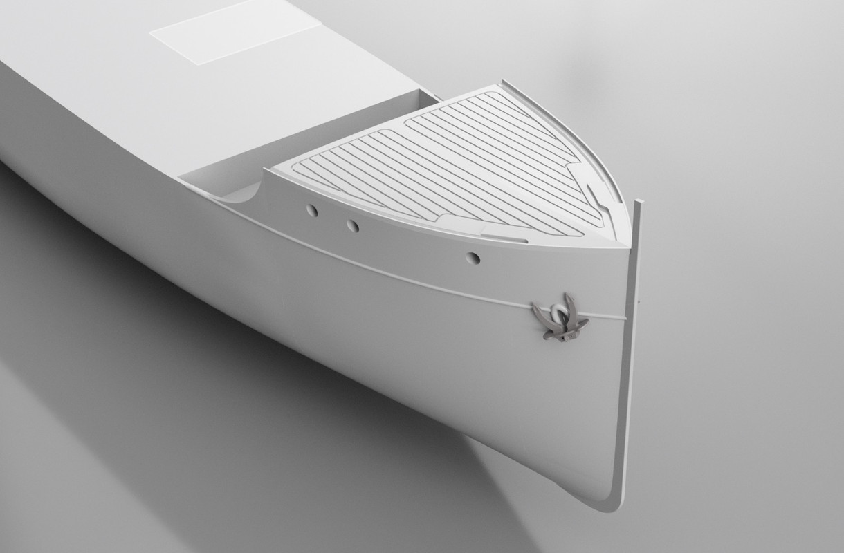

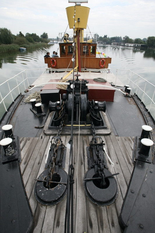

Positioning the hawse tubes today. There will be a new anchor model to draw, I have placed this spare one in the meantime.
I concentrate on the front forecastle with my tried and tested 3D drawing methods and sometimes new ones.
This forecastle is peculiar with its "gutters" on the edges. I have estimated that the deck floor must have looked something like this at the time.
You can see from the contemporary photos that parts are missing, dismantled but not replaced for cost reasons perhaps, in order to replace the steel sheets underneath this floor which suffer a lot from corrosion as they cannot be maintained.
It can be seen that the anchor chain stopper pattern is almost identical to that of the SS Nomadic ( 1910 ).

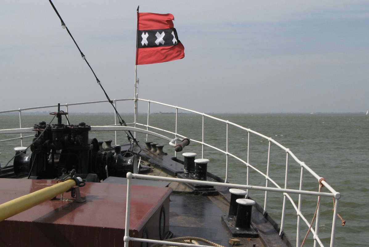

Is the awarthships handle a hand operate bike pump?
Iceman 29
Posts: 1952
Location: Bretagne, France
Re: SS Hydrograaf, 1/100 3D, hydrographic ship, Royal Dutch
Post by Iceman 29 »
I think it is the command of the steam engine, Tom. It's seems connected to the steam pilot valve.

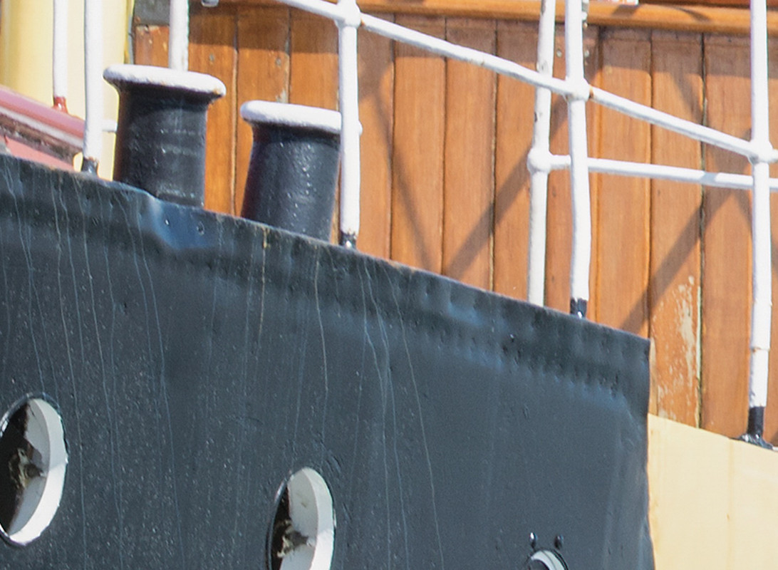

Yesterday's progress.

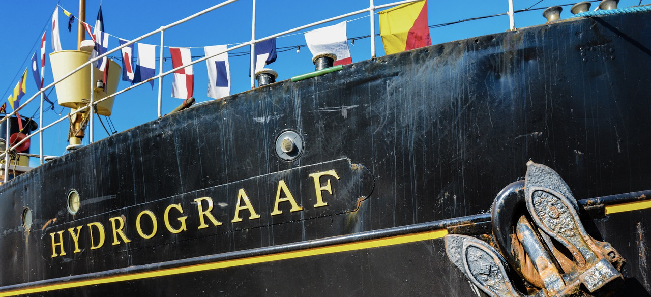

You can see that the 2 lines of rivets have been partly removed, or eaten by rust, replaced by an arc weld perhaps.
The ones on the bow are still partly there.

Pascal,
The rivets on the hull sides were probably flat on top (countersunk heads) and not rounded (button head).
Countersunk head rivets did not cause drag and presented nothing to collide with ice flows, etc.
The rivets on the stem were button head and would not contribute much to drag or interfere with sea ice any more than the stem itself. I suspect the button head rivets created a stronger bond between the plates than the flat head rivets.

Talking about the gutters at forecastle: when you have a wooden decking, you can take this right up to the metal bullwark etc., as water would collect in the corner between the wood and the metal, leading to the rotting of the plank edge. These waterways or gutters used to be formed from angle-iron and were often given a trough shape with a cement mixture to protect the metal from rust.
Countersunk rivets require a certain thickness of plating and are expensive to make. Domed shape rivets tend to be stronger and cheaper to make, but there are also intermediate forms, with partially countersunk and partially domed rivets. Countersunk rivets were more frequently used for aesthetic reasons and not so much to reduce drag. Warship often had countersunk rivets above the waterline and dome-shaped ones below the waterline.

Thanks Phil & wefalck . But I'll leave it like that for aesthetic reasons.

Wefalck,
I know that early iron ships used domed rivets on the hull. I have visited a few of the surviving vessels.
However, by WWII flat or slightly domed countersunk rivets were used on hulls, at least with the Cleveland class cruisers that I am most familiar with. The blueprints specify that below the water line the rivet heads will be ground flat to reduce drag. Also, where hull plates of different thicknesses are butted together the edges of the thicker plate that rise above the thinner plates were to be ground back at a 45 degree angle on the leading (forward) edges to reduce drag. On these ships the thinner plates were welded instead of riveted.
Also, above the water line backing plates at the vertical junction between plates in the same strake were riveted onto the outside of the hull plating. But below the waterline the backing plates were riveted to the inside of the hull plating to reduce drag. Likewise, the docking keels were inside the hull plating. On many ships the docking keels were outside the plating.
It would be interesting to follow the development of metal hull ship construction and drag reduction measures over the first 100 years of metal ship construction.
