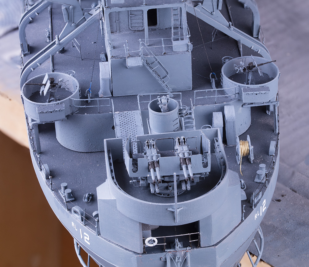

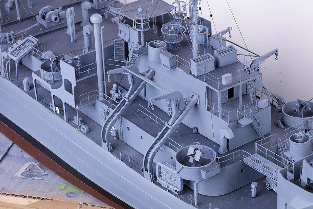

Happy Bastille Day (Jan 6). Current progress on the ARL as I work stern to bow. Added helmet racks and some individual GI Helmets hanging on hooks by the flying bridge. A few life rings as well on the main deck life lines.

Tom - your ARL is looking SUPER!!! All the details are quite superb!!!

The aft end looks sufficiently over packed as was typical of a WWII "man o' war" or anything else that left the dock at the time.

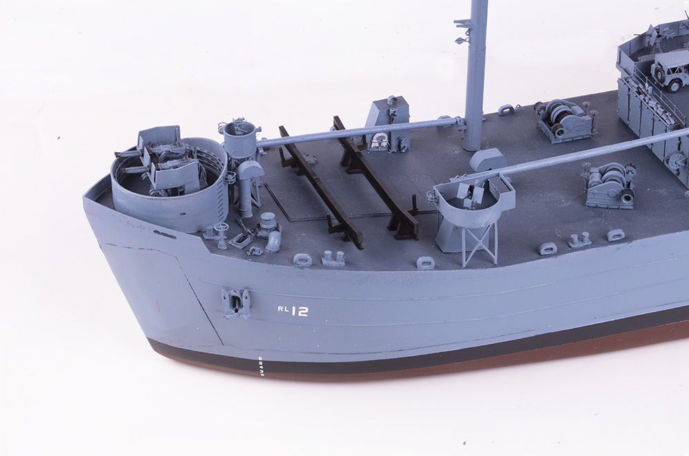

The ARL's usually had an "unusual" bow awarthships boat rack where larger boats such as a LCM or 40' Motor Launch could be placed for storage or work. I have printed a trial version to see what modifications are needed as I have no exact drawings of this. NARA has a BOGP for ARL 13 which has this rack, but like Chicago teachers, they seem to be on permanent vacation.
Though they come off the printer fine, they have a tendency to banana when drying. A 3D technical issue which I have experienced and solved in various ways. So product development is necessary.
Stay tuned for further developments! Tom

The boat racks in the black as a trial fit. I need to reduce the angle a little on the supports to better match the deck sheer. It is not totally sure how these were employed. It may be that the ends hinge in to make a cradle? Certainly cross beams could be installed on the lower ledge of the I beam. I have variously seen LCM's, 40' motor launches and LCVP's placed here.
Notice the purloined jeep on the O1 level...

Attempting to print this set with Model Grey rather than Rapid Black resin. The Grey is more rubbery and delivers less detail, but the rubbery part may be a help to keep them straight. I added a 1.07 mm hole lengthwise to try to add a stiffening piano wire. This worked well with the booms.
Paying attention to the Cart-Horse order scenario, some detail around the ramp needs to be constructed. I can just see the jeep, won in a poker game being spirited away from Mog Mog (Ulithi) in one of the LCVP's to betaken aboard and re painted and assigned a mythical NAVY serial Number.
The Early ARL's had the bow doors welded shut, later it was found desirable to retain the capability, as well as the ramp. The early LST's had a sort of elevator, but those produced from later LST's had the ramp. Some, such as Sphinx had this removed post war.
