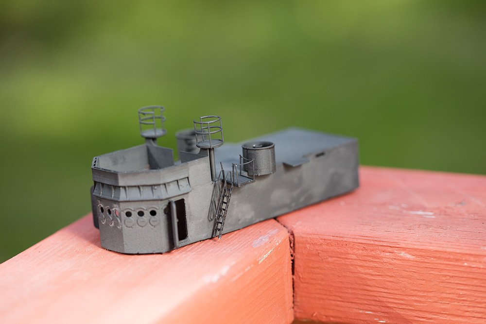

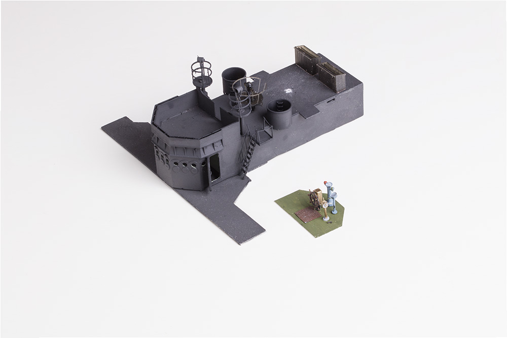

Current progress on the pilot house: Consists of seven parts, fwd and aft deck house segments, PH roof deck, (Strathmore paper) Flying bridge bulwarks (Incl searchlight platforms, round tubs and inclined ladder.
Interior of wheelhouse will have some minor detail. spoked wheel, Eng order telegraph, binacle and compass repeater. Interior color open to debate, have seen white to black...

If a bridge is going to fly, it needs wings! These are laminated from heavy (Archival) Strathmore Bristol Board, sealed with paint and the edges sealed for filing and sanding with CA. Note the few details for the pilothouse interior.
Currently working on the O1 Deckhouse which goes under the pilot house complex.

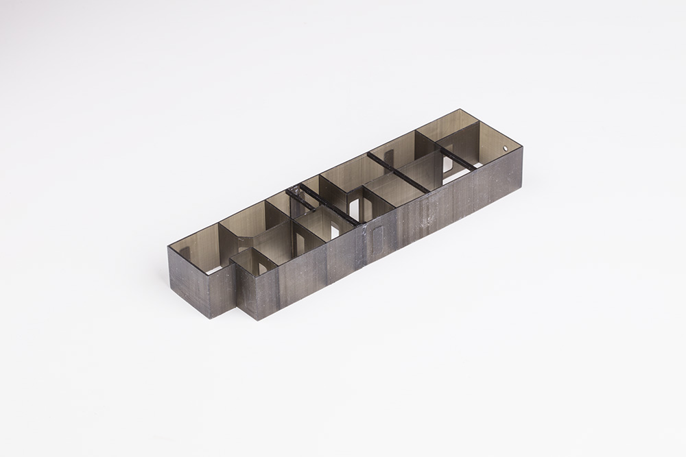

Printing the 01 deckhouse with appropriate compartmentation. However the WT doors are not open. Because of the size, printing in two sections. Joining these pieces, plus the bridge bulwarks (not yet designed) may be a little complex. From photos of Poseidon she had the First Luff's "veranda" decked over (not shown on the Sphinx plans), a lovely spot underway! The Captain's cabin, toward the aft of the O1 deckhouse is surprisingly small and accesses the bridge through a compartment forward and an interior inclined ladder to the charthouse.

The O1 Deckhouse, compartmented, from Starboard Aft. Printed in two pieces as it is too large for my small printer, joined with lap joints.

Tom,
That looks good! Can't see the seams, so you must be doing something right!!

It will get a thin coat of gazing putty to treat the seam when the O2 deck is joined and lightly sanded as necessary.

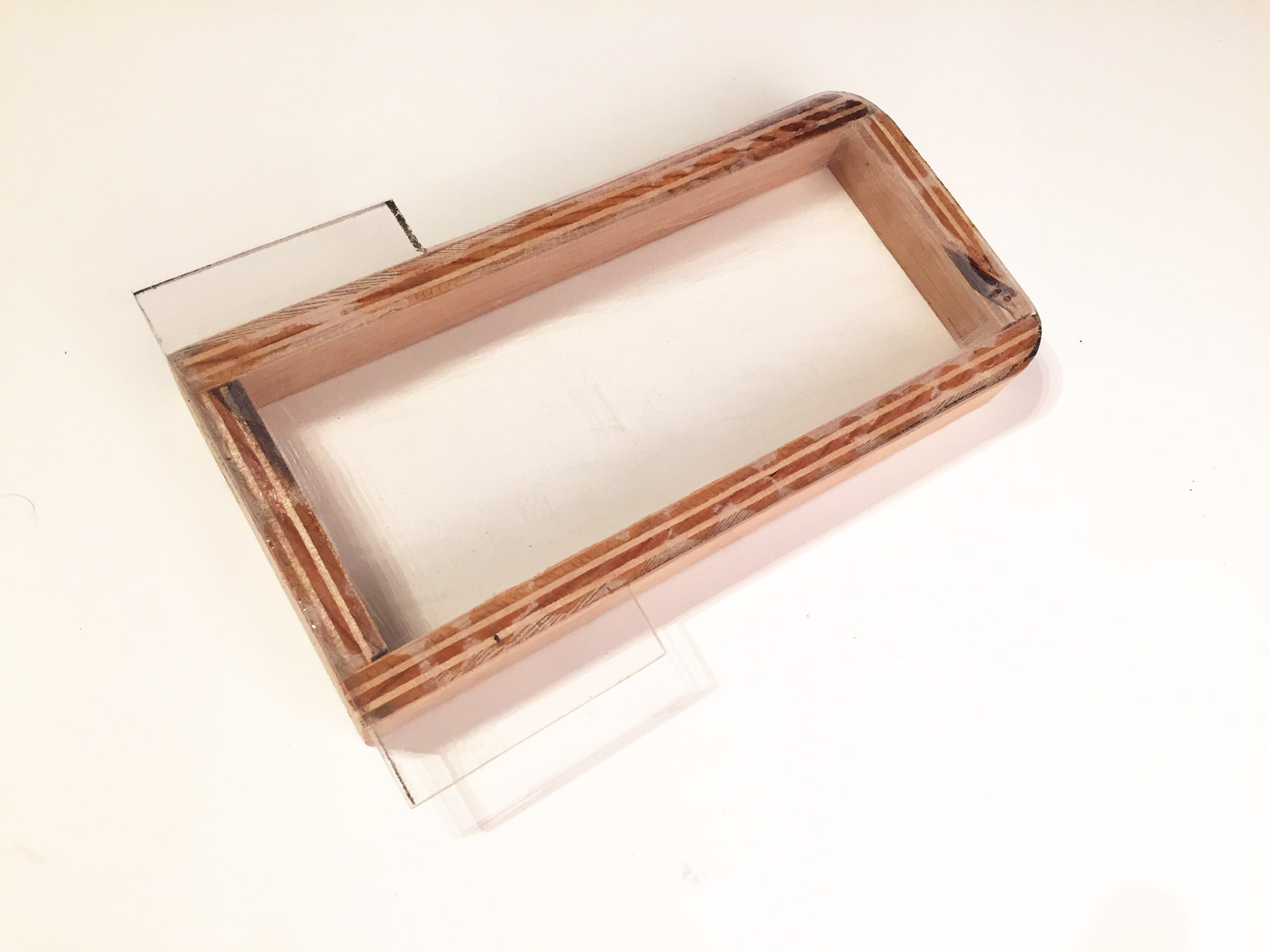

In contrast to Pascal's masterful use of 3D printing, I often revert to my larger woodworking tools. In this little adventure my 500 lb cabinet makers saw and another rather large scroll saw etc. The aft most part of the Poseidon's main deck house is quite simple in configuration. I printed the deck plan with the Silhouette machine and used it as a template to cut the deck out of plexiglas. A little lube is necessary, as well as a slow blade speed to avoid melting the material in the cut. The backing for the bulkheads is wood, cut into appropriate width on the very accurate table saw. This is the same technique I used as the basis for the superstructure of the APA.
A as yet to be determined facing to be used on the bulkheads. I might (might) experiment with the permanent adhesive materials that I can cut with the "Cameo". Otherwise possibly Strathmore paper or maybe thin sheet styrene, if I can find some.
