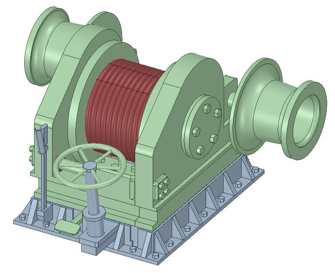

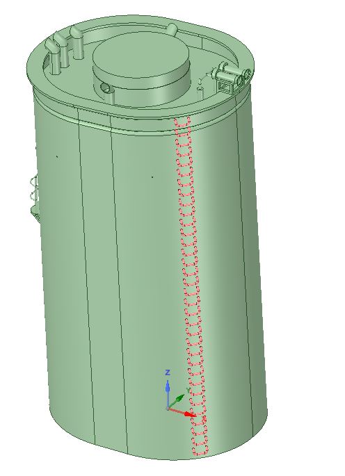

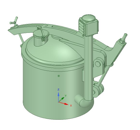

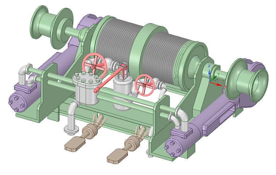

So, just a few of the parts I've been designing/printing and stowing away are:

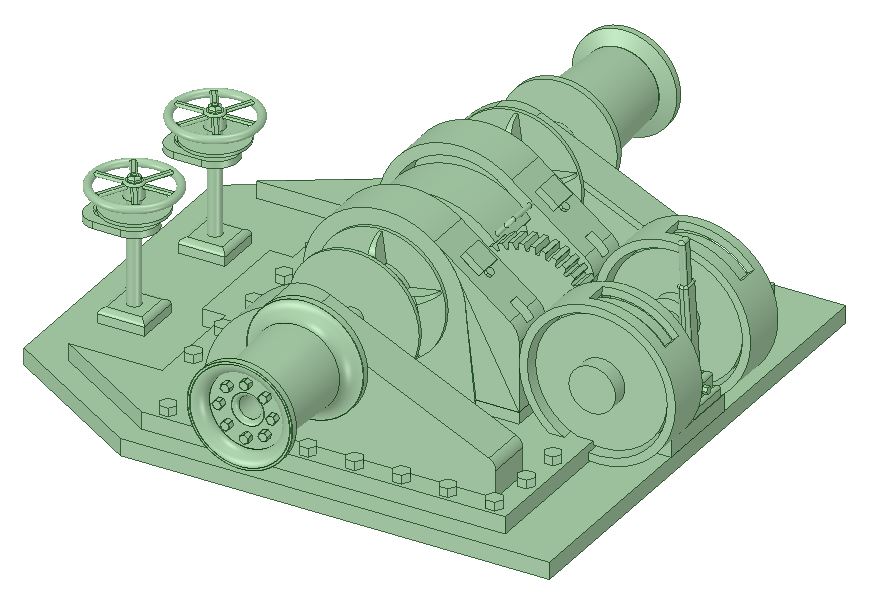

I have quite a few more completed, but this is a good sampling of completed and printed parts. Sorry, my actual parts photos are not quite presentable but I'm working on that. Also, I have in hand a couple of the gun tub assemblies (minus the mounts) which were rather involved in design -

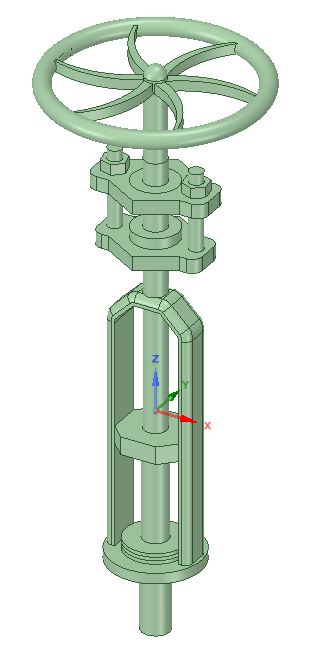

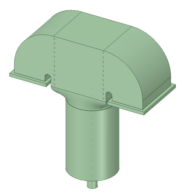

Here are a few more items I've also designed/modified/printed and stowed away:

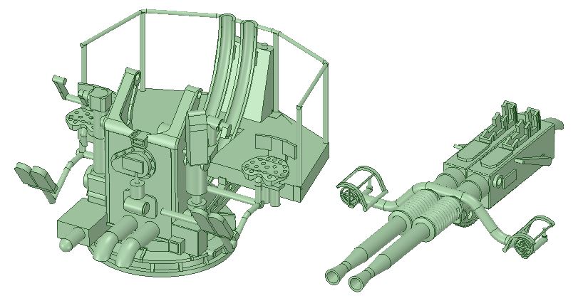

As you said, I do find designing these items and seeing the result is quite satisfying (much like the self or instant gratification of Gen. X a few years back :sleepy: )
