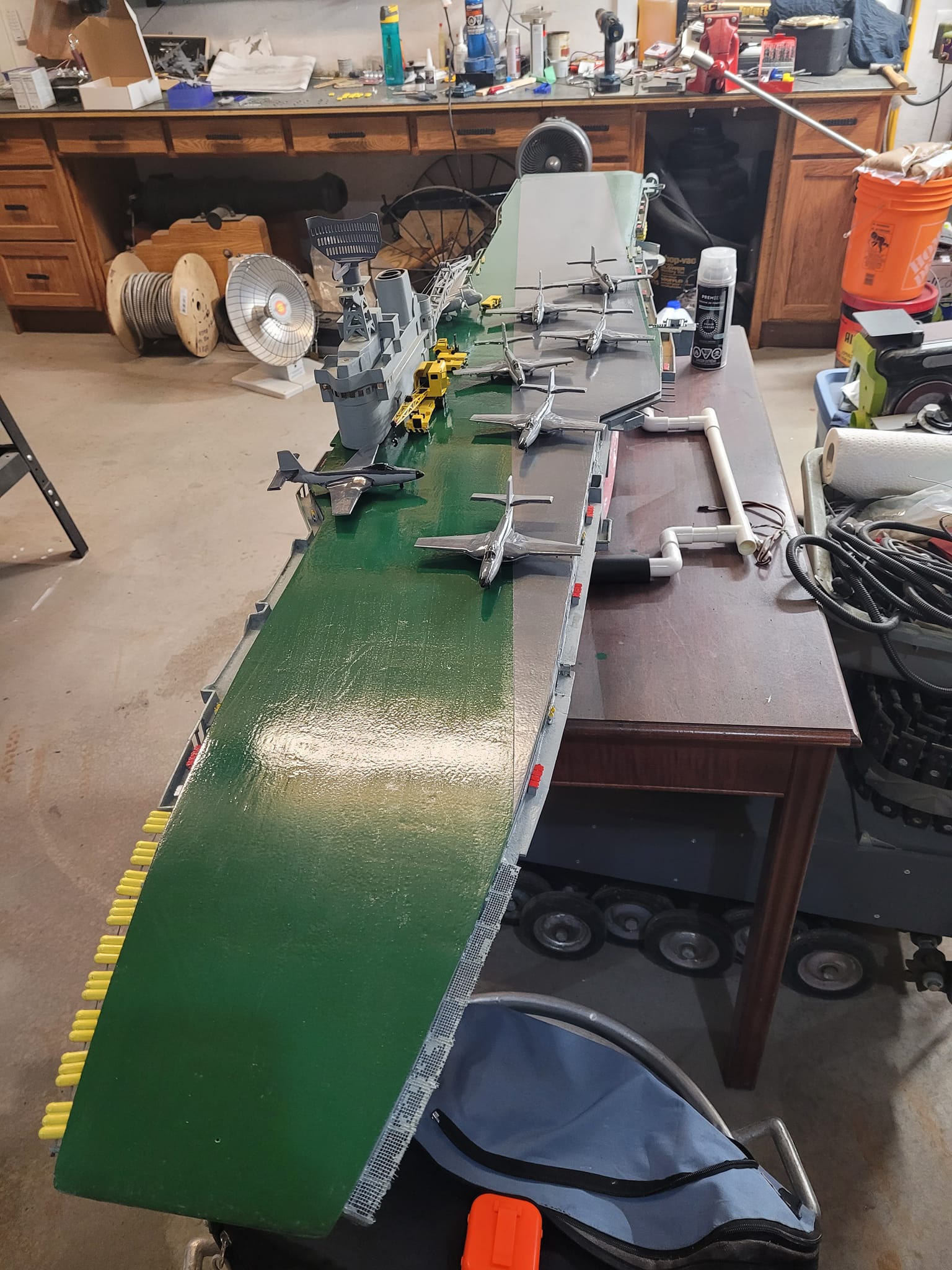

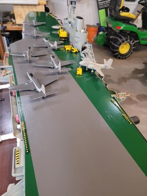

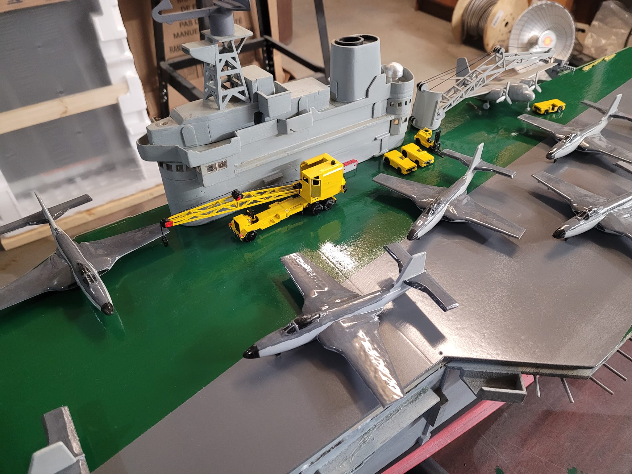

The bubbling flight deck seems to have been defeated at last.
3 light coats, and a couple of weeks of drying time.

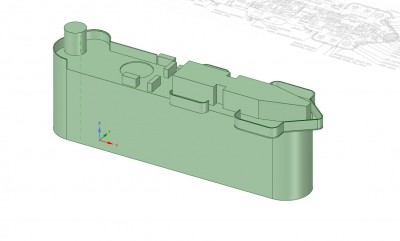

Basic layout, and the details gets added from here!

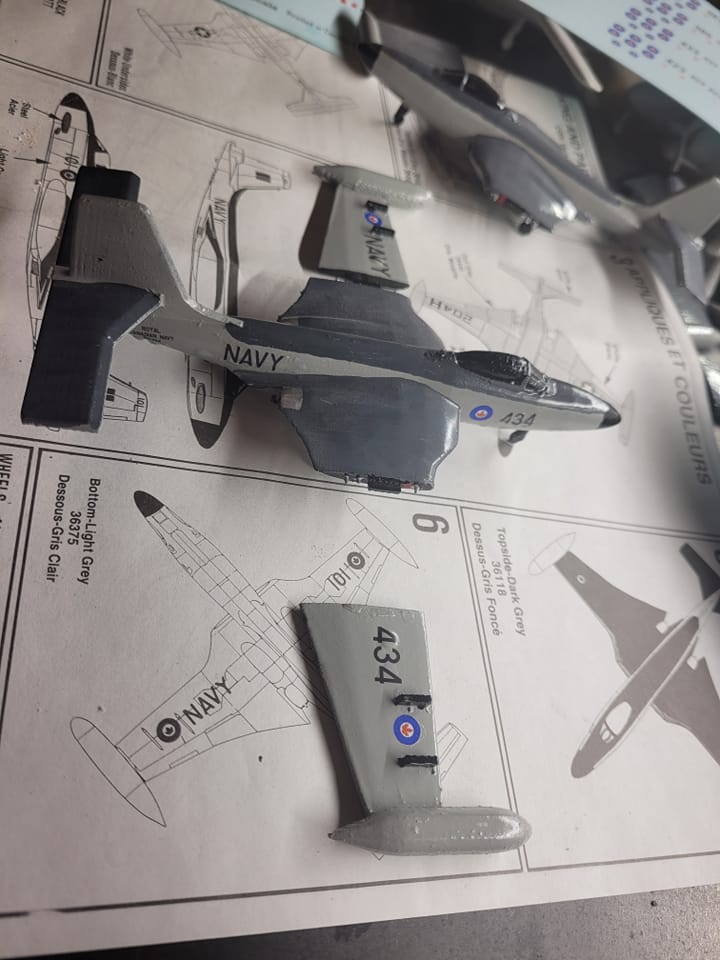

So, I decided to try my hand at putting some decals on....and here's the result. This Banshee is the first of 8 that needs a decal treatment, and I spent about an hour and a half putting these ones on - there's more to come yet.

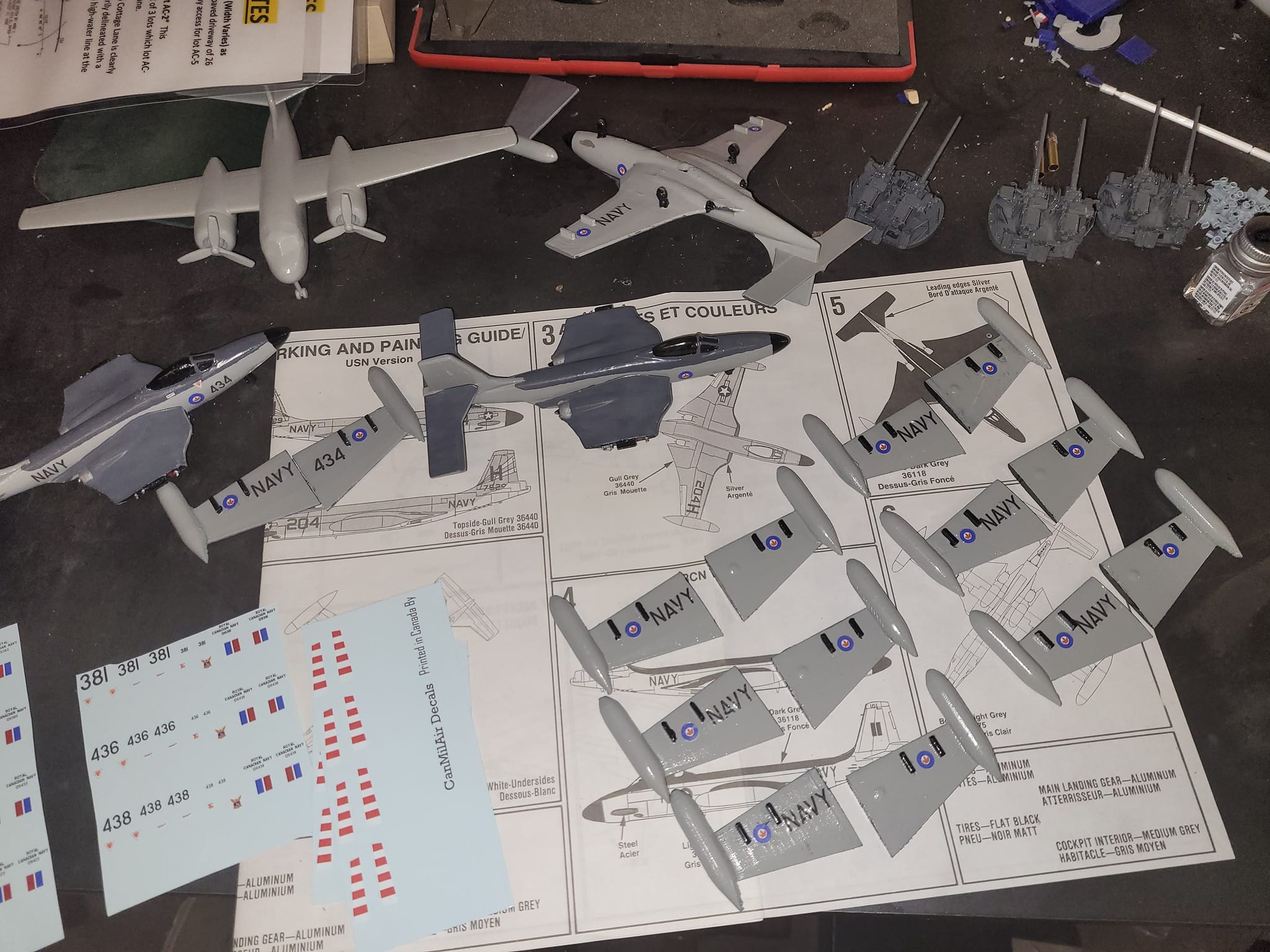

I went to a production line system for the decals....wow....there's a lot of 'em!

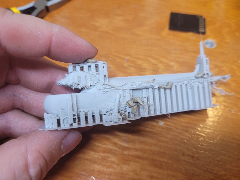

Here's a picture of the first failing print - you can see scorch-marks on the rear of the flight deck of the Bonnie in this little 3D printed model of her.
Then you can see the real failure - the H04S print where things really...well...fell apart.
The bodum tube on the printer was leaking a bit of filament out the top, which was puddling on top of the heater, and then dripping randomly onto the model while printing...what could possibly go wrong there, eh?
New parts arrive tomorrow.

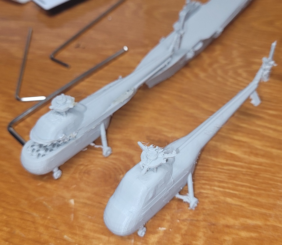

A couple of hours of work last evening with some fiddly bits on a printer (mostly because I didn't bother to read instructions...) then another hour of sorting out alignments, and I have my printer back online again.
Here is the new/improved HOS4 print!
Not perfect, but adding some rotor blades and some paint will make it the best 1/96 scale versions of these available!

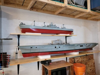

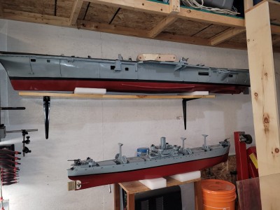

Last night I got a couple of hours of work done in the garage - you can see that I put the Bonnie up on the wall temporarily.
She's actually on the Liberty Ship's shelf, but I was working on the Liberty ship last night and needed the bench space.
There will be another lower shelf coming for the Bonnie soon!

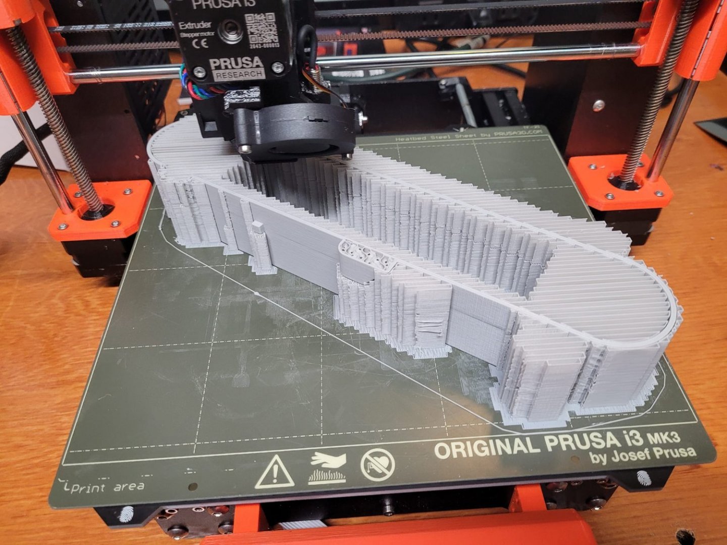

I printed Version 5 of the Island last night - it'll be done when I get home from work today.
Some supports to knock off, then it should be good to go!

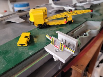

I also finally got around to printing off the landing light platform - here it is in all it's glory! I'm pretty pleased with how this looks!

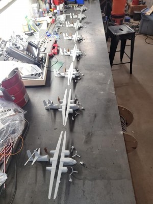

And...for my next trick....I have some new 3D printed Trackers that need to be assembled, painted, and detailed.
I know that the Trackers usually have 'issues' with being tail heavy, so the plan is to put a lead/copper weight in the nose area (I'll drill a 0.30 hole into them, insert, and glue the 'weights' that I have handy) to give them some home of staying on the deck properly.
Getting the Liberty Ship's new rudder on last evening and getting ships up on the wall means that I actually have space to work on my bench...and having recently cleared out some furniture from my youngest minion's bedroom from my garage, I actually have some space again. Life is good!

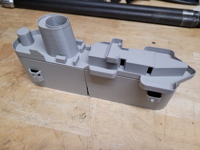

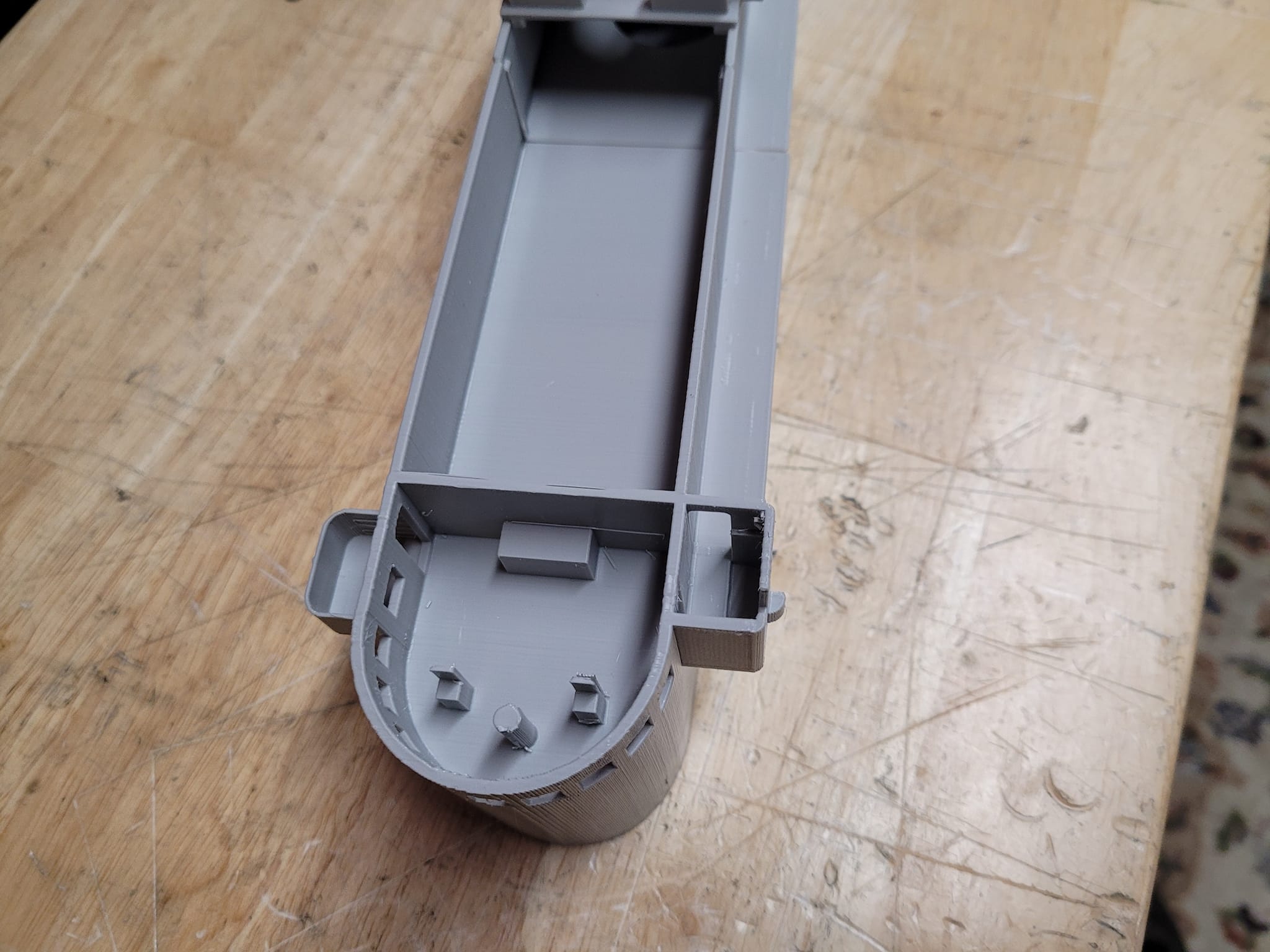

Well, I printed off a smaller version of the Island and gave it to a friend for his use and feedback. He's working on a 1/350 scale Bonnie from scratch.
He pointed out that I got some dimensions wrong somewhere/somehow.
In 1/96 scale, it's 29mm short.
That was...a bit of a shock. I thought I might have been out 3-4mm (thickness of two walls) but nope...turns out I'm 29mm off.
Not quite back to the drawing board...I scaled the whole thing up by 11% and that seems to have fixed most of it...it's now 2mm too wide...which is, literally, the thickness of the walls...so...I'm sticking with it.
I spent this evening fixing some other issues with the model, and have generated new print files. Unfortunately, it's now too big to print in one piece, so I'm having to slice it up and will end up gluing it together.
Alas!
On the other hand, having it the right size is a good thing.

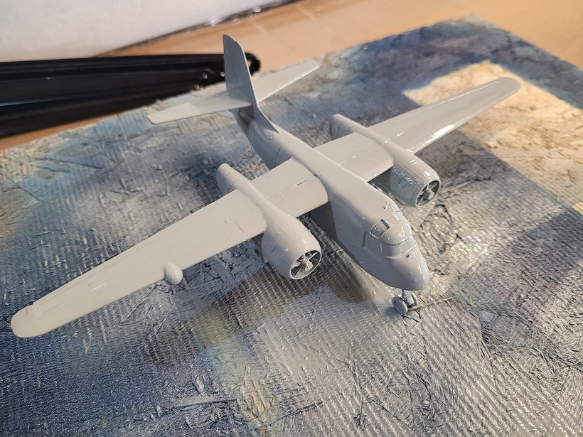

So, some additional printing has been going on in the background, and things are progressing.
The Air Det is my current focus - and the Trackers have center-stage for now while I'm printing a new Island.
I've finished assembling and painting them. Each aircraft received approximately 15 grams of lead/copper in the nose to provide some weight, and to balance them so that if they're tipped back onto their tails, they'll return to resting on the nose gear properly.
I also spent a few minutes last evening, having finished the last layer of varnish, and put up the 'boat rack' for the Bonnie - an 8 foot x 16 inch plank on the wall of the garage so that I can get her up and off the work-bench to provide me some work-surfaces to use!

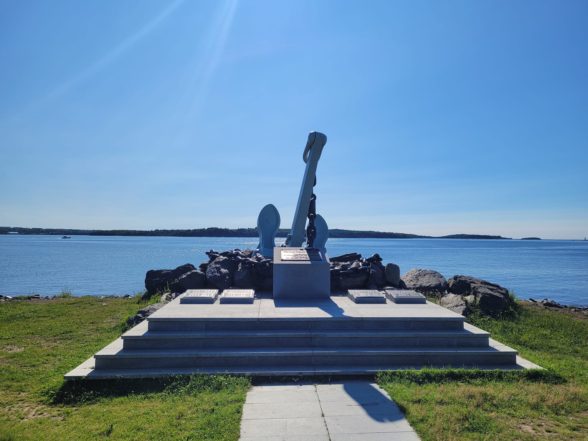

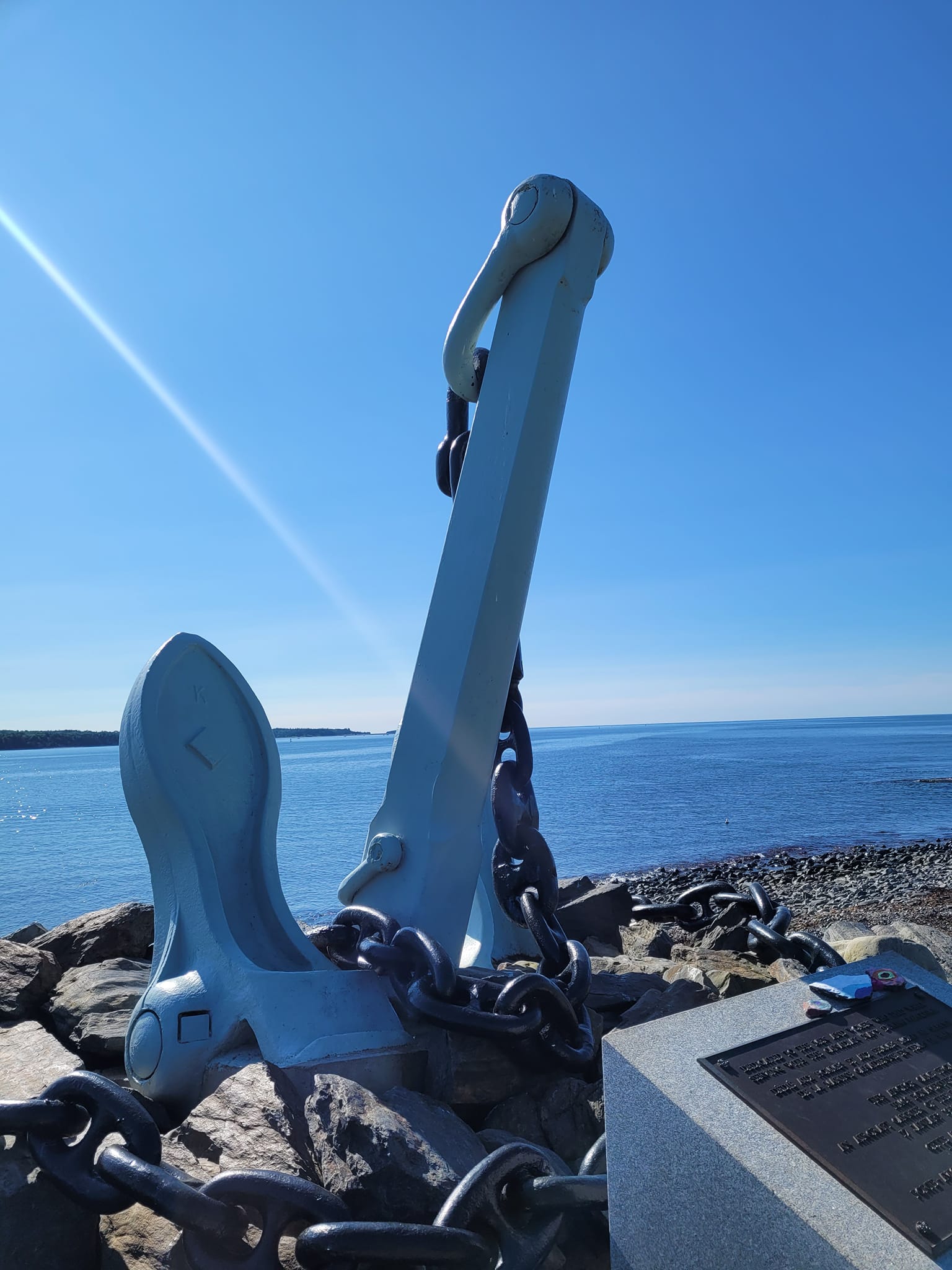

I did get out yesterday though to have a look at an Anchor.
It's the sailor's monument to those lost at sea during the Cold War. I stopped and paid respects, including to a shipmate that we lost in 2005 north of Poland. Really neat thing about the monument is that the anchor cable is both fouled, and then leads off into the ocean, a lasting connection to those lost at sea.
If you look carefully at the information plate though, you'll see that this is a special anchor...it's one of HMCS Bonaventure's Anchors.
So...the model builder in me then pulled out my tape measure and took some dimensions...I now have a new set of anchors ordered, and some new anchor chain!
Then it was off back to the renos...
