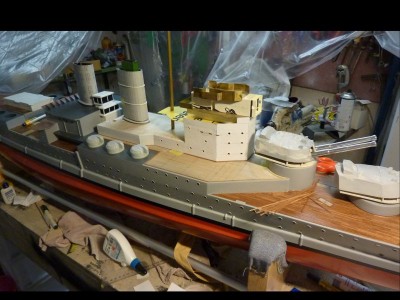

Dear friends,
the 1/100 scale meeting at Gelsenkirchen on 21st September is coming closer very fast - Renown is registered for maiden trip.
Disadvantageous, time is running due to some family celebrations and a friend´s sickness what´s all stressing my time. But here is a little progress of my tries to make Renown presentable...
Best regards from (sitll-) Dortmund!
Joachim

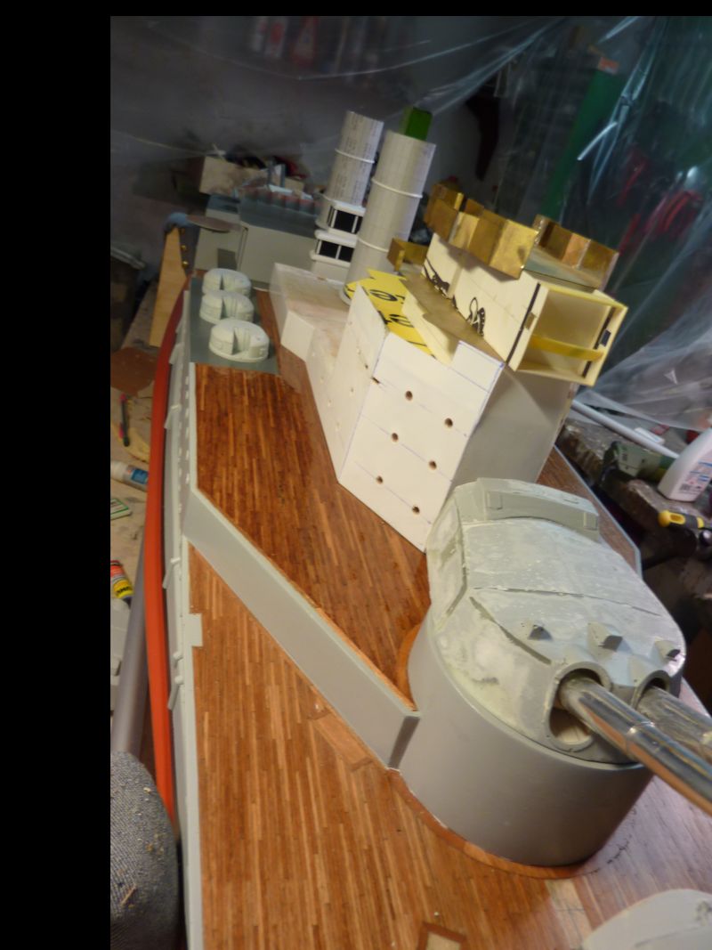

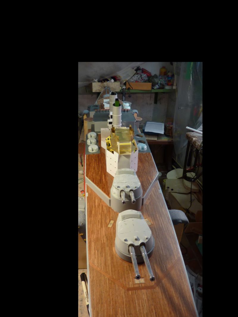

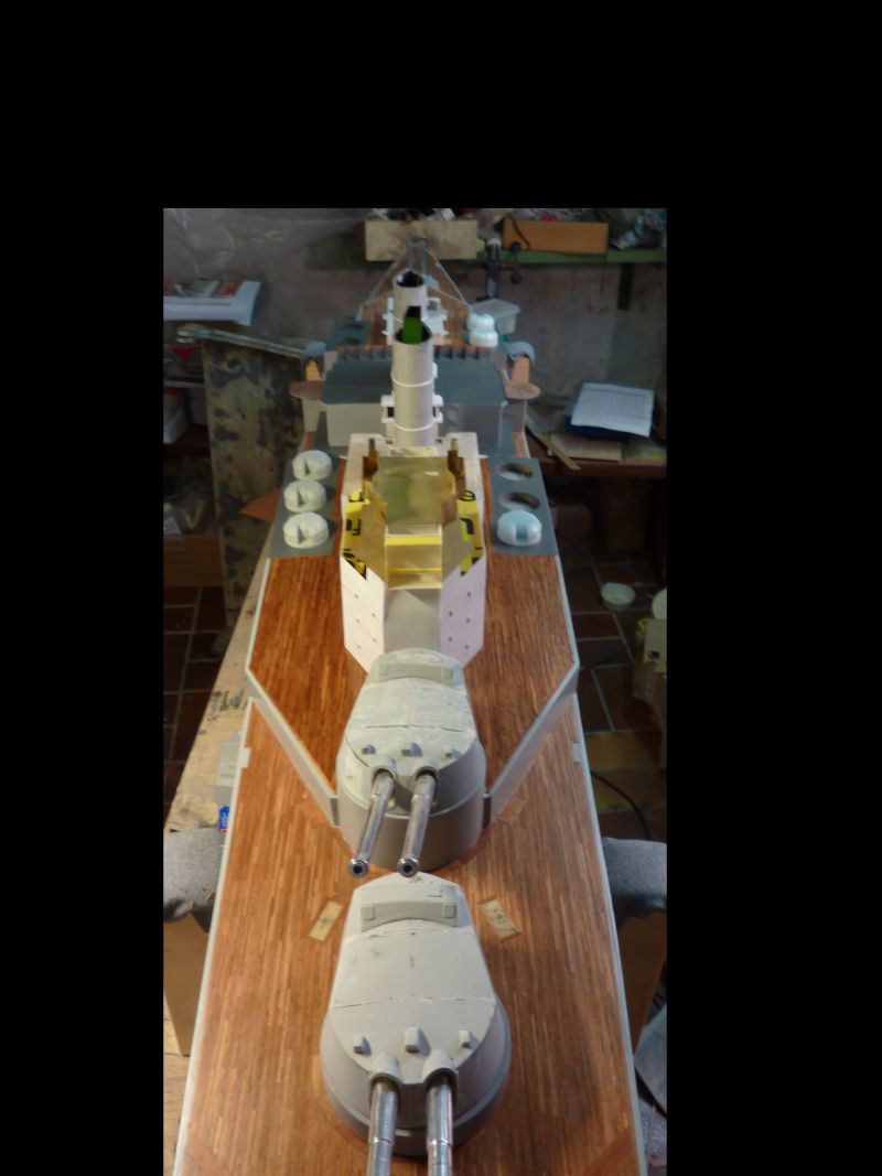

Dear friends,
the next step is done, the last deck is planked. Hope I get the superstructure screwed together until the fleet meeting on 21st of September in Gelsenkirchen...
Works continue on the funnels, so next update will be coming soon!
Best regards from Dortmund!
Joachim

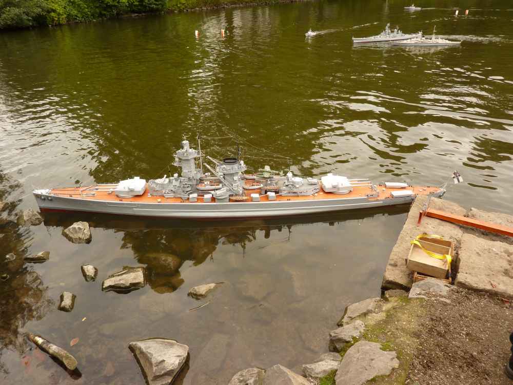

today was really great: First time "all ahead", Renown on the water bigger than Mommie´s pond. It´s been the "Flottentreffen" in Gelsenkirchen, almost 50 ships in 1/100 scale and many others, as a Graf Spee in 1/50!!
Renown performed very well, except a little lazyness in turning. But hey, she´s a big lady with almost 36 kilogrammes;-)
She is hungry, too, consuming 17Ah in a bit less than an hour. So I will take out one of the to leadbarrels and add another accumulator. So more power and time - as many functions are still to be added as smoke, position lights and maybe movement of the 11 in barrels. Turning of turrets A and B is already working very well!
So have a look and enjoy!
Happy regards from Dortmund!
Joachim

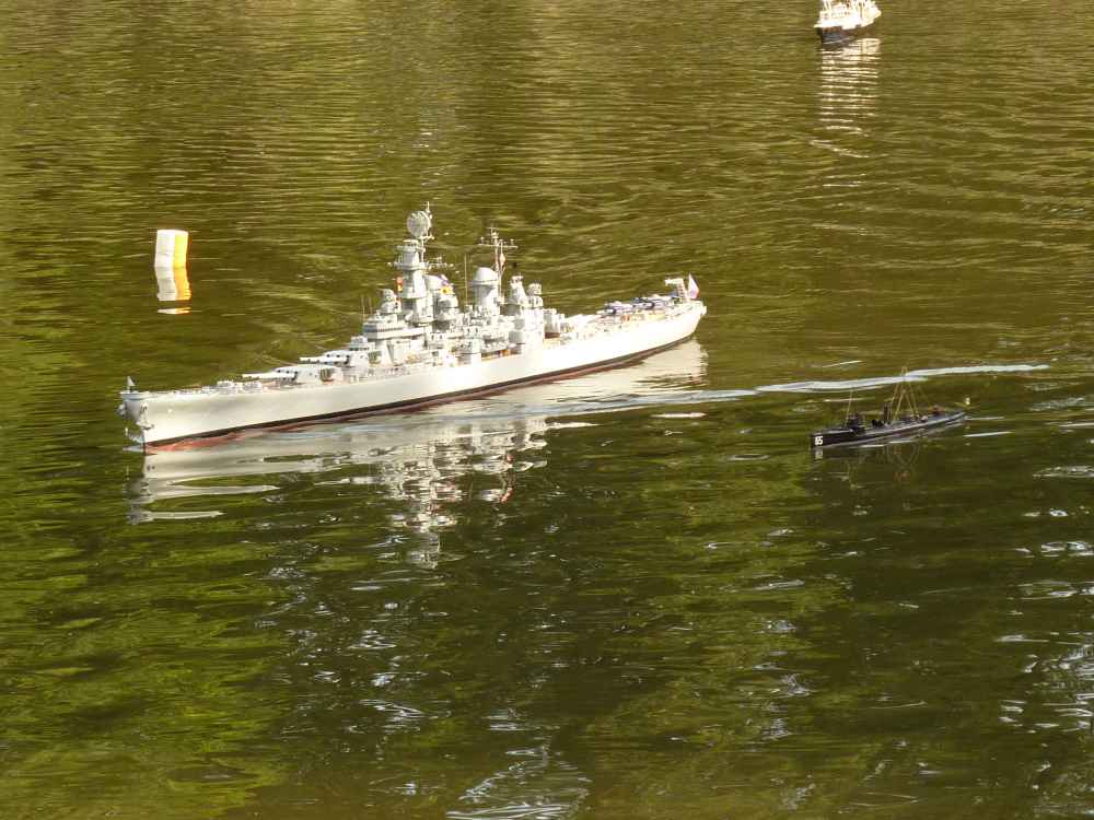

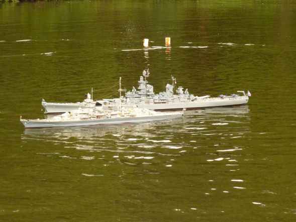

here are some more pics, not only of my "Baustelle" :-)
File comment: Missouri and Prinz Eugen
File comment: Salvage Tug Seefalke, still alive at Bremerhaven Museum

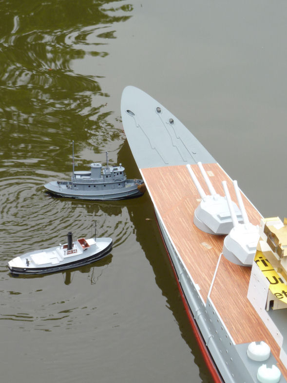

and some more:
File comment: Graf Spee in 1/50. 3,76m. 120 kg... a fat lady:-)

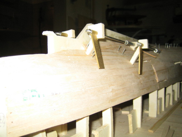

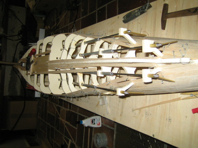

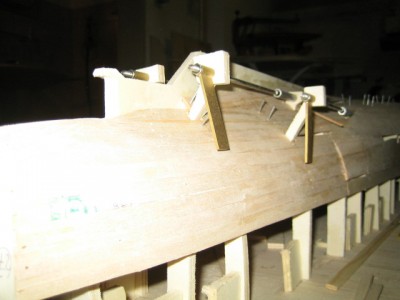

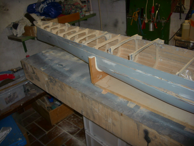

Hi Björn,
let´s see what I have found concerning older pics...
I tried to copy the bulges right together with the frames and decided not to add them later on. Covered with glassfibre it was a lot of filling and sanding to achieve a sharp result.
Keep on searching for some more pics!
Best regards
Joachim
