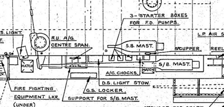

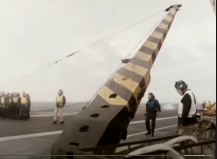

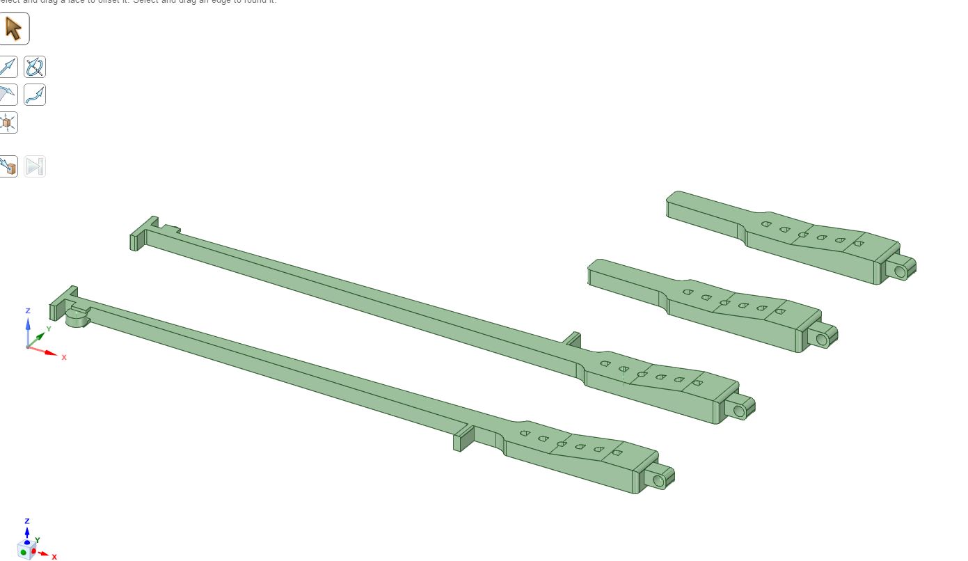

Well, after some initial frustrations, I found a couple of good youtube instructional videos and have spent a few more hours fiddling about with Designspark.
Here's my first 'project' at Version 1. The Crash Barrier support arms.
The design is based off the screenshot from a youtube video showing carrier operations on a British aircraft carrier from 1975, and from the ship's diagram that I have showing an overhead view with both a long arm and a short arm crash barrier as shown in the image.

Those came out pretty well, though as I am sure you know, we can design all sorts of intricate things in scale that won't print successfully. Those look pretty straightforward. I think I remember you printing with filament, unfortunately I have no experience with this method wit regards to capabilities. Aside from the mess, a big disadvantage of SLA printing is a reduced print size.
DSM is a solid design program which has advantages and disadvantages. You are also designing the interior dimensions if there is one and to the degree an item can be hollow of solid. In the real world of printing this can be advantageous. Every program has it's necessary workarounds.
Keep plugging away. This may change the trajectory of you project because of what you can do!

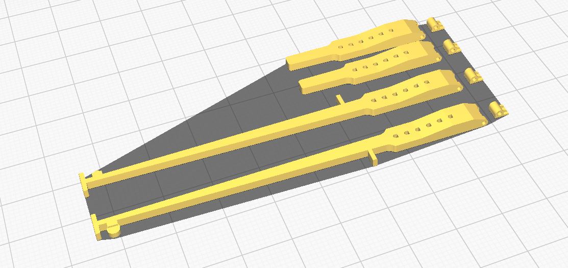

Well, apparently this will take just 36 minutes to print. We shall see how it goes!
I have to say thank-you for pointing me towards DSM, it's got a lot going for it. I'm still at the point of figuring stuff out, but with some youtube tutorials going in the background while I'm puttering away at other things, I am seeing steady improvement in my skill, and this program is SOOOO much more capable than TinkerCAD.
I suspect you're right that this will take me to another level - I'm pondering re-drawing some of my existing models and having a go at re-doing them, but realize that can be a 'later' thing. For now, there is SOOOO much detail that I can add to an Aircraft Carrier, moving forward, it will be better.

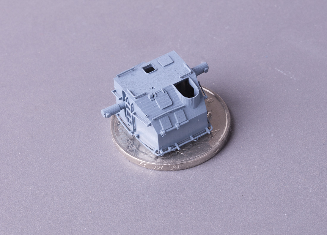

Grabbed this one out of the spares box, MK 37 director with cupola. I did these appropriately with and without cupola for 1:192 Missouri and Alaska. Trying to do these (which I did) with rails and whatnot by analogue means is somewhat trying. These are done with Phrozen Rapid Black Resin, which I like for detail. It did leave some very minor stepping on the glacis. A soupier resin would not do this but would have less crisp detail. I did do a version of this with the officers hand slewing device (Phil would know the proper name).
Sitting on a 2 Ruble coin (worth about $.03 US). As these can be printed fairly thin walled, I did contemplate doing the interior.
Possibilities are endless.
Tom

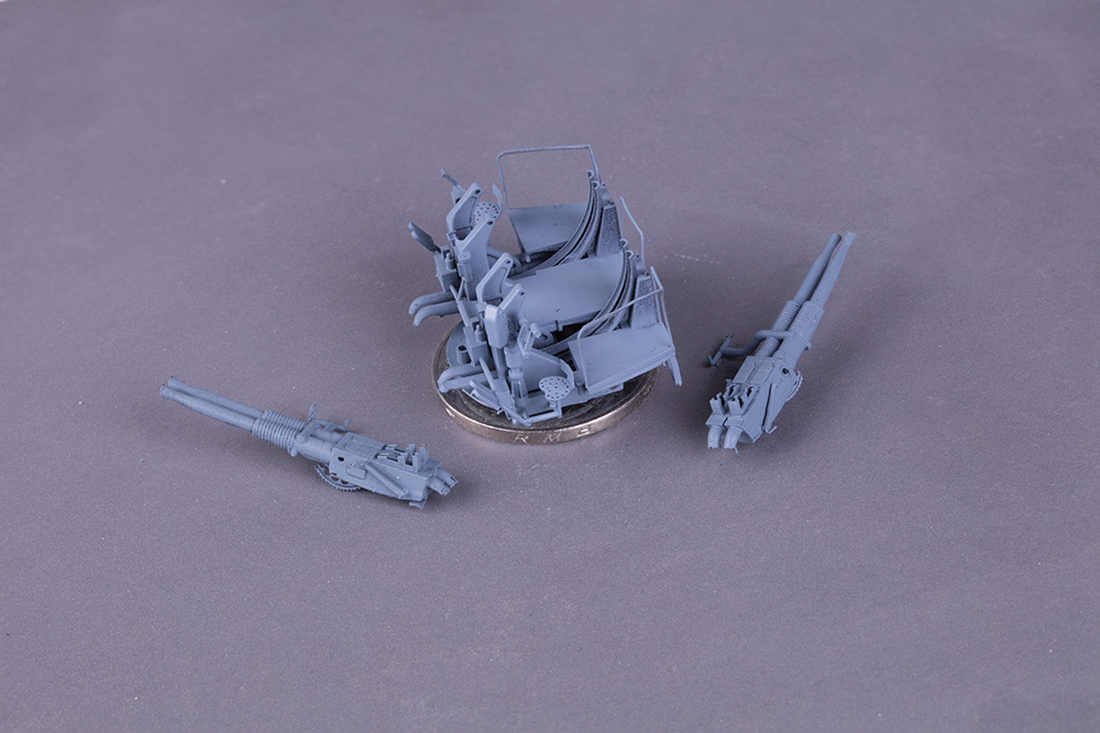

Top is a quad Bofors that I printed for the APA (1:120). This could be printed with the barrel units on the trunions or separate. An advantage for separate is easier placing and removal of supports, disadvantage is some fussiness of assembly. There is also a shield that can be added as I did for the ARL. I printed a large number of these in 1:192 for Alaska, with shields and barrels in place.

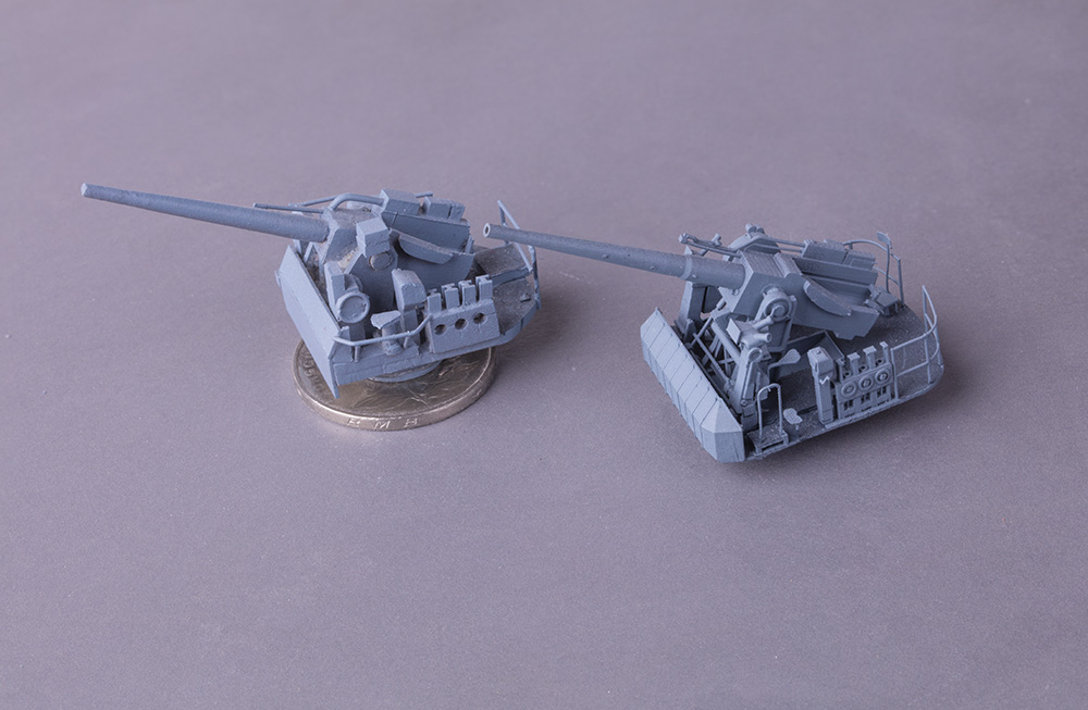

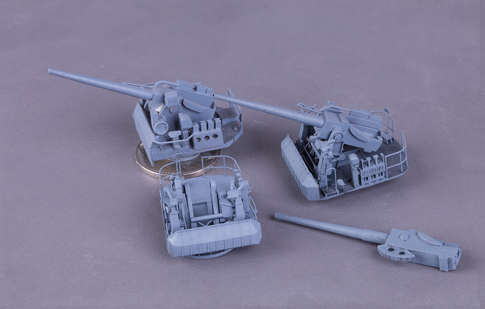

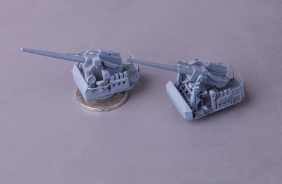

The bottom two consider a 5" 38 open mount that I built for the APA (1:120). The original hand built which I replaced is for comparison to the 3D model. I printed these as separate barrel and carriage for the same reasons as the Quad Bofors. The one's used on the models have some additional paint such as deck blue, black Bofors barrel unit sections etc.

Looking good. Still, personally, I would probably go for turned barrels in combination with 3D-printed parts. Rotation symmetric parts seem to turn out crispier that way.

As a note, the left barrel is turned on the handmade piece and the right barrel is printed.

OK, didn't say anything ... the printed barrel actually looks rather good :thumbs_up_1:

I do agree that brass barrels turned by an expert machinist, such as yourself, are superior. I have a small lathe, but not a jewelers model and have turned some barrels, but I find such small thin, long items somewhat problematic and have a certain failure rate. Certainly I could not turn successfully 40 mm barrels in 1:192. With some forethought one could print a barrel and tune it up on the lathe. However such could not be attached to the receiver and would have to be separate pieces. For most of us, having a wide variety of techniques, each most suitable for the task at hand is best. For instance the Laser cutting seems like a good technology. In a somewhat similar manner I have used the stencil cutter for making masks for hull numbering and even some superstructure members that would have been cut from sheet metal. It does have the capability of cutting styrene and balsa but I have not experimented with this as yet.
