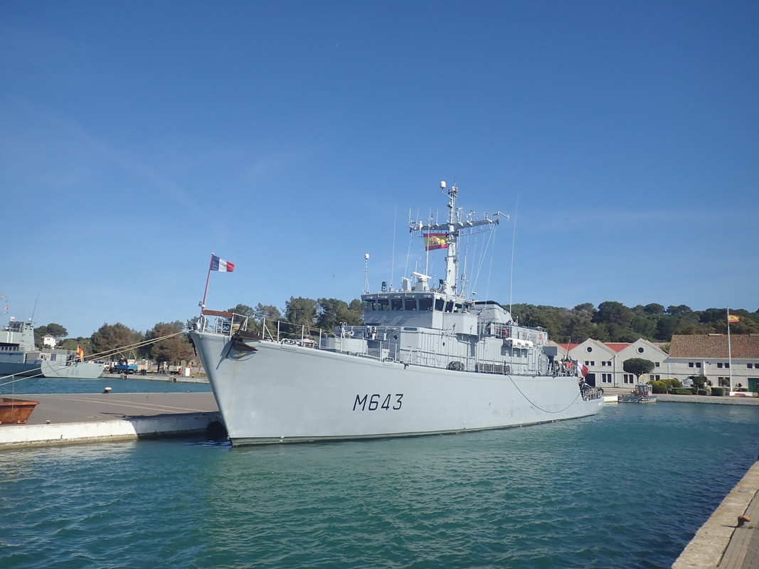

The Tripartite type, or in France the Eridan class, is a series of 35 minehunters designed according to a joint project by the Belgian, French and Dutch navies, ratified by the Chiefs of Staff of the three navies on December 9, 1974.
The Andromède, hull number M643, is a French Navy Tripartite-class minehunter. Its home town is Issy-les-Moulineaux.
Its missions are to “detect, locate, classify, identify, destroy or neutralize mines in water depths ranging from 10 to 200 meters, guide convoys under threat of mines, penetrate the sea and search for wrecks”.

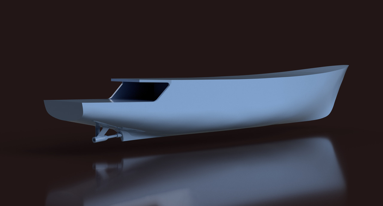

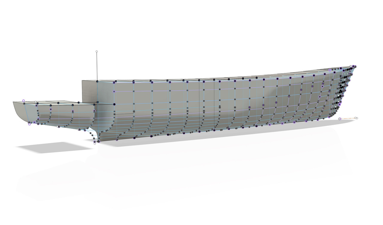

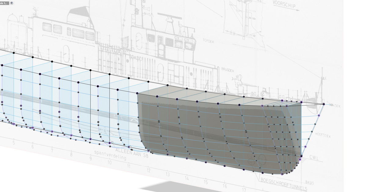

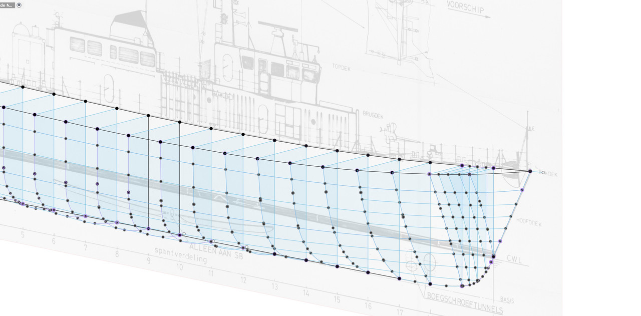

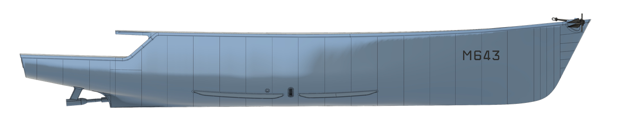

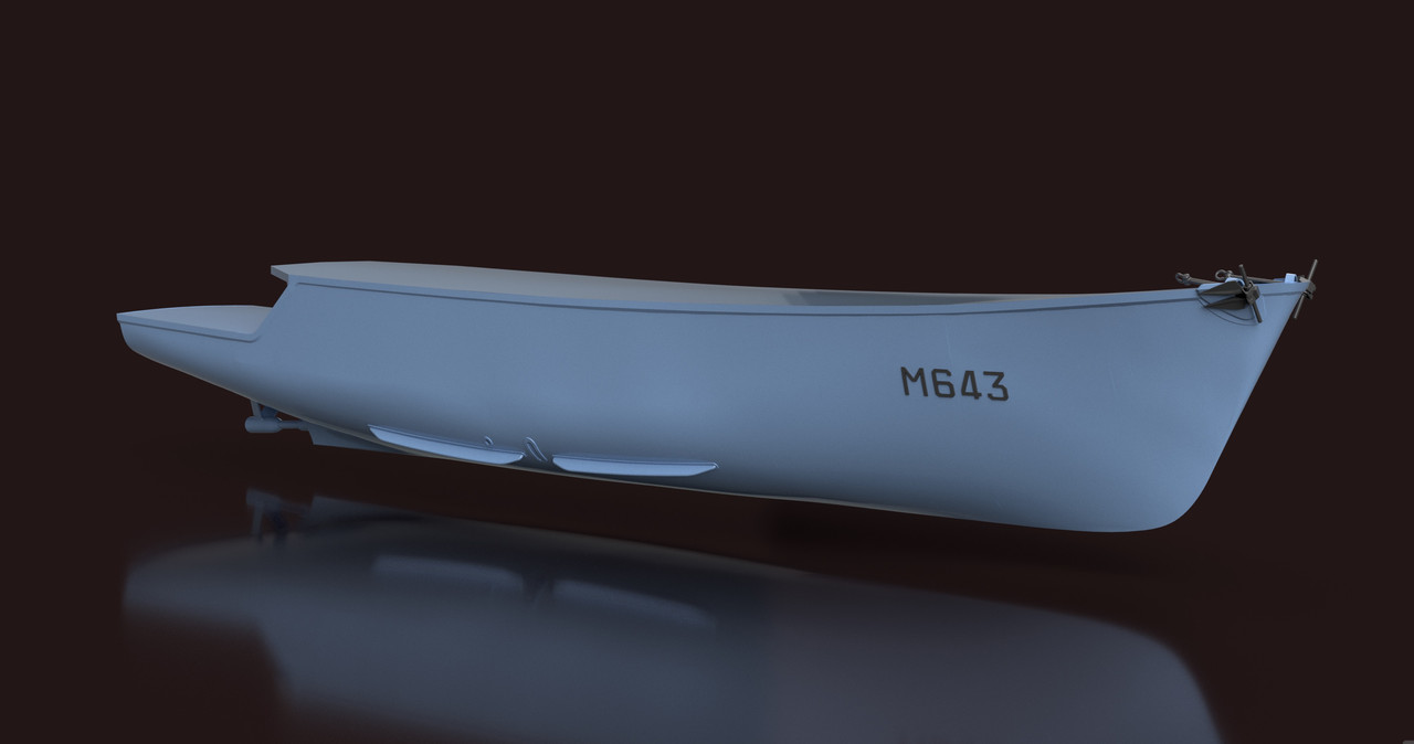

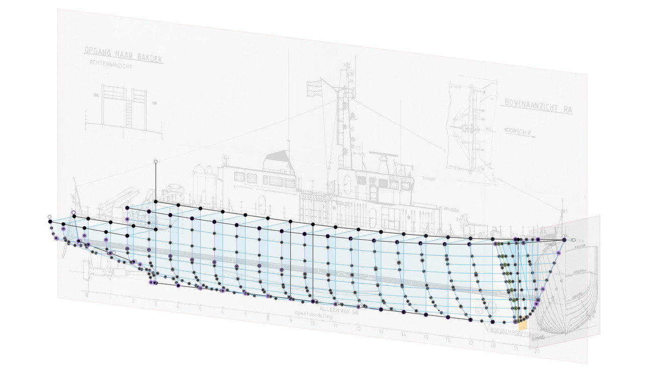

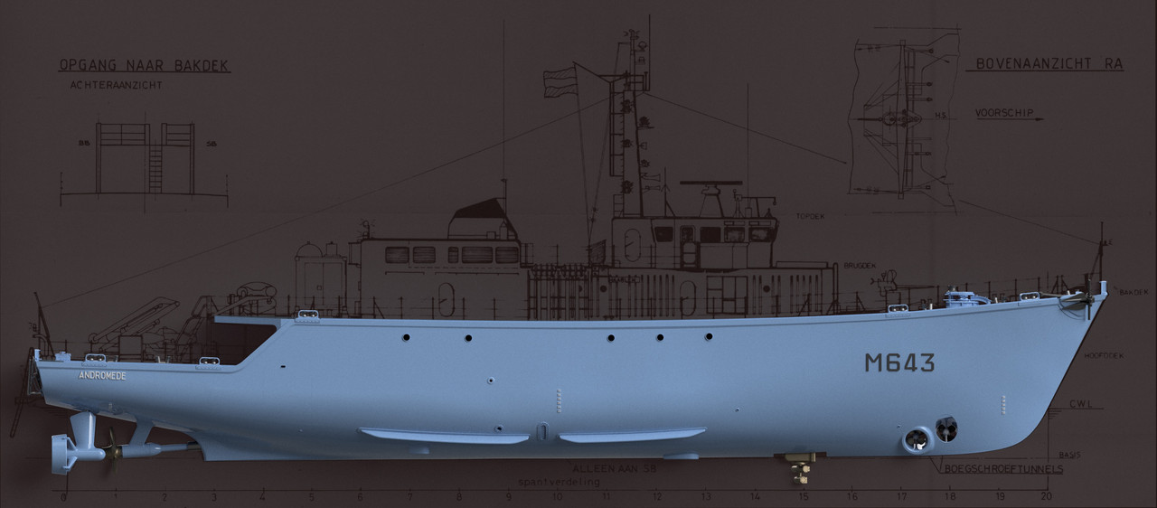

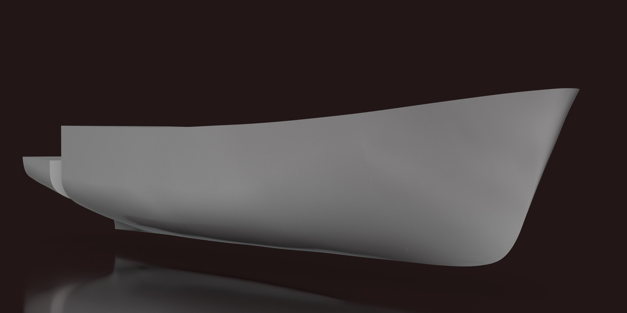

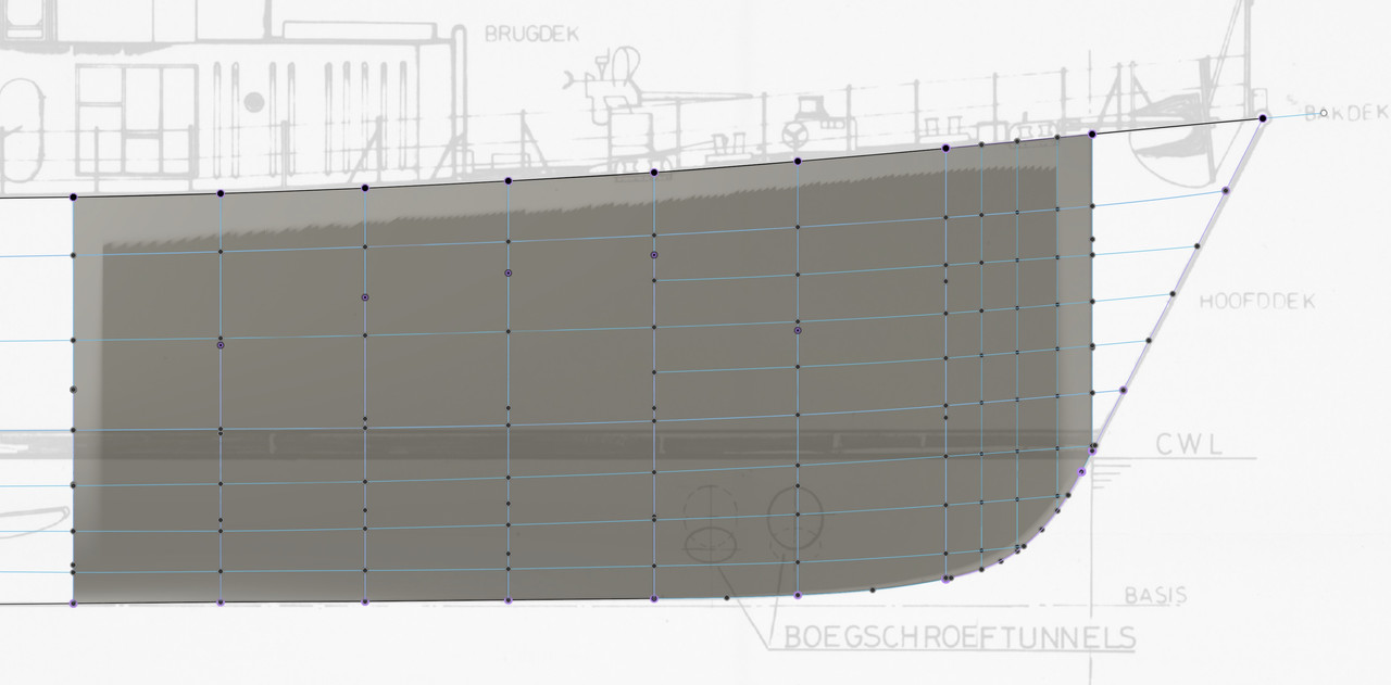

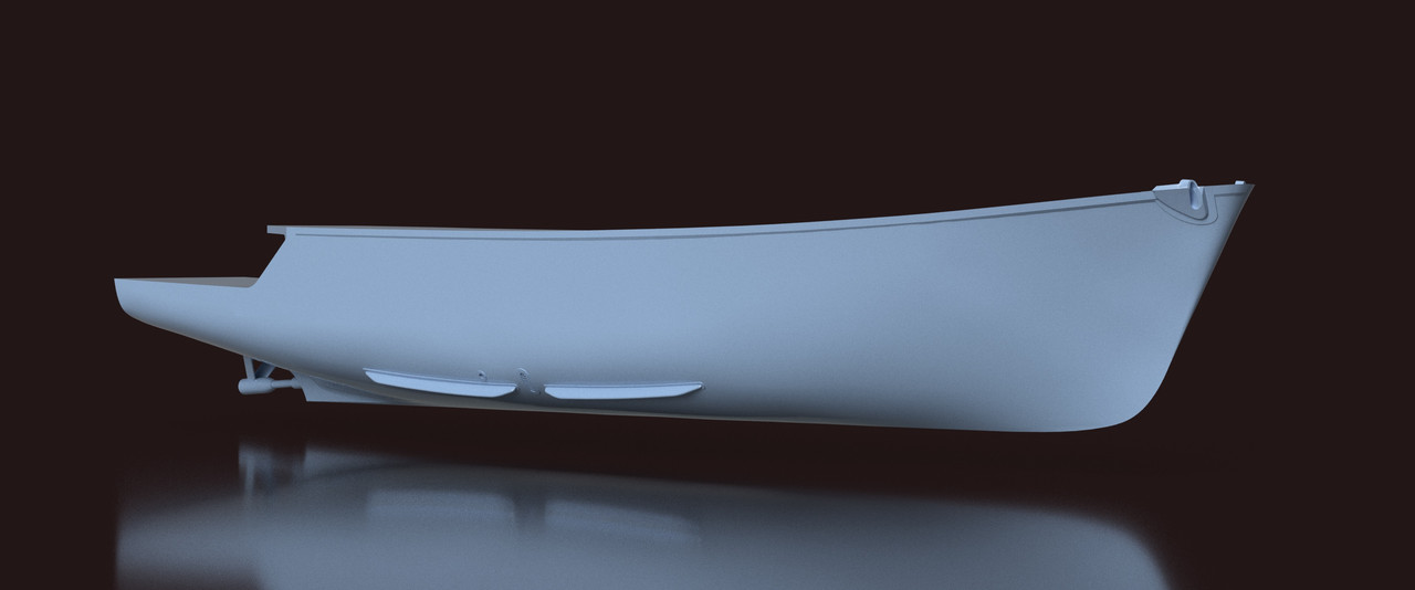

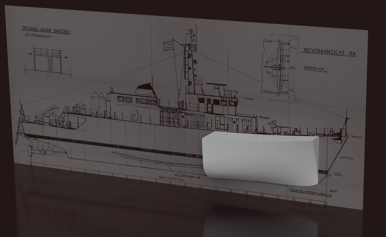

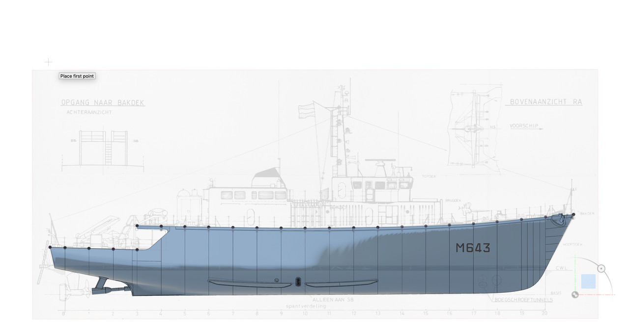

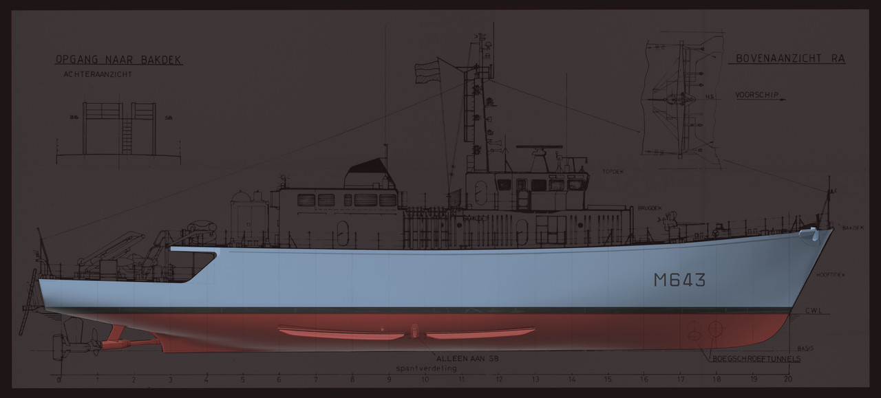

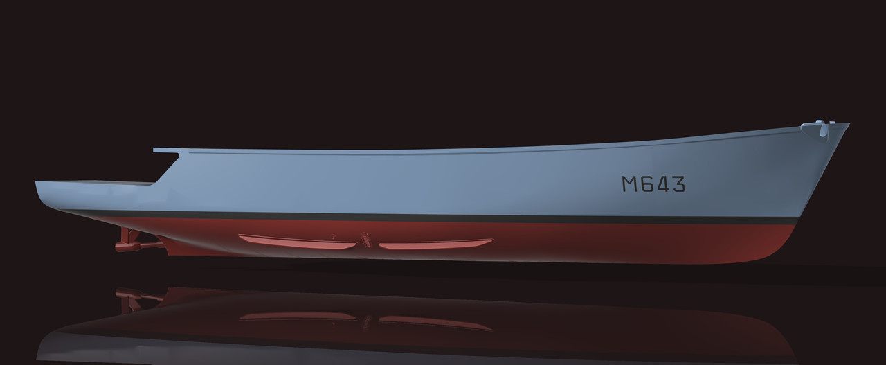

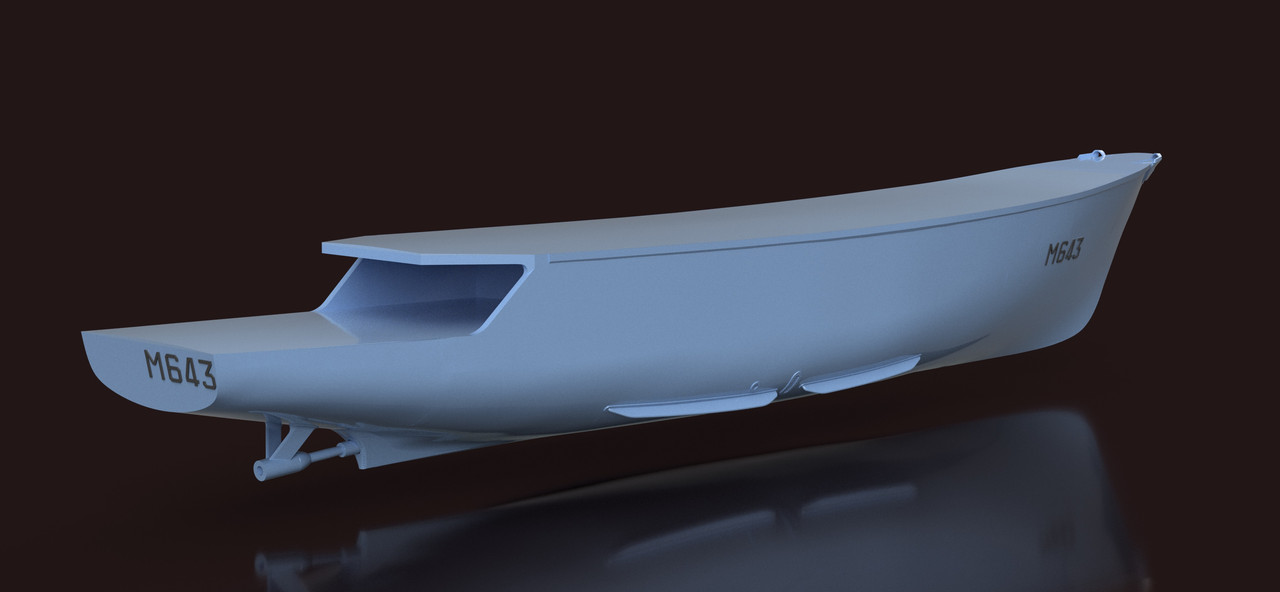

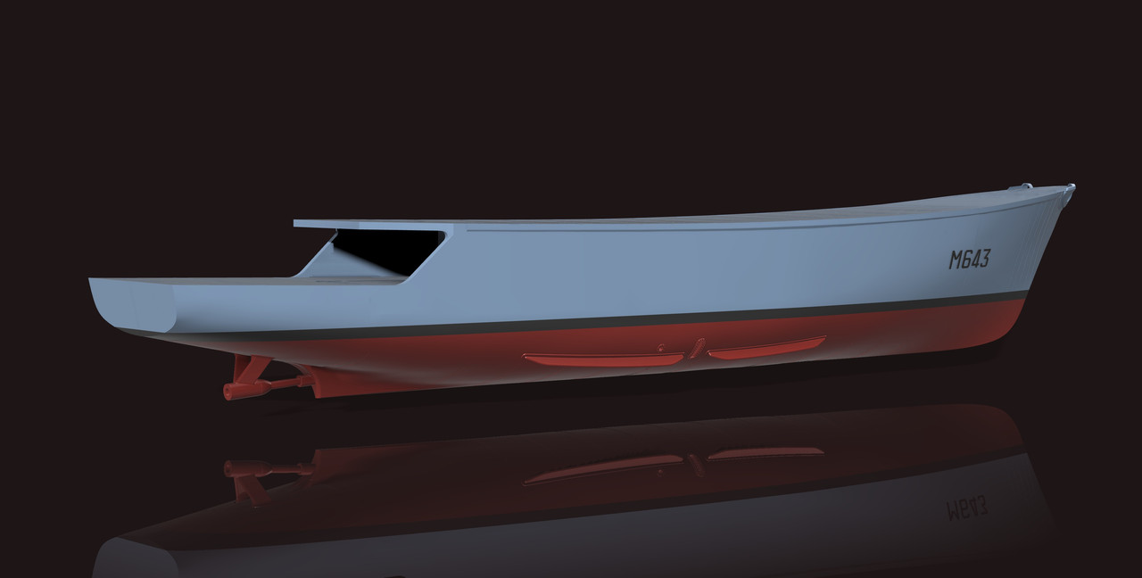

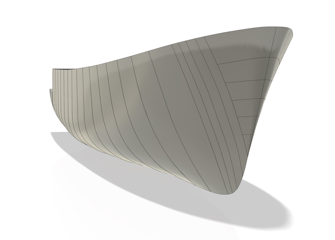

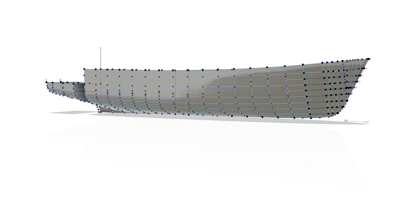

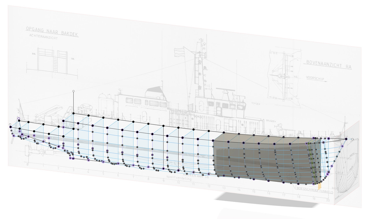

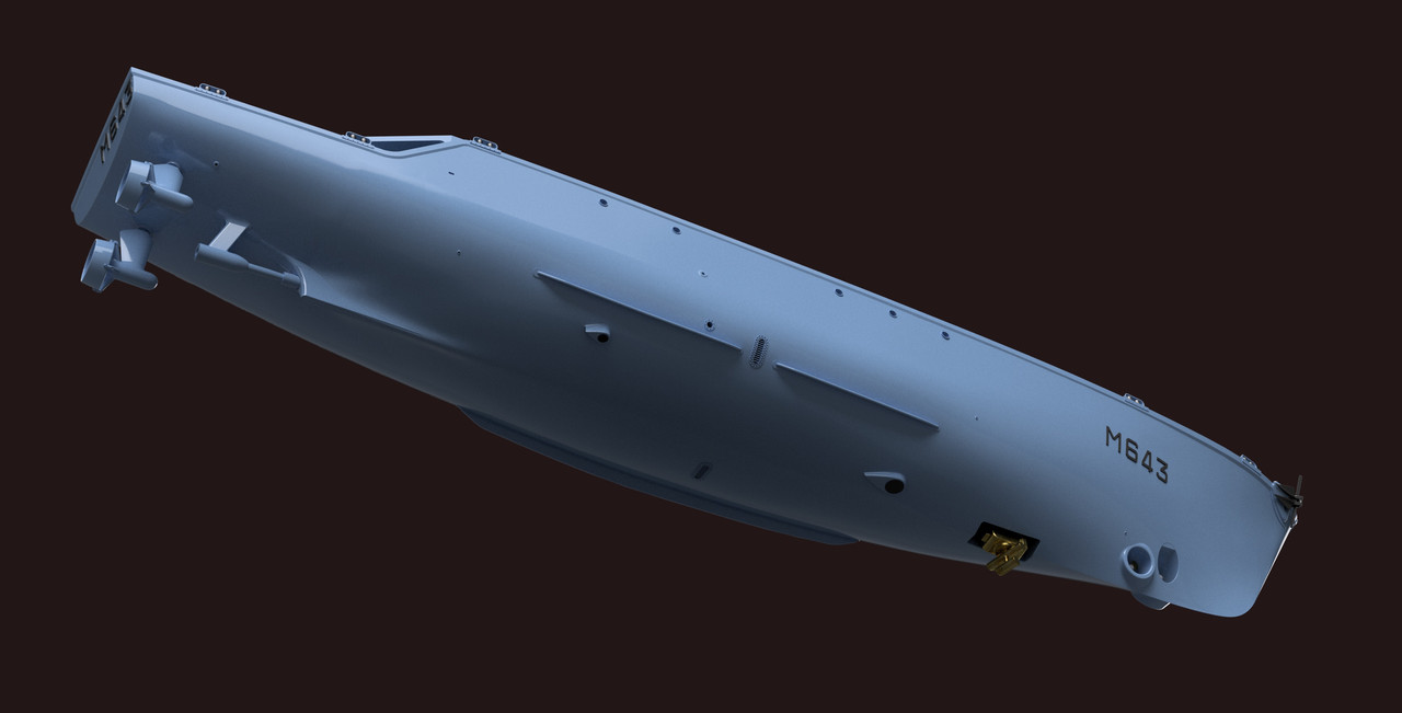

I started the drawing a week ago, having put the Shell Welder on hold for a few days due to the death of my mother-in-law at the end of November to avoid embalming the house with paint smells, so this project came just at the right moment to keep my mind occupied.
The hull of the ship is quite simple. I'm drawing at 1/144, but a 1/100 version, my preferred scale for this size of ship (51 cm long at 1/100), will also be printed for me.
Here's how far I've come in just a few days:
Pascal

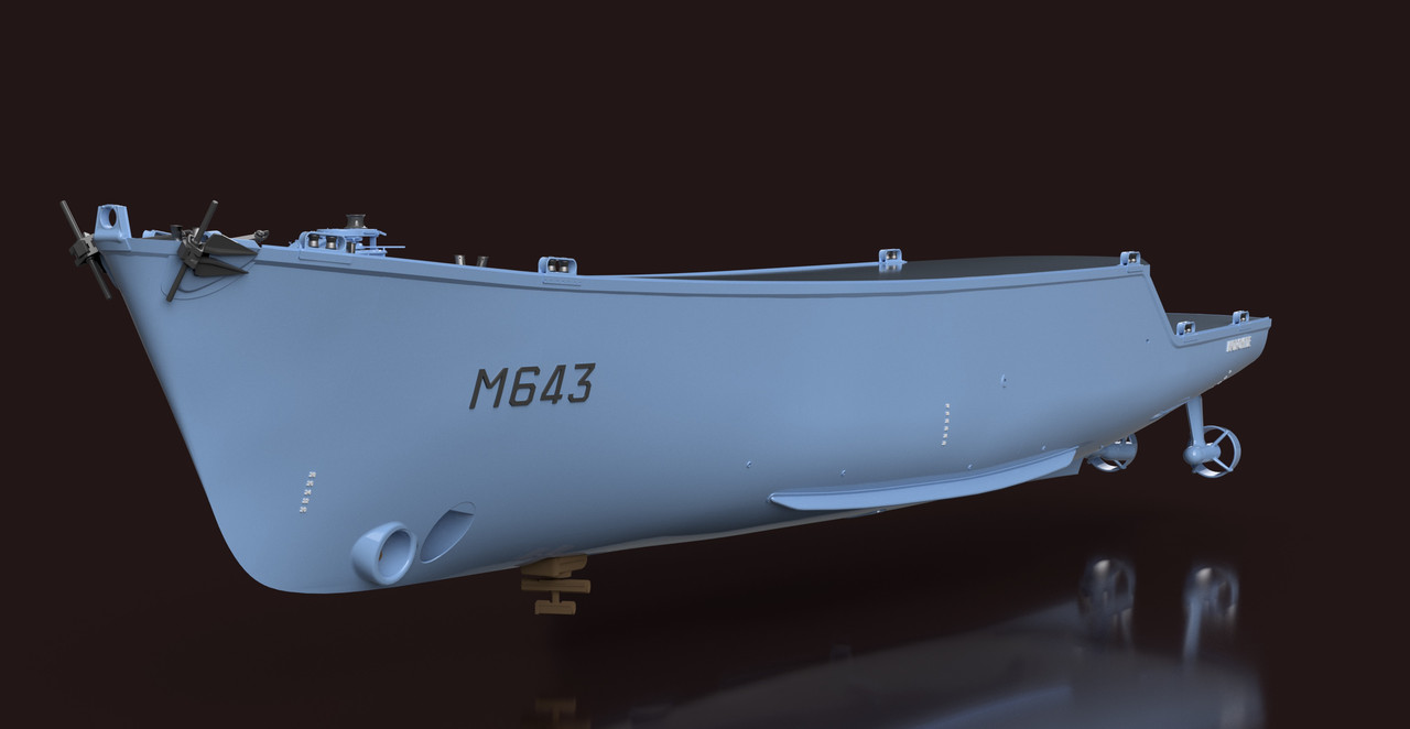

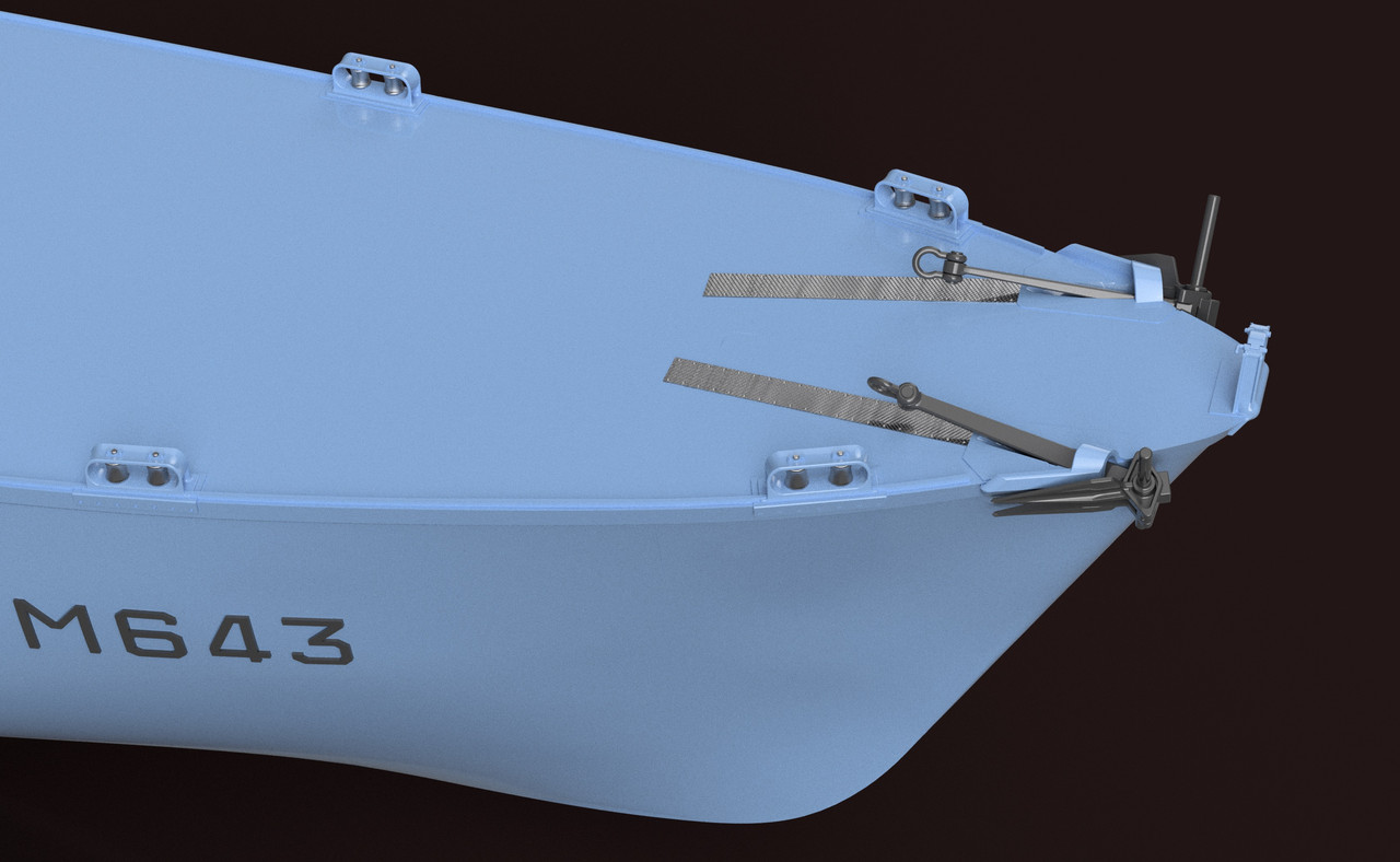

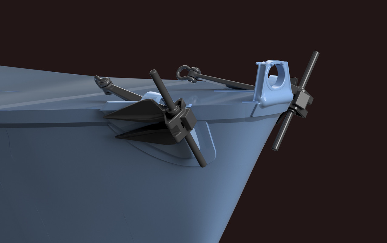

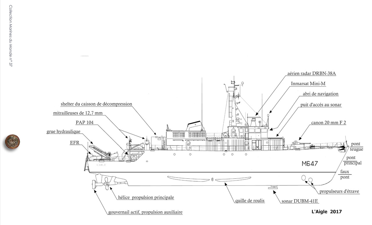

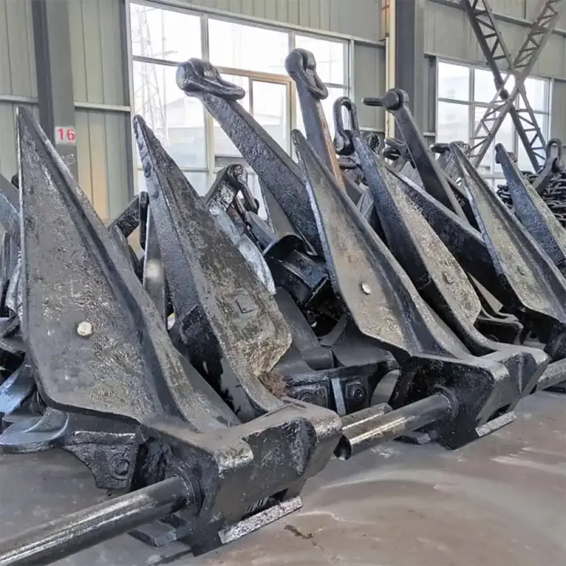

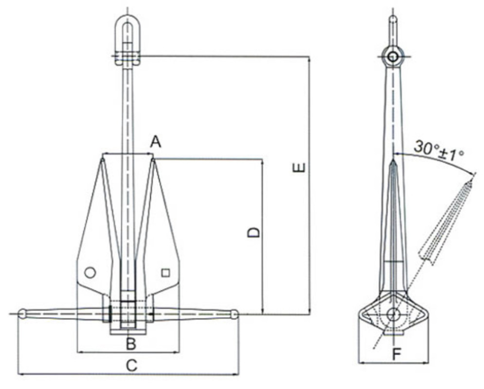

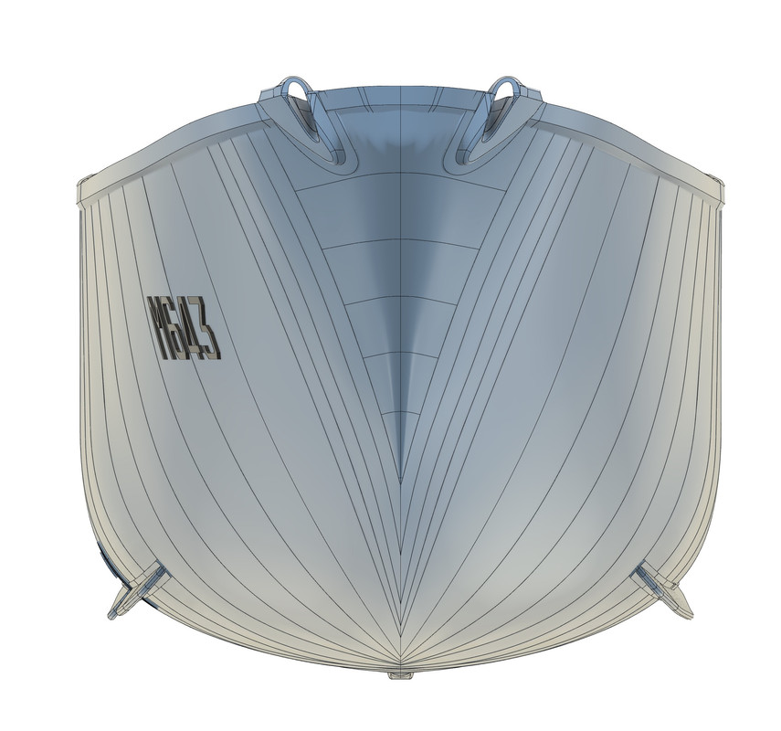

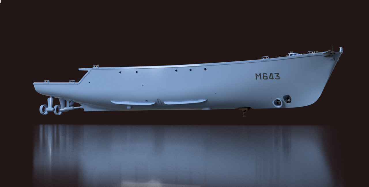

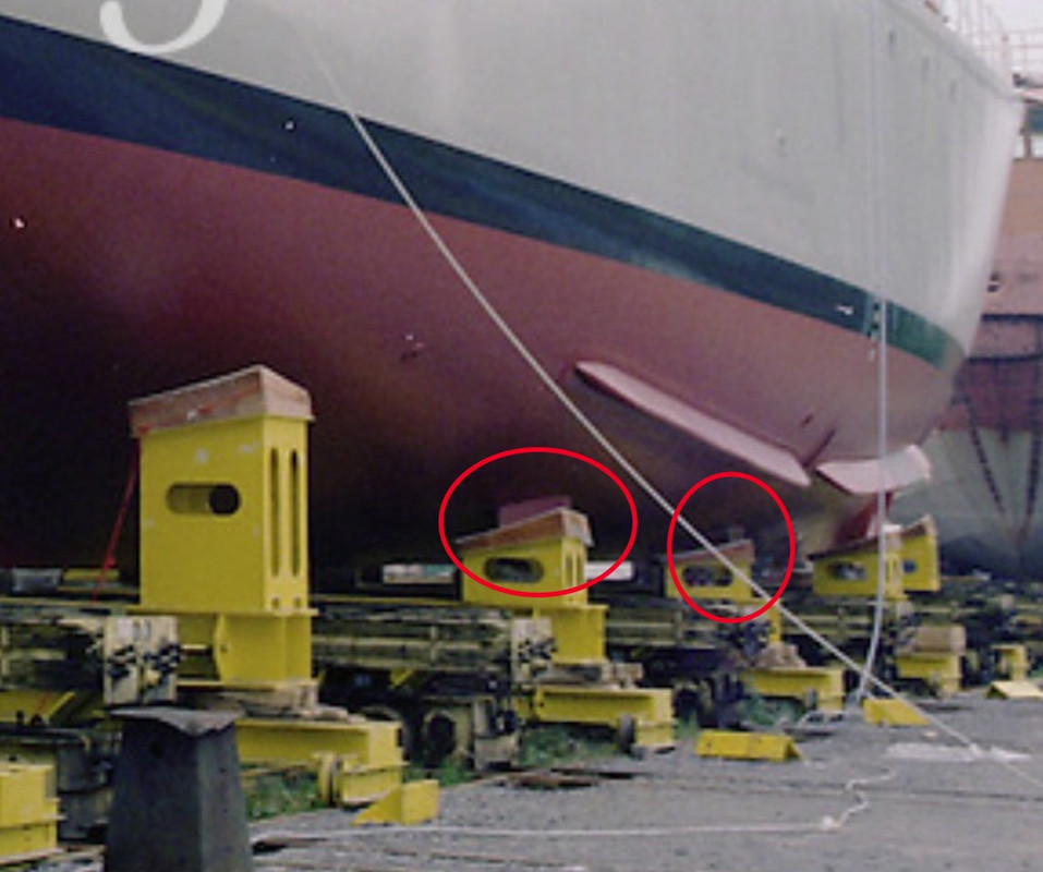

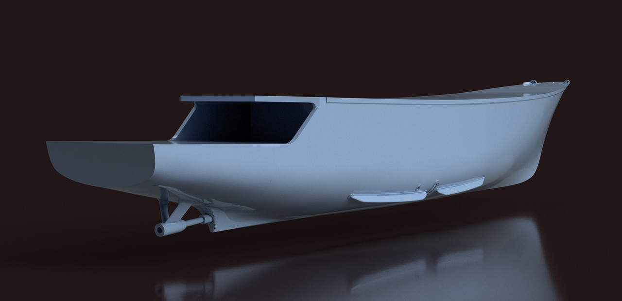

Note that the anti-roll keels are asymmetrical, due to the seawater intake on the starboard side.
They are often shown identical on models, but this is not the case.

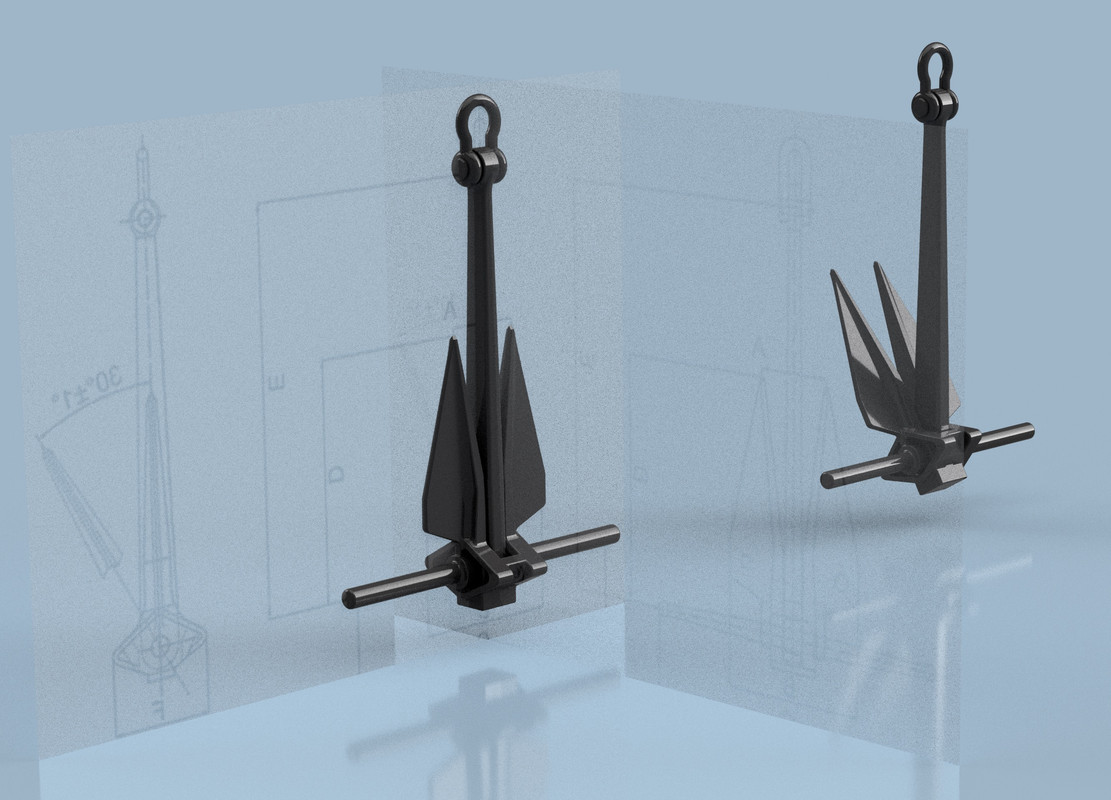

Anchors are of the Danforth type:
Pascal

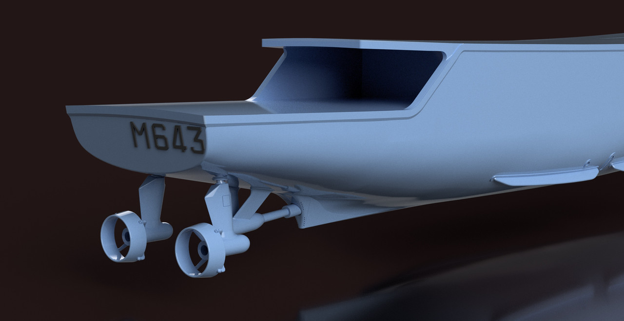

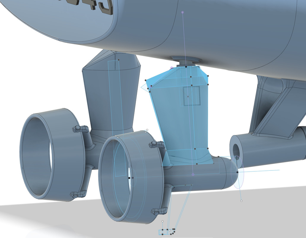

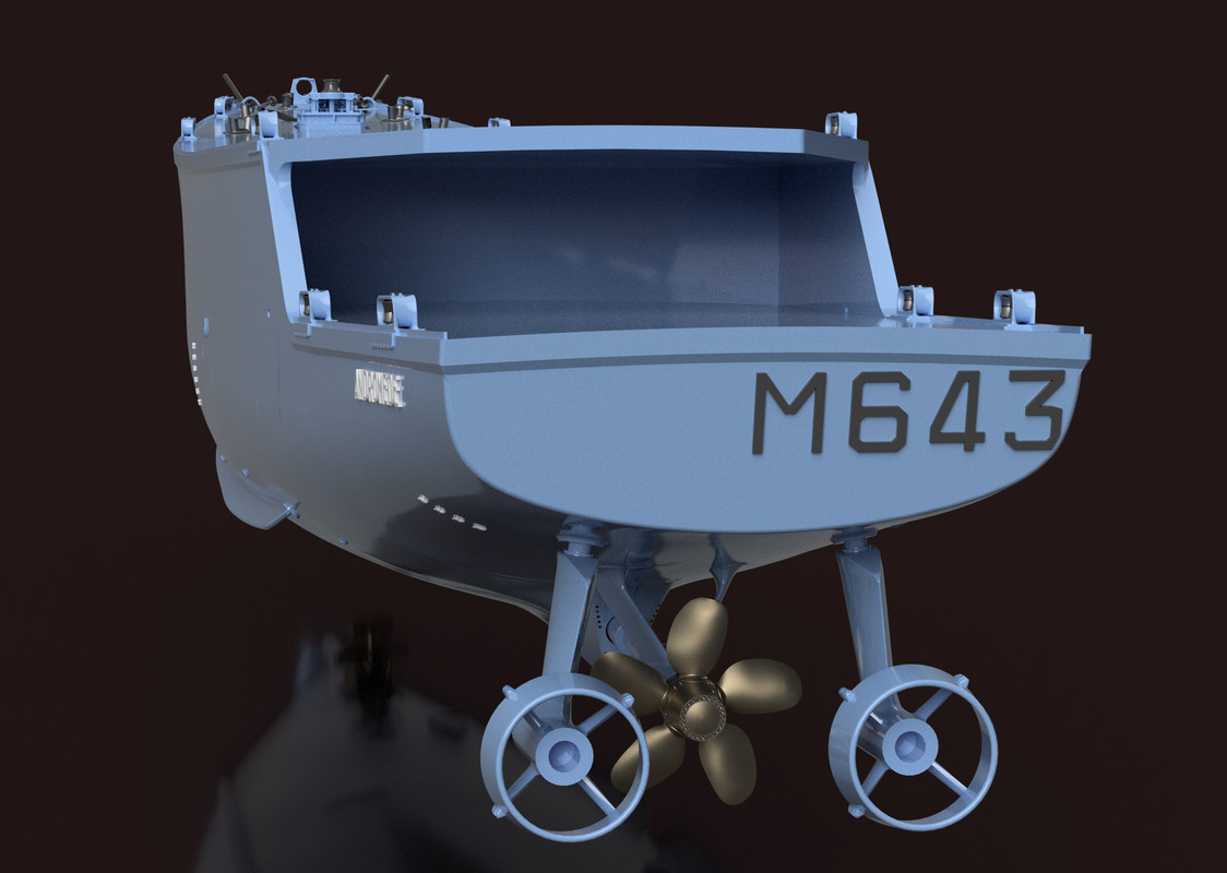

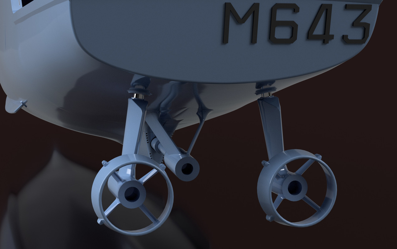

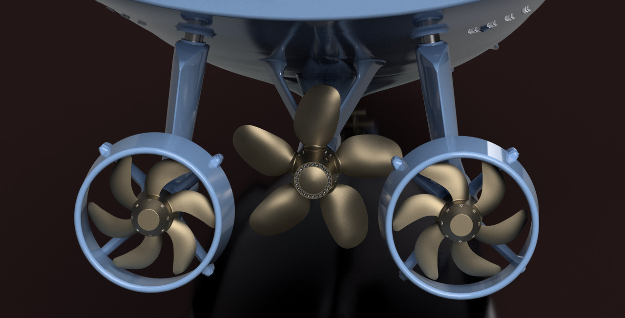

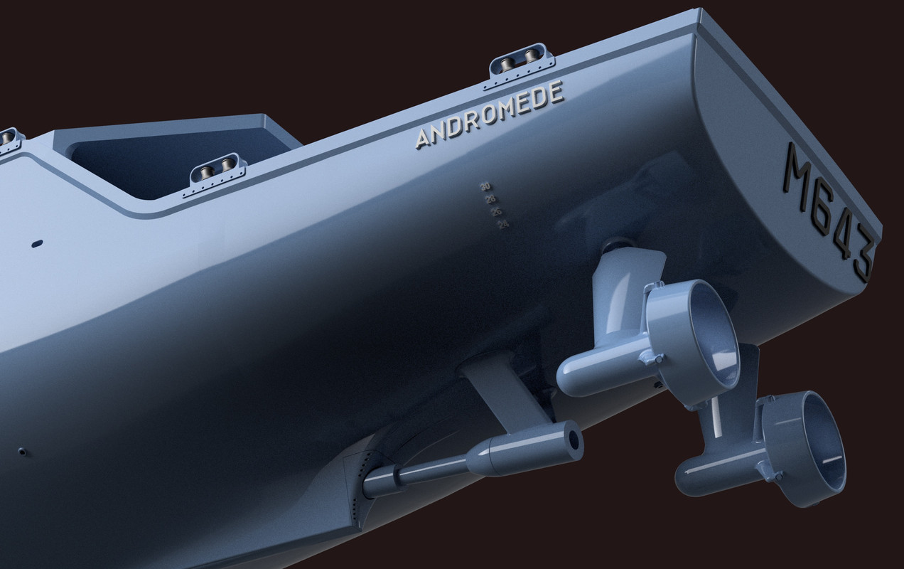

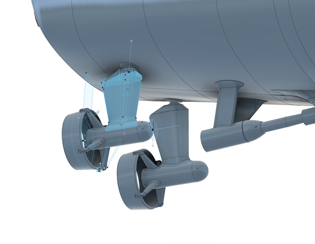

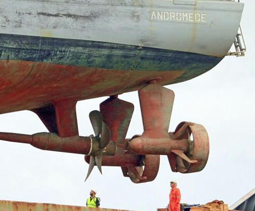

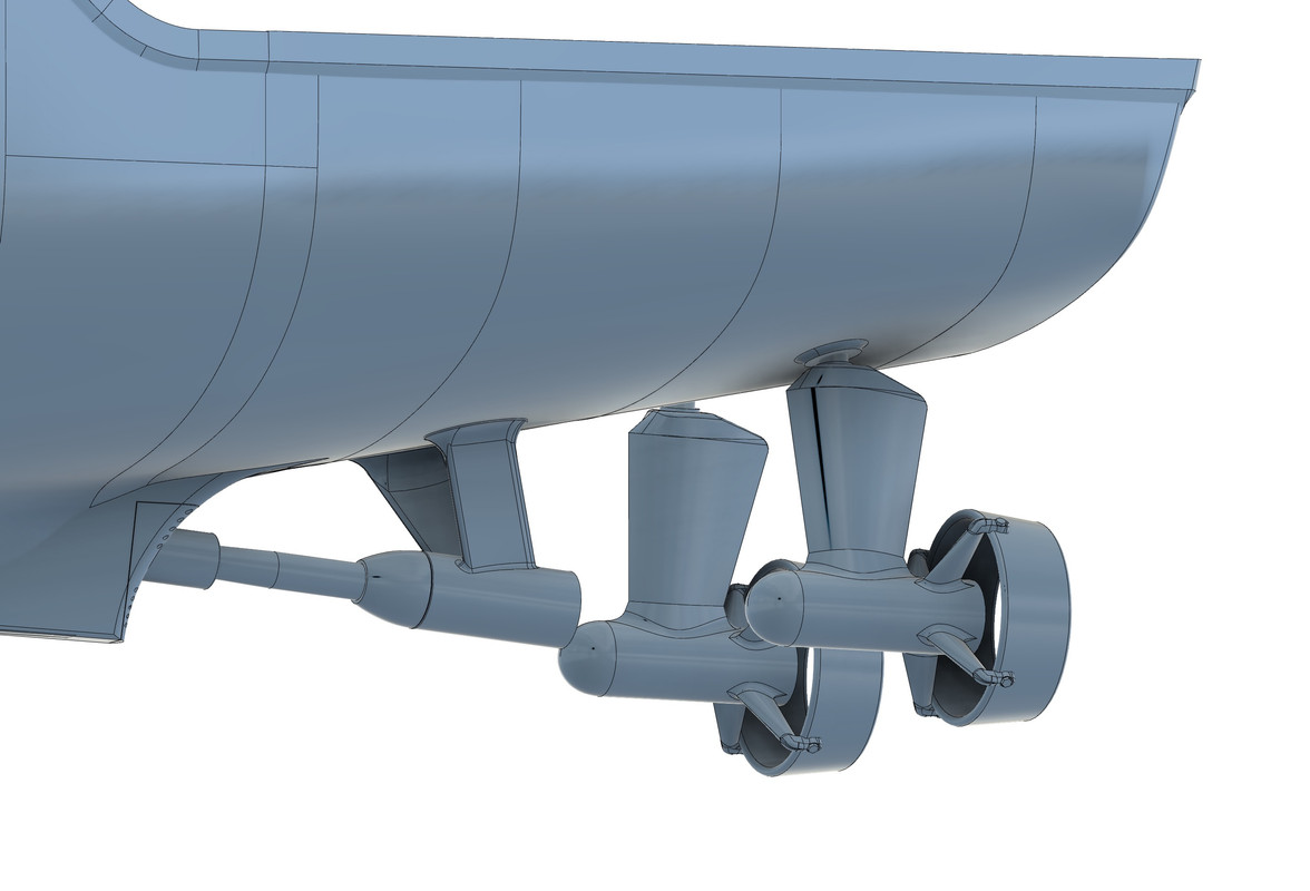

Drawing azipods. Not easy.
What's more, the corners of the upper part are too tight :roll: I'll rectify that tomorrow... :')
Too bad, I was happy with the result. :lol:
I'll try to repair the structure of the previous drawing without damaging the drawing too much and therefore wasting time.
Pascal

Changes made. :heh:
Pascal

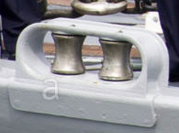

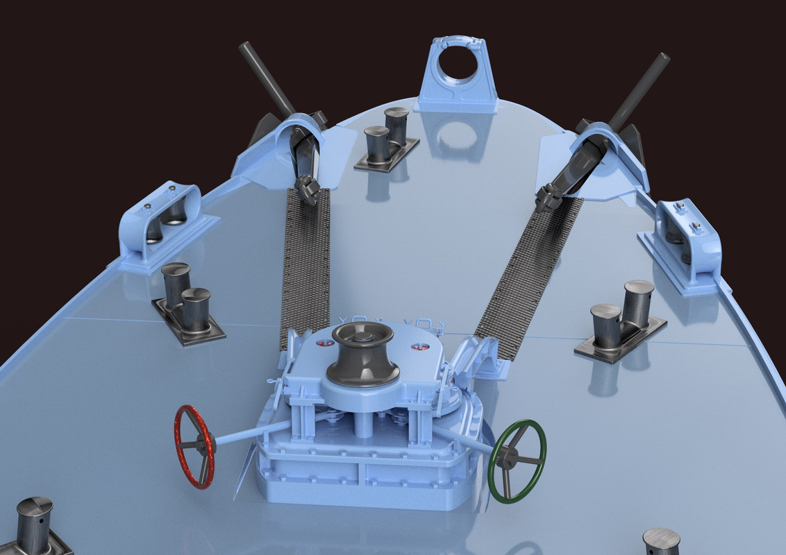

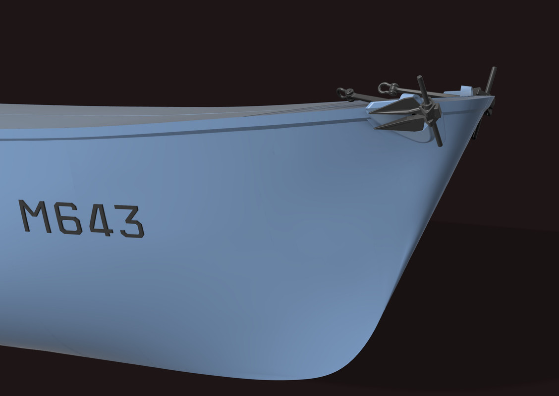

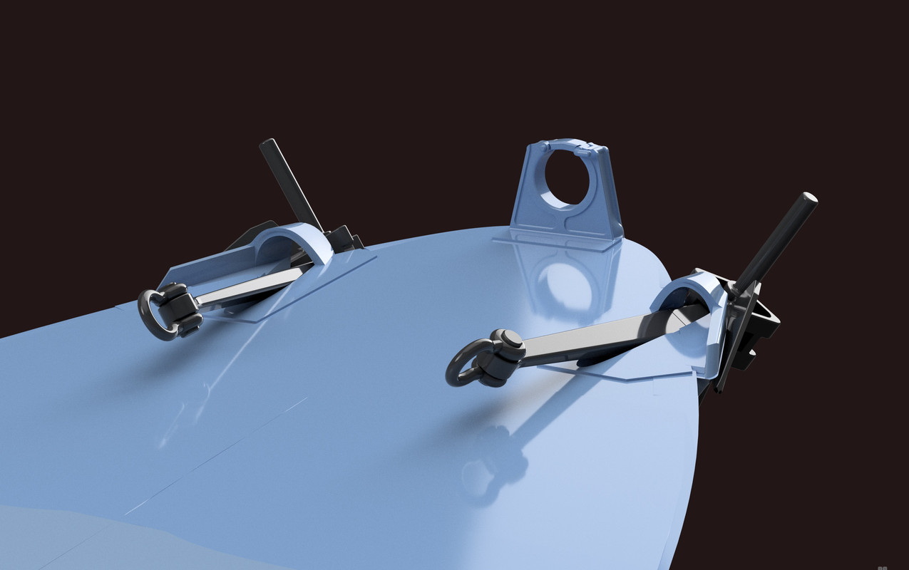

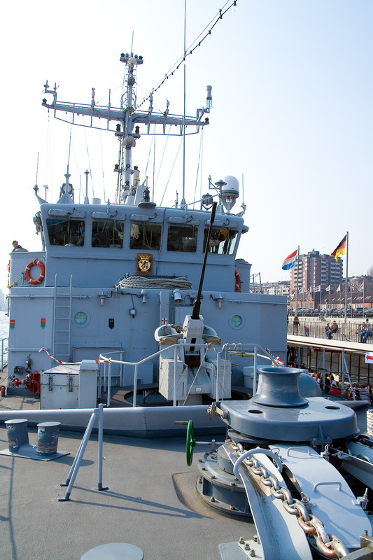

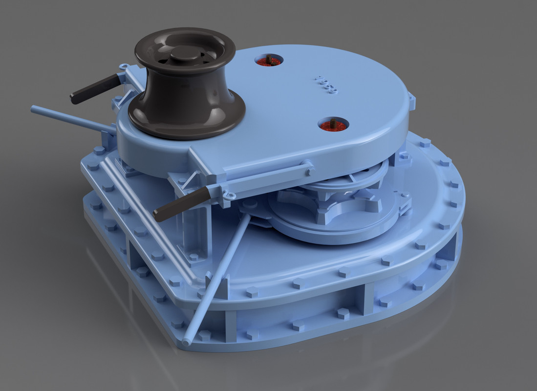

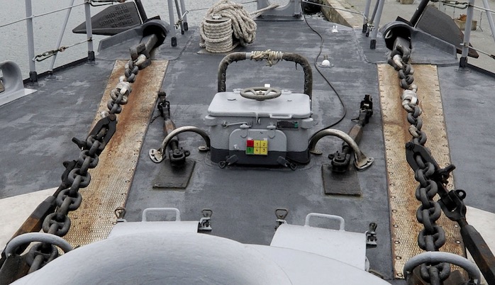

Drawing of the front central fairlead, you can open that one.
Drawing of the stainless steel fairleads with rollers, non-magnetic ship obliges, as well as the stainless steel protection plates of the composite deck to prevent that the anchor chains do not scrape it.
I've seen that on some hunters the anchor chain is made of stainless steel. All in all, the construction cost must be quite high for the size of the boat, it's quite a technical vessel.
There are only 5 portholes on the starboard side of the hull.

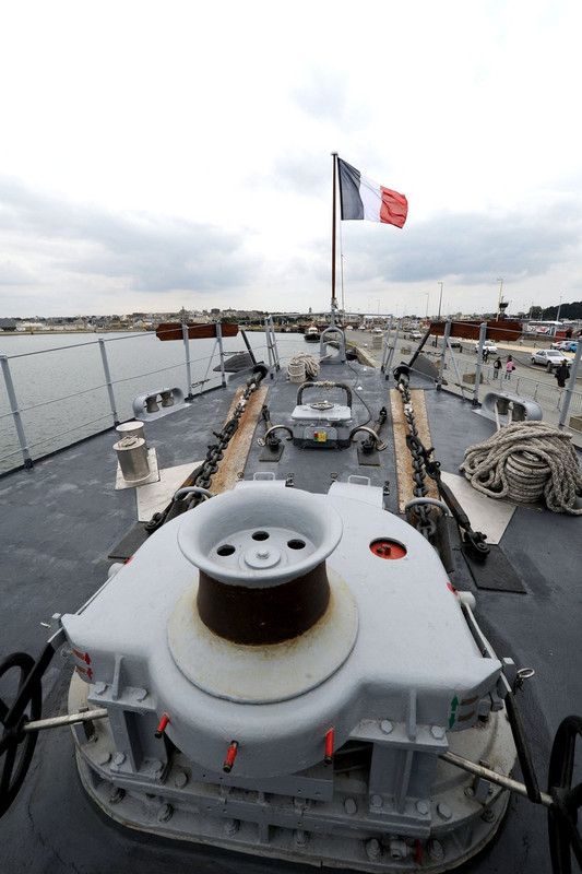

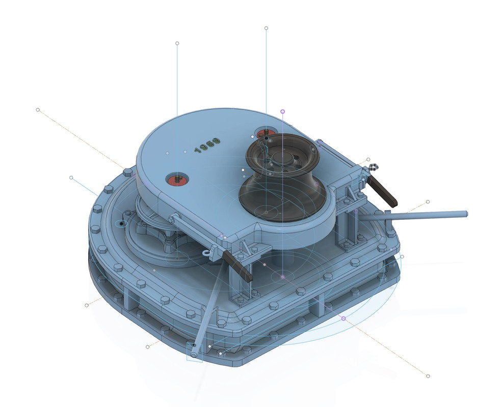

8 hours to draw this windlass/cabstan, a rather original piece of equipment :heh: , I've never seen one designed like this, although I've seen a few go by during my career.
No plans of course, I used these two photos almost exclusively... It took a lot of imagination to make it credible.
And that's not the end of it, I've got the V-shaped chain slides to draw as well as the descent to the chain well, but that won't be as tricky.
I'm quite happy with the result, but note that the photo taken from the back was taken with a fisheye lens, hence the significant distortion of the image.
:copyright:Torsten Bätge HNLMS Schiedam M860, note the stainless steel chain. luxury, but it avoids magnetic effects and rust.
Chasseur de Mines Croix du Sud, nice pictures in Saint-Malo here:
https://www.emeraude-journal-infos.fr/2 ... ix-du-sud/
Emeraude Journal Infos - Photos Patrick Desjardins :copyright:
The result: the ‘thing’ should look like this, with a few details still missing, the sprocket brake handwheels and the grease nipples.
To be continued.
Pascal

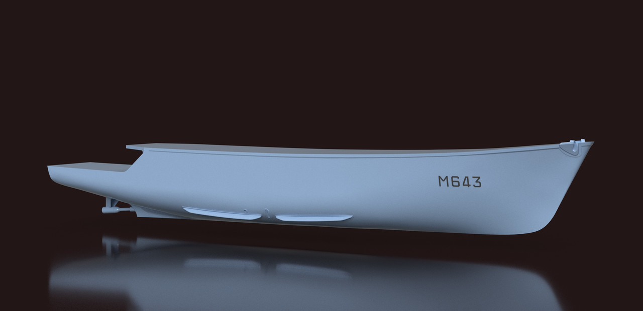

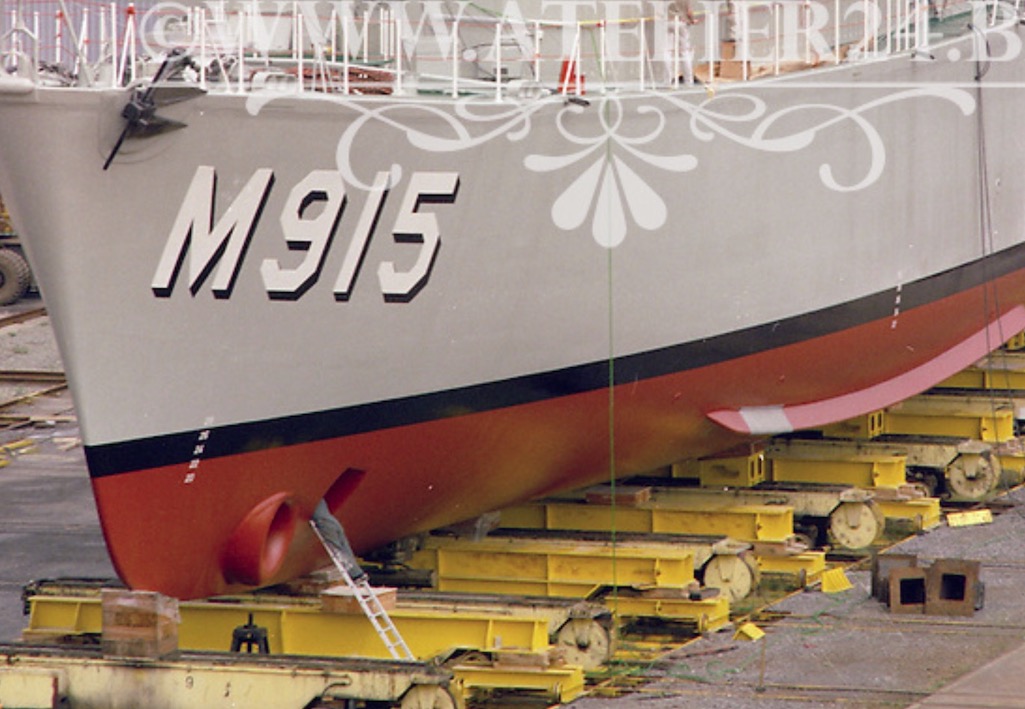

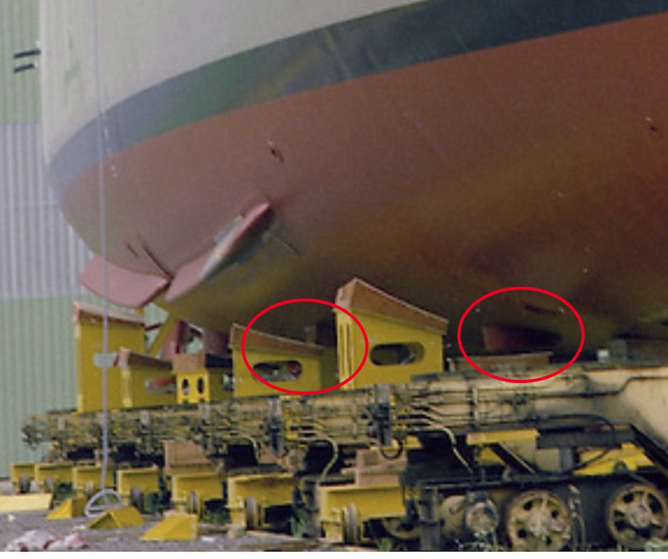

I worked on the specific stainless steel mooring bollards, the windlass chain guides (not finished), and a big job that took me quite a long time, the tunnels for the 2 bow thrusters, which are very specific to this type of vessel.
You can see that they follow a slope and end on one side with a hydrodynamic bulge.
What's more, the beads are naturally asymmetrical port/starboard...

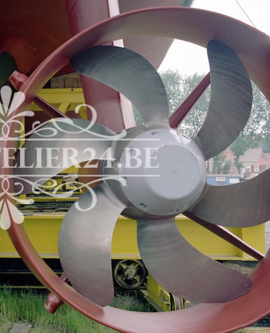

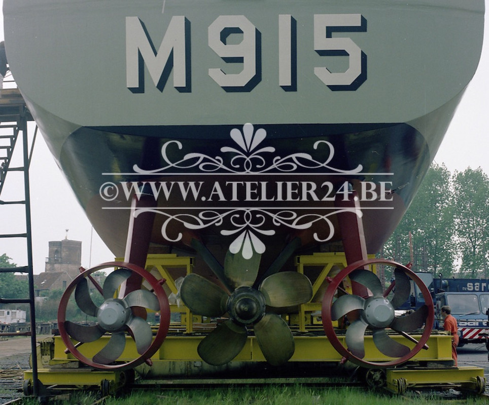

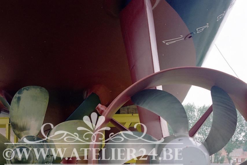

There are still the propellers to draw, but that's easy enough, thanks to the photos below.
I've found some very good photos here of a Belgian fighter in the final stages of construction, the kind of photos you'd expect from a modeller.
https://www.atelier24.be/gallery/Aster- ... nbdaB8wmYs

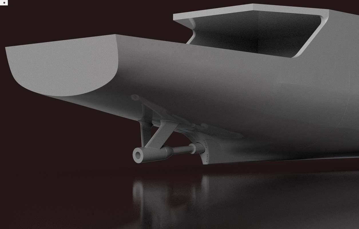

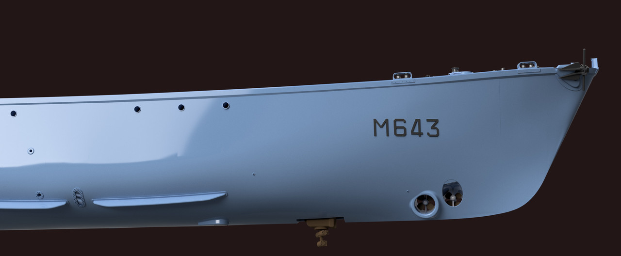

Drawing of the bow thruster angular gearboxes and propellers. Drawing of the various outlets and inlets, I still have some to add, especially on the port side.
Drawing of the Doppler lock, the appendage on the starboard bow, and the echo sounder, which is a little on the starboard stern.
Drawing of the port low water intake.
Pascal

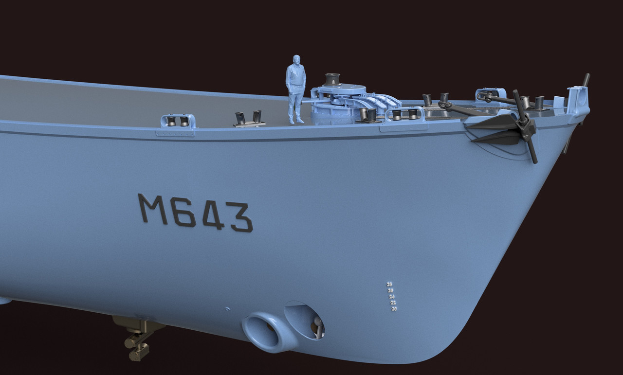

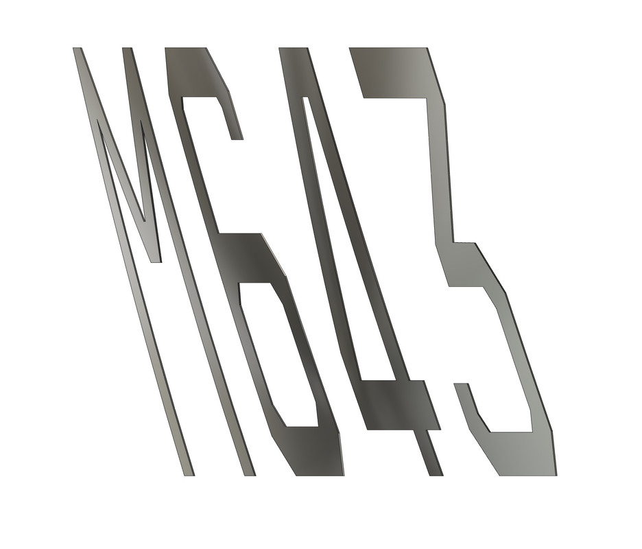

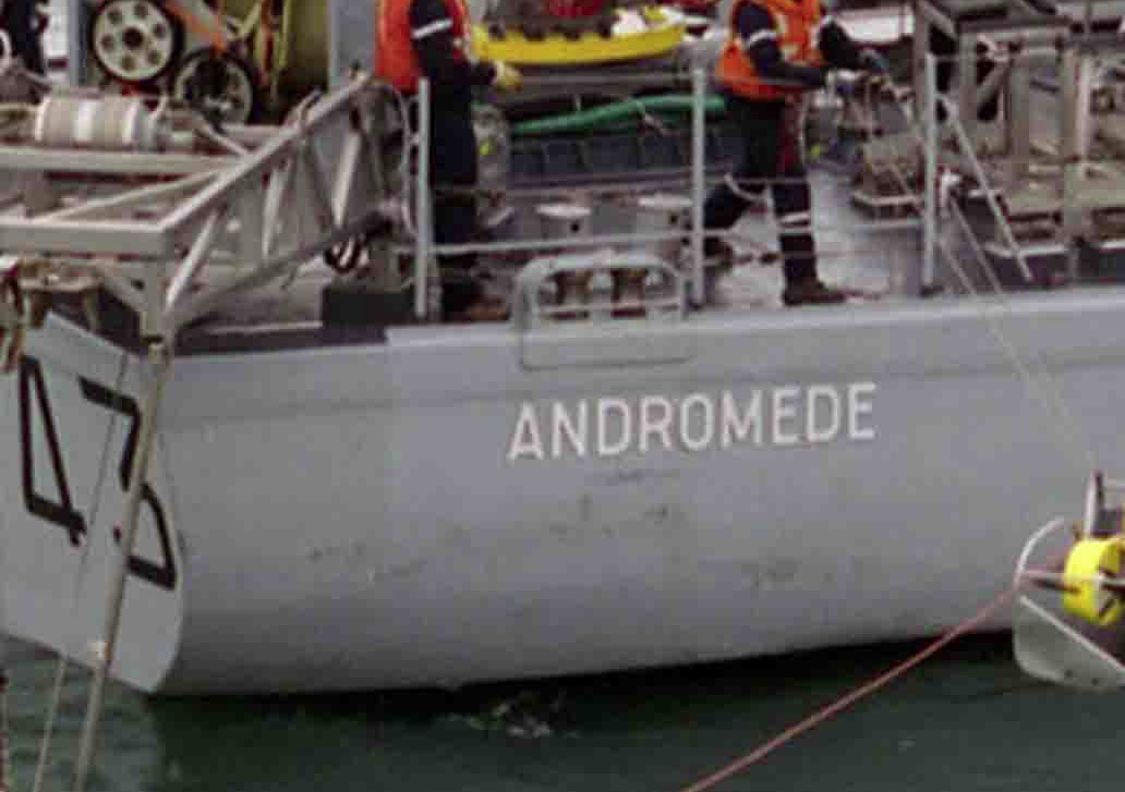

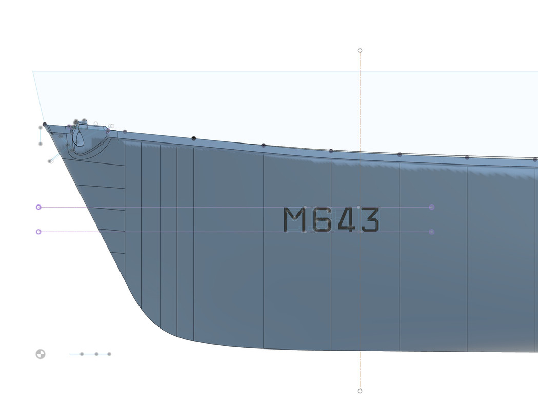

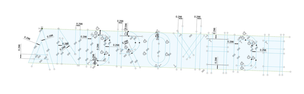

Drawing of the draught scales and the ship's name.
The font that is very close to the original font used by the French Navy is ‘DF Camino Light’.
It's a pay font on the internet, so I typed in the name and transferred the image of the text in 3D, it's free. :lol:
https://www.myfonts.com/fr/products/lig ... 5432185002
Pascal

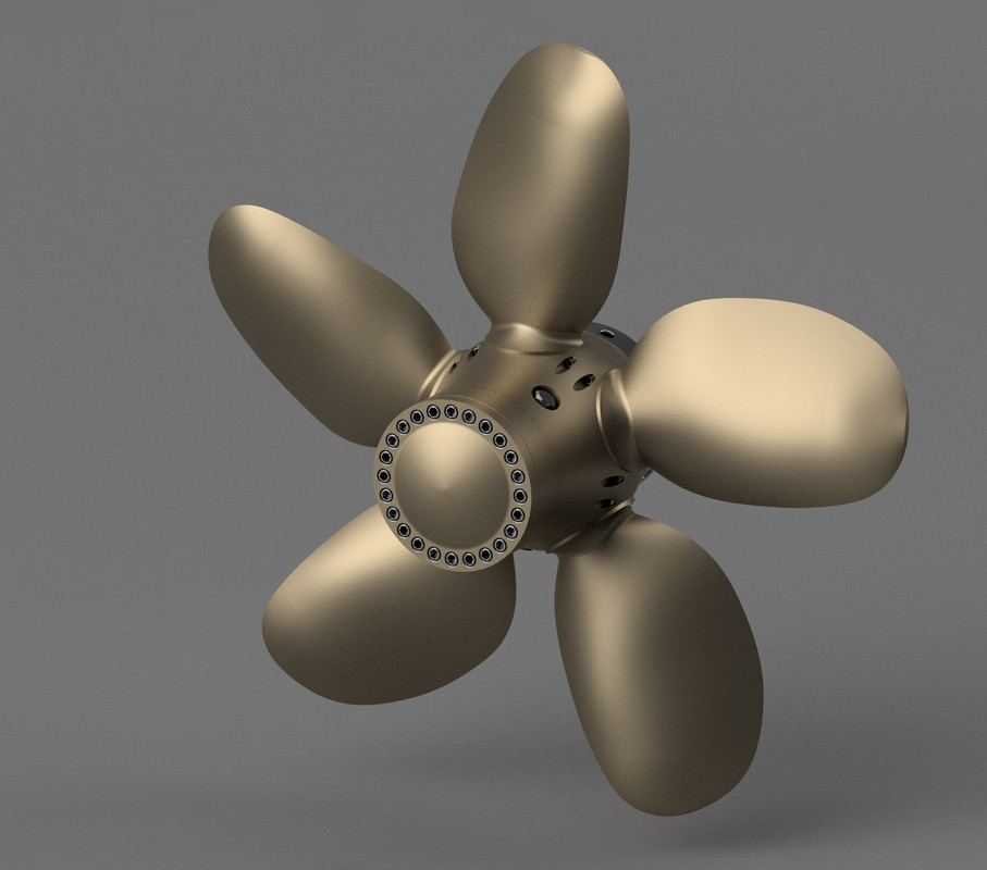

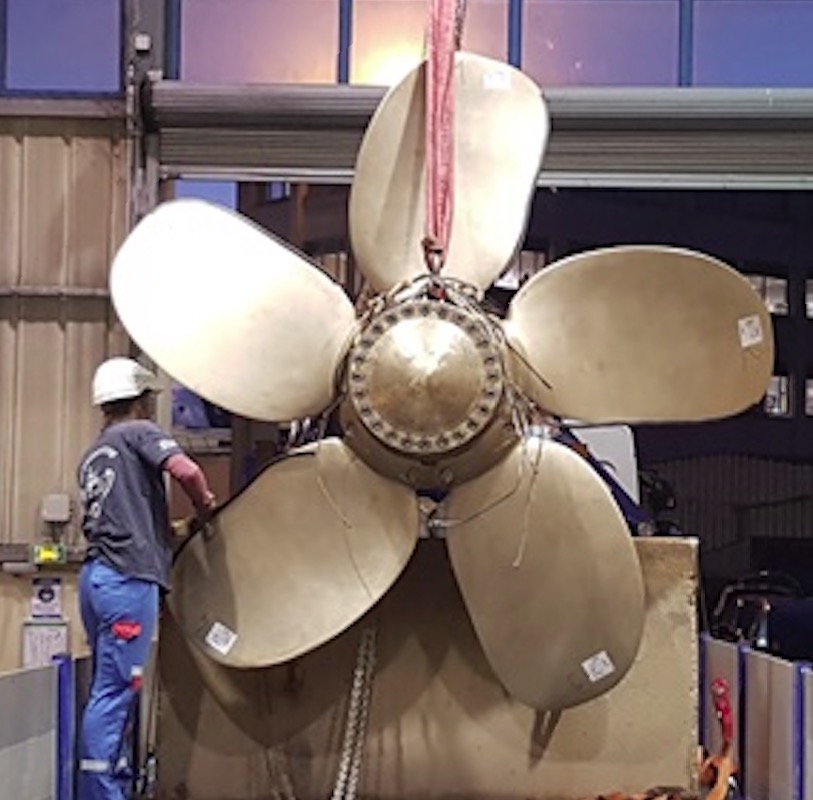

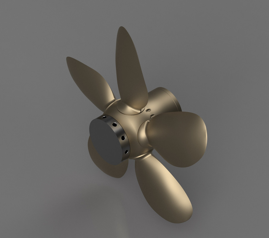

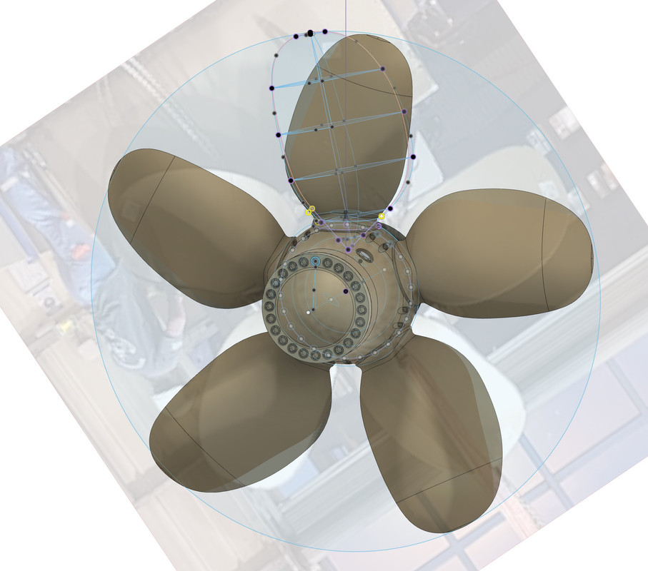

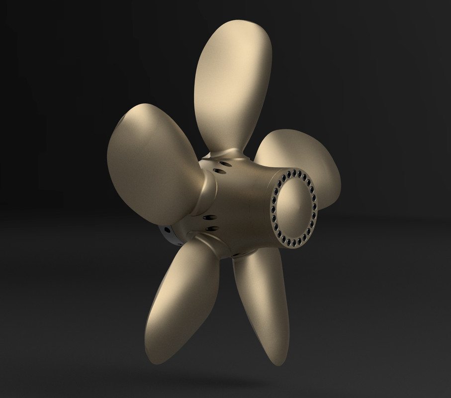

Drawing of the 2m50-diameter propeller for the main propulsion system.
The Andromeda minehunter fitted with a 3D-printed propeller:
By Vincent Groizeleau - 01/14/2021
For the first time, a French Navy ship is equipped with an additive manufacturing propeller. The ship in question is the tripartite mine hunter (CMT) Andromède, which received this equipment during its major technical shutdown in Brest.
The 2.5-meter-diameter propeller, comprising five cuproaluminum blades, was produced by Naval Group's Indret site, which has been investing heavily in the industrialization of new 3D printing technologies for several years.
The site, located in the Nantes region, has equipped itself with the largest cell in Europe employing the WAAM (Wire Arc Additive Manufacturing) process, which consists of creating objects by successively adding layers of material. 20 meters long and 8 meters wide, this robotized cell, integrated by the Nantes-based subsidiary of the Japanese group Yaskawa, can produce parts weighing up to 5 tons.
In this case, each blade blank, made from the same alloy as in the foundry, weighed 300 kilos at the end of additive manufacturing, and 200 after machining. Leaving Indret in October, the five blades made their way to Brest, where local Naval Group teams attached them to the propeller shaft, which was then installed on the CMT (the single propeller constituting the Andromeda's main propulsion system). According to the manufacturer and the navy, tests carried out in December demonstrated the success of the operation. Certified by Bureau Veritas, this propeller was not produced for a test campaign, but is intended to remain on the ship until the end of its life.
“In collaboration with the Fleet Support Service and the French Armaments Procurement Agency (Direction Générale de l'Armement), we had to create the entire reference system to meet the very high standards required of military vessels, for example in terms of robustness and acoustic discretion. This propeller will remain on the ship for all its missions, and has no restrictions compared with the one it replaces”, explains Naval Group, where it is claimed that this is the largest propeller produced in this way in Europe, and the first to be installed on a combat vessel......
Read more here:
https://www.meretmarine.com/fr/defense/ ... ression-3d
http://server.idemdito.org/electro/marine/cmt-histo.htm
I started from these photos, including the one that's almost full-frontal.
I've thickened the blades for printing.
Pascal

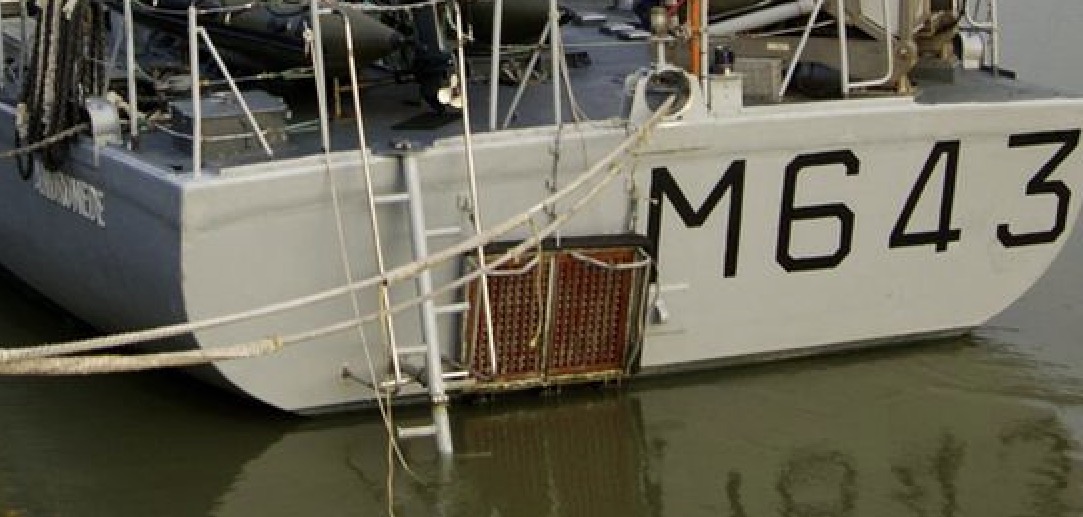

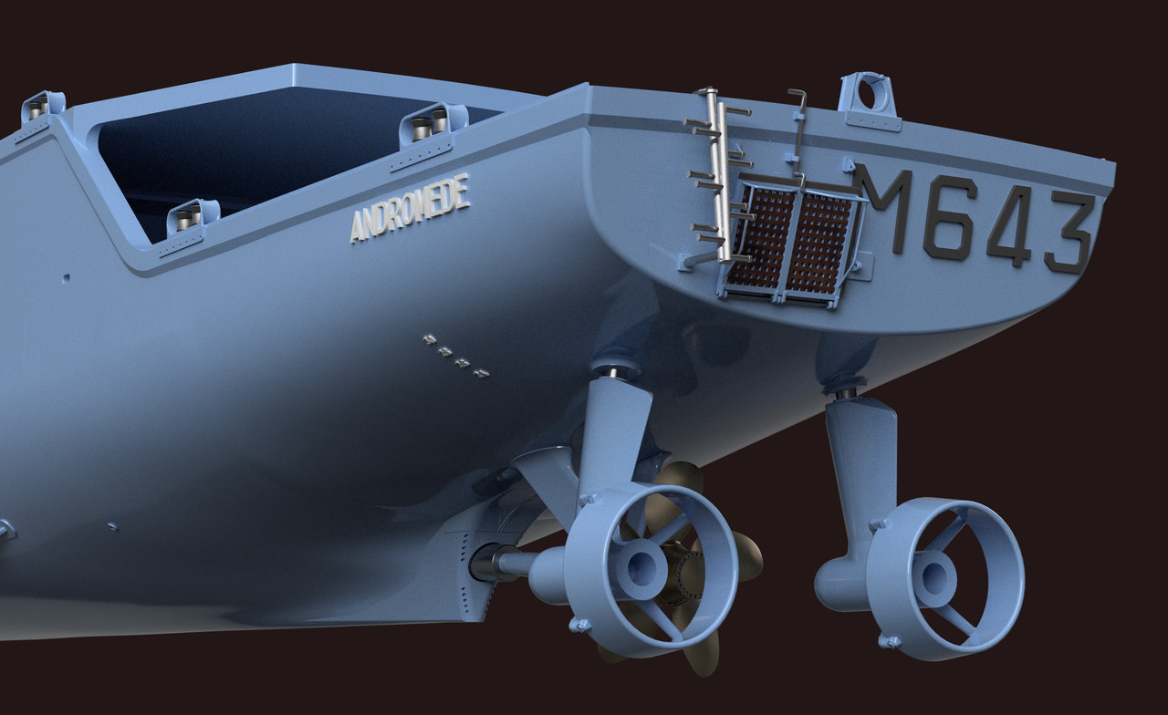

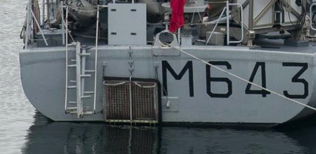

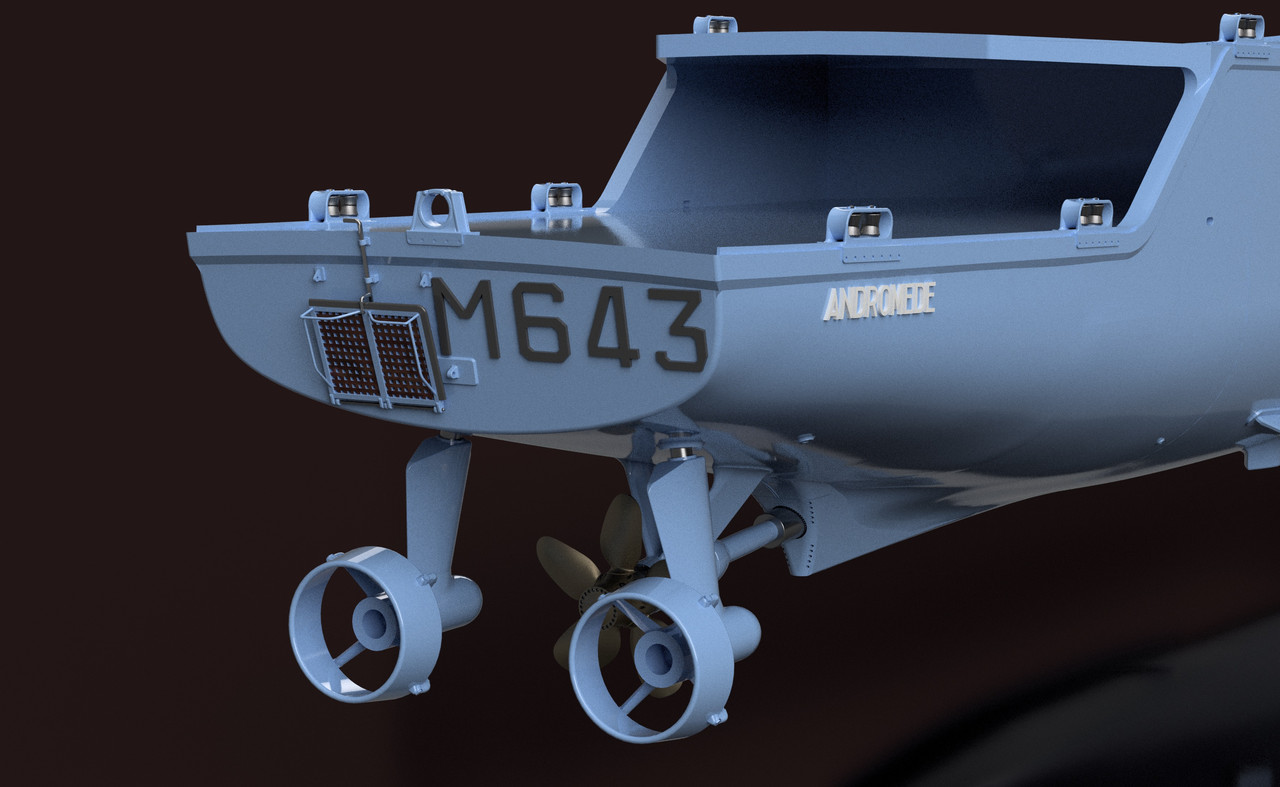

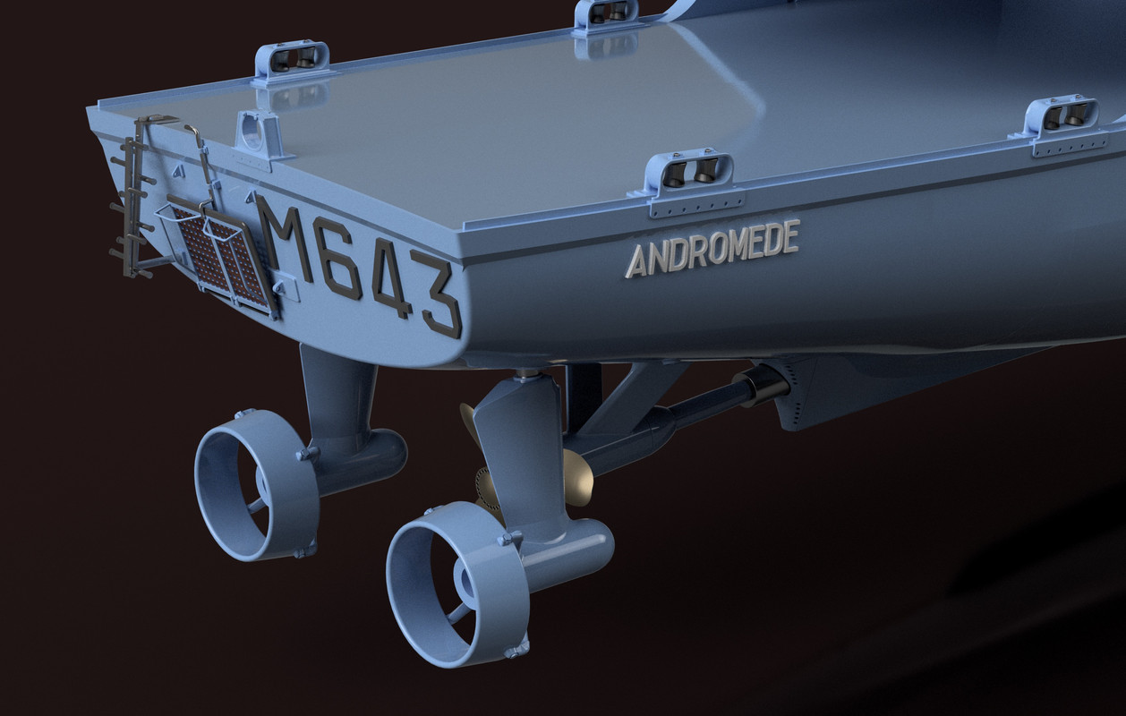

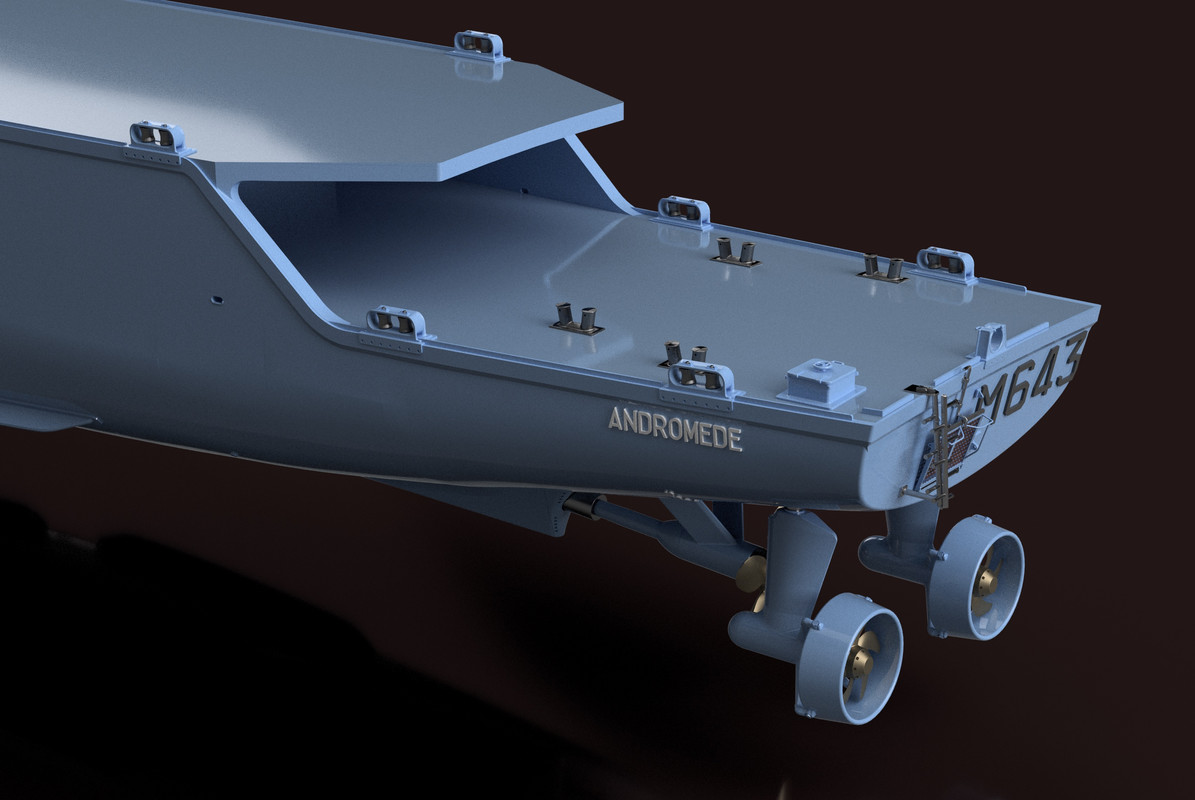

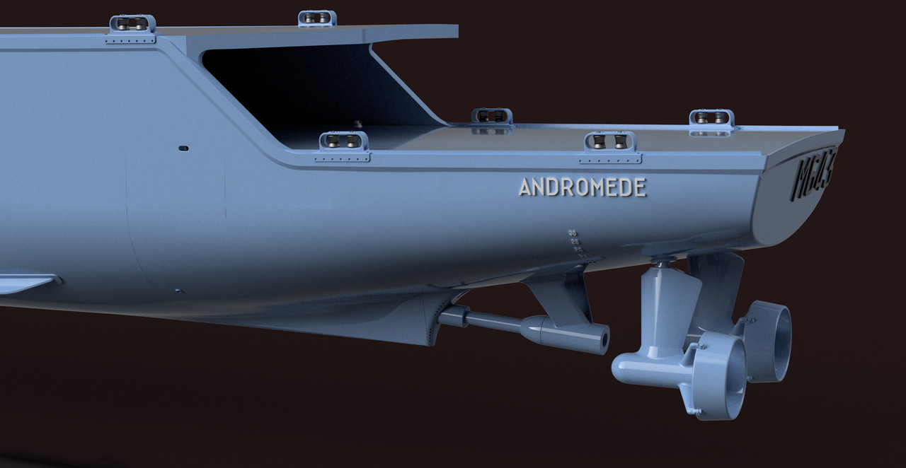

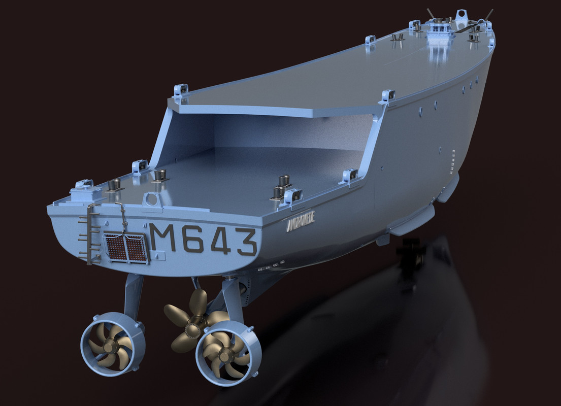

Drawing of the transom accessories. The divers' ladder, the platform for boarding and disembarking in the sea, for the inflatable or others. Various fixing points.
Pascal
PostPosted: Wed Dec 18, 2024 8:16 pm
Posts: 1881
Location: Bretagne, France

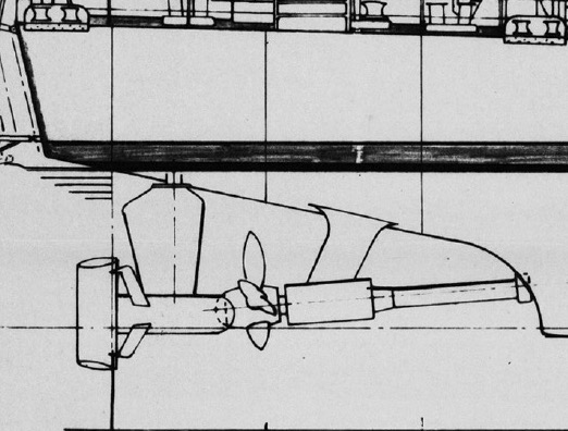

Not too many visual advances today, port aft hatch, active rudder propellers or azipods, but mainly a flattening out of what has already been drawn for the aft section.
I've scaled all these accessories to the correct proportion, and changed the size of the nozzles too, which were a bit too small, so the plan isn't right.
Changed the pods too, especially the diameter of the drive. Not easy to do.
I'm quite happy with the 2 ‘sabre’ type propellers, a first for me, I know how to do it now. All I had to go on were the photos. No plan.

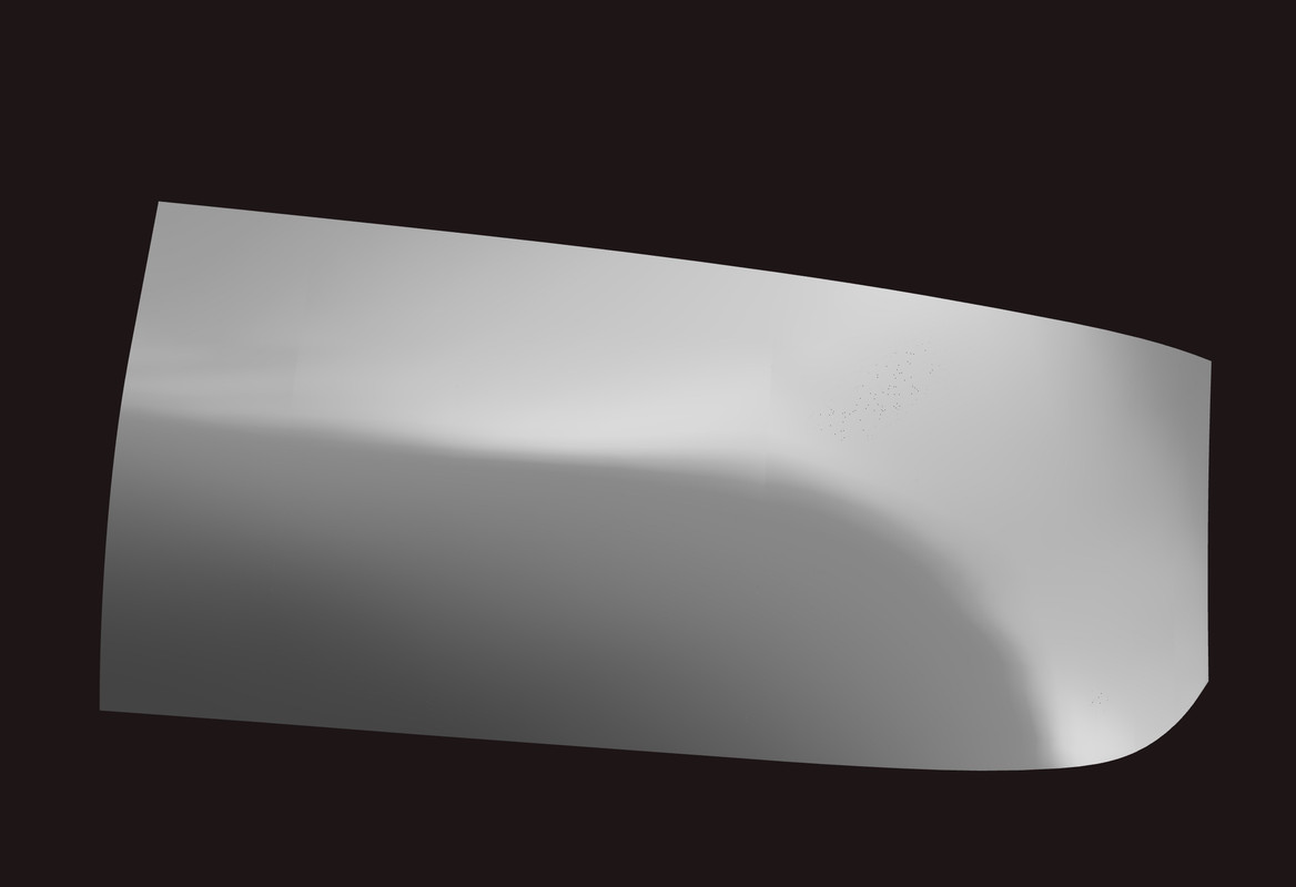

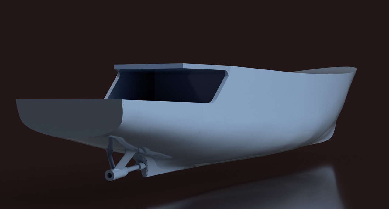

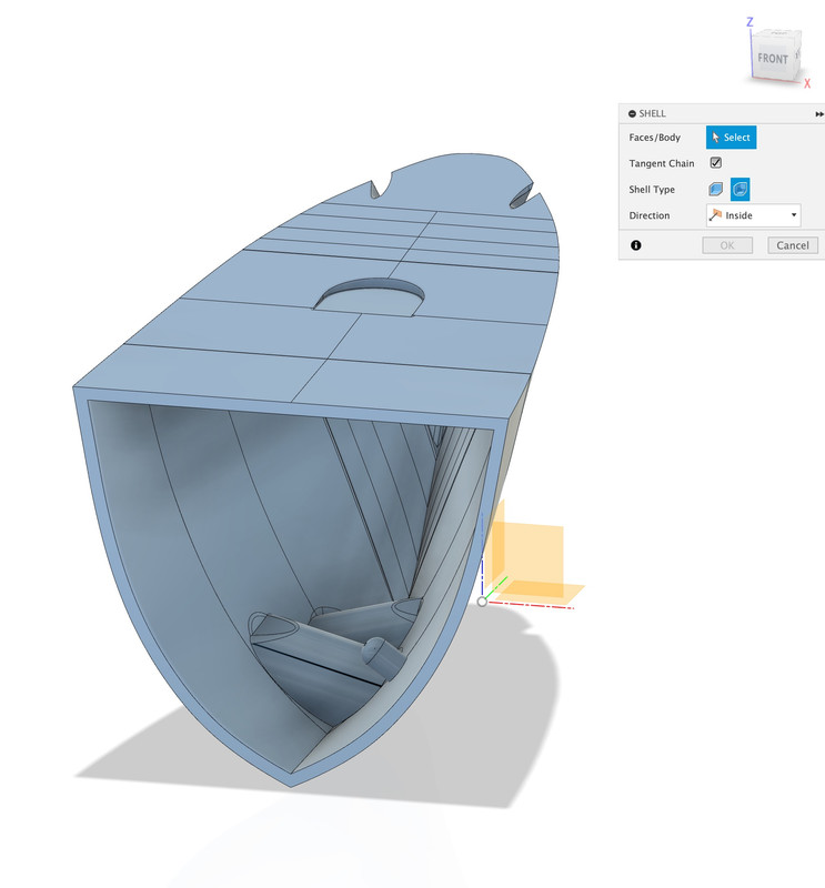

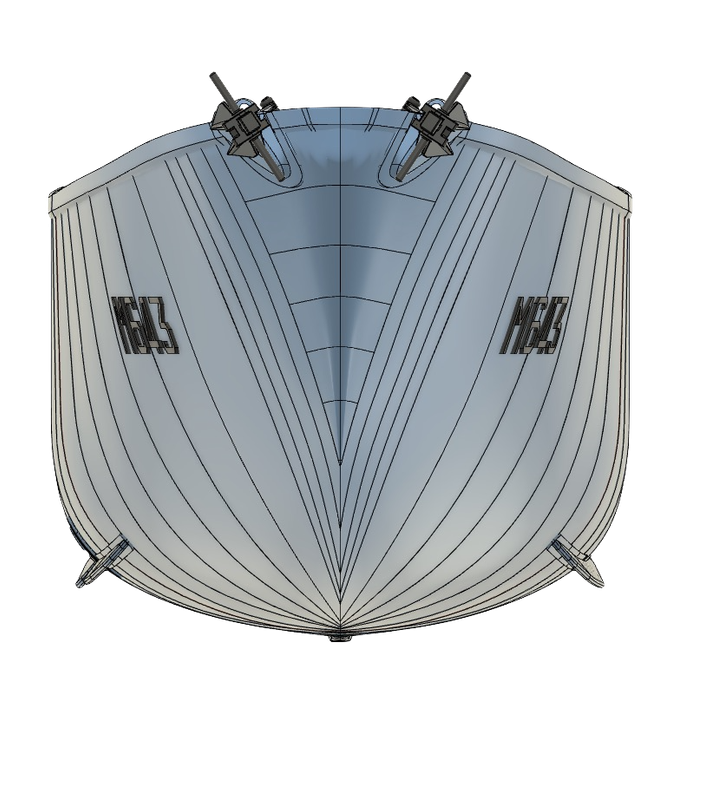

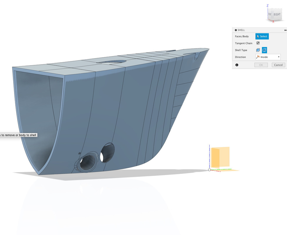

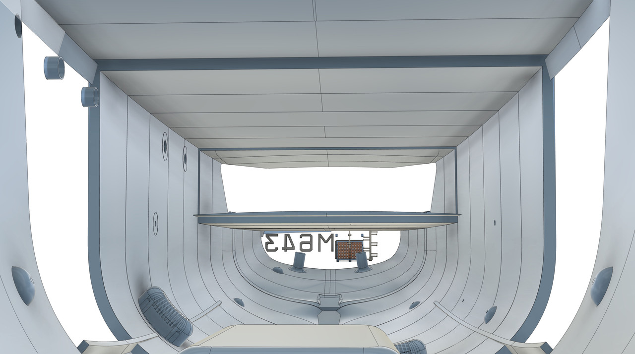

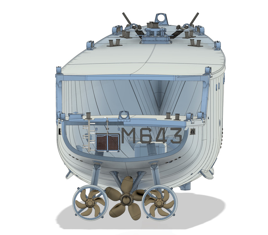

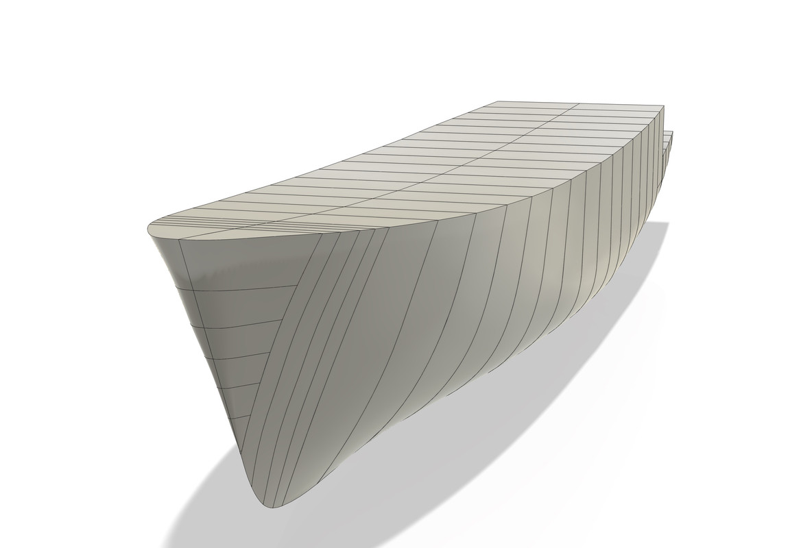

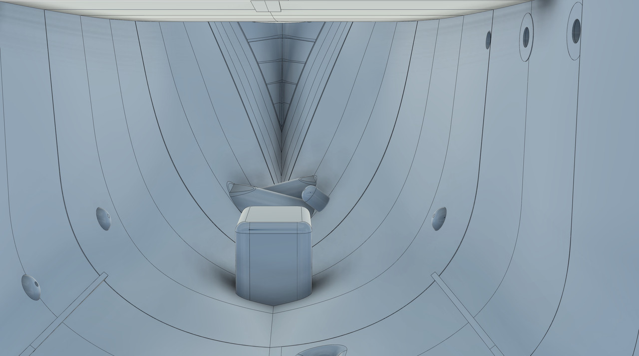

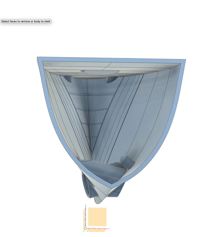

Hull gutting yesterday. This operation was usually rather time-consuming, as it involved virtually remaking a smaller shell within the hull, generally keeping a thickness of 1.5 mm, and assembling it to the other using a negative assembly.
Fusion 360's “Shell” function has improved considerably in recent weeks, and all the better for it. This function used to work only once in 5 times, depending on the complexity of the part.
As you can see from these screenshots, the program has perfectly managed the internal shape of the bow thruster tunnels, which are quite complex and almost impossible to do as well manually.
Today:
Windlass/capstan design completed.
Just to give you the scale of the ship.

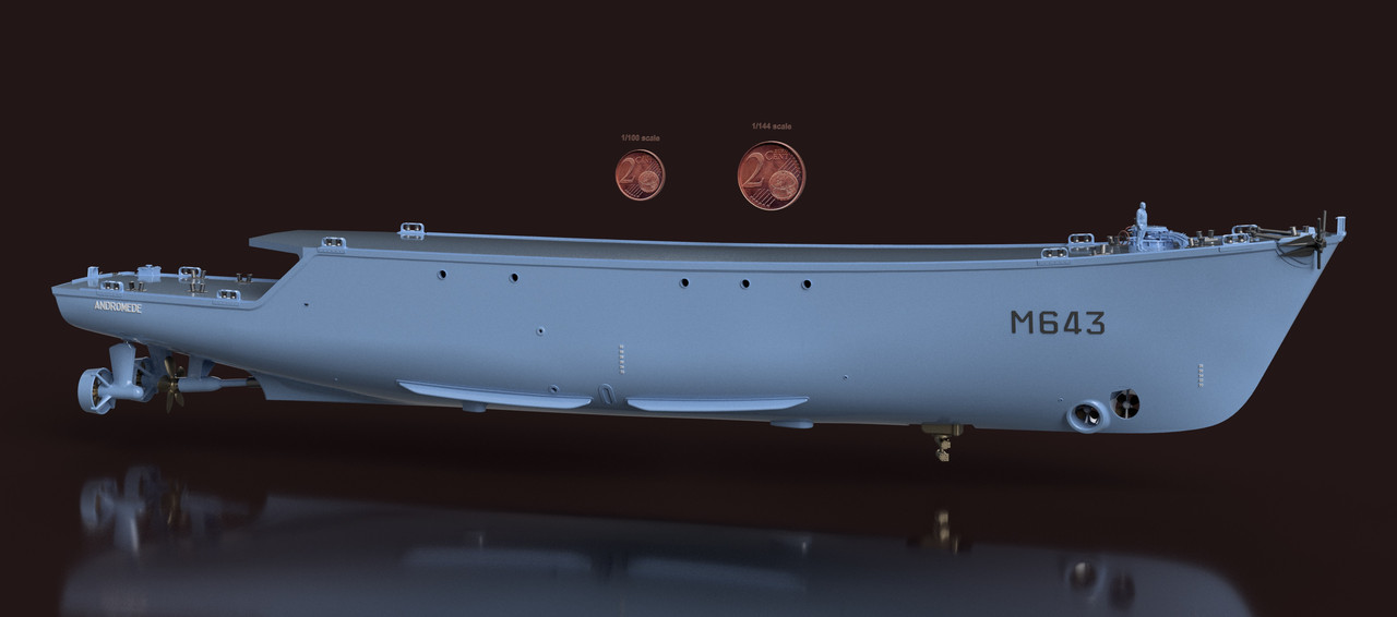

I haven't done anything on the models for the last 4 days.
For aficionados of the 2-cent euro coin, which is 18.7 mm in diameter and gives the scale in both 1/144 and 1/100 versions:
