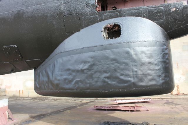

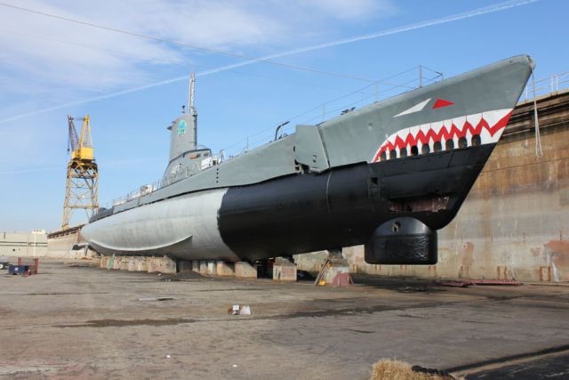

A request from a Swiss friend.
A Guppy kiosk conversion ( Porthmouth Sail version ) for a Gato Class submarine to represent the USS Torsk 423 with a 1:72 Gato Class Revell hull. I have to release the big sonar under the hull also.
I found a lot of drawings on this excellent Gato Class website:
http://www.gatosubs.com/mkptsail72draw.htm
Unfortunately they are not very accurate, see picture, but they did help me a bit to start my 3D drawing.
Luckily, you can find a lot of pictures of the USS Torsk in a dry dock during an interview and docked at the museum, especially on Flickr with HD pictures of individuals.
This submarine kiosk looks simple in terms of shape, but it's quite the opposite.

The photos of Torsk high and dry reveal that most of the limber holes along the sides of the built up main deck have been filled in. These were initially in great number to allow a quicker emergency dive, not of great importance by the time the GUPPY's were re constructed. This would have also cut down submerged drag.

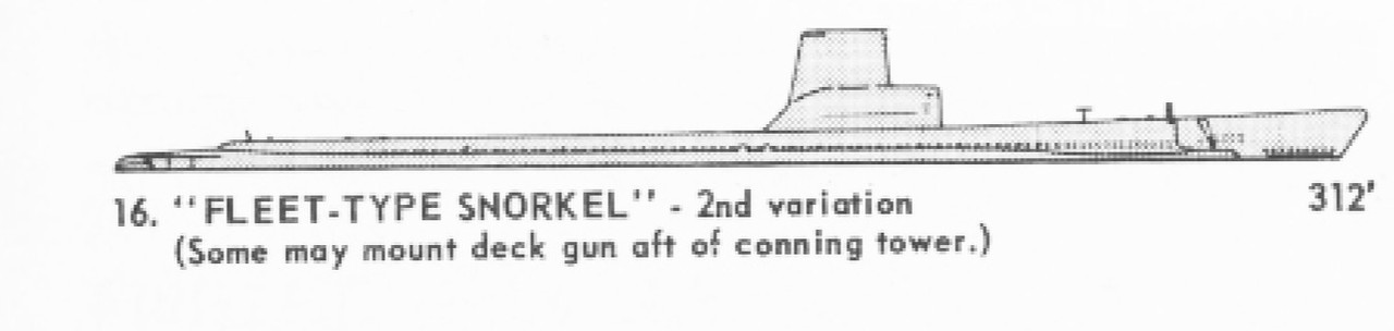

Very nice conversion piece! I know things don't "translate" very well sometimes, especially marine terms. The USN term for this streamlined superstructure is "Sail". Not a very literal nomenclature!
Torsk, a "fleet Snorkel" boat is shown below. She retained the coning tower for navigation and periscope observation at the base of the sail. Aft of the periscopes is the snorkel apparatus.
Illustration from Norman Friedman's "US Submarines since 1945".

I incorrectly suggested that Torsk was part of the post war Guppy program, in fact she was a "Fleet Snorkel" and not a Guppy. The Fleet Snorkel boats were a fairly minimal conversion with underwater speed considerably enhanced by exterior cleanup. Torsk and several others retained the base for the 5" 25 deck gun aft of the sail, however none in the long run retained the mount for long.
The Guppy boats were a very extensive reconstruction. The most obvious distinguishing external characteristic was the Guppy's had a rounded prow and the Fleet Snorkels retained the original raked prow.

It's a Fleet.Type Snorkel variation 2 ( Porthmouth Sail version ) conversion indeed.

I tried oil-canning with a method I developed, not the one in the link above.
It's quite tedious because each recess has to be drawn one by one, here there are few, the settings must be careful, too many, not enough. :cool_2:
It has the advantage of not being repetitive in terms of shape.

The oil canning is indeed a challenge in 3D, but it is feasible, it would be easier on a relatively flat hull, this is not the case here.
Already, representing the hull sheets is not simple, both together will certainly be very complicated operations, you need of course a very powerful and recent computer with a lot of RAM. :cool_2:
