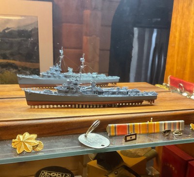

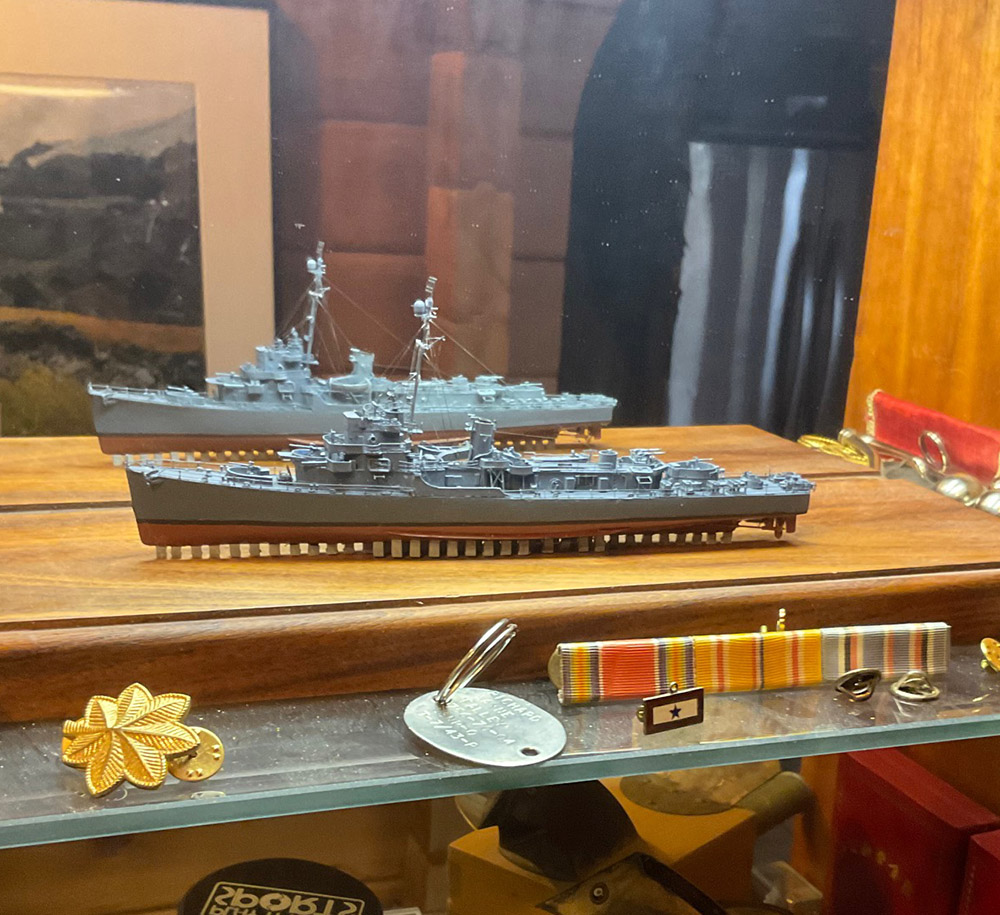

Added dry docking blocking, sitting for now in the hall case (full of junk).

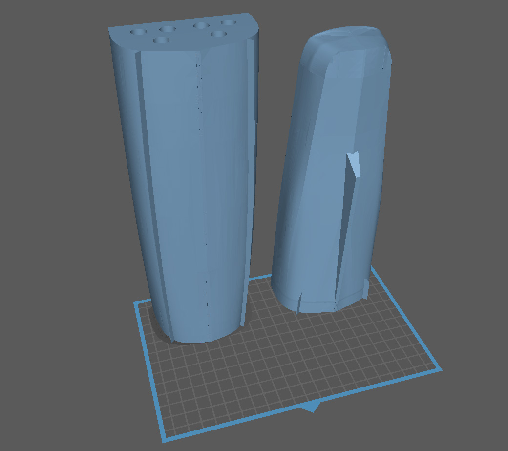

The mid and aft hull sections printed fine, (1:144) looking a bit like two Australian Fruit Bats, asleep, hanging from the platen. I could have printed all three hull sections at once if I had had enough resin. Awaiting a new FEP and some more resin. It is possible to remove the cover mid print and add resin, as the vat will only hold so much. So I get to clean and cure these and see how well they join. I did print the bilge keels which will help with alignment (I hope). They look much better than anything I could attach separately. So far, not having removed them, printing the part end sections directly on the platen worked well and insures a dead flat section for joining.
As to scales? Since I don't use commercial parts, pretty much up to me. I did like the 1:120 that I used for the APA but I can do much of that in 1:144 and large models start taking up a lot of space.
In doing the hull lines, the most useful thing was listing the exact frame locations plus or minus some inches for each section profile. So I was able to space them exactly by making a chart and converting it to MM along the hull from the FP. My primitive program does not allow a mirroring so I do this in Chitubox and place the pieces together.

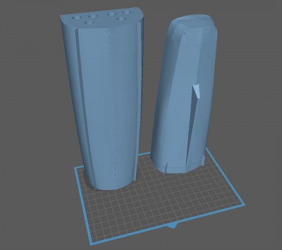

What mid and aft hull sections look like on the platen. Each section is about 9 1/2 inches long. All three sections could be printed in one go.

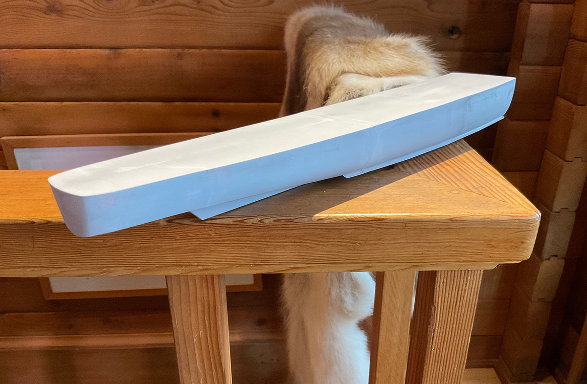

Just shot a light coat of auto primer on the DE Hull (aft 2/3). Here are two of the three sections joined. Final fairing and smoothing will take place after I get the bow printed. Usually My resin supplier gets it to me in a coupe of days but this time said they would send me an email when it shipped. Wah hail.... Same thing for the FEP supplier, label made for the PO but "awaiting item".
Got another tackle box for small parts and dedicating this one for the DE project only. Printed smoke generators, quad Bofors, 3" 50's 20and 3" aft tubs, anchors, and all the K guns and racks. I printed a batch of 20 mm', but think I will modify them slightly.
