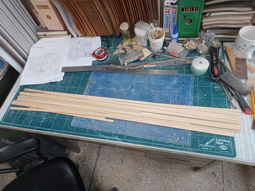

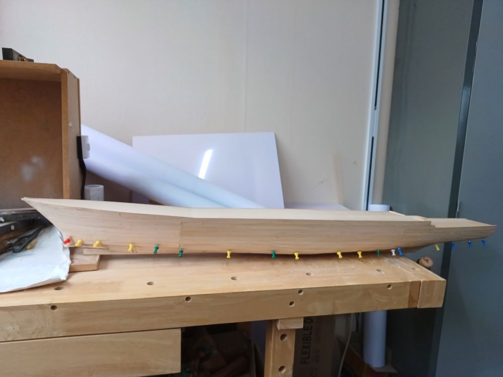

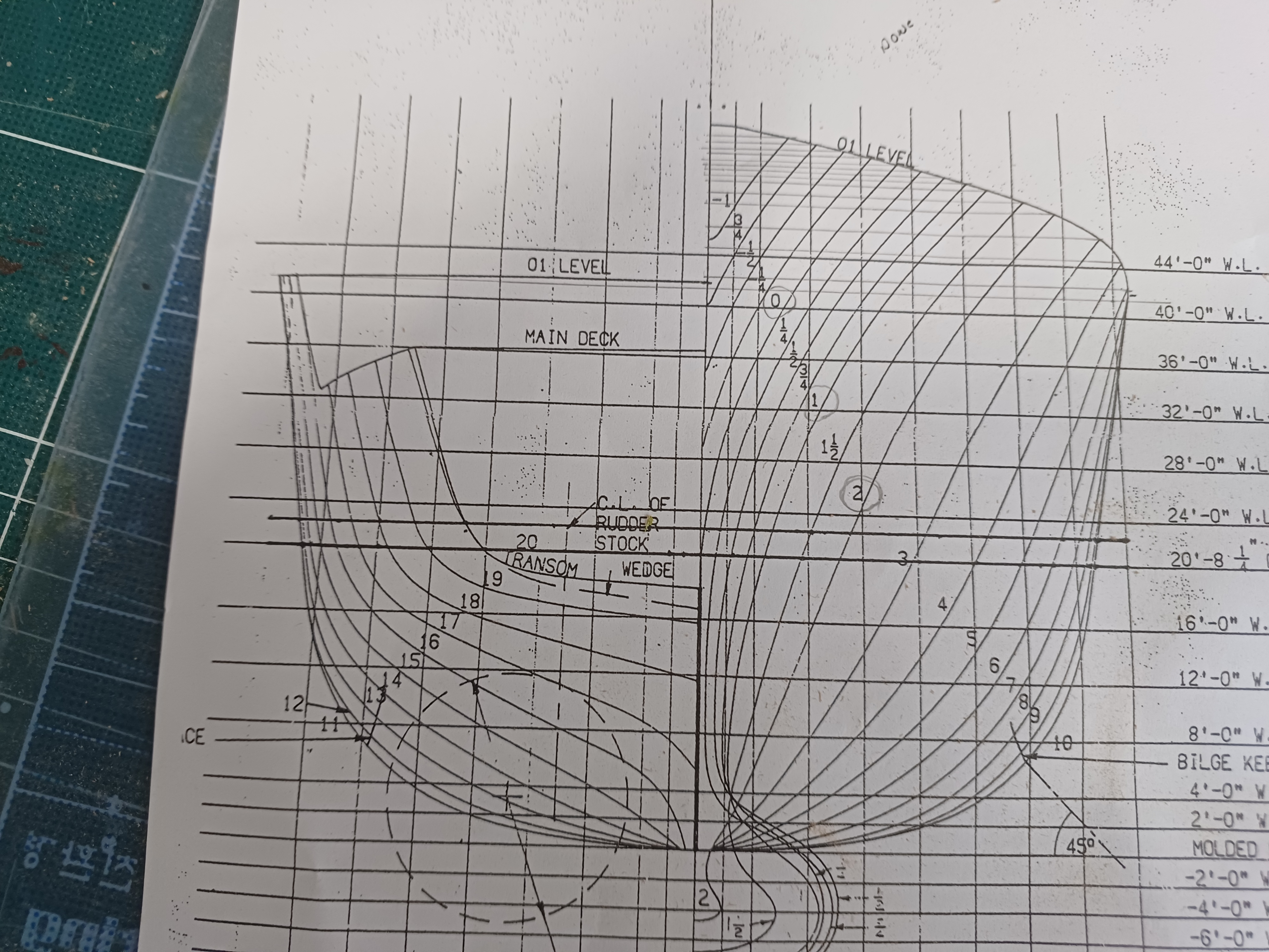

I've started new model project.
Song Jung Gun

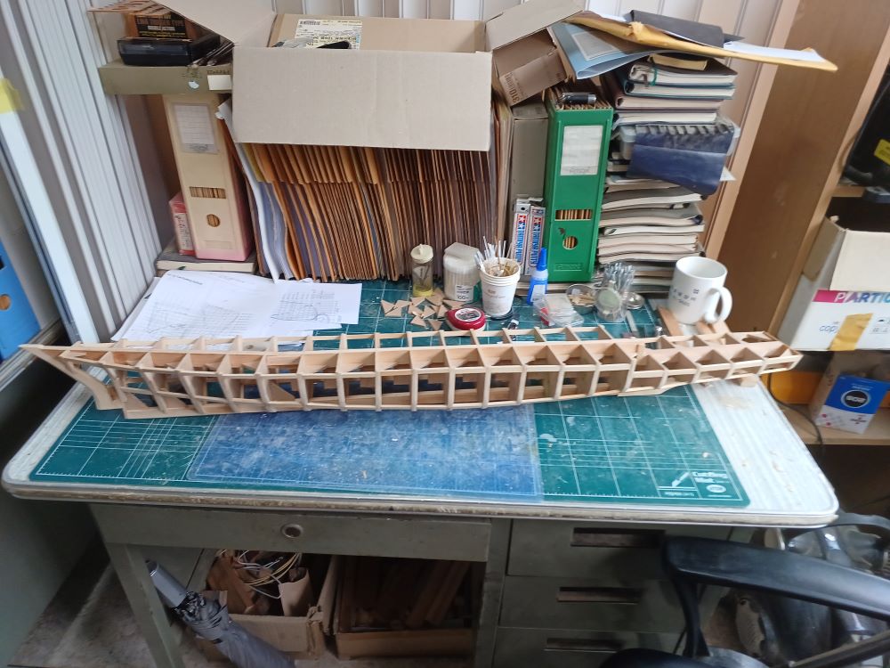

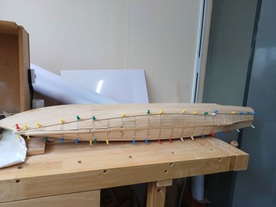

I've built frame of body.
Song

PostPosted: Fri Jul 07, 2023 6:17 am
Posts: 1561
Fliger747 wrote:
I am of course always appreciative of Song's experience which leads to a combination of speed of construction and excellence. Coming along nicely!
Thank you very much Tom!
I'll built it slow and slow. My wife said to me 'where do you storage it?'.
Regards; Song

DavidP wrote:
2 questions.
1: why is there a knotchout where the keel joins the bow stem?
2: why does it appear that part of the keel 4 frames back from the transom plate is lower then the rest of the keel?
2 answers.
1: It's difficult to maintain straight line of bow stem without knotchout. You will see in near future plaking stage.
2: That is flight deck. It is lower than main deck. could you check plan and real ship?
PostPosted: Fri Jul 07, 2023 6:26 am
Posts: 1561
bigtodd wrote:
This is exciting. :thumbs_up_1:
Keep the updates coming.
Thank you so much.
PostPosted: Fri Jul 07, 2023 10:34 pm
Posts: 1561
DavidP wrote:
1: I never had to do that to my 1/144 Spruance/Tico hull back in the 80's but we shall see.
2: I am talking about the keel not the flight deck. it appears as tho you had to add a short straight piece to the keel before doing the curve to the transom plate.
Sorry I misunderstood your question.
The keel of your comment will be exposed after planking. The other will be covered with plaking strips.
So it is lower then the thickness of strips.
Song
PostPosted: Tue Jul 11, 2023 5:24 am
Posts: 1561
Hi, forks!
I am doing preperation work of planking.
Song

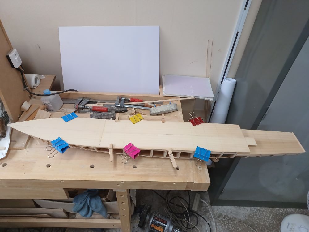

Hi,forks!
It's deck of body. I've attached 2panels each other.
Song
PostPosted: Fri Jul 14, 2023 2:29 am
Posts: 1561
Missed Picture.
