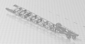

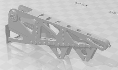

I've done quite a few 3D design files for this equipment and here are a few shots of my main components (machinery base, kingspost, boom, and outrigger. In addition, separate pulleys & pins, and associated gear have also been created -
File comment: Crane Boom

File comment: Crane Boom Outrigger

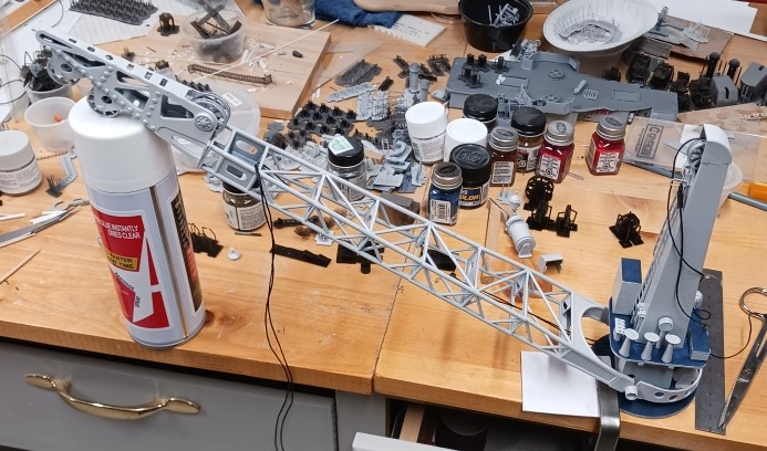

There (as I mentioned above) other parts, but these are the main components. After my initial design in which I had one part which comprised the base plate (not shown), machinery flats, and kingpost, I ran a print and was disappointed in the results - the lower area was distorted and so this prompted me to separate items and I've now (after 3 print editions) come up with a final version which has printed well and is now in the assembly stage. Here is a photo of tonight's work -
Rigging this crane should also be quite an accomplishment as the photos don't really show how the various cables were run; this will be a "best guess" effort, as well!!

Getting started on rigging this crane - not an easy task, but I think the outcome will work -
May take a bit of very careful threading to get the rigging cables in place!

Today was a busy day in the shop - I worked on this boat crane project as well as my .50 cal Browning MG project, and the Mk. 12 Antenna replacement project. I quit when it appeared that things might get destoyed rather than assembled. So, here is progress on the boat crane -
Note - Weights and hook sizes are fluid as these may be changed if further information becomes available. The lower machinery flat shape I based on the shape of the boat crane's deck on the
02 Level on the starboard side.
Due to running out of display space, these pictures aren't in the greatest of locale for photo purposes, but it will have to do for now! With the rigging and display base (no cube for this one!), I am working on a small 1/48 scaled group of crewmen (painting) that I plan to add to the mechanical flats (a couple, anyhow) and those should "finish" this project for now. It will remain a "work in progress" as I am not completely satisfied that the pulleys and cabling arrangement are correct - but, without further conclusive documentation to refer to, I will leave it as is until such time.
SUCH TIME - may be soon as I may be making a trip down to the ship to assist another local modeler with some restoration work on the 1/96 model of The Showboat that he built and donated some years ago. While there, I hope to find some time to talk with the curator re. several topics, one of which will be what actual photos they may have of the cranes that could lend some further details to their configuration and rigging, etc. For those of you who may have visited the ship in the past, this large-scale model used to adorn the Officer's Wardroom but was subsequently moved to the main building on site (its exact location I'm not sure of at present). I would also like to try to twist some arms and get a visit into one of the Main Battery Directors, but I seriously don't think that will happen.... :huh:
