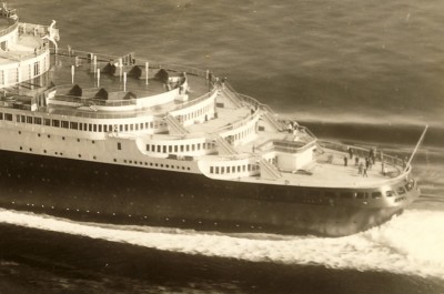

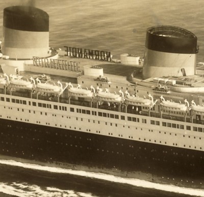

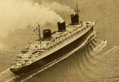

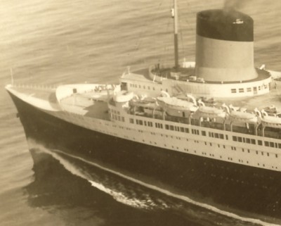

JIM BAUMANN
Posts: 5680
Re: SS Normandie 1:600
Post by JIM BAUMANN »
Looking very good indeed--a most worthy model!!
I think however the funnle tops may need to be looked at again?-especially the after-most one...
I post below some handy pics--sorry they are nor larger-- that may be of use to you
I have a number of books on Normandie--If I can assist with any specifics--let me know!
This is a very handy link
http://www.hot.ee/revall11/
http://www.garemaritime.com/gallery.php?s=10
Best Wishes
Jim Baumann

Many thanks for the pictures Jim. They will come in really useful.
I see what you mean about the 3rd funnel but unfortunately the area is in shadow and it is not so clear to see exactly what is happening there. It seems there is some sort of wire guard over the top.........I'll have to try and find more information about this area too.
I'm glad I decided to upload the pictures now ..... there are some things I seem to have missed but I am still in time to correct them.
It seems I need to decide whether to go for the earlier curved bridges, (leaving out the lounge structure aft); or leaving the aft structure there, (it's not glued in place yet), and changing the shape of the bridge .....I quite like the curved bridge ....and I think the aft lounge doesn't really improve the looks ......so I'll probably just leave out the aft lounge ..... we'll see.....
decisions, decisions ......!
Any other comments would be welcome.
Patrick
