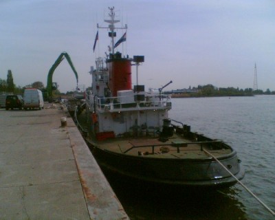

Some more pictures I took when it was moored in Rotterdam.

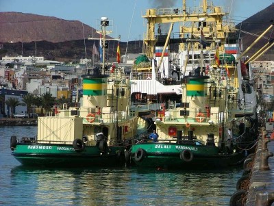

It for sure is a nice type of tug.
When I get home from holiday I will post the article about the modernisation of the vessels.
3 of the modernised vessels have been refurbished and repainted a couple of years ago at a yard close to my home. A friend of mine did the transportation from England to Holland.
2 of these vessels are the Ogbomoso and the Balali. Both sold to Nigeria.

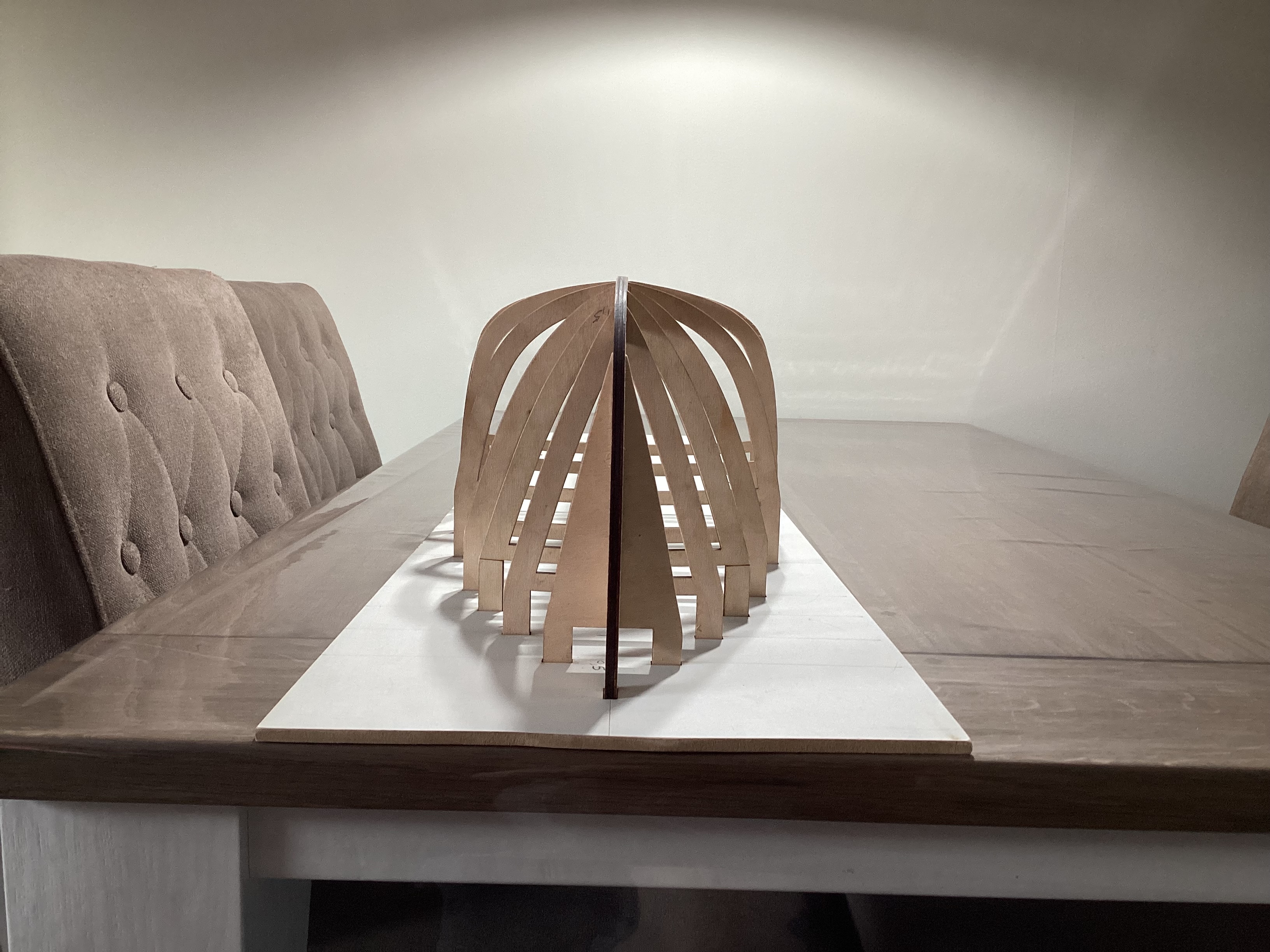

A couple of weeks ago I started drawing the frames in AutoCad.

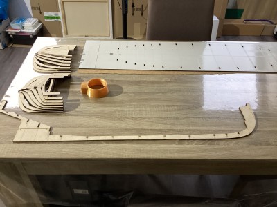

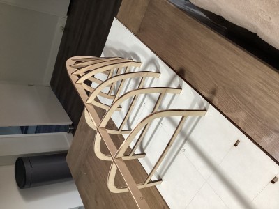

Parts are cut by a friend on his lasercutter.

File comment: Template for the frames.
File comment: All parts incl. prototype nozzle.

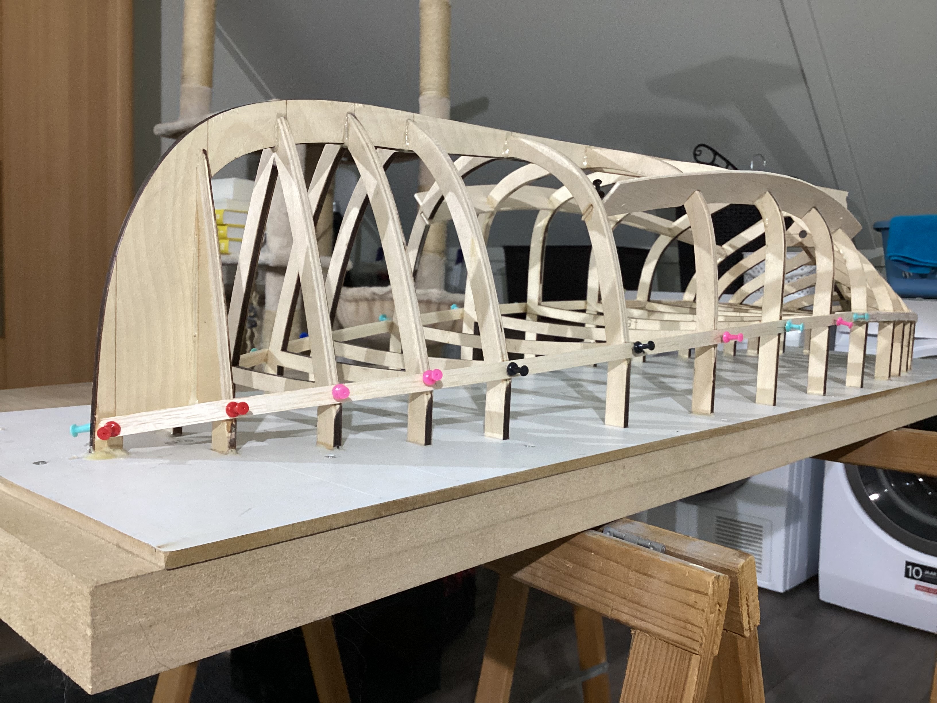

Dryfit.

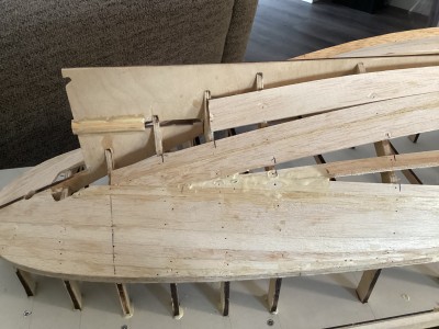

3mm balsa glued in place.

More planking.

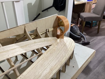

At this moment I am working on a new nozzle design. Some parts need to be removable to dismount the rudder.

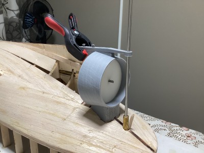

Printing the prototype nozzle.

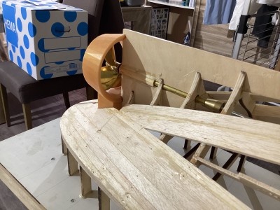

Testfitted.
Overall dimensions are ok, some minor adjustments need to be made on the hole positions.

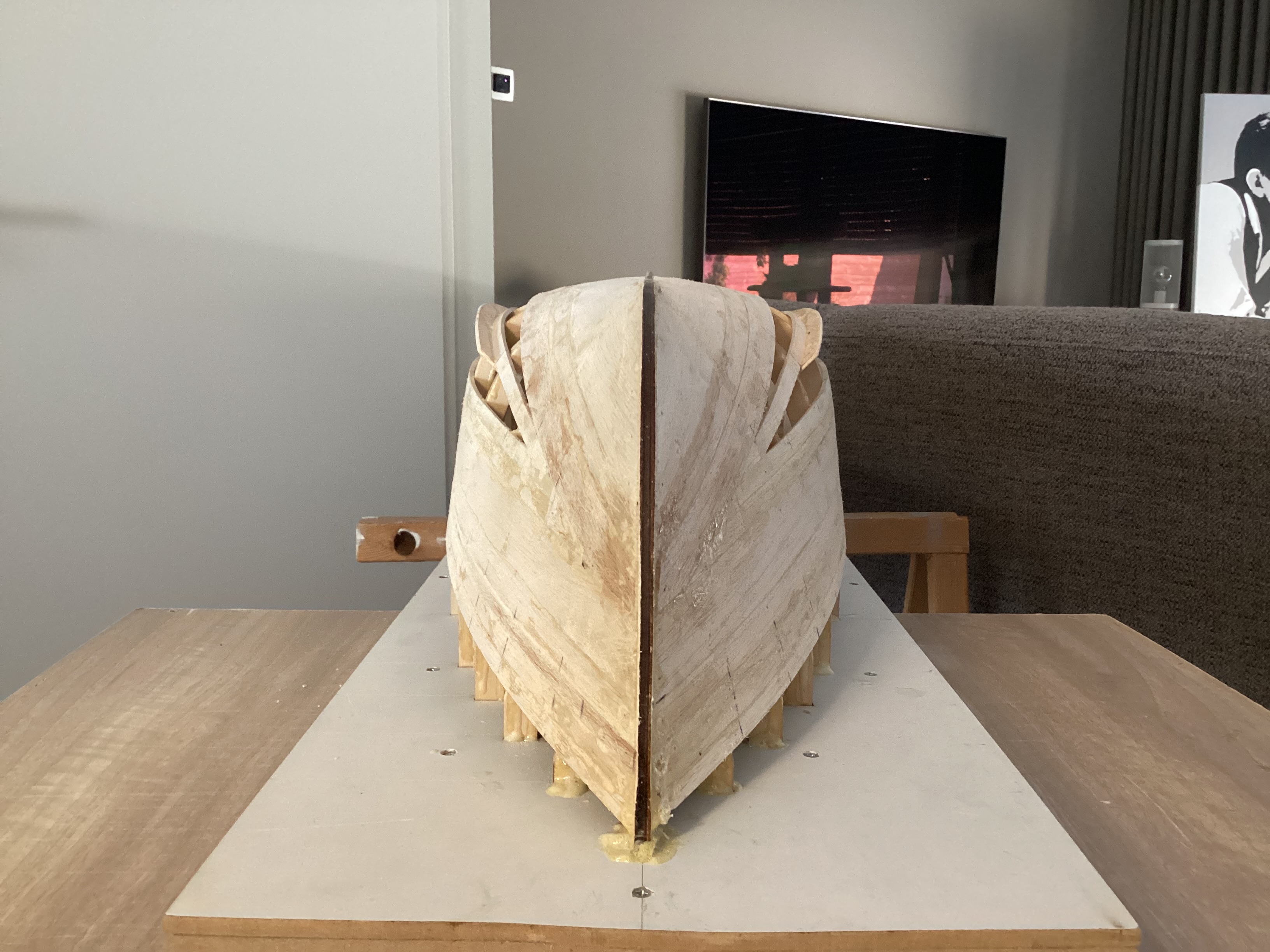

Closed the hull this week after several weeks of no time.
Now it is coated in PU resin. After sanding the hull will be smoothed out with putty.

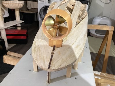

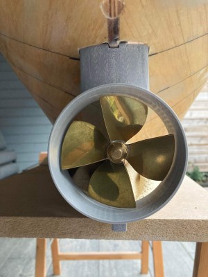

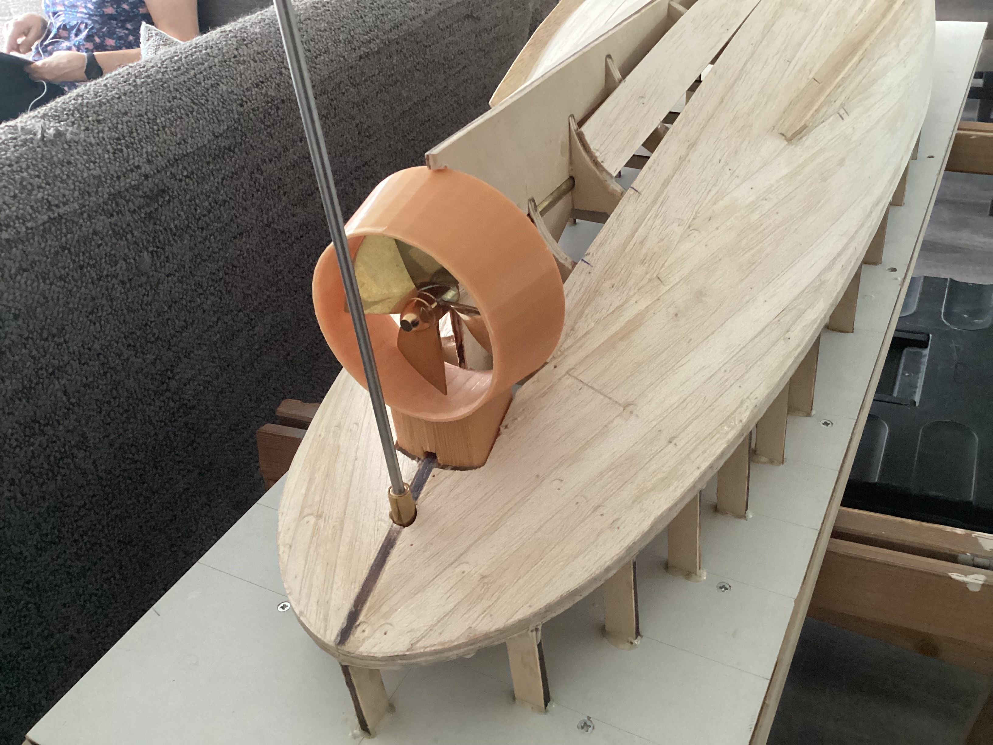

Propulsion fitup.
