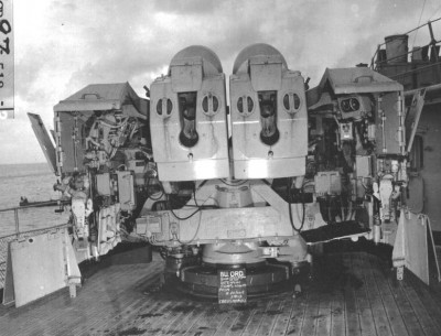

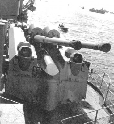

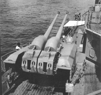

GUNS!!!
I have attached some images of the 10.5cm guns in LC37 mounts from the Prinz Eugen, they appear to be the same as those on the Bismarck have a look and let me know if this is the case.

Hi Brad
The beasties you want are 10.5 cm SK-C/33.
and 20.5cm SK-C 37.
Two variants on Bismarck.
Very interesting axial mount on these.
