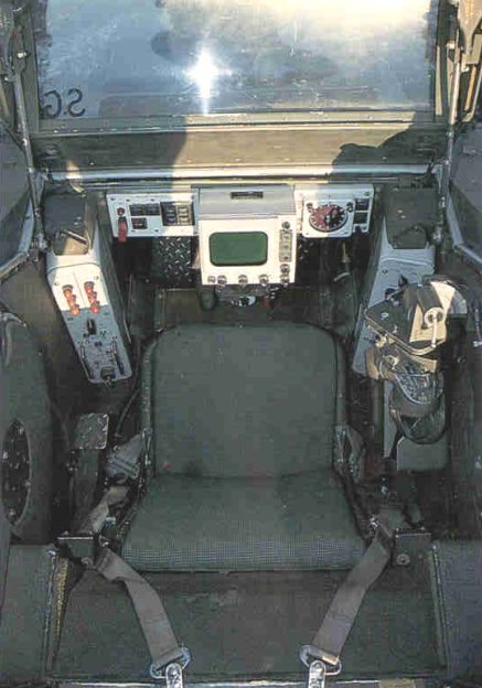

My dad Served as a FCT aboard the USS Henry W Tucker during the Vietnam war and operated an experimental SAM system called the Sea Chaparral that was mounted on the helo deck while he was there. I'm a 29 year old professional model maker and prototyper and I want to build him a desktop model of the Chaparral to give to him as a gift (and because it will be fun... hopefully) I can buy a 1/35 scale model of the Army version of the system which is mounted on the back of a tracked vehicle, but that's too small. So I'll be scratch building it, I'm not sure of the scale, but it will be about 8 inches tall when the missiles are in the rest position. I've picked up a number of pictures of the Army version including a great shot of the interior.
I've got some questions for the experts though. Would the seat be covered in the same color fabric if the system was on a ship?

As far as I know the units used by the UN were simply lifted of the army's tracked chassis(The turret was mounted on a pallet) and bolted on the ship's deck, so I would guess the interior would be identical to your photo.

The fire units were borrowed from the Army. The only changes made to them by the Navy were:
-Gyro stabilization in elevation, to make it easier to stay on target on a rolling deck
-An auto track function. In the Army version, the gunner had to keep the target in the crosshairs manually, in the Navy version, once the missile aquired the target, the missile's heat seeker took control of the mount and kept it pointed.
-A remote designation system that allowed a radar operator in CIC to point the mount in bearing.
-A very minor modification to the intercomm system to allow connection to a Navy sound powered telephone circuit.
None of the above had much impact on the outside appearance of the mount.
