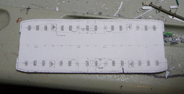

Have been having some problems with programs not outputting drawings at the same size they were input, leading to the delays thus far. I should be able to get a paper test hull by tomorrow, if not tonight. Thanks for reading!

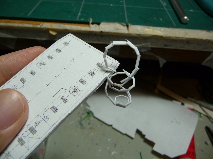

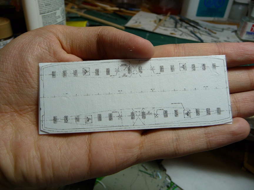

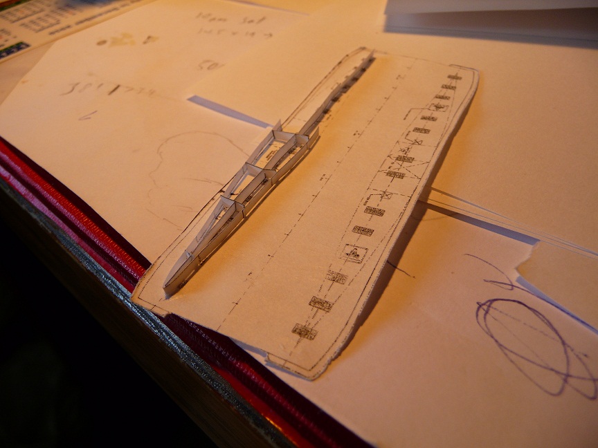

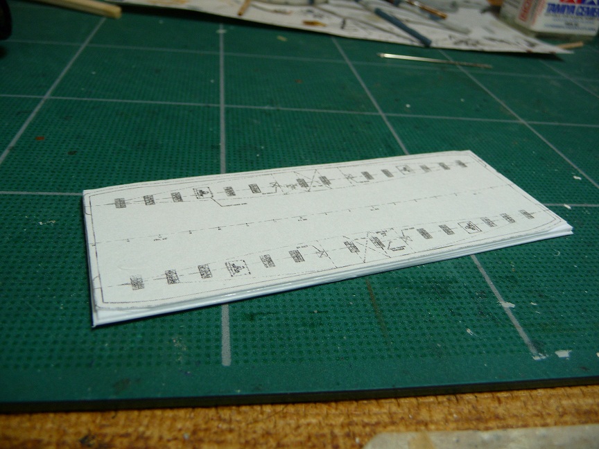

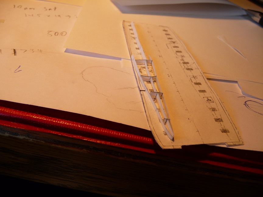

Ok, absolutely nothing astounding to see here - just a paper mock-up of the frames for the hull, and not even a complete mock up; it's just one quarter of the hulls
Hopefully I can get around to making the styrene versions this weekend!

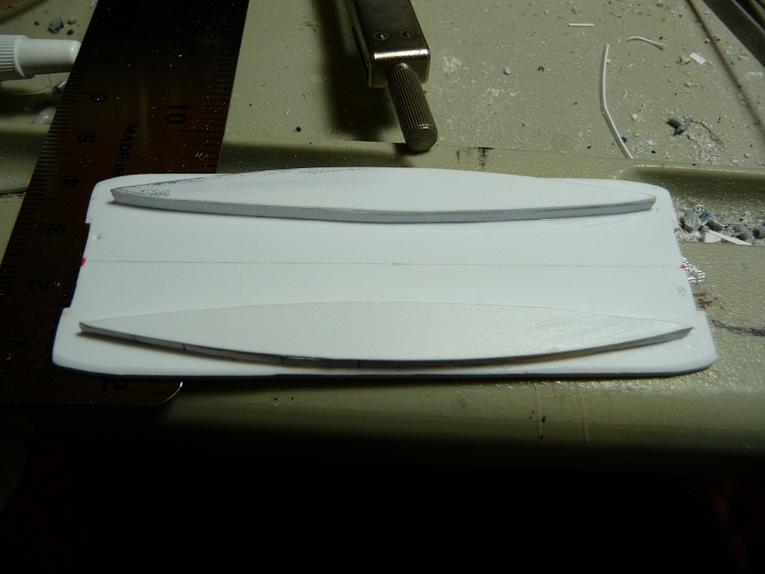

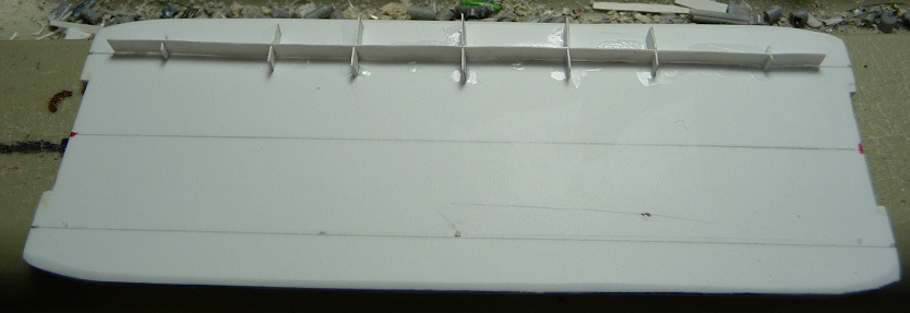

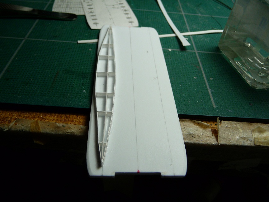

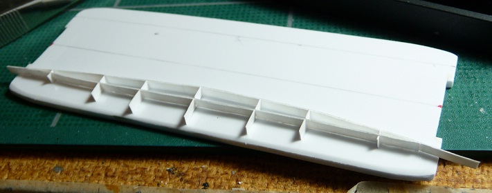

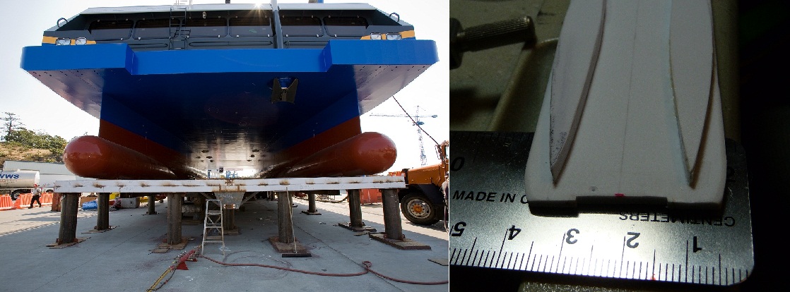

One of the hulls is now constructed - waiting for the putty to dry and then it can be sanded. The frames, keel, and sides are .005" (0.13mm) styrene with paper superglued onto one side. The waterline plate is 0.5mm styrene and technically hangs below the waterline.

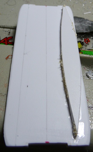

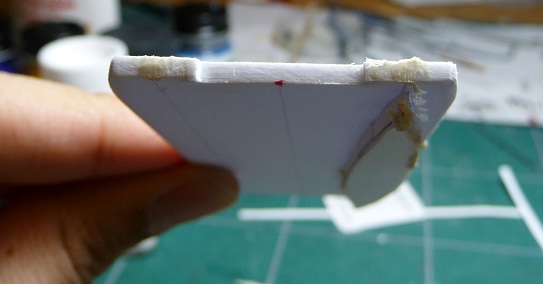

Today I attached the other hull! Yay! And they both look decent.
The second hull was made using the sandwich method, as I ran into depressions on the side of the first hull, requiring much putty and ugliness.
None the less, both are now attached (the one farther away from the camera is the sandwich one):
The anchor wells are also drilled out. Now comes the question of whether to make the anchors separately or molded on (as this hull structure will be molded as one piece later). While generally it makes sense to make them separate for the modeler to choose, the tiny size of the anchor may not make it feasible to do so.
As you can see below, the anchor is much smaller than the ones we see on warships: Any opinions?

Hmm, good question. Molding them seperately will for sure make them very weak and breakable! To make the master, I guess even using a piece of PE sprue to cut out the flukes of the anchor. Perhaps leave the option for the modeller to do the same. It depends on what type of kit you want to make out of this. Something like a full kit, or a semi-kit, leaving some stuff to do to the modeller.
The PE piece would be the strongest for such a narrow thickness and small size. Molding them in will be very difficult as these small angles and spaces would be very difficult to mold (I think). I suppose those are easy places to get air bubbles in the mold. Just my opinion though, I don't have any real molding experience myself. Also perhaps the risk of breaking them off when releasing the cast.
So, the conclusion for me would be either make them seperately with PE or give at least a drawing, in scale of these anchors with the kit, to let the modeller make them himself.
Good luck with your build

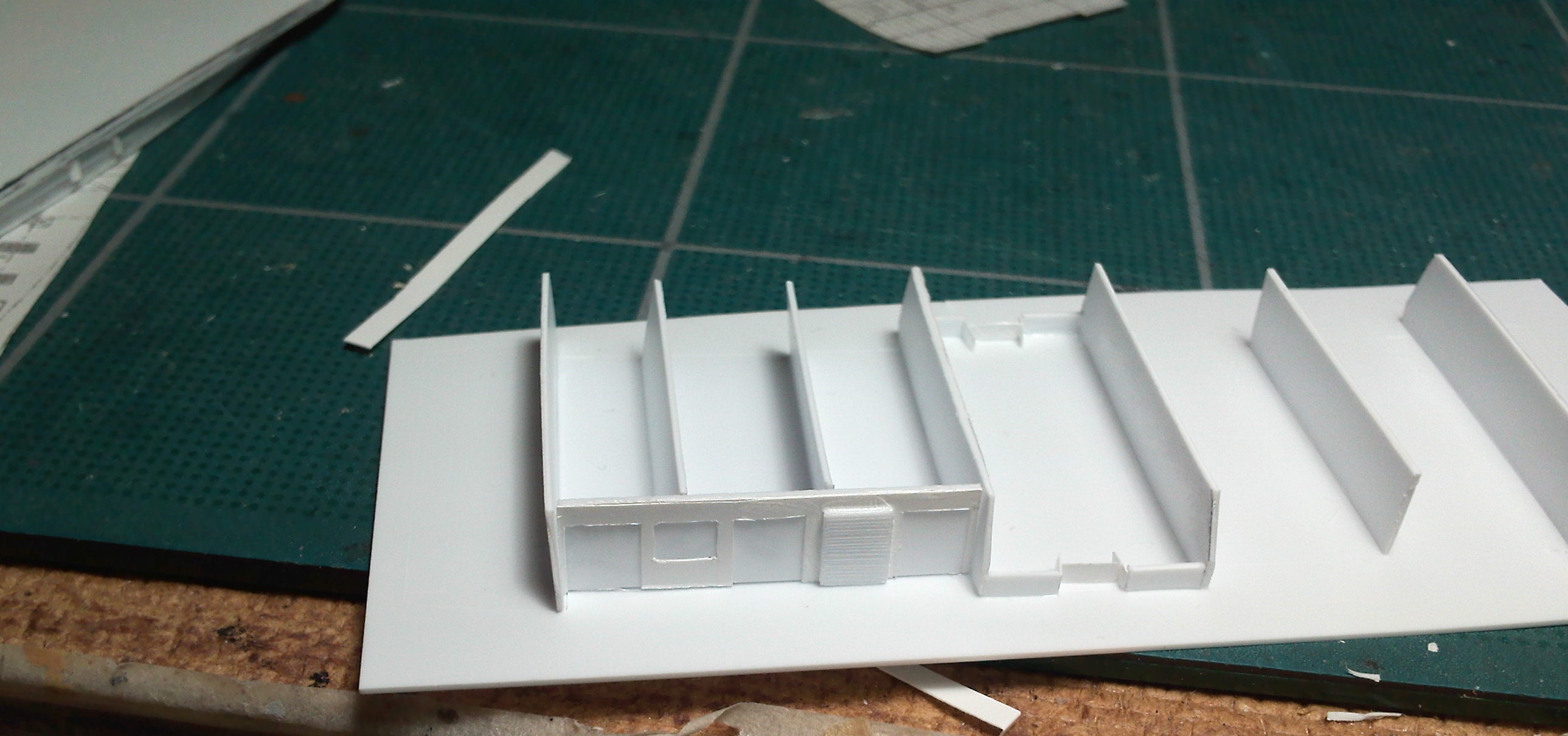

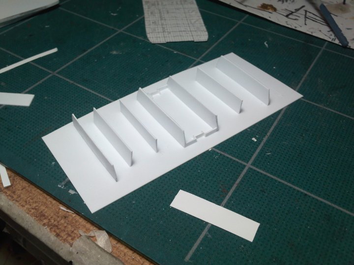

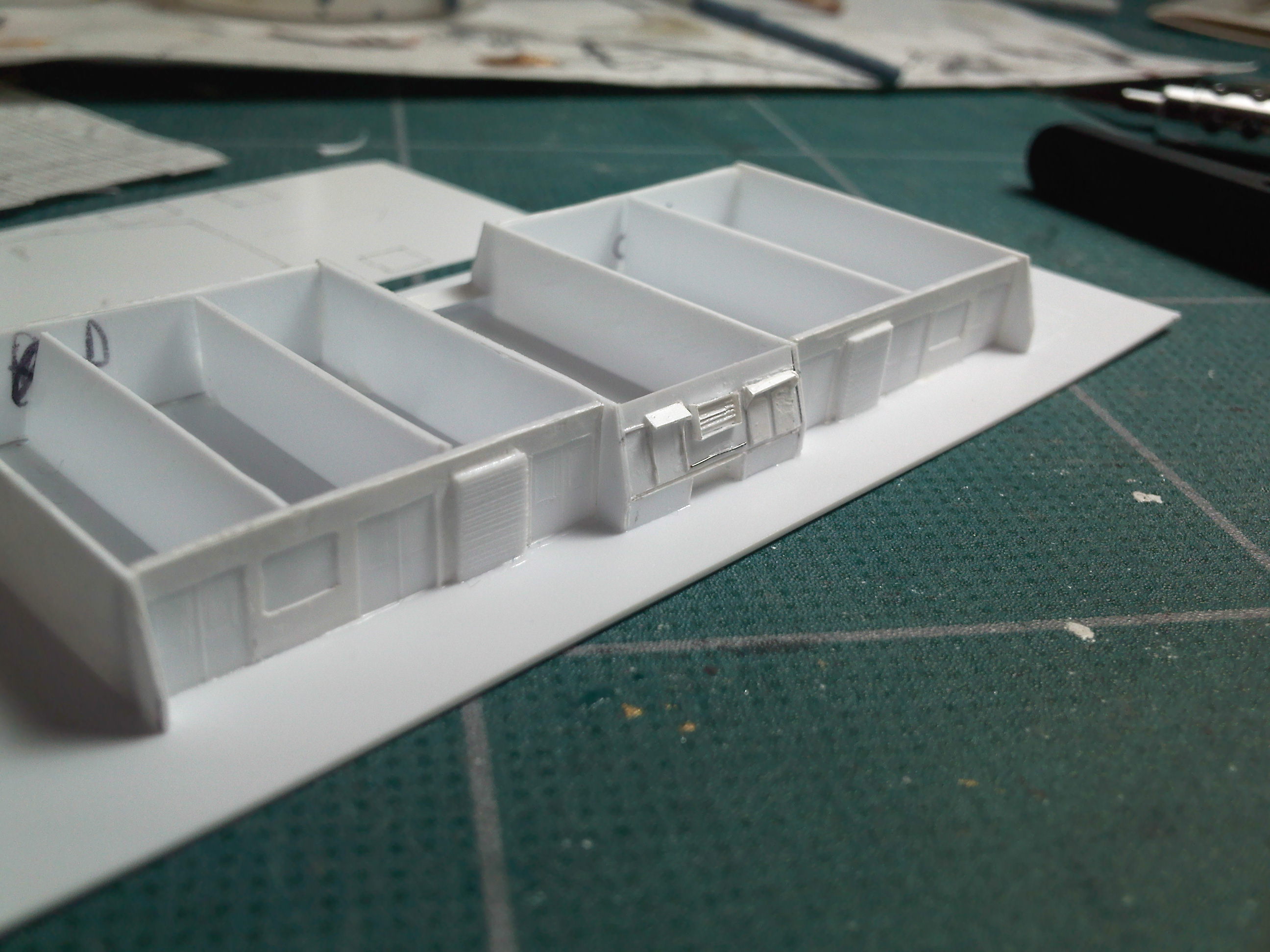

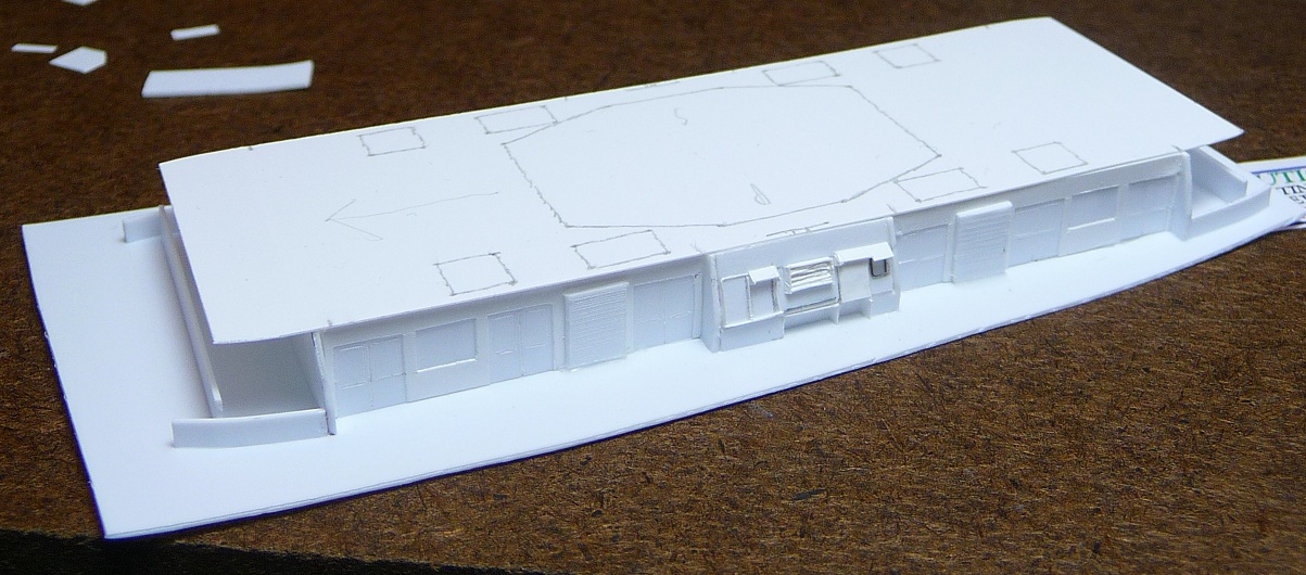

Today, work began on the passenger cabin. More complex that I was hoping, particularly in how to make the recessed doors.
And thanks for your input, Neptune! In the usual way of doing things, I'm putting off on that anchor until a much later date

Detailed this area of the bulkhead. Fingers crushed the right-hand side visor while the plastic was still "soggy" from the cement, but managed to make it somewhat acceptable with some shaping and slicing.
It's messy, but I'm still learning as I go!

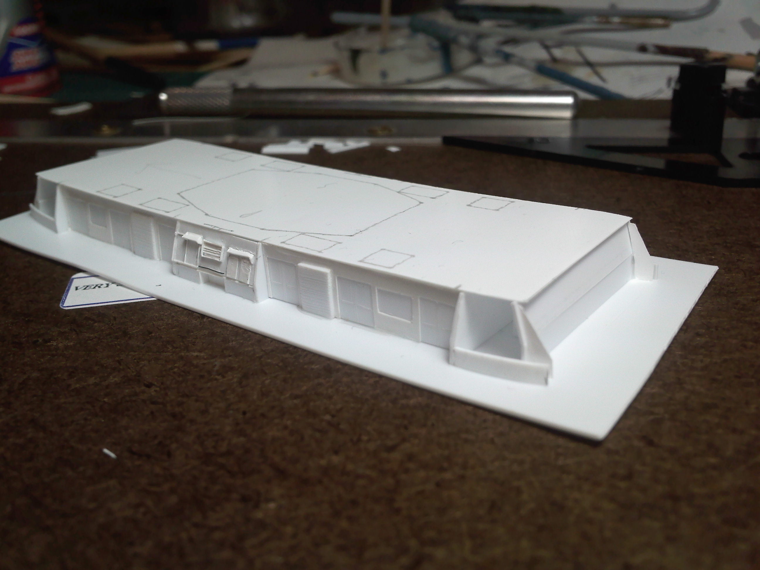

Right then, here's what I got done last week. Finished the detailing on the port side bulkhead and added the bottom halves of the four curved bulkhead corners of the cabin. The cabin roof is not glued on (may have to be redone due to warping of the base

welcome back home timmy the pacific breeze is looking good .styrene is tircky stuff sometime. on larger areas as decks and such i will use wood skined with thin styrene to eliminate this problem.
- Posts: 12463
Re: 1/350 Burrard Pacific Breeze
Thanks for looking in, Mark!
You're right, Russ - in retrospect, I should have glued a metal "spine" to the bottom of the base!

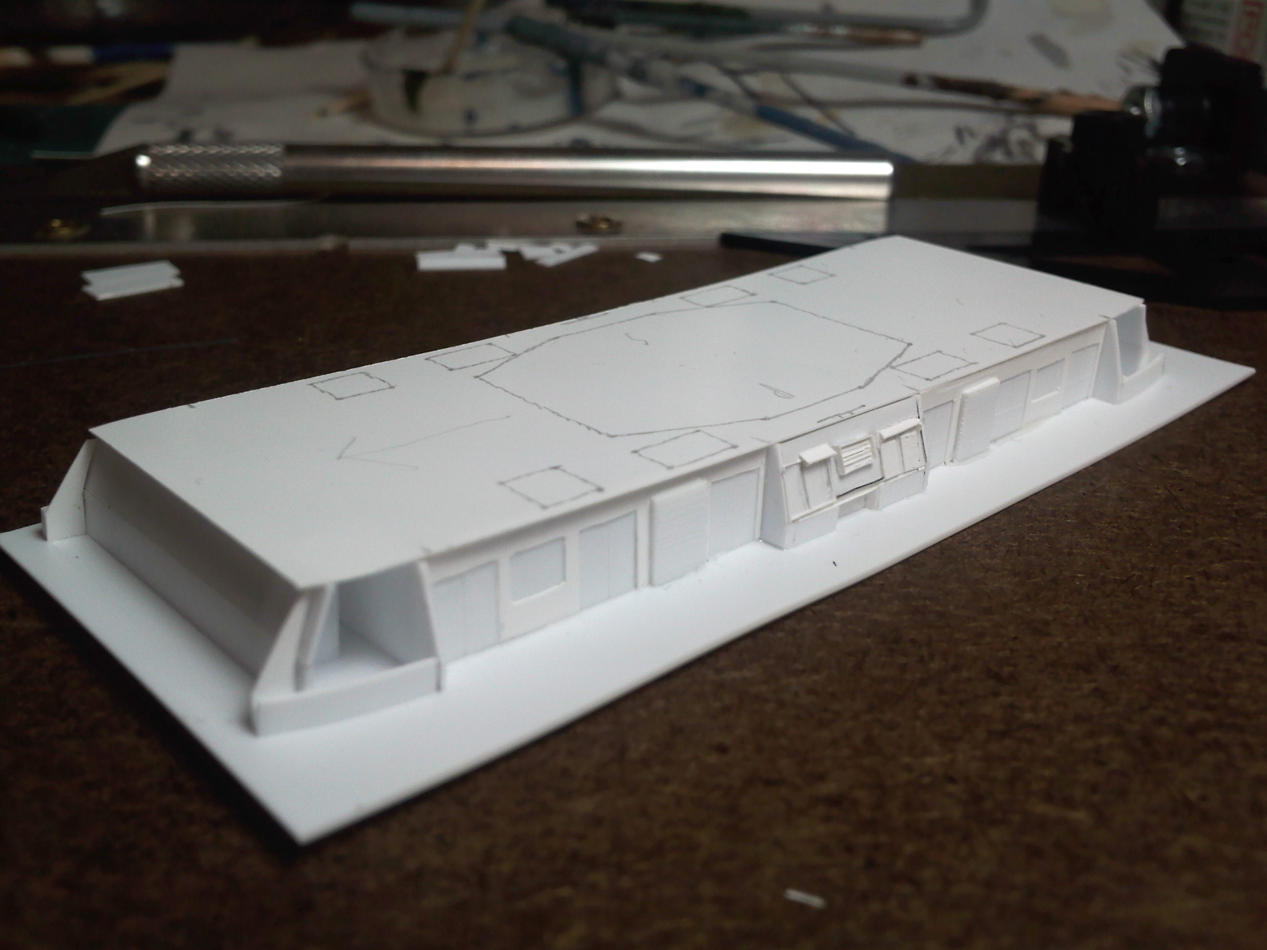

- Posts: 12463

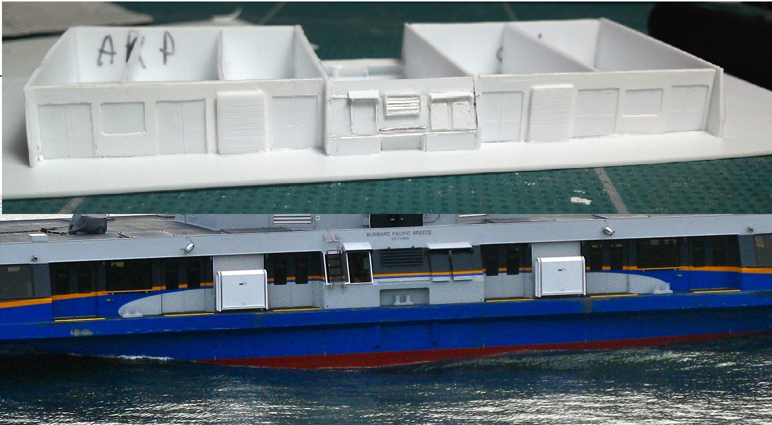

Got the fore/aft bulkheads roughed-in on Tuesday. Trickiest thing was to build the angled bulkheads on the four corners:
