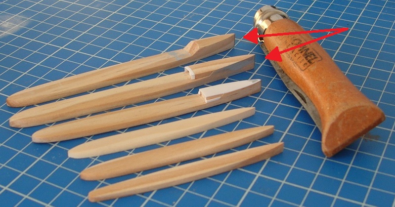

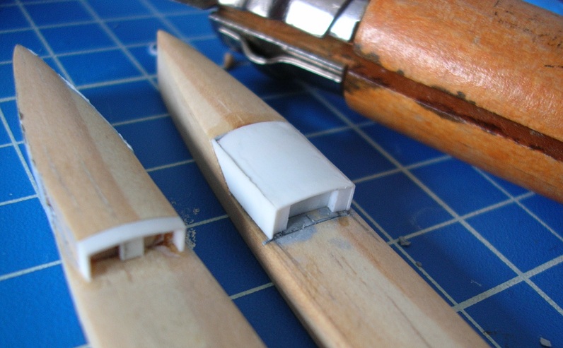

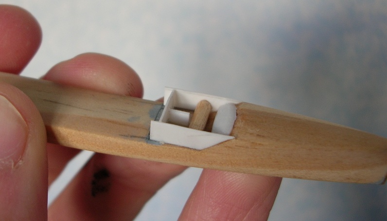

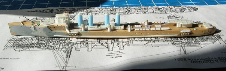

The hull cut in wood: started two of them (red arrow) in order to try different way of buiding the forecastle

Hi Moomoon building from scratch is difficult at large scale but you are building at 1:700 . Seldom seen as working models yet an interesting subject non the less. Question what type of timber are you using to form the hulls ?

Hulls are made with vulgarious pine wood. I just try to find a bit with uniform density. Harder wood would be better but too had for my electric saw. Softer would be too fragile and make it hard to cut "sharp" details. Cost is almost null :smallsmile:
Yet on this kind of forecastle it was a bit laborious, probably a full plastic hull would be better, but I enjoy being outside cutting my piece of wood (good substitute for ex-smokers I'd bet).

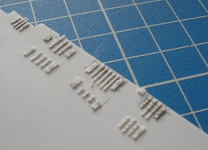

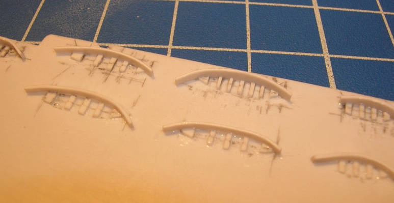

I did the boats as usual: 0.3mm plastic strips over 0.5mm sheet, wrapped with 0.3mm, sanded, electric wire added for the keel.

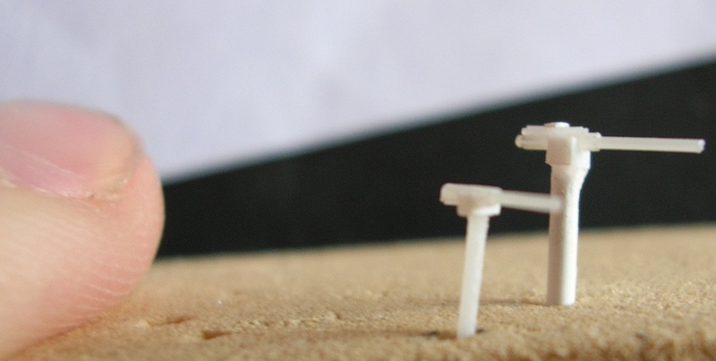

Here are the guns: the ship carried 2x100mm and 4x65mm, but I did much more as I would be lucky not losing a few...
100mm
100mm
65mm
65mm
65mm (left) & 100mm
65mm (left) & 100mm

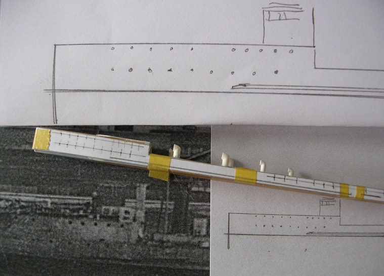

My plan didn't show the porthole so I found a side view pic, traced the position on paper, reduced the result to correct scale, and here we go :-)

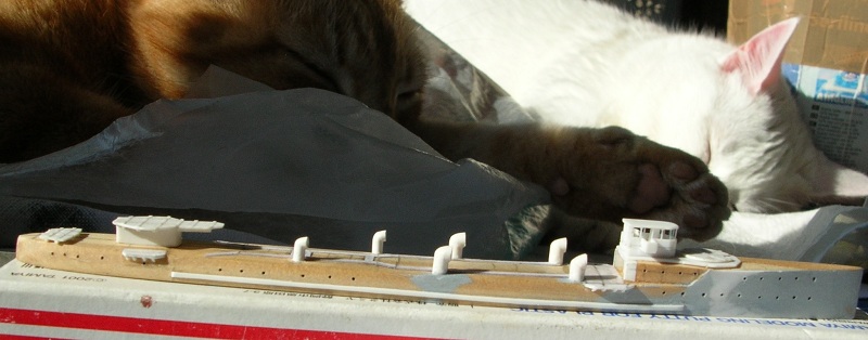

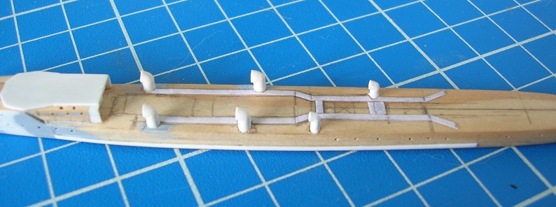

Air vents are plastic tube cut at 45� and glued together again after a 180� horizontal rotation of the upper part. Wood plancs or grating were used as anti-slid ways, I figured these with paper+CA. also added the hull reinforcement with 0.3mm plastic sheet.
Rear "superstructures"
Bye.

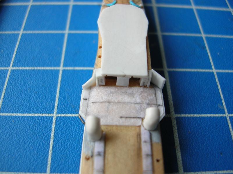

Update about the bridge and and side guns positions.
Bye

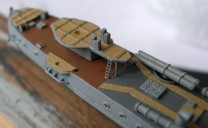

Should start to look like a ship now :smallsmile:

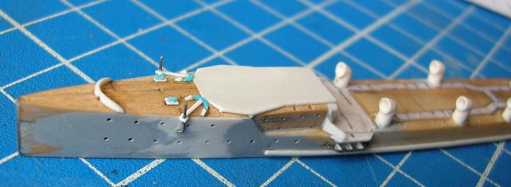

Been working on forward deck details:
Bye :wave_1:

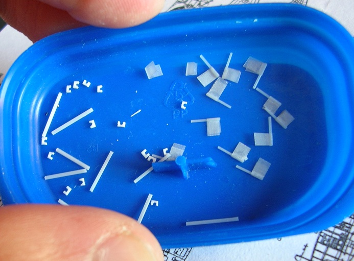

I've added eyebrows to portholes (electric wire cut as explained by Edward Pinniger and J. Bauman).
Also did the mast with straitened brake cable, adhesive paper, electric wire and Cyano glue.
glued the model on a support so that my fat finger dont mess the painting to come. Most of parts are just dry fitted so that I get an idear on how to do the aerials (I'll drill holes for them in hull before gluing details).

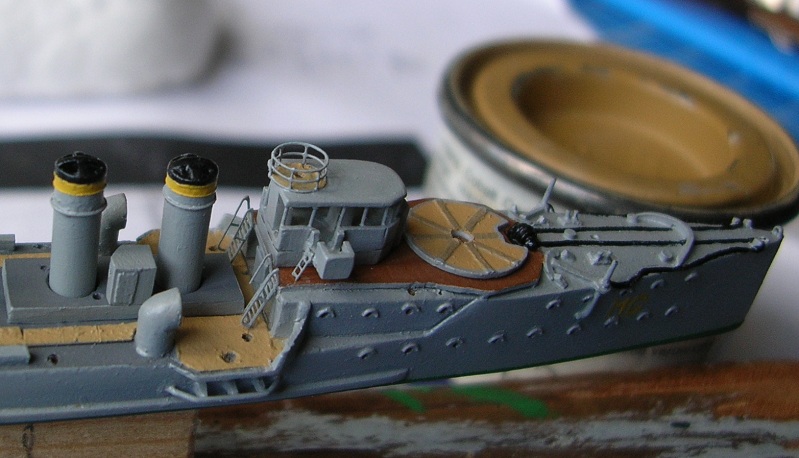

Painting is in progress... as well as the hull of a few other dozen projects :big_grin:
Corticene area (brown) is only guessed... I used humbol enamel paints 164, 165 (dark&light grey), 186 (brown) and 94 (wood planks).
bye.

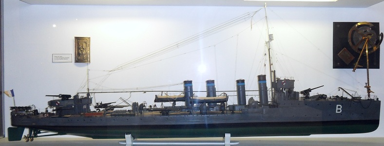

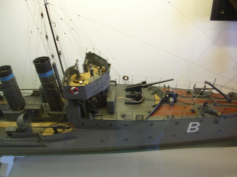

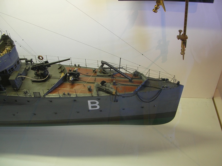

I found beautiful examples of 800t dest at the "Mus�e de La Marine" in Toulon (nice place to visit) where you can see two splendid 1/100 models made by a very talented modeler called Jean Bart (!!!): Le Bouclier (prototype of the serie) and La Fourche.
Le Bouclier
Le Bouclier
La Fourche
La Fourche

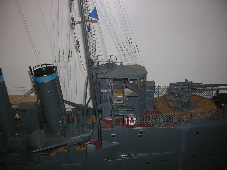

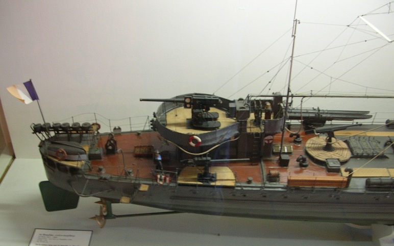

I do have more pics, here are a few of this superb 1/50 model made by Mr Jean Bart (+1980):
It shows the ship late in the war or after (at least 1917, Bouclier was to first to have his forward funnel rised, most of the others only had some kind of a funnel cap added afterwar).
Mr. Jean Bart's model
