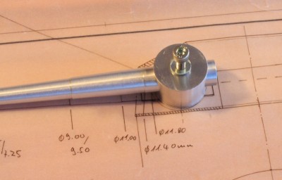

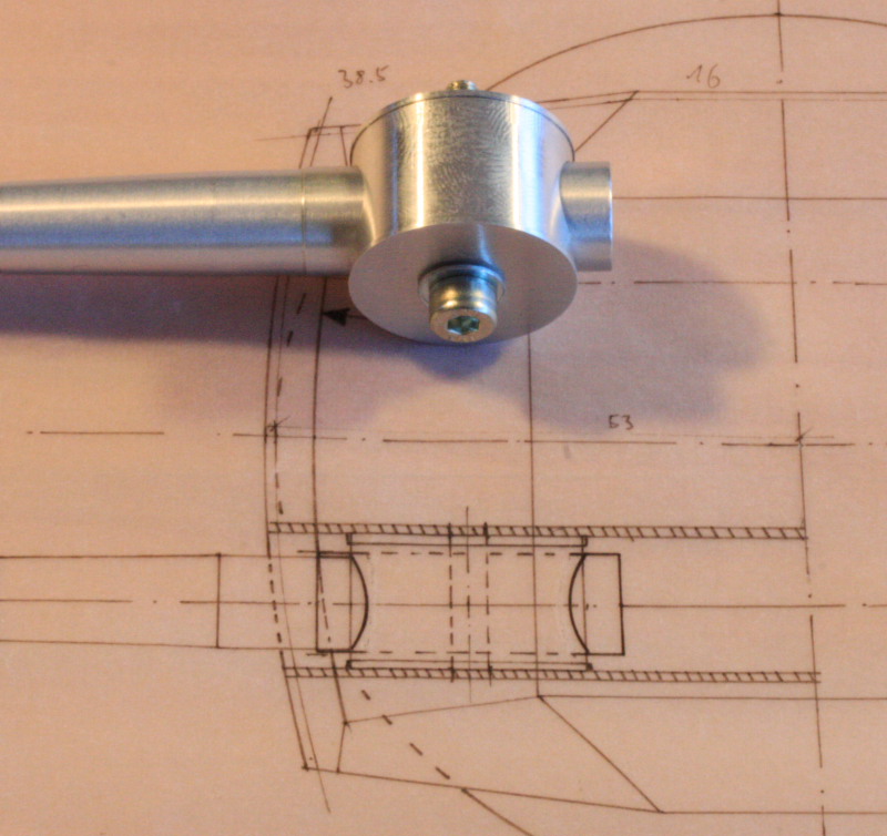

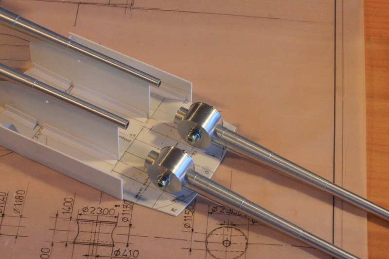

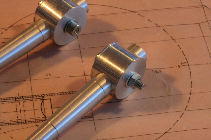

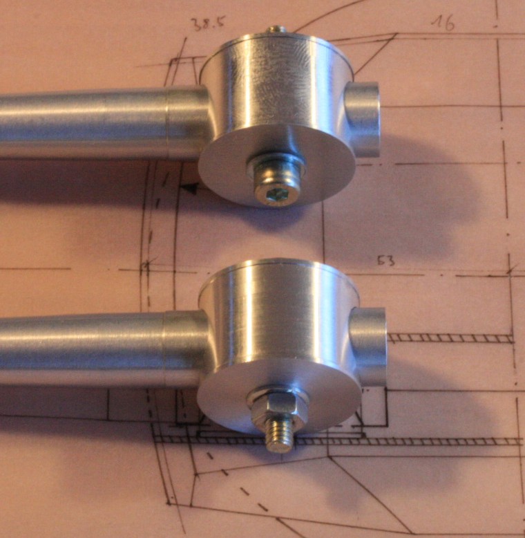

some time ago I actually started work on Bismarck´s main battery. I will first build a study model of styrene before I commence work on the final model. However, gun barrels are the final results of my research (turned at a friend´s friend lathe). I need to get my on lathe in 2011 - any recommended machines, please?! :cool_2:
Bye!
»Als ik kan«
http://artisanmodeler.blogspot.com/

And a final pic:
»Als ik kan«

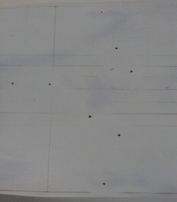

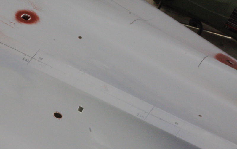

added circular and oval openings in the hull bottom using a pumpgun .... just kidding! :cool_2:

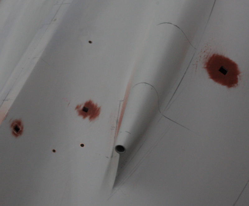

»Als ik kan«

Hi Bernd Your gun barrel arrangement is excellent .It will be interesting to see how Kiwi Medic installs his as they elevate independently in each turret.
PostPosted: Sat Sep 18, 2010 3:32 am
Posts: 557
Thank you all for your kind comments!
Dave: my barrels will move just by hand as I do a static model. :smallsmile: Just a simple bolt running thru the splinter bulkhead and the gun shield...:D I also look forward to see kiwimedics progress on his Bismarck!:D

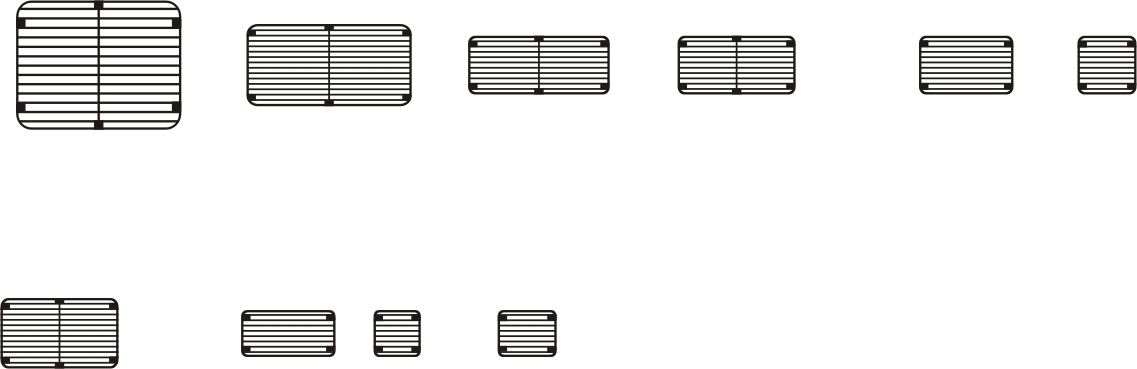

I am working on my first PE parts for the grills of the sea chests. I have on foto of a grill and when compared to these pictures:
http://www.randive.com/sea%20chest%20cleaning.htm
I come to my reconstruction (see attached file).
What do you think??
Bye!
PS: does anyone knows a reliable etching service which delivers high quality work?
File comment: Grills for sea chests
»Als ik kan«

Thanks for that hint, Peter!
Smallest dimension = thickness of brass sheet - as far as i know that´s the basic rule?
Bye now.
