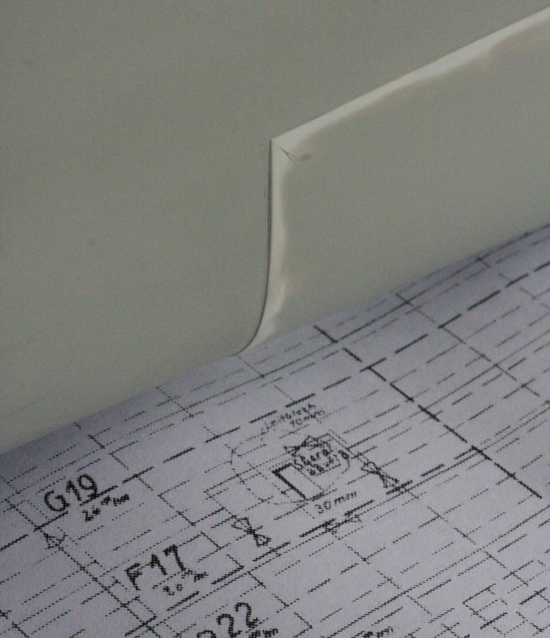

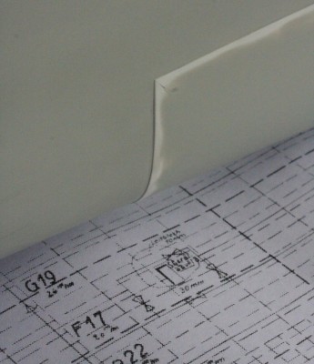

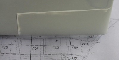

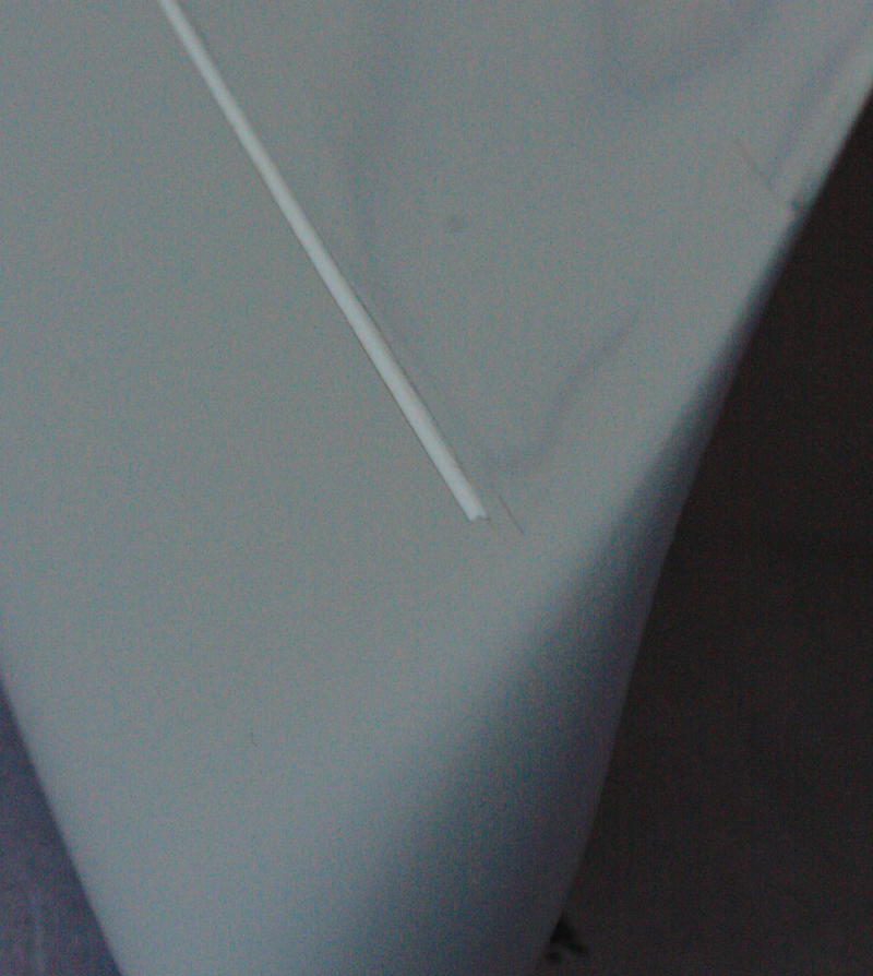

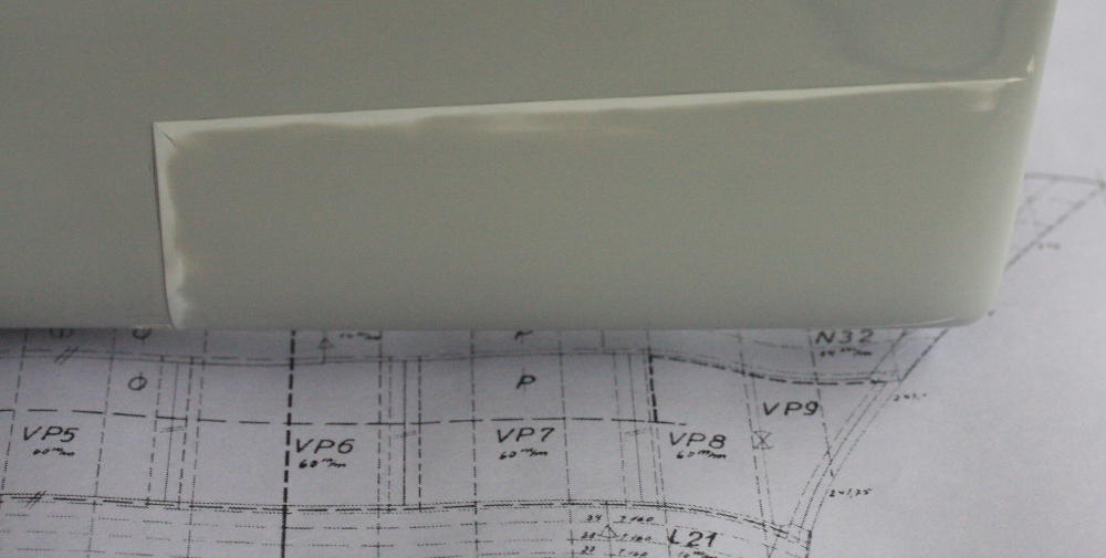

Hi Phil,
on http://www.scalehardware.com/ you can find miniature rivets made from brass or stainless steel ...
I added a few pictures of yesterday´s work ...
Bye for now,
Bernd.
File comment: After sanding I added a coat of primer which laps onto the styrene strip
File comment: Final wet sanding (800 grid) and fine tuning.
