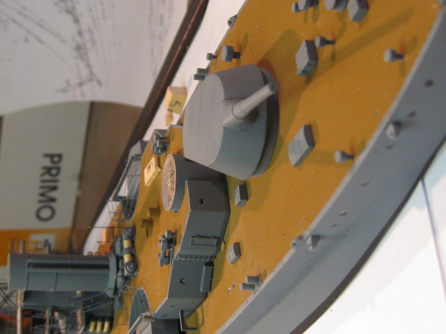

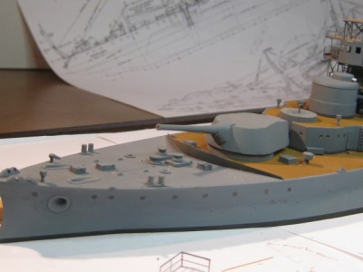

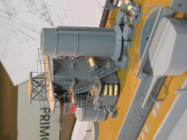

I started building this model 3 years ago (I'm terribly slow), I hope I'll finish it before this year's end !
It's based on the National Maritime Museum plans.

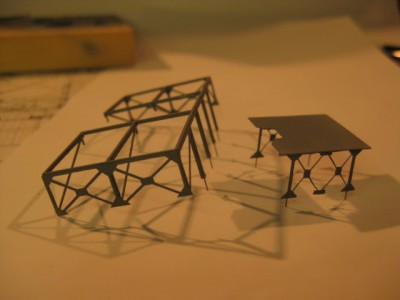

here's the new production
File comment: This is the structure which will support the boats. It's photoetched

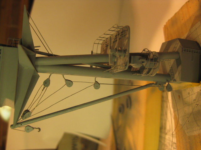

File comment: My main mast mast is nearly complete with the derrick.

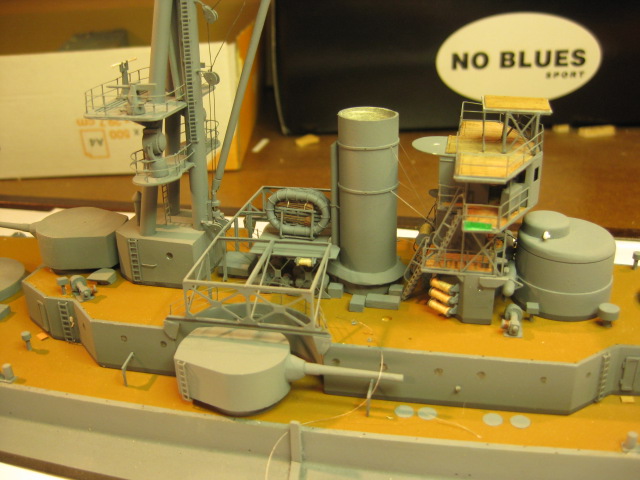

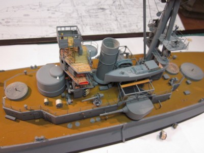

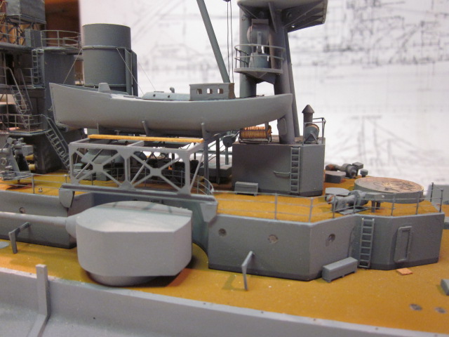

I've done some work
The main mast is now glued to the deck
The metallic frames supporting the boats are also in place, and I've glued some stiffeners on the funnel (I made them with unithread 8/0)
The Carley floats are not glued yet

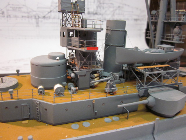

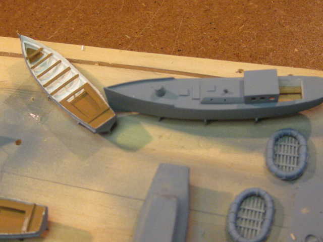

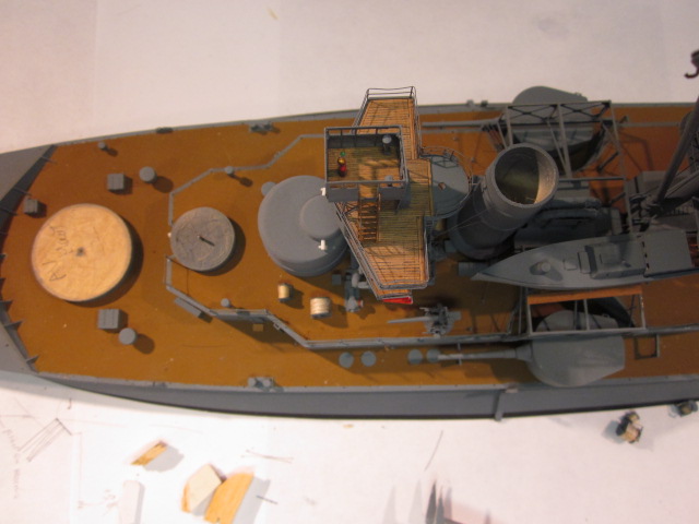

Summer's almost gone
I can resume work on my model.
during the last two months it was very hard to find time to work on it (beach fiestas) without a trembling hand.
I've fixed the railings on the port side of the boat deck : stanchions : entomologic needles 000 and nylon fishing thread.
The 3" HA gun is not definitely glued, neither the motor boat which is not finished
The compass platform is almost ready (the chart table needs to be glued on place)
There's too a lot of minor paintwork to do

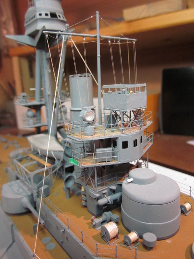

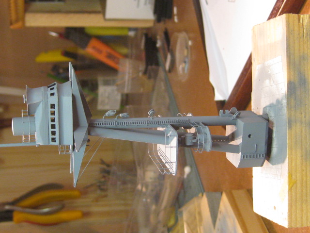

I've done some work !!!

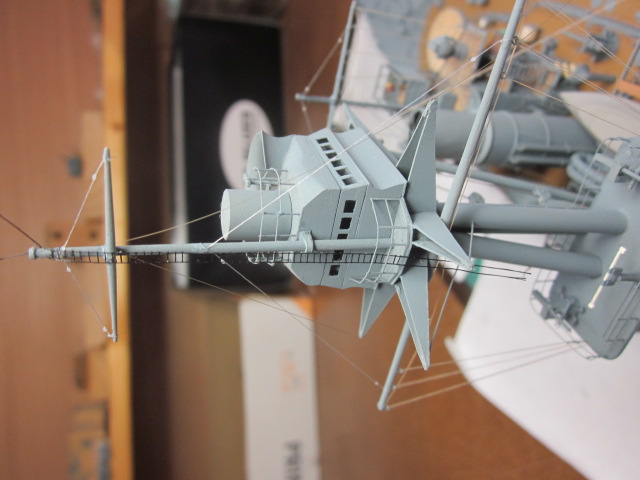

I've fixed the foremast. I tried to make the signal halyards with Uni caenis wire, but I was dissatisfied with the result (too much sagging).
I've then tried the stretched sprue method of Jim Baumann and it worked perfectly (and quickly) Thank you Jim :thumbs_up_1:
For tightening the sprue I used a rolled cigarette as I have always have one in the mouth !
Edit JB-- rotated photo

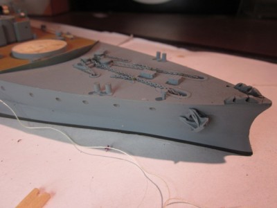

File comment: Anchors, chains and stoppers are finished (a little painwork left to do) but the catseyes have been blown away in the process

Excellent!
I am happy that it worked well for you in a larger scale also!!
I actually developed the smoke method using Gitanes and Gauloise cigarettes--then I moved on to Camel Filter... :big_grin:
then... 11 years ago...
I gave up smoking--hence I now use incense sticks fro tightening rigging.
Model room smells like an Eastern Temple!
JIM B :wave_1:

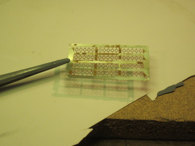

I've done some work
File comment: I tested the making of radio aerials.
I photo etched some rings and glued Uni caenis on them. It worked at the 2nd attempt.
A big problem will be fixing them on the yards

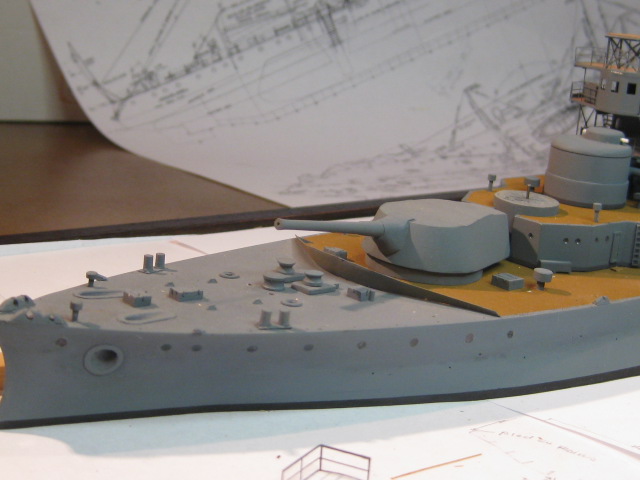

File comment: I've finished the forward part of the upper deck.
Still need somme painting.
The Jackstaff will be glued at the last moment

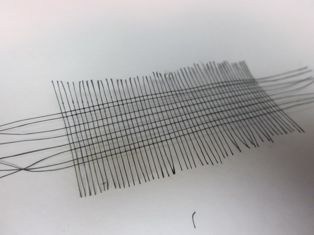

I made the rope ladders which lead to the the top of the masts.
I had to build a jig and glued the wires with shellac
File comment: the jig

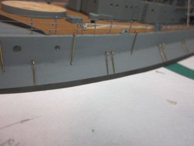

File comment: There's a lot of vents (approximately 18 on each side)
