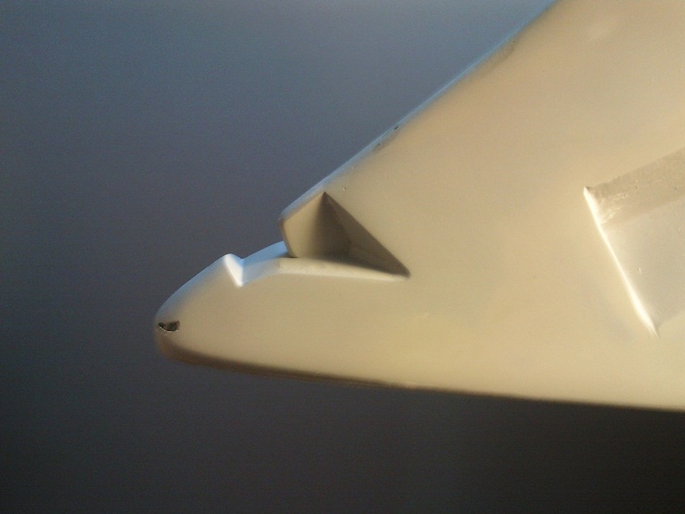

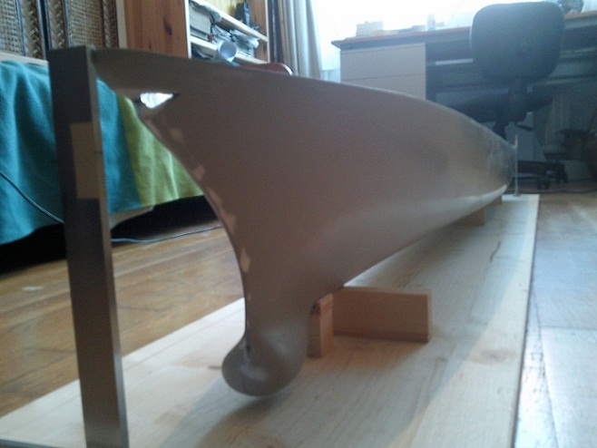

I've been working hard on the hull lately trying to fill blemishes and air bubbles. The hull is full of air bubbles, especially along the keel where the to halfs of the mold meets. These little pores are really hard to get rid of as the air trapped in them tend to keep the filler out. I used CA glue to fill the holes then sanded the surface smooth whit 600 grid paper. I repeated this process a lot of times but some of the holes are still visible.
The wooden stand is ready so the hull can be stood up straight. It's pretty basic but does its job.
File comment: I cut the front hawse port out because it was totally out of shape. This will be rebuilt whit styrene bits.

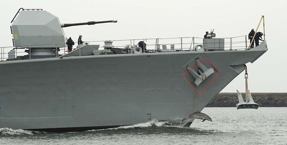

Some progress on the fornt hawse port. I discovered that the starboard side hawse port is also out of shape and it's position is incorrect. I'm not sure if I want to rebuild that though.
File comment: Location of hawse port on the real ship.

Looking good! :thumbs_up_1: It's nice to see an other Duke in progress, please keep me posted as you proceed! I'm trying to figure out that starboard anchor location right now. I'm only guesstimating cause I don't trust the drawings any more but once I find the correct dimensions I'll let you know.

in order to try to help you estimate sizes on a ship. A standard railing is approx 104cm high from deck to top. Deck to first stanchion is about 20cm, between lower and middle stanchion as well as middle to top is about 40cm. That'll give you some in-between sizes to measure and estimate sizes of other objects. Railings can be found all around the ship, so they give you a reference in a lot of pictures and places.
Good luck in correcting this. If you have a good car-body filler you could fill the anchor place entirly and start out from 0 on that.
Hi Neptune,
Thank you! You really helped me out here! :woo_hoo:
I will cut the whole port out of the hull and start to build the new one from there.
