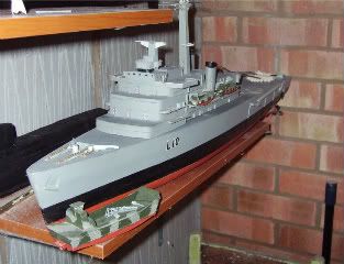

I think it's great and look forward to the pictures of the models as work progresses. I have just started scrutinising my drawings of HMS Andromeda and will start on the frames shortly. The ship above is HMS Fearless in 1/192 which was made as a partner to HMS Leander. The submarine is HMS Resolution again a scratchbuilt model and to the same scale.
