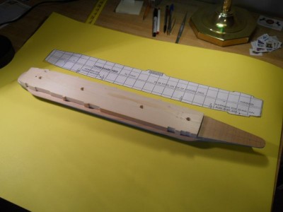

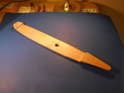

I am attempting to build a model of the USS Midway as she appeared about 1954. This model is being built using the plans found in Popular Mechanics 1954. I am keeping to the notion that it will be in the style of the WWII era ID or Teacher models. This allows me to not think that I have to super detail it. If I get wrapped around the details I will never get it built. It's my walk before I run phase. The scale is about 1/500 and I am building it from wood salvaged from projects in my garage. Right now that is all pine. Since this is the 1st time I have posted a project let me see if I can include some pictures. Rich
File comment: Basic hull cut out of pine.
File comment: With the sponson deck in place.
File comment: Hanger deck set in place.
File comment: A quarter bow shot.

I thank everyone for their kind words. The plan was published in four issues of Popular Mechanics in 1954. No I did not get these issues off the newsstand myself. I got them from ebay but then I found them at Google Books. I enlarged the plans several times until they were full size. Then cut and tape. The wood is pine boards about 13 years old. What you can't really see in the pics are the lines drawn on the hull. I cut out a set of body plan templates and went to work with a few carving tools and sand paper, Once I get enough done to show progress I will post more pics.
