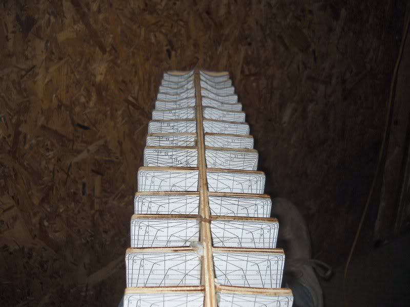

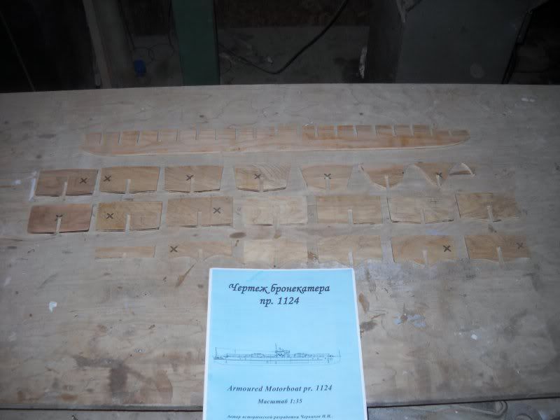

The keel and bulkheads cut from 1/4 inch ply . :wave_1:

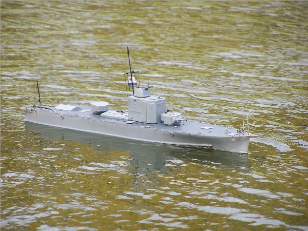

I built a very stand off scale version 15 years ago I'm looking forward to seeing more as the build progresses.

Yep,, she gets the occassional outing still.
My 1125 has a Tamiya T32 turret and the 1124 has 2 x T28s robbed from Zvezda tanks bought in St Petersburg in 1995!

PostPosted: Fri Feb 25, 2011 10:23 am
Posts: 1012
Hi All :wave_1:

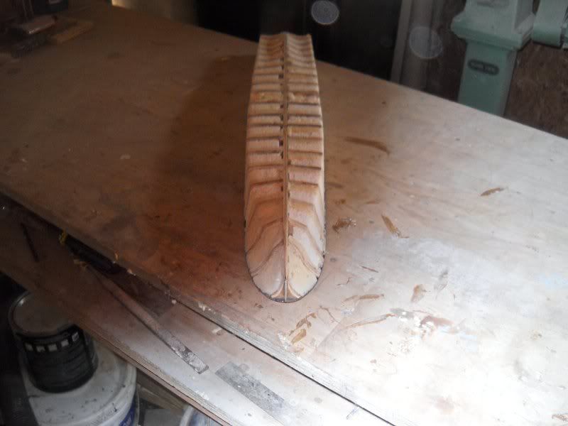

All framed up .
I stole this from Bill Waldorf. He puts a styrne strip on the bow to keep it straight while forming .I figured alum would work even better .

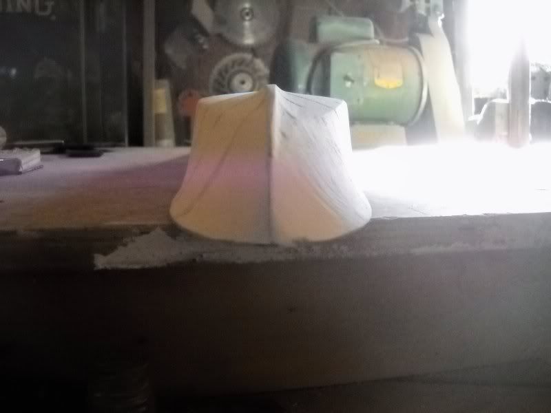

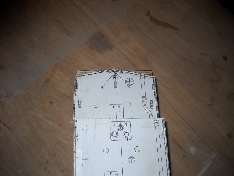

The deck template glued in place .
The stern was canted but the frames are straight so the area between the frame and the deck template was filled in with basswood then sanded to the deck template with a 12in disc sander .

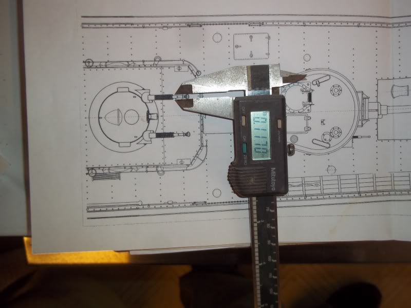

Dusted on my Compact 5 lath .I haven't used it in years since I got my full size on .
I don't have a diagram of the 12.7mg barrel so I had to measure off the plans .
Used a OO center drill .
The brass rod is .156 so it had to be turned down to .117 which is the largest dia.of the barrel.
This is when I ran into problems . :mad_1: The motor started to get hot and slow down so I had to shut it down .Now I will have to take it off and get it fixed so its back to the hull . :wave_1:
