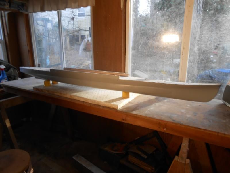

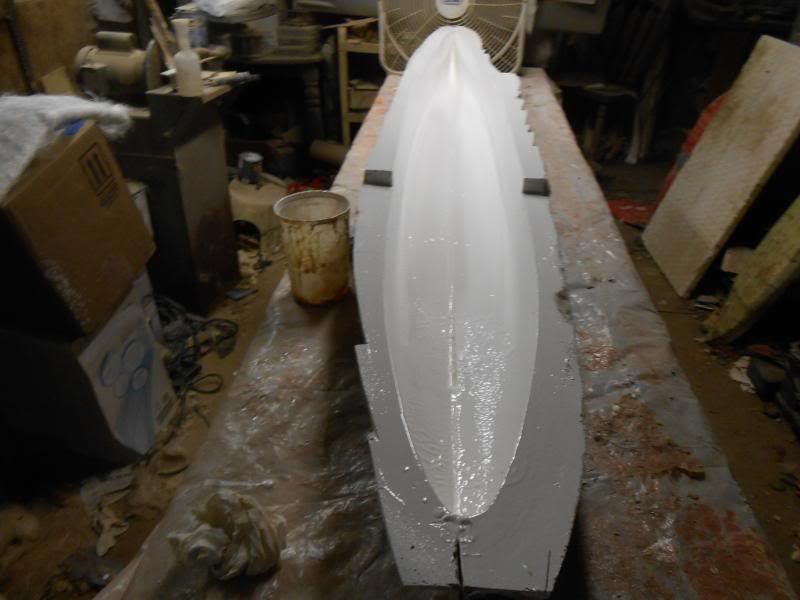

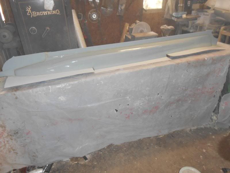

I am making a fiberglass hull of the IJN Heavy Cruiser Mogami for a friend .He will be making the late war seaplane carrier version .Here are a few photos of what he and I have done so far .

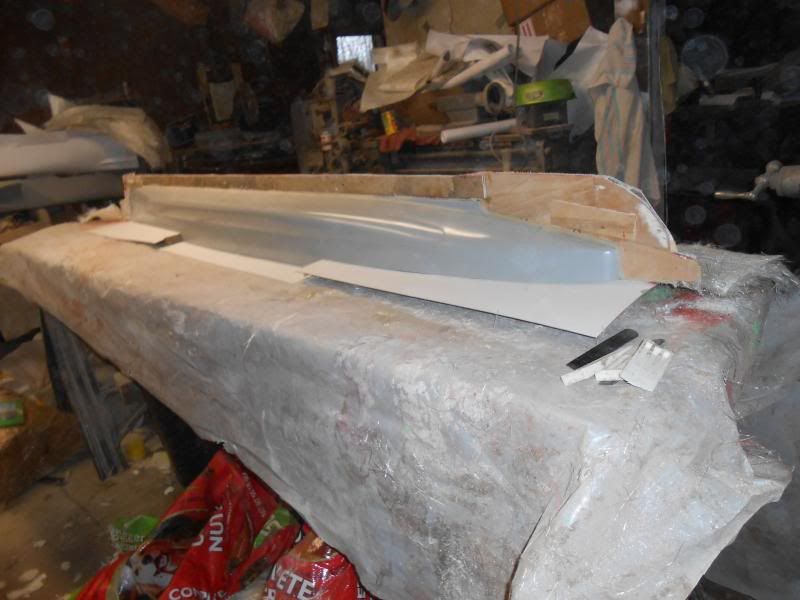

I made the plug the same way as the T3 Tanker .
Installed the dam and sprayed on PVA .

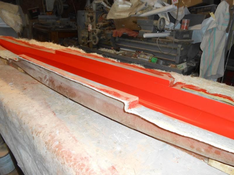

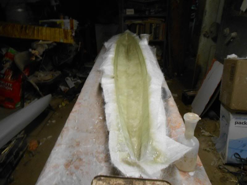

Started the mold .Three 8 mil layers of tooling gel coat then a layer of matt .Each side will have six layers of matt .

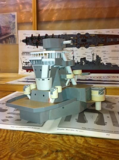

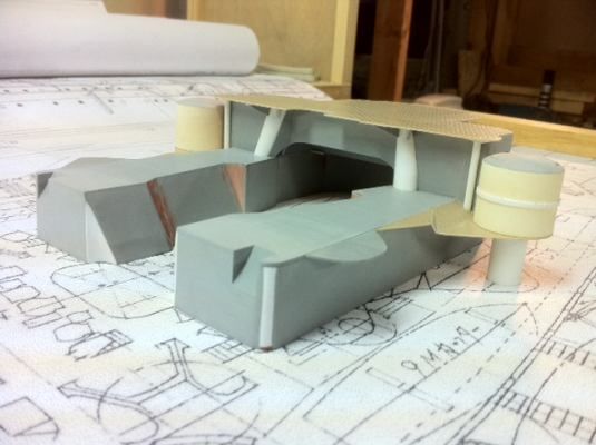

Stan has started the superstructure .

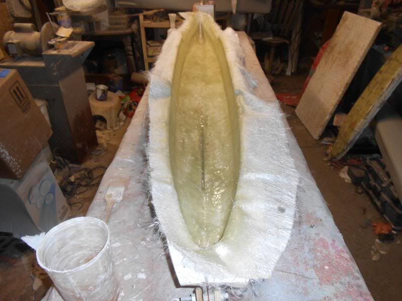

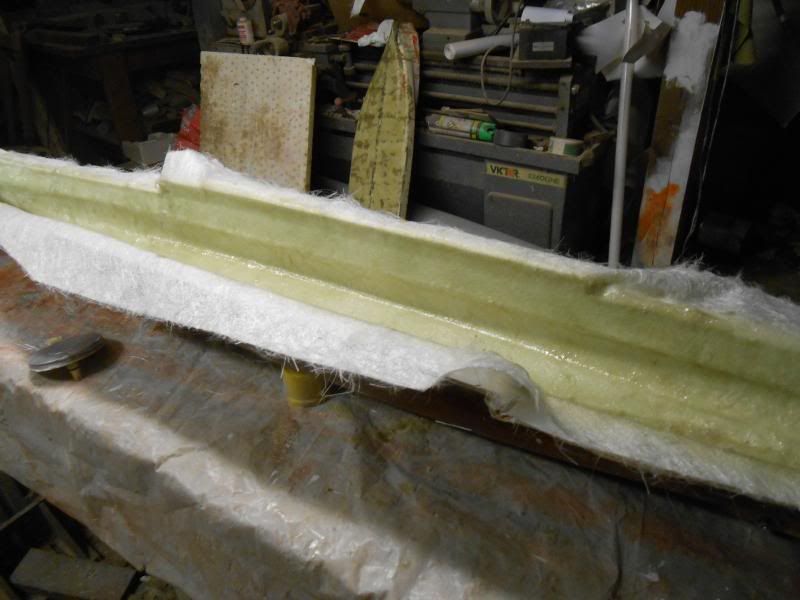

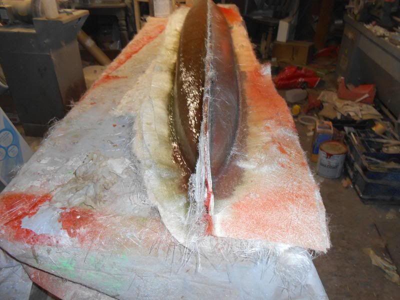

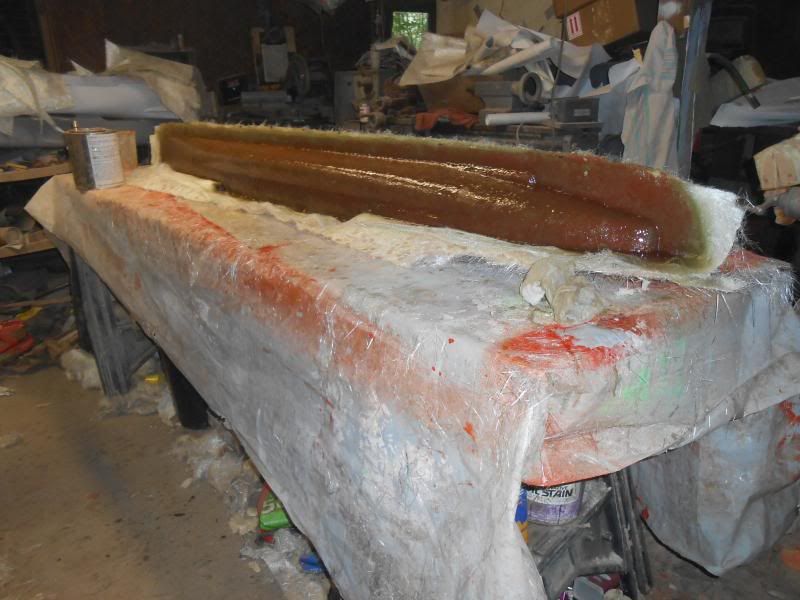

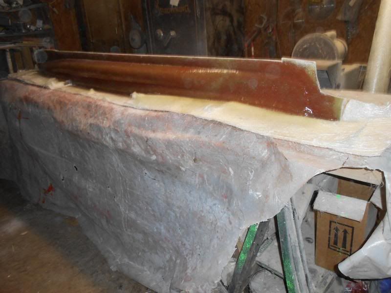

I now have six layers of matt on the port side . Used five qt of resin to do it .
Getting ready to seperate the dam from the mold .
Starboard side ready for PVA then matt .

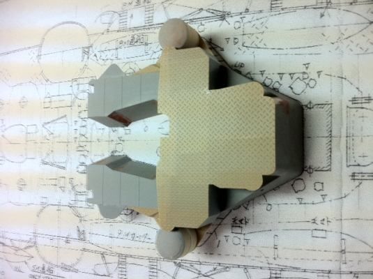

Stan has been buisy on the superstructure .This is what he has so far .

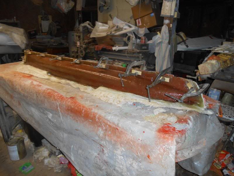

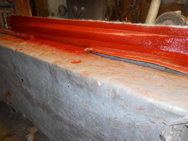

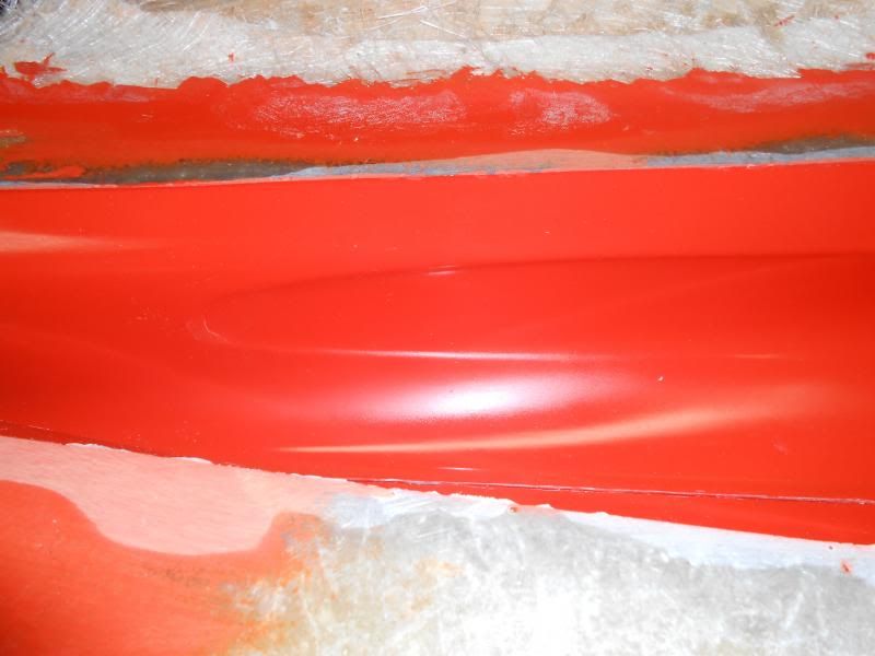

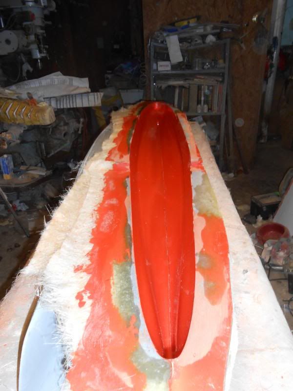

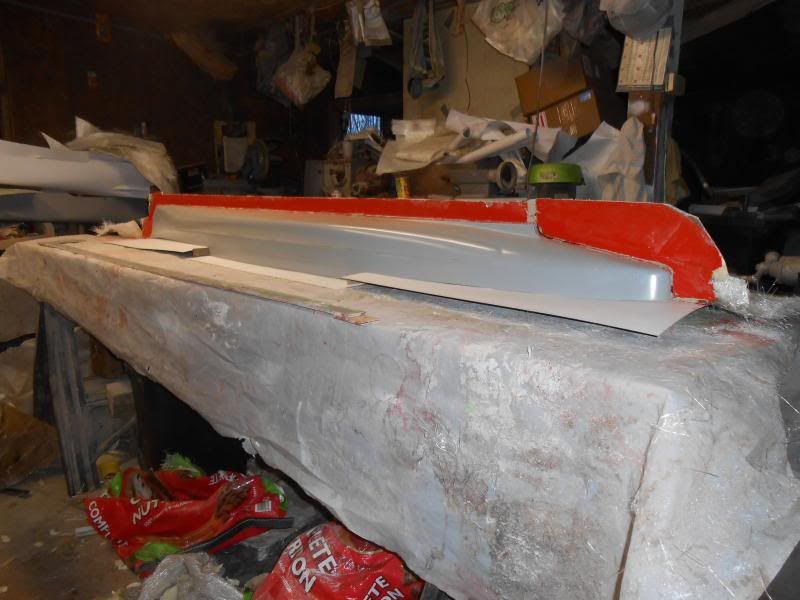

Clamped plywood pieces , backed with resin and matt along the plug for the bolts . I use bolts with shoulders so they act as guide dowles at the same time .

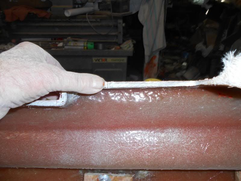

Trimed the excess matt on one side .This is the thickness of six layers of matt .

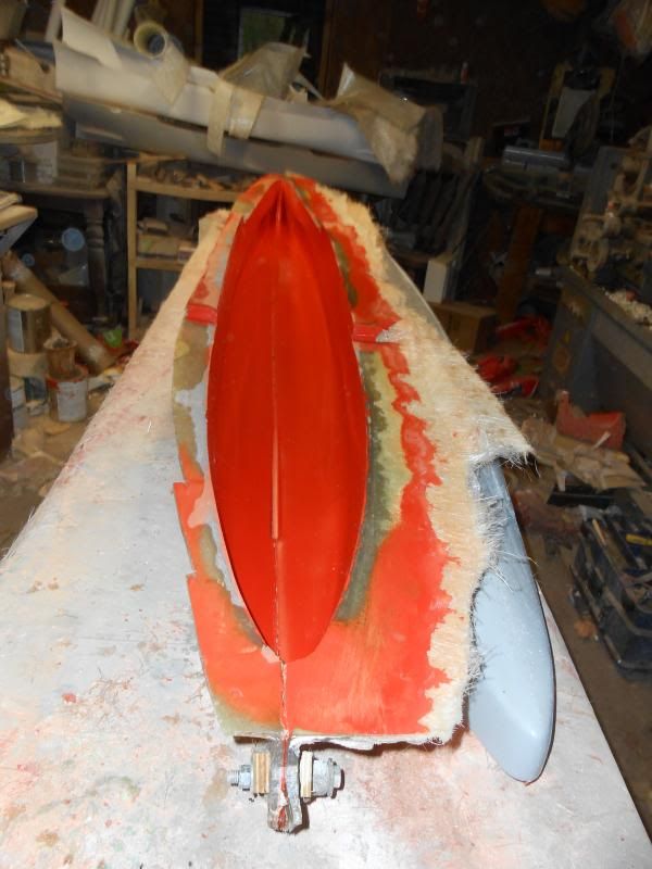

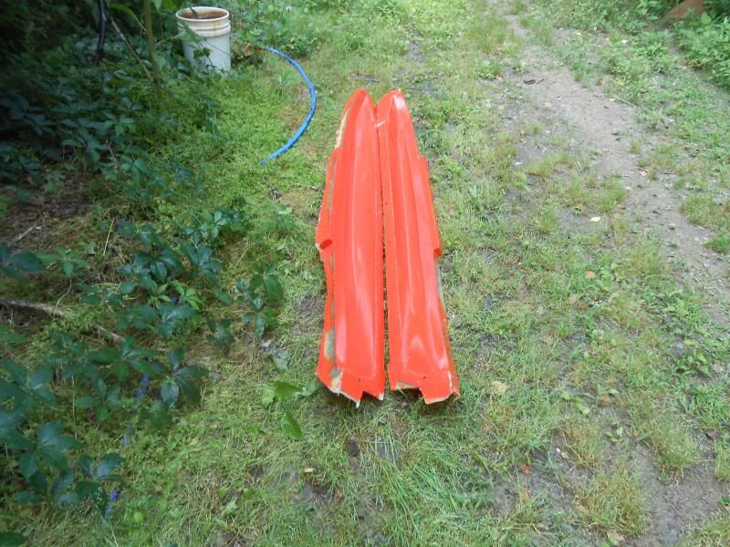

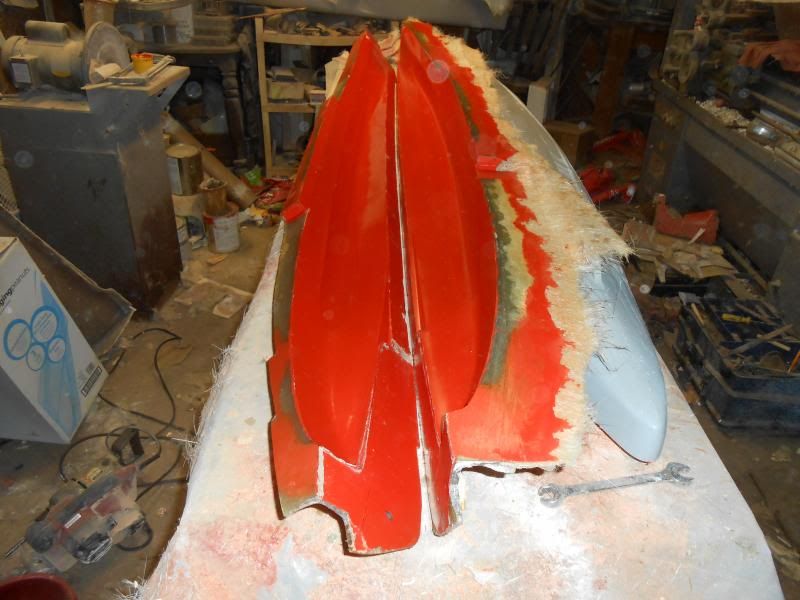

Seperated the mold to remove the plug .
Bolted the mold back together .
Note torpedo blister .
The O-1 level is part of the mold .Hulls will have this level already there .
It has to sit a few days then polished with release wax .Then the first IJN Cruiser hull . :heh:

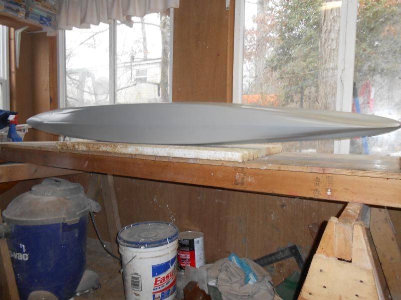

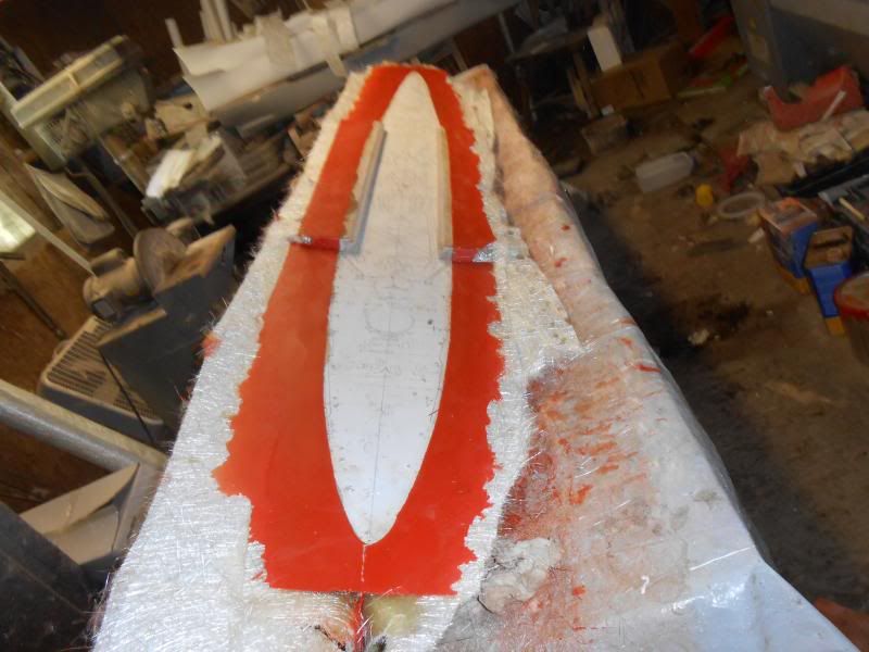

PostPosted: Tue May 28, 2013 5:19 am
Posts: 1012

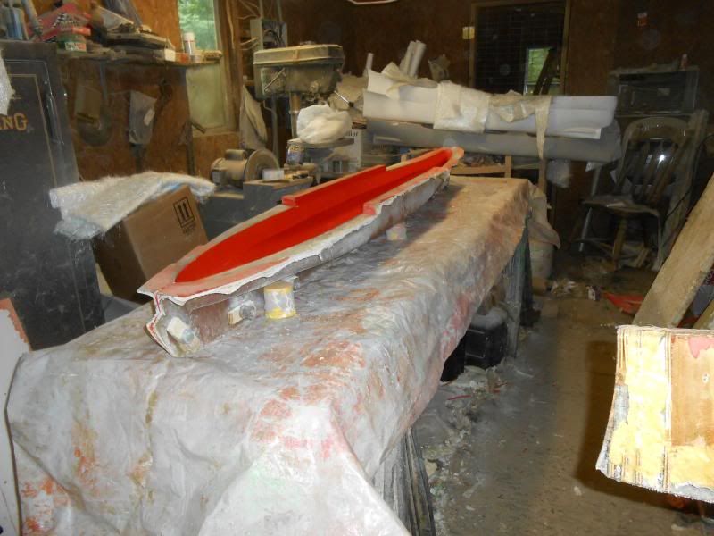

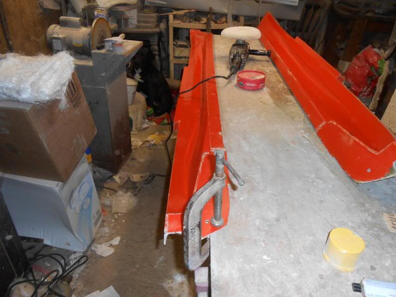

Washed the mold then waxed it with hi temp release wax .
Clamped the mold halfs to the table to polish with release wax .
Bolted the mold together then sprayed on two coats of PVA .
Sprayed on about 25 mils of gel coat
Laid up the hull
Have to let it sit in the mold for five days
This is the first and only IJN Heavy Cruiser made in USA .
