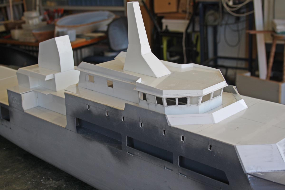

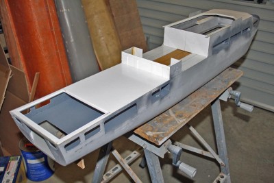

The MV Sycamore is used by the Royal Australian Navy as a training ship for a variety of tasks including helicopter pilot training.

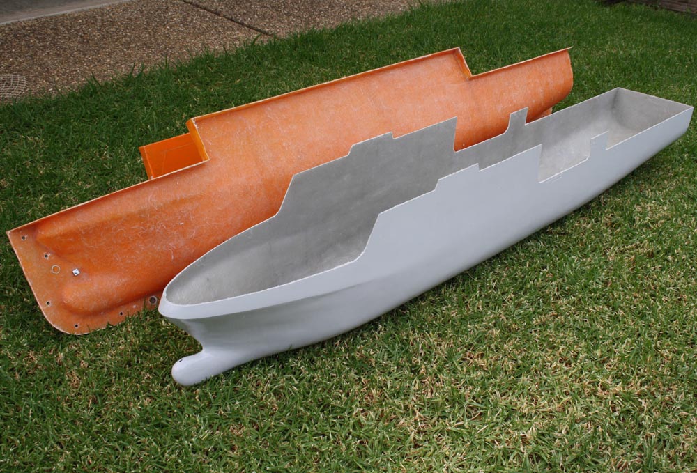

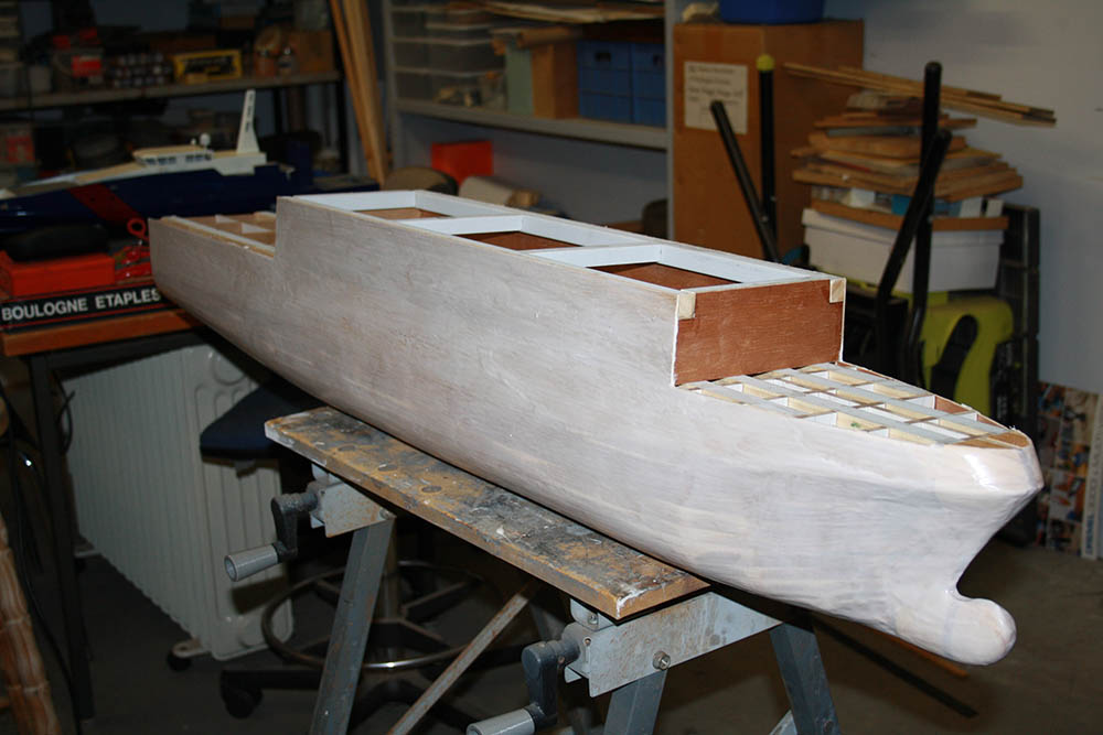

A couple of years ago I started building a 1:72 scale model of this ship. I first built a wooden hull then took a fibreglass mould. Finally making a fibreglass hull.

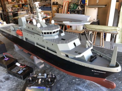

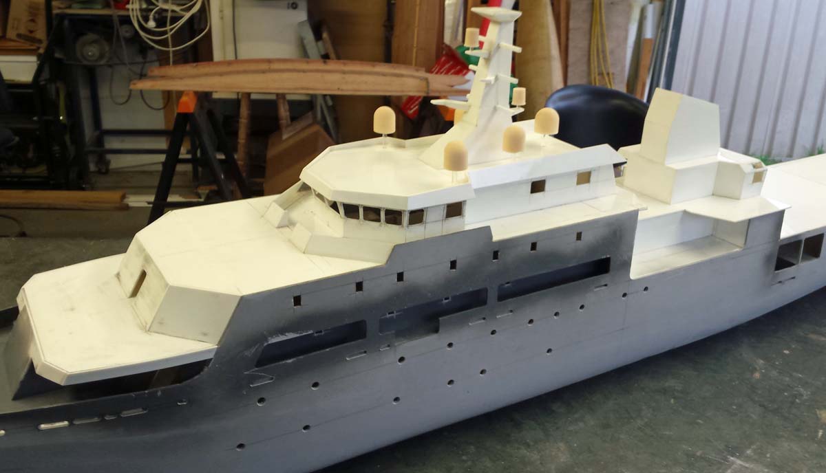

Construction has progressed slowly over the last couple of years but the model is now starting to take shape. The attached photos show how construction started.
Steve B.

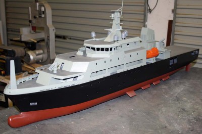

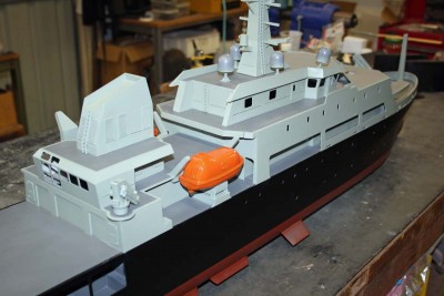

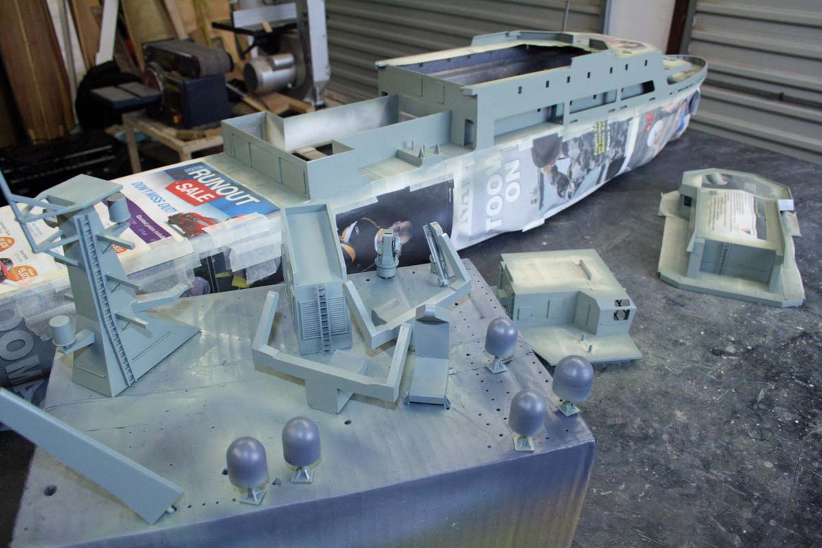

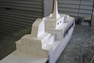

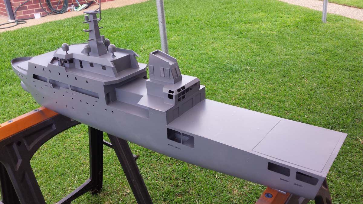

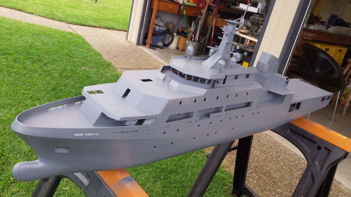

A few more photos of construction progress.

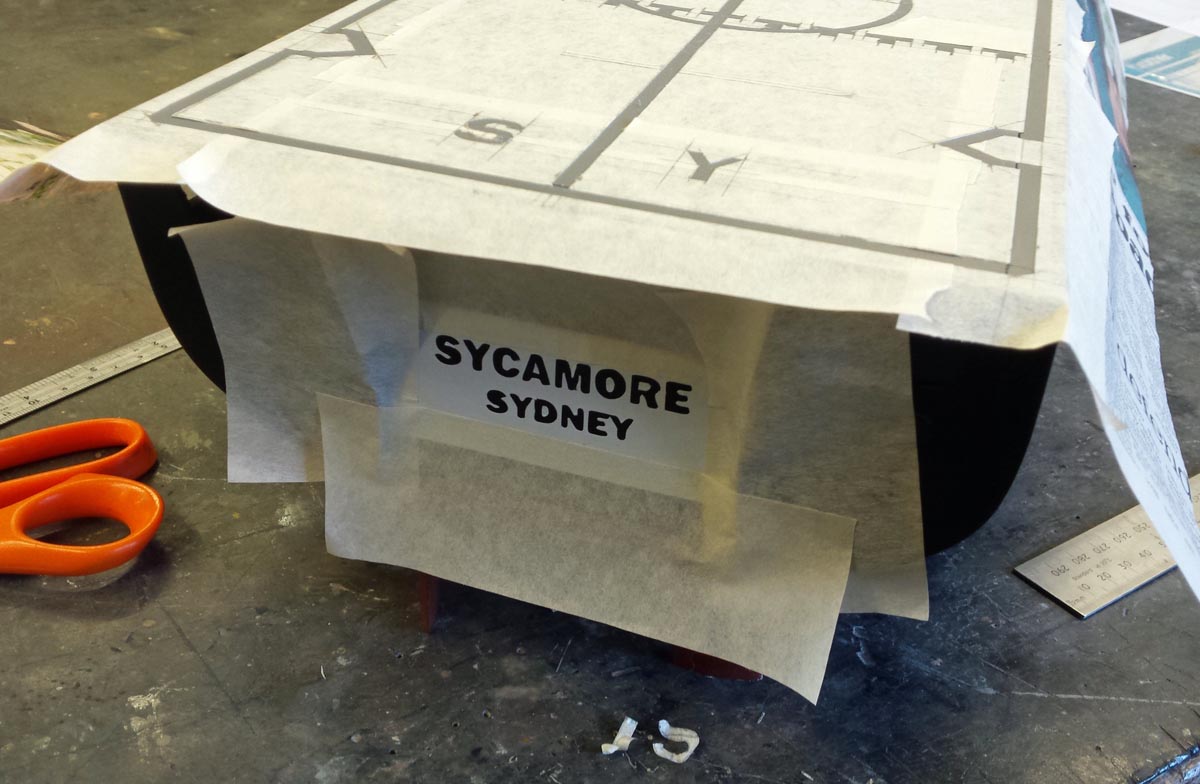

The lettering and helicopter deck marking are done from cutting a mask?
PostPosted: Mon Oct 05, 2020 2:28 am
Joined: Sun Aug 15, 2010 7:05 am
Posts: 39
Location: Wagga Wagga NSW Australia

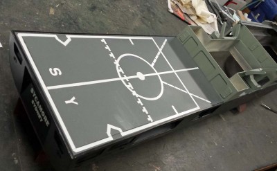

The flight deck was covered in masking tape then the markings were drawn onto the tape. The areas to be painted were hand cut with a sharp exacto blade and the appropriate areas of tape were removed ready for painting. White paint was applied in several thin layers with an air brush
The ships name was done with a mask made from vinyl (cheap book covering vinyl). I used my wife's scan-n-cut machine to produce the mask. The scan-n-cut machine did struggle to produce such small letters. This was an experiment and it did not turn out quite as well as I had hoped but it is still acceptable.
PostPosted: Tue Oct 06, 2020 2:07 pm
Posts: 2432
Great job, indeed the name at the stern does seem to have some possible minor improvements, but the flight deck looks stunning! :thumbs_up_1: :thumbs_up_1: :thumbs_up_1:

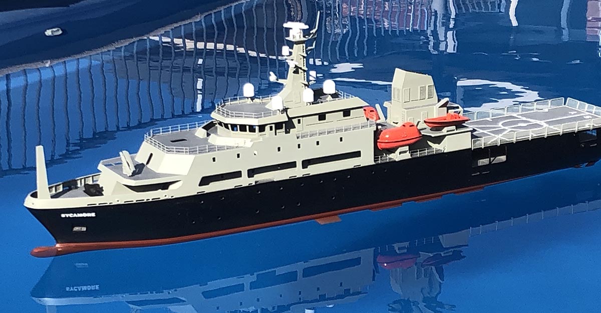

Some progress on the MATV Sycamore in recent weeks.
I have made a few more fittings such as radars and anchor winch. I have constructed and fitted the flight deck nets. Also started fitting some railings.
I fitted a couple of motors and the electronics in preparation for its first on water test.
File comment: A few more bits fitted to the model.
File comment: First test run on the water.
