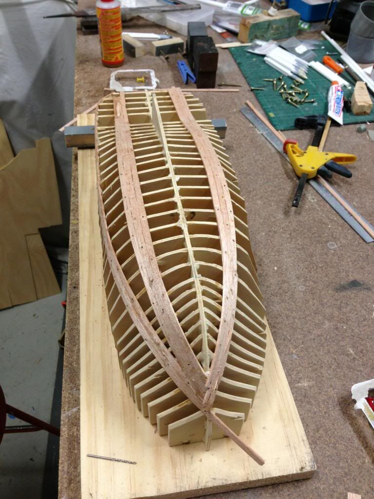

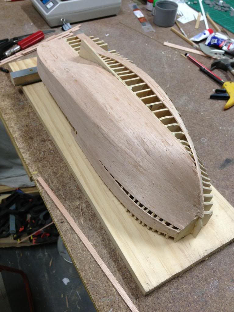

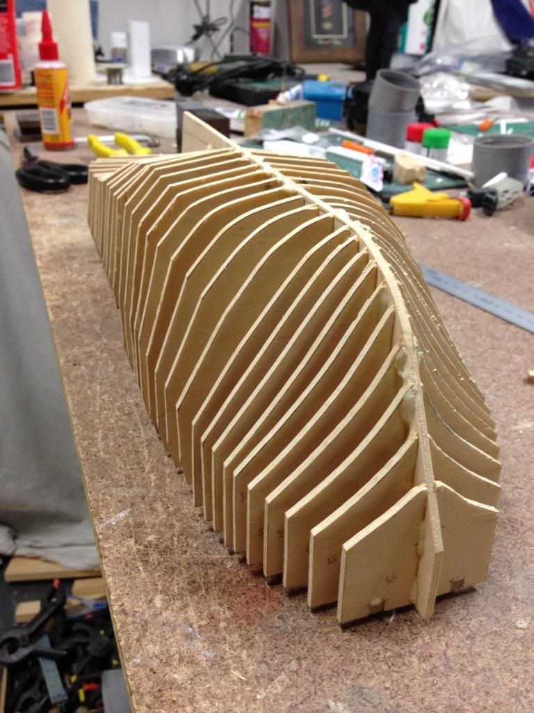

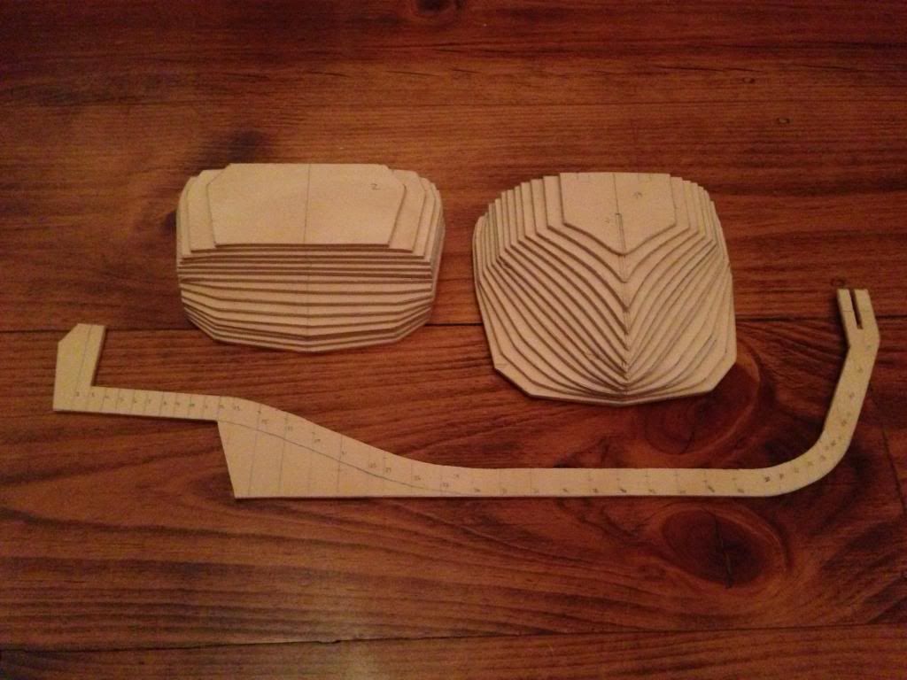

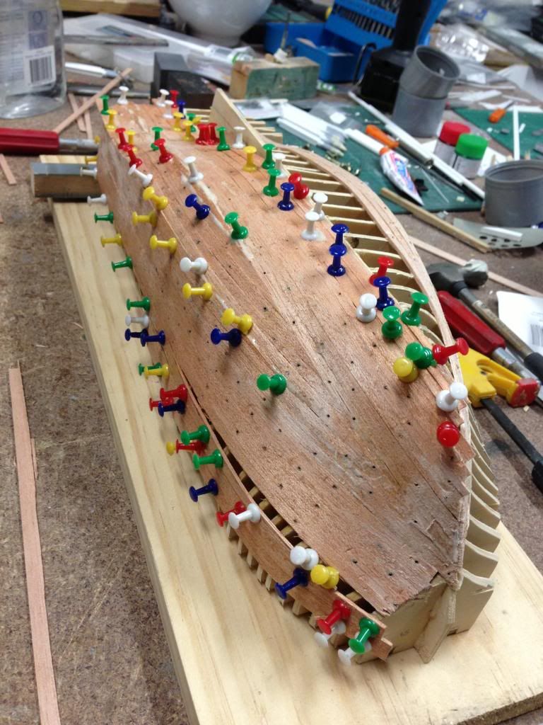

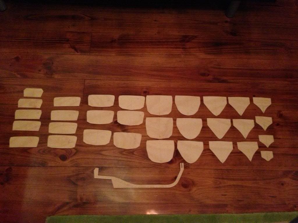

I have used 3mm plywood for the Keel and Frames and in total I have cut 36 frames to go on this small Keel, it sounds like an over kill but this hull has so many changes in her shape that I needed all the frames to give me her crisp lines. So I have cut everything and glued the frames in once I had the Keel in it's jig to stay straight and true, when all that was done I flipped her on her back ready for planking. Scott
I had to cut another 5 frames after this photo was taken

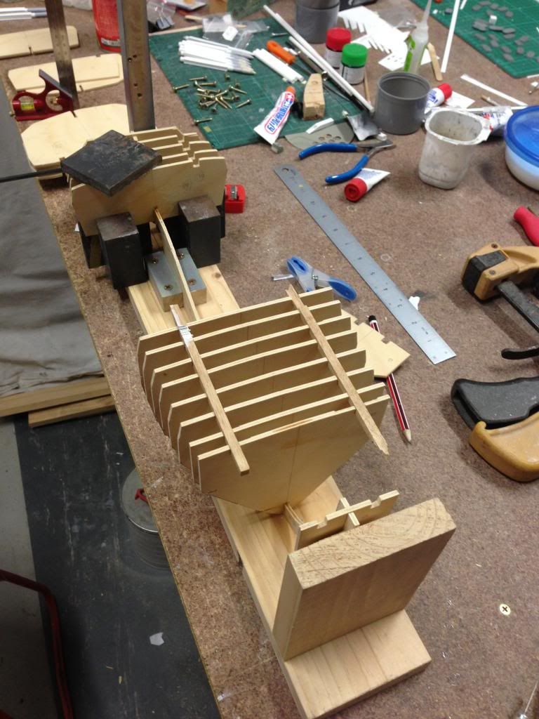

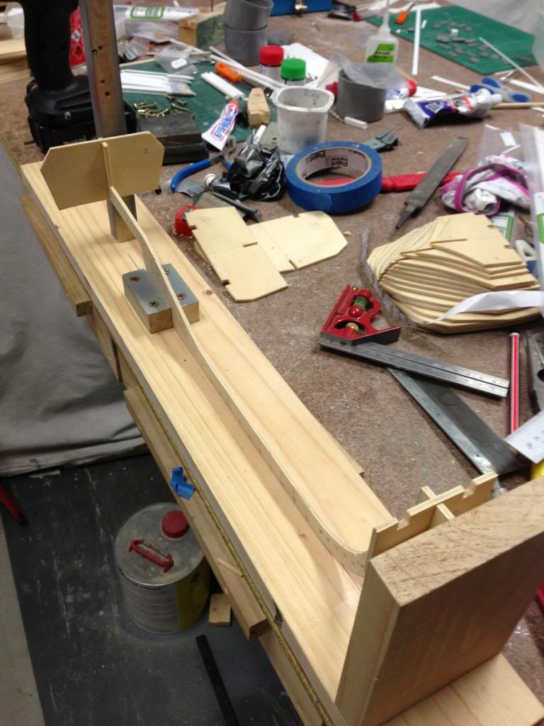

Jig set up for Keel

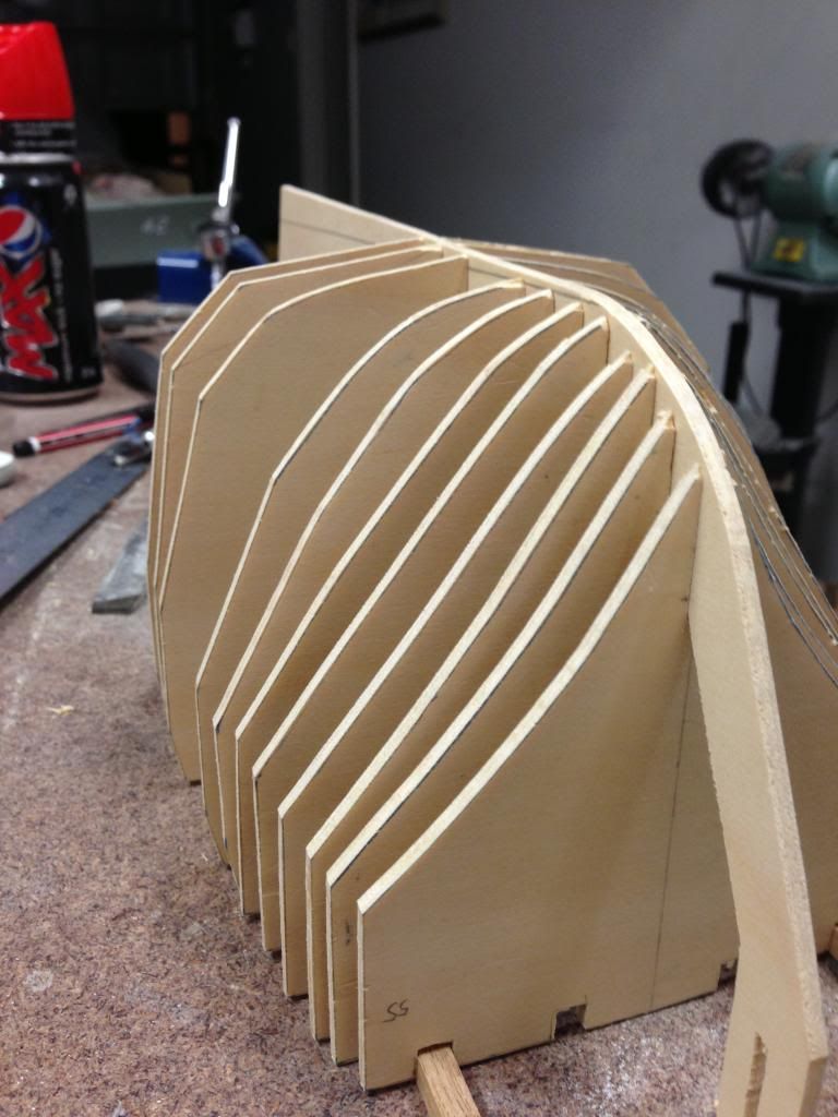

Started to glue frames

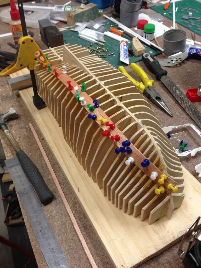

this has taken around a week for the frames
all frames done

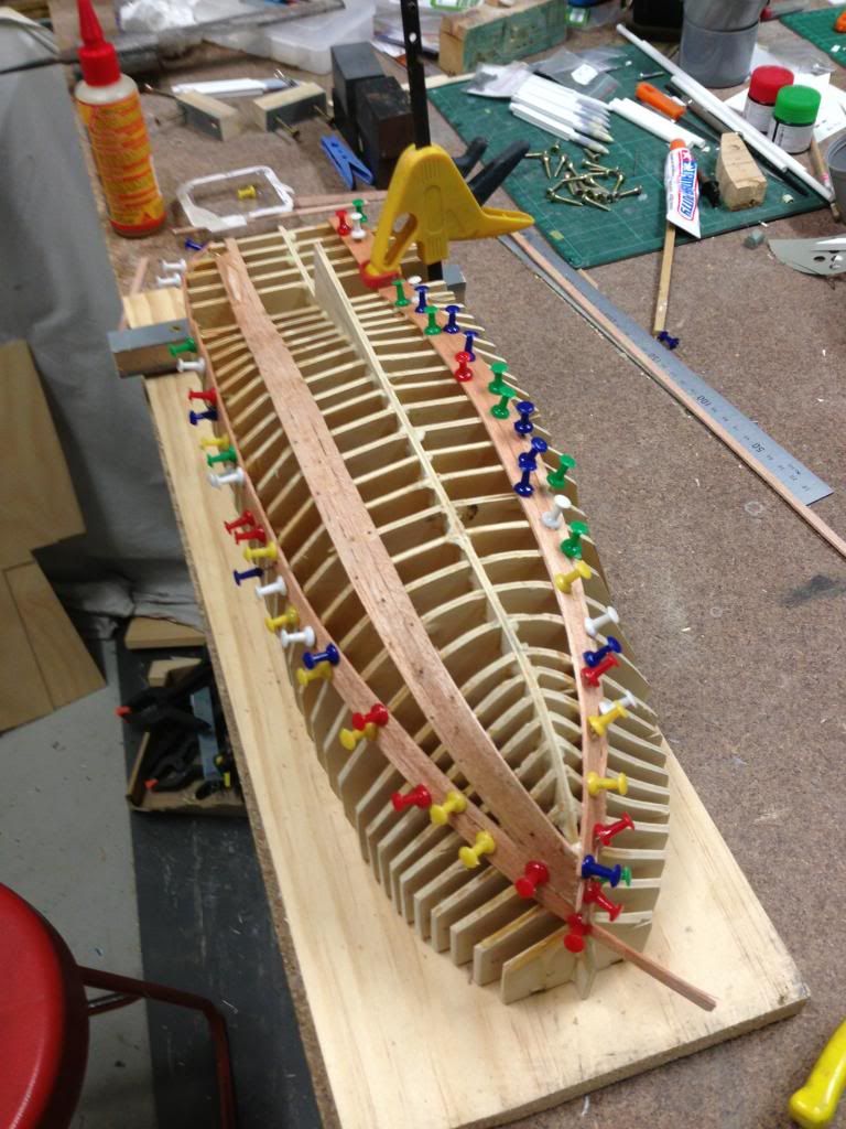

out of the jig and ready to plank

Planking looking mighty sweet mate!! Seems like only the other day we went aboard her to get pics!! (How long now ....12 months!!)
I will be one of the many lining up for a hull once the mold gets sorted !! :thumbs_up_1: :thumbs_up_1:

As with the original, looks to be hel4stout. Were those the original frame spacings? I have seen similar tugs in Hong Kong, a far cry from the old style Navy tugs I worked on. Interesting the fire nozzle on the tower!
Cheers. T
 Post subject: Re: 1/72 Tarpan Tug
PostPosted: Wed Nov 13, 2013 10:47 pm
Joined: Thu Oct 11, 2012 6:49 am
Posts: 67
Location: Adelaide, South Australia
Bruce, I had a great chat to Trevor today whose my Tug Guru and have some great ideas for detailing the plug for the final part before the mould process. Lets see how we go before you start lining up for a hull :big_grin:
T cheers for looking in on my build, the frame spacing is as the plans show in 1/72 scale which in the Bow and Stern sections I used every frame and the frames had 7mm between each one and in her mid ships area I did every second one that gave a 14mm space between frames. Scott
