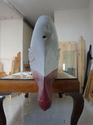

File comment: A front view f the bows.

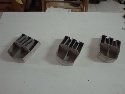

So here I am at last to start posting the progress pictures.
I shall be posting the pictures according to their section. I shall start off firt with the works carried out on the main turrets.
Ths main turrets are completly scratchbuilt using 1mm thick card board as the main construction medium. Of course laminated to gin thickness and strength. The gun barrels are made from solid aluminium bars and turned on my lathe.
For those who are interested in card board, please take note of how the stiffeners and reinforcements are laid out. These are not there just for show, but to ensure that in future, the object constructed will not warp or distort, while able to handle change in temperature and humidity.
The main turrets are just finished with four, brush applied coats of grey primer and eft there for the time being.

The second part related with the construction of the secondary gun turrets.
The third part shall follow soon.
Cheers.
Paul.
File comment: A closer view of the spacers in place. These shall also serve as excellent reinforcers.
