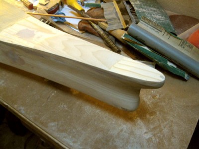

I started building the hull Scale 1:191
LOA 57 inches
This is my 3rd Missouri this size.
My first photo:
Pine bread and butter hull with poplar top slab 1/4 inch.
It was so cold today that when I squeezed the bottle of glue the container cracked.
After getting this all glued together I will start marking out the station lines.

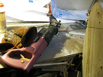

Cutting out the fat.
The Japanese saw would not do it ,the sawzall would not do it, so I went outside
and used a vice and a skill saw and finished it with a carpenters saw.
Can anyone tell me the length of that small skeg that goes between the two large skegs???
Went to get coffee.

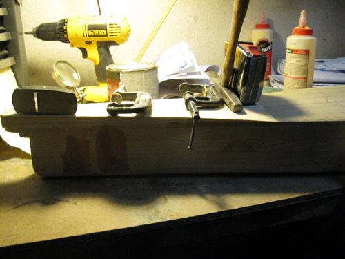

Yes that is problematic.
Last time I used a round rasp. I think I must have had more inthusiasum back then.
This time I think I will take it back outside and use a 4 inch grinder.
I hope it goes well. LO..lol
That concave starts at the bow and extends back 14 inches on a taper.
I am glueing up the stern and bow deck where it rams up a little.
I had to cut and make long taper wedges. Lots of work.
It is 30ºF outside.
I think I will glue the deck ramps on at bow and stern instead.
Here are the photos of the wedge shaped pieces I made.
Now the deck is the correct measurement above the base line.
Went to get coffee.

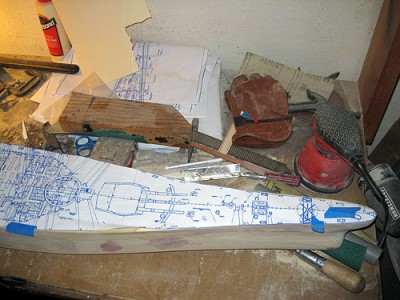

Guest wrote:
I want to let anyone following this thread know that the scale of my model will be 1:187 because
my top view drawing I got from Floating Drydock (TFW) was 57 inches LOA.
It will not be a problem.
Make sure you fold the top view drawing down the
centerline and trim so that both sides are symmetrical.

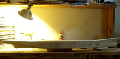

I did some serious work today.
Lots of wood dust.
I am ready now to make the skegs and rudders.
I will need to find some nice hard wood.
Went to get coffee.
