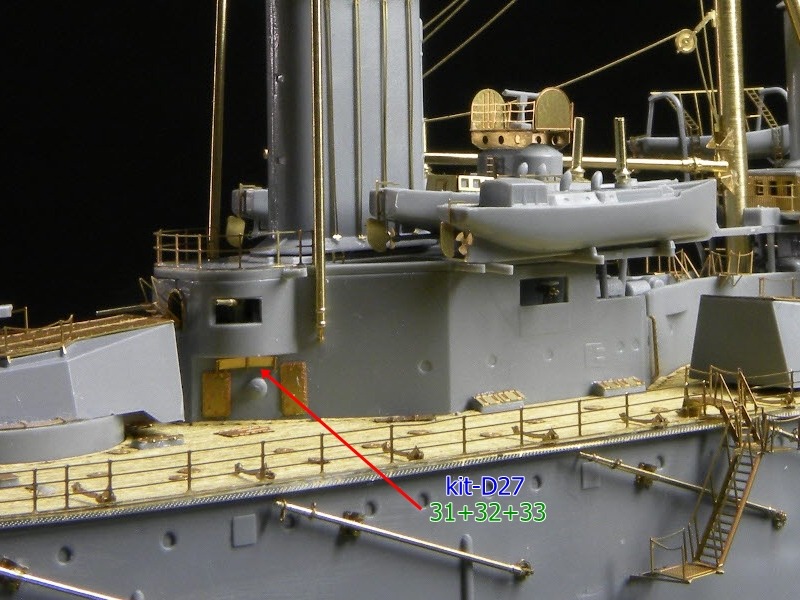

Hey Chris, so it begins, the mystery parts that Pontos never bothered to explain :smallsmile:
I was just looking at this today and I think that they are for the search lights. Actually if you look at the photo a few posts up you can see them very clearly. on the two search lights on the bridge wings.

I also have found the instructions hard to read and incomplete. I sent an E-mail to Pontos two months ago outlining the things I found. According to a Pontos post on this forum, a revised instruction sheet would be available, so I have held off posting my list. Again, that was two months ago. So, here is my list with corrections. Updates are posted in color. If anyone can add to it, that would be great. I do like the set and hopefully an updated instruction sheet will be available soon.
The following PE parts are not shown on the instructions:
12 - rear superstructure railing?
31 - shown on updated post from Pontos on this thread
32 - shown on updated post from Pontos on this thread
33 - shown on updated post from Pontos on this thread
