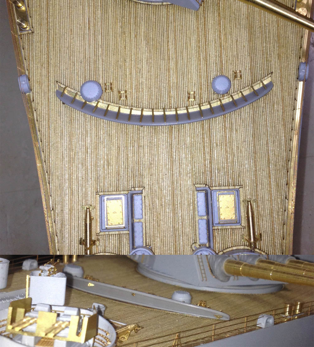

Sorry this R07 is Water protector and I edited page1 pdf file.
And following shows the Water protector photos.
You can also watch the Waterways on the edge of deck.
Thank you

do the waterways go on top of the teak deck or along side it?

Lapausky -
Waterways are to the outside of the deck. They are underneath the lifelines and the chocks are welded IN the waterways. See the last photo posted that shows the breakwater. You should see the waterways on the outside edge of the deck. On the real ship it is a narrow strip of metal that extends from the inside edge of the hull (which has a rounded upper lip) to the outside of the decking. The waterway has a vertical strip of metal that is welded to the waterway and forms an outer edge for the decking to fit against. Picture the letter "L" turned 90 deg. upward.
Hope this helps,
PostPosted: Sat Jan 25, 2014 7:03 am
Joined: Fri Jan 24, 2014 1:27 pm
Posts: 2
Thank you.
I have been on the USS New Jersey. and have see the waterways close up.I was unsure on the model as I didn't want to "test fit" the deck.i would upload some photos but the webpage will not let me, they are to big.
