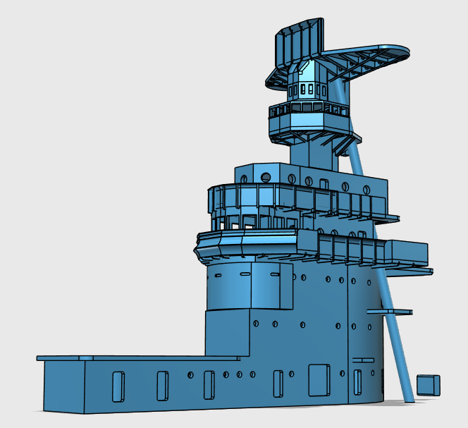

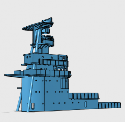

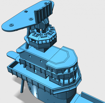

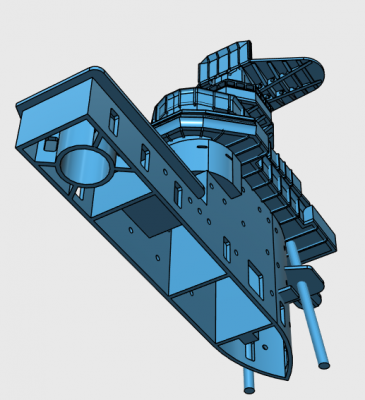

Here are a couple screenshots of a starting point for the design. This has, basically, Saratoga's Flag Plotting Station and deck on a rough draft of Lexington's 1936 tower.
No enclosure. But it could be speculated that the enclosure follows the angular splinter shield and that there was probably one shatterproof glass panel per shield facet. The top of the enclosure would probably be level with the roof of the Flag Plot. How far back it extends could be extrapolated from the number of glass panels visible in May 8th photos, assuming that the glass panels were all the same size, which seems reasonable.
The boxy structure under the Spotting Top is a Radio Direction Finding Station. I think it is the same structure that appears in May 8th photos so I would leave it in the design. Saratoga did not have this feature from about 1933 onward. In 1941, one was added above and forward of Sara's Pilot House.
These drawings also give you some indication of the detail designed into the models now available.
From this rudimentary design, is there enough information (facts and reasonable assumptions) from which to design an enclosure that would be acceptable to the modeler (a significant improvement over the Trumpeter design) and worth the cost to the modeler? In other words, would you buy this? Your thoughts, please.

PostPosted: Thu Oct 29, 2015 10:21 am
Posts: 2588
Looks great! I would have bought this for the Lex at Coral Sea diorama I finished earlier this year.
I would change a couple of things however:
1. The enclosure
The print of NH 76560 photo in Steve Wipers last book shows the enclusere better, but still not really clearly. But at least it clearly shows it's presence. The windows are clear and of similar size as the pilot's house's, and the roof seems strait and solid. I believe this was a permanent structure indeed.
I also believe what we see in the NARA pic is only the beginning of this addition, or even just a mock-up. This photo might have been taken around the same time as the series in which the 8" guns were removed, when the refit was clearly not complete. For example, the 20mm gun gallery on the former boat platform at the base of the funnel has not been added yet.
I purchased a high resolution scan from this photo, but it doens't get really clearer than the print in the Warship pictorial book. I think the NH 76560 photo shows clear enough that the enclosure extends all the way to the front, to at least the same level as the pilot house's front. But it is not so clear how far to the sides it goes (I think all the way to the splinter shields indeed, but the splinter shields might have been replaced by other plate material?), or how far to the back. All in all, I feel Trumpeters rendition of this area is not to bad, given the scarce evidence.
But I do understand leaving it of, so the modeller can add his own interpretation. But I certainly would add it myself.
2. The spinter shield on the forward end of the spotting top
The famous pic of Lex with painted bow wave in '41 shows that it is a different shape than before. It is set more forward, with rounded sides towards the back, and it seems less high. Also, I cannot see any reinforing ribs on it's front face anymore. The NARA photo shows this item also, from the side.
https://upload.wikimedia.org/wikipedia/ ... r_1941.jpg
3. The little windows at the base of the Radio Direction Finding Station are clearly present on the above photo, but seem to be missing from the NH 76560 photo. I mistakenly left the entire Radio Direction Finding Station of my model (which should be there really), but I would leave these windows of. But maybe this level was openable/removeable?
4. The NH 76560 photo shows something in front of the Radio Direction Finding Station, which Steve Wiper interpretes as a FC radar antenna. I followed this idea on my model, but it is best represented by PE. And since it is uncertainly, maybe it is best left of indeed.
5. At the aft top end of the flag setting station, there were two 24' search lights, on semi-circular platforms (moved up from previous location). These are easily added by the modeller, but could be a good addition for your product.
6. I would prefer to have the splinter shields present around the 1.1' AA gun platform (previous 8' gun location) An extra platform for the lower position in front of this would be a nice addition, so all the splinter shields would be identical.
7. I would prefer to do the two rear poles of the pole mast in brass rod/tube for extra crispness (I would be affraid of any roughness due to the printing process of these inclined and round items). I would therefore prefer them not to be on the part, but instead holes through the different platforms through which brass rod of the appropriate diameter would easily fit. But of course, that's just me, and your other customers might have a different opinion.
8. There was quite some spinter matting around the bridge. The inclined facets you added to the front of the pilot's house were actually spinter mats (the NARA photo shows their irregularity, and it is also visible in one of the 8' inch turrets removal photo's). I would therefore prefer to have this irregular aspect reproduced on the part, or have them left of completely to be added by the modeller.
There was also splinter matting hung straith vertically around the splinter shields of the pilot's house level. I also would like to have these added, if the above parts are included.
I am not sure if the flag plot level had splinter matting against the splinter shields. This seems plausible, but on my model I opted not to have them, for the sake of visual variation (yes: artistic license! :) ).
On the other levels, splinter matting was added on railing. This might indeed be best left to the modeller: PE railing with plastic sheet splinter mats. But 3Dprinted splinter mats to add to the PE would be nice too. :)
9. A better version of the 8' director/rangefinder would be nice as a separate part. It seems to be still present on the NH 76560 photo and other Coral Sea photo's, in the exact location as the NARA photo.
Please don't see above suggestions as criticism. My own rendition is certainly not accurate on several points, so I just want to provide some ideas and suggestions.
I wish something like this was available when I was doing mine, I would have certainly bought it! It would have saved me a lot of time, and the end result would have been better.
And if you feel like it: Trumpeter's funnel assembly could also do with a replacement (lower position of 20mm gun gallery, different shape structures to the front base of the funnel, different shape of radar control room and without windows, different shape of top of funnel, ammo lift details, ...) :)
One benefit: if you offer these together, the modeller could have identical splinter shields around the 1.1' gun platfroms, front and rear.
Marijn

Marijn, superb analysis! Thank you!!
Thank you! Your Lexington is a miracle of modeling.
1. The enclosure
I also believe what we see in the NARA pic is only the beginning of this addition, or even just a mock-up....I think the NH 76560 photo shows clear enough that the enclosure extends all the way to the front, to at least the same level as the pilot house's front. But it is not so clear how far to the sides it goes (I think all the way to the splinter shields indeed, but the splinter shields might have been replaced by other plate material?), or how far to the back....
Agreed. I would like to add it and I think there is enough evidence (barely) to make a reasonable representation of it.
I think there is an additional platform here that has been fixed to the front of the splinter shield but raised a bit. It looks like the platform extends rearwards through the splinter shield (an opening cut for it) between the two inner rangefinders. If true, what is the shape of the rear of the platform behind the shield?
Agreed. It seems reasonable that the windows were closable by shutters or panels which is why they alternate present and absent from photos of the RDF Station on both Lexington and Saratoga.
Agreed. Better done in PE.
Ah yes, I inadvertently deleted them when merging Saratoga's Flag Station with Lexington's tower. Oops.
Agreed. I'll add it.
Brass is certainly a stronger an smoother material.
The inclined area you see in the design forward of the pilot house is a complex steel venturi, a feature of the ship from about 1936, over which splinter mats were placed. Look closely at the photo on page 39 of Steve Wiper's Warship Pictorial #33, you'll see the venturi behind the splinter mats. Although I could certainly design these mats, I think the natural irregular appearance of the mats would be better, more realistically accomplished by the modeler. A 3D design would look artificially uniform.
I'd like to include one. Still looking for good drawings and up-close photos. If good references can't be found, I'll omit it in favor of the Trumpeter part until good references are available.
Indeed! Please be advised that analysis indicates that a complete 3D-printed funnel is likely to be very expensive due to the volume of printed material needed to make one. I intend to design one, however, but fear few sales due to very high cost. Perhaps there are features of the funnel that can be designed for 3D printing as lower cost alternatives. I'm considering this for a short-stack design for Saratoga, too.
Thanks, again, Marijn! I stand in awe of your model, modeling skills and research abilities. And your English is excellent. Please post more if you think of anything else.

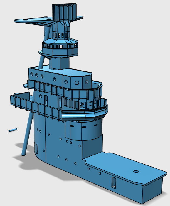

More work done on the design. It's getting closer but much more to do. Hopefully ready by Sunday - other work has been promised.
The May 8th photos seem to indicate that the Flag Plot was widened, too. Look again at those battle photos and follow the path of the sloped tripod supports. See how they appear to pass inside the Flag Plotting Station? Both Marijn and Martin built their models that way. If the supports pass inside Plot, that means that the Plot was widened like Saratoga's was. If I'm wrong and it was only lengthened, the sloped supports should pass outside the Plotting Station.
Thoughts and recommendations, please.

PostPosted: Fri Oct 30, 2015 3:28 am
Posts: 2588
MartinJQuinn wrote:
In AA Hoelings "The Lexington Goes Down", he tells a story of someone on the flag plot (I think it was a war correspondent) diving behind the splinter mats during some of the action, then roundly getting poked fun at by those near him, as the mats would not have provided any real protection. This leads me to believe that the sides and back of the flag plot had mats hanging off the railings, not splinter shielding.
Thanks for sharing your knowledge and showing your beautiful model Martin! I'm also no expert, also just a fan of the ship, and I happened to build it and therefore researched it's details a bit.
You might be very right here! Before the refit, there was railing here, no splinter shields. And any of the known photo's don't show this element clear enough to be sure, so your interpretation might be the most logical indeed.
I have to say though that the way you represented it on your model looks more like canvas covering of the railing. The splinter mats were thicker elements hanging from the outside of the railing, through which the structure of the railing was not visible anymore.
That said, I'm also not 100% happy with my representation. Next time I think I would sculpt them with Magic Sculp so they would look a bit softer and irregular.

Here, below, are some new screenshots showing:
1) open Spotting Top shutters, more closely representing the real Spotting Top as it appears in the May 8th photos
2) some refinement to the Flag Plotting Station Enclosure to better match photos
3) installation of a widened and lengthened Flag Plotting Station similar, but not identical, to Saratoga's. It's forward outline can be seen in views from above (in the final design, this will be merged into the deck and be invisible in the model)
Your thoughts and recommendations, please.

Hopefully any uncertainty of the number of guns won't affect the future 3D funnel design since the modeler can choose the number of Oerlikons to place on the platform. But certainly an interesting question that, hopefully, can be resolved quickly by the great researchers here. Thanks for bringing this up, Matt!
In the mean time, if Shapeways printed the 3D tower design today, it would look like this, including additional, matching 1.1" splinter shields for the two positions aft of the funnel:
