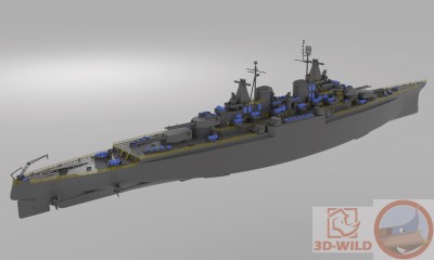

Hello everyone, I just wanted to present a preview of the finished late war modernized Lexington kit. Two versions are presented in 1945 configuration, one more historically akin to the older battleships and the other a hypothetical reconstruction.
Alongside the 1941 modernized Lexington kits, all of these will go for sale at some point between the end of July/start of August. We apologize for the long delay, but we had other kits to take care of before this one could be introduced.
We can have all of the resources in the world and still get it wrong. Not out of any incompetence, it's just because of how difficult it is sometimes to implement a physical feature without having seen it with your own two eyes. - the Chieftain

It's probably too late to make a change but your "cage" mast version has only one main battery director. All American battleships had a second main battery director except for a short period of time for Colorado and Maryland. These two had the aft cage mast cut down and the second main battery director went with the top half of the mast. This was temporary. In both ships, the stump aft cage mast was replaced with a tower like you have in your design but topped with a main battery director not a secondary battery director. I should have said something earlier and I apologize for that.

No worries, thank you for pointing it out. There's still time to make small changes like that :)

The latest version of the most modernized Lex looks great with one minor suggestion. All the USN's fast battleships kept the top of the somewhat oval armored conning tower (forgot the correct name for it but it is located just aft, and just above, of the B turret) free. There are viewing scopes that stick out of the top. Yes, the modernized old battleships did see quad 40 mm or other AA guns on top. But the Lex appears to have room on top of the B turret for a quad 40. And it appears a quad 40 would not block the needed view. Suggest moving the quad 40 to the turret top. Again, the changes look great and should give the buyers more options for little extra cost.

Von Fricke, it appears that none of the old battleships(OBB) had quad 40mm gun mounts on the turret tops.

@Von Fricke, as FFG-7 said, none of the old standards were ever fitted with 40 mm on the turret tops. The newer fast battleships had enough room with the triples to fit a Bofors on, but these are twin 16'', so it would be a tight fit.
I can see the issue with the various periscopes etc. sticking out of the conning tower, but it's been done before on ships like WeeVee so I thought it made a certain amount of sense. I guess they would've found a workaround for that

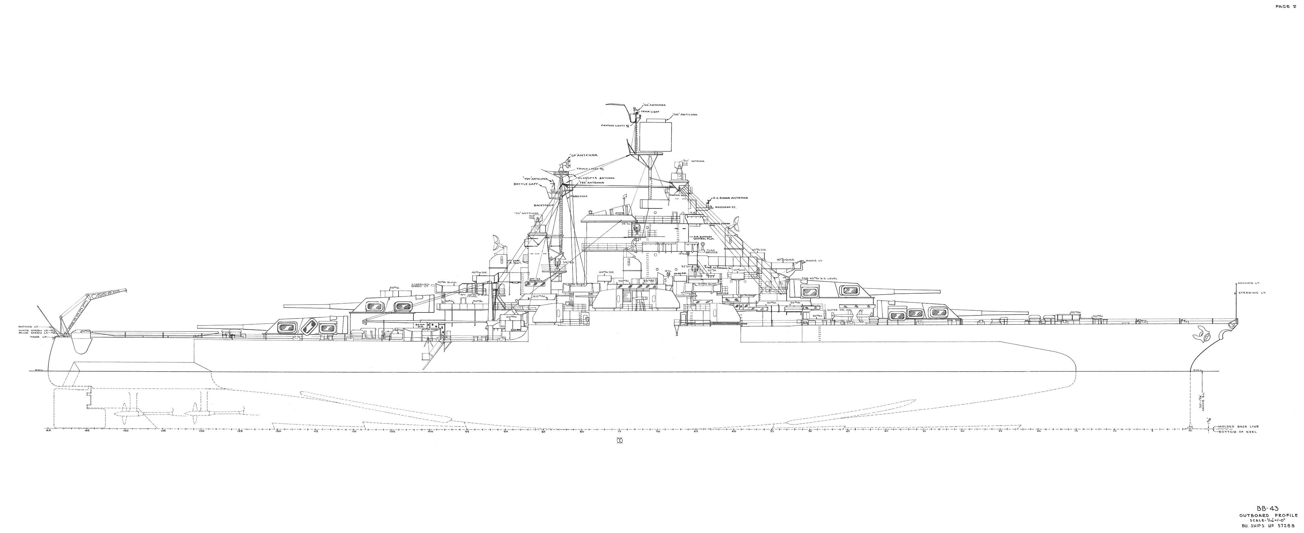

I would have done both forward & aft superstructures to that of the modernized Tennessee class & West Virginia. if that Lex was rebuilt at same time as the other 3 ships then why have 2 different styles when there would only be 1 & mass productions savings at that.

Well I took inspiration from California and liberally interpreted the rest. After all it's a different design, much longer, that can accommodate additional stuff than the cramped rebuilt standards, so the general gist of it is there, but I don't think they would've gone for a 1:1 copy. But there's no way to tell definitively one way or the other, is there?

would have still kept the 2 smoke stacks but with the tops angled like the other 3 modernized ships.
can you do a 2D side profile of the modernized Lex with the forward superstructure the same as the other 3 ships with the 2 raked funnel tops as that current forward main fire director does not look right because of shape in that location?
I figured 2d might be easier for quick info before doing a 3d tho is up to you. or do a 3d of just the area between the main turrets 2 & 3 without doing the whole ship.
