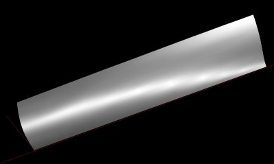

First, just as an example however, I’m going to use the existing stations to create a surface to make a point. This is a surface generated, using the “Curve Mesh Surface” function in KeyCreator (your function may be called something different depending on program) I selected the stations in sequence as my primary curves, and used waterlines as my secondary curves.
We can see from the splotchy highlights on the turn of the bilge, that things are pretty lumpy. The causes are two-fold. The first is that the stations themselves have errors, either by the offsets not being transcribed properly, or by not having been properly faired to begin with. Being off by an inch won’t show on a ¼” to the foot hand drawing, but will get magnified by a computer. Another cause, is by the waterlines themselves. They force panels on the aft bottom, and forward sheer to be overly large , this causes crushing, and ultimately warping, of the surface flow lines at the opposing ends.

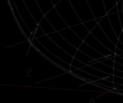

So, I zoom in at the aft end of diagonal splines 1 and 2 and see this! Di. #1 looks OK, but there is a bump with Dia #2 at about Sta. 8. Which means Sta, 8 is off in this area. I’ve drawn an arrow to point it out. If you can see the colors, you will notice that I’ve already changed the color of this point from purple to yellow, just to remind me where the station needs to be corrected.
Now rotating the bow up a bit I can get a look at the aft end of the lower diagonals. Again here there are a few wobbles a shown by the arrows.

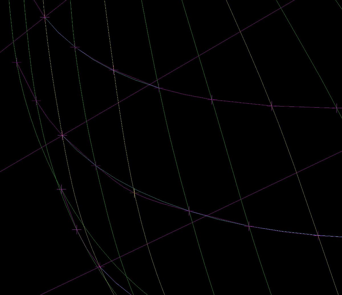

After marking these points in yellow, I repeat the process with all the splines: Rotating the view as needed to get a good sightline down each section, and then marking the points in yellow, so I can pick them out in the next step.
Once done, I create news splines, but this time skipping all the yellow points. The next screen shot shows a close-up of the Sta.8 Dia 2 intersection that was shown earlier. The original diagonal is shown in purple, the new one shown in blue. The difference in a forshortened view looks huge, but the truth is the difference is just less than an inch, at full scale! But that’s the difference that will give a fair surface.
Next I delete the old diagonal splines. In this particular example, it turns out that almost all of the offending points were on stations 8 and 5. so I’ve deleted them as
as well. Now we get a better view of the new splines and we can see that they look a lot smoother.
