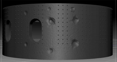

This is the reason I'm asking.
I took my turret (with rivets) and imported it into Z-Brush. I've used a standard alpha mask to get the 'iron' pattern, so that looks a bit like leather, but this is only a test. I could create my own alpha pattern to properly mimic the 'iron' texture.
I used a few different brushes and hammered in some dents according to this picture:
I think it looks OK, but I'm not sure if the detail is too much for the fab process at this scale.
The other big problem is why I asked about bump maps. This Obj is a whopping 350Mb to retain all that detail at a mesh level. If there is some way of 'applying' bump maps then I could just send you some jpegs and you could map them where you want them!
If you want to take a look at the obj, PM me and I'll upload it somewhere and send you a link. Bear in mind that this mesh has NOT been optimized for fabrication!!! :big_grin:

I think yours looks really good, much better than that one I did. But did I read that right, 350 megs for just one part? Wow, definitely too big to have printed, their limit is 64 megs per part, with minimal detail size of .1mm for the ultra detail material. That's what I ended up using instead of the regular detail stuff, so we'll see how it turns out in a week or so.
I sort of found a round-a-bout way to use bump maps in SW along with another texture, but it's a real pain to get them lined up, if at all, kind of hit or miss at this point, but I'm still working on it.
And yeah, I would definitely like to check out that obj file and those bumps too (thanks for the offer). Oh, a little OT, but did you see that the ocean generator is being included in the trunk of Blender, now that looks really cool, I definitely will be checking that out.

I had some help from my Son, who is a Z-Brush expert and he's managed to turn off a load of stuff and get the file size down to 86Mb. I got rid of the rivets, which don't need to be a gazzillion polys each anyway. It should be possible to boolean them together again afterwards. That still isn't within the 64 meg but it's a lot closer. He says it should be possible to get it within the range.
