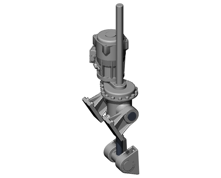

Here are some images of the elevation drive mechanism. All of the pitch, yaw and elevation mechanisms are very similar - five drive systems in all.
The electric motor drives a screw thread gear that moves a threaded shaft. The darker gray vertical shaft is actually threaded, but I am cutting corners on this one. Screw threads bloat the file size tremendously, and the overall ship is already approaching a gigabyte. So use your imagination.
The lower bearing blocks are attached to the elevation platform. The upper bearing blocks that support the drive mechanism are mounted on the drive platform that rotates around the vertical axis.
The elevation motor moves the threaded rod up and down and this tilts the elevation platform up and down. The tall tube on the top of the assembly is a housing to protect the screw threads on the rod. Originally the lower part of the threaded rod had a rubber cover that protected it from the elements. It would stretch longer or shorter as the antenna was elevated or depressed. But the rubber cover was exposed to sunlight, salt spray and very high winds and that meant a fairly short lifetime.
The last picture shows the drive mechanism installed near the back of the antenna assembly.

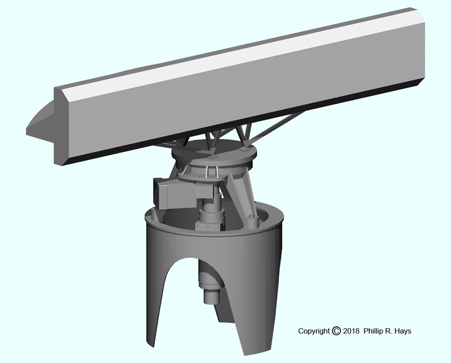

A little more progress. Hikes in the mountains and sunny summer days on the beach are interfering with ship modeling! I have added the drive mechanisms for pitch, roll, azimuth and elevation.
I am working from a few drawings and close-up photos. As the drawing progresses from one part to another I occasionally discover a mistake in earlier work and have to go back and redraw. I thought the tower was a symmetrical rounded square rectangle at the top, but I couldn't get some details of the different rotating stages to align properly. Then I realized I should have paid more attention to one of the drawings. The top of the tower is narrower port/starboard than fore/aft!
Now I can start on all of the electrical boxes - and there are a lot of them!

What a jewel this is, Phil. It is surprising to see all this intricate mechanical, electromechanical and hydraulic machinery put to work in the service of an (arguably) higher technology — guiding gigahertz waves precisely and efficiently from source to target. Especially admire the third image shown above. Amazing. Michael

Posts: 1677
Done!
The AN/SPS-30 antenna is finished. 15 Megabytes, 51,519 drawing entities and 379,261 points.
There are only a few details left. I must add the new SPS-30 to the after tower. Two smaller antennas on the after radar tower need to be reworked and the identification flags will be added to the forward tower. And the catwalk on the after funnel must be reworked.Then all the parts of the ship will be finished! Maybe.
I also need to make the SH-2 Seasprite helicopter.
Then all the parts must be assembled into one complete file.
