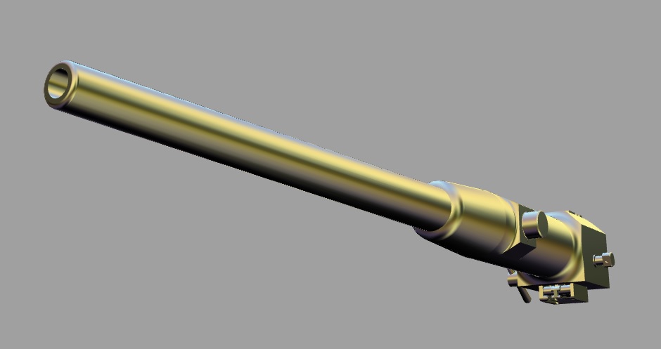

Drawings of the breech block mechanisms at a high level of detail are problematical. I have been using patent drawings for breech block details but the end product in 3D CAD is, necessarily, a composite taken from several Hotchkiss patents and from an old textbook that seems to feature redrawn patent illustrations. In any event, patent drawings are not dimensioned and rarely represent in full a manufactured product. It would probably take a trip to the national archives to get truly scale drawings to work from. There were several different quick firing guns that might have been repurposed, I suppose, as saluting guns. In the US these were chiefly manufactured by Driggs Schroeder. Driggs was the inventor, and the patents (and drawings) were in his name.
I have been sketching the Hotchkiss mechanisms mainly as an effort to figure out how they worked. Many of the details will not show in the finished 3D model.
However, I was pleased to see that even with the breech block up, closed and locked, some mechanical detail still "reads".
When the breech block is dropped, more detail appears.
In my early 6-pdr, which had no recoil system, the view of the breech block details and mechanism should remain fairly open. Michael
Edit. Ran an image search on US 40mm saluting guns. They are purpose built although some are mounted on crinoline mounts which antedate WWII and are apparently left over from the QF era. In these instances it seems plausible an old QF was directly replaced with a new 40 mm saluting gun.
There are also some YouTube videos of 40mm saluting guns performing a 21 gun salute. These show one sailor loading and a second operating a double lever/crank. The crank seems to accomplish the whole sequence -- I don't see a trigger. The image search turned up a close up of a breech, snapped in a public park, but the block and mechanisms are missing.

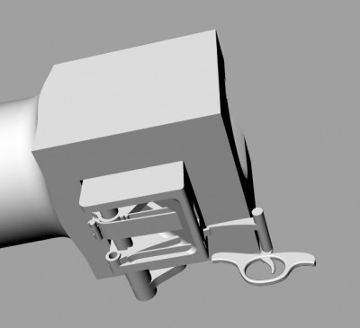

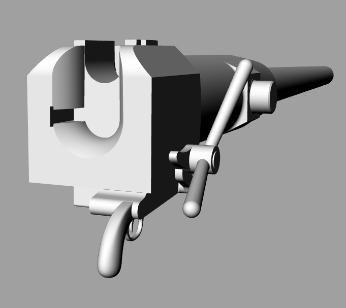

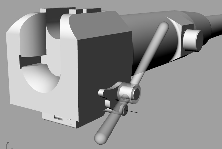

The 6 pdr is cocked by rotating the double lever counterclockwise. A cam on the lever's shaft operates against a (what? A follower or a finger, let's say) mounted on an extension of the cocking shaft, that is, the shaft bearing the hammer.
Bear in mind that the cocking shaft is mounted on the breech block, which elevators up and down. As the double lever is rotated counterclockwise, the crankshaft roller moves freely through an arc milled into the breech block. During this initial movement of the lever, the breech block remains stationary -- but the cam and finger engage, the finger is nudged downward decisively, and the hammer is cocked.

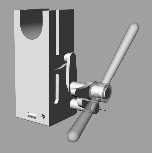

The encounter between the cam and the finger is brief. As soon as the crankshaft roller reaches the end of its arc, the breech block is free to fall. It weighed 51 lbs and dropped quite suddenly -- carrying with it the cocking shaft and finger. Here is the mechanism shown in the clear.
On photos of some the QF's in the Hotchkiss series, there appears a short hand lever extending downward from the finger at a right angle. This small lever would have made it easy to cock (or slowly release) the hammer by hand if necessary.

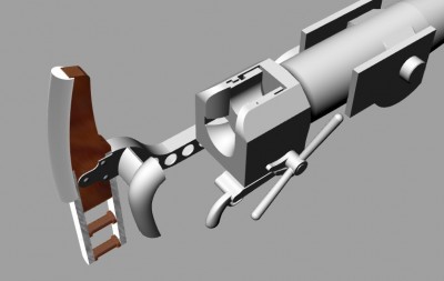

The grip is modeled in 3D with a 2 rail loft. The origin of the rails is a point at the base of the grip. The loft proceeds from an ellipse near the base of the grip to a slightly rounded rectangle at the top.
The grip was solidly mounted to the QF. The gun could be fired by hand or remotely, by means of a small, short lanyard looped through the guard.

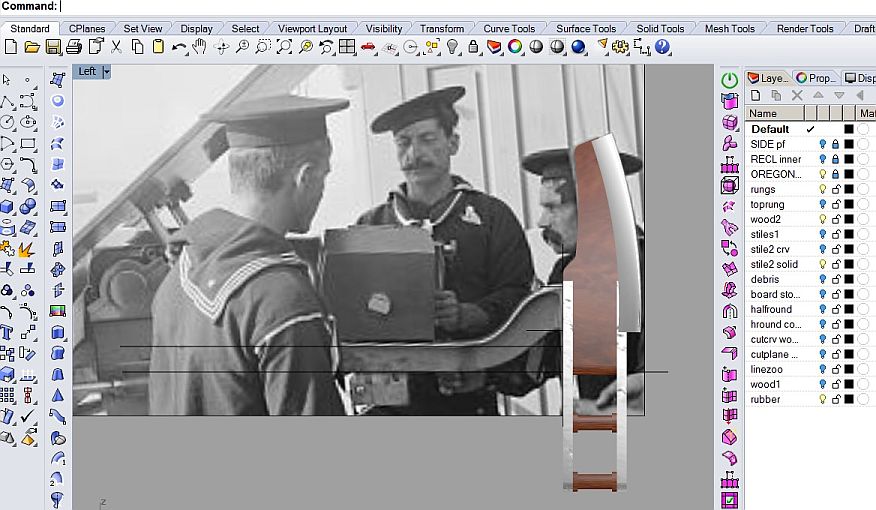

From this point, it is necessary to leave aside the highly detailed Hotchkiss patent drawings and work from a pastiche of other drawings and photographs. We do have good line art for the shoulder brace. The steel "tiller arm" on which the shoulder brace is mounted varies in style, size, and fixings from one QF to another and from the 3 pounder series to the 6-pounder series.
By good luck, there exists this (probably cc 1890's) photo of a Hotchkiss 6-pdr on the USS Oregon. It is almost a plan view, so I have overlaid the shoulder brace drawn from line art, and will proceed to draw an approximation of the steel arm on top of the photo.
The cylindrical rubber shoulder pad was probably natural polyisoprene. It was white. It is not black because it was not compounded with carbon black, like a modern black rubber tire.

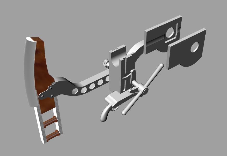

PostPosted: Sun Mar 06, 2016 5:18 pm
Posts: 201
Many of the Hotchkiss QF's are fitted with plates flanking and closely fitting the trunion. These serve as a very solid attach point for the traversing arm. If the barrel is temporarily erased it is possible to see how closely the plates are fitted on the model. This was accomplished with a Boolean subtraction. I think of these plates as wrenches, with the traversing arm as the handle. (In retrospect I can see this was an error. The side plates are parts of the gun’s cradle. They serve as mounts and guides for slides on which the gun tube recoils. 1-23-2020)
The arm itself is loosely adapted from the photo below of a Hotchkiss 3 pounder, and from the photo in the preceding post of the 6 pounder on the USS Oregon.
There was a variety of mounting points and shapes for the traversing arms, but documentation is thin. I am happy with what I have here so far, but it should be regarded as free lance, not scale. Michael

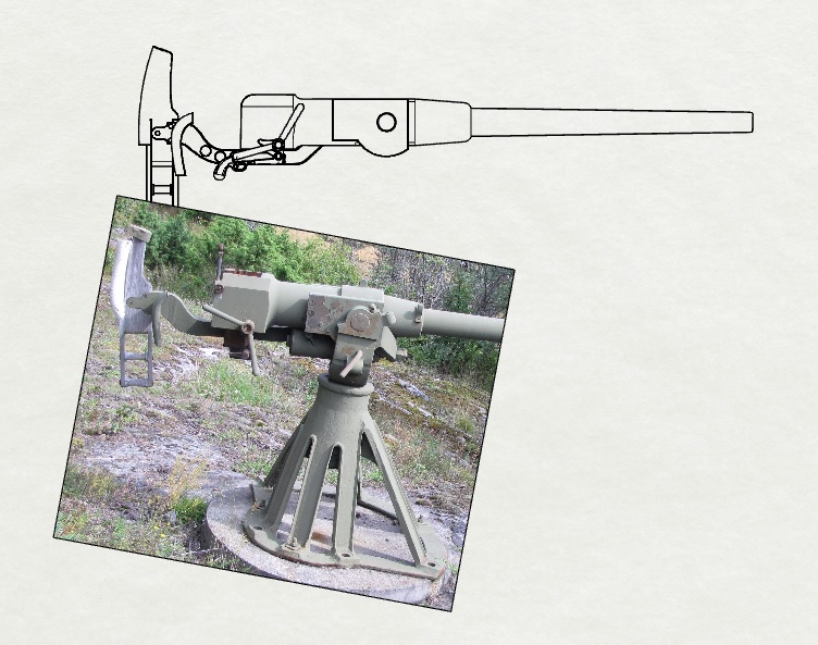

About as close as I can get is this drawing of a Mark IV, which was specialized for anti-aircraft in WWI.
It has a rotating base instead of a pintel, a broomstick instead of a shoulder-fitted traversing arm, and two recoil brake components mounted above the tube. Might be a cousin of your antique Mark X cum Mark II.
