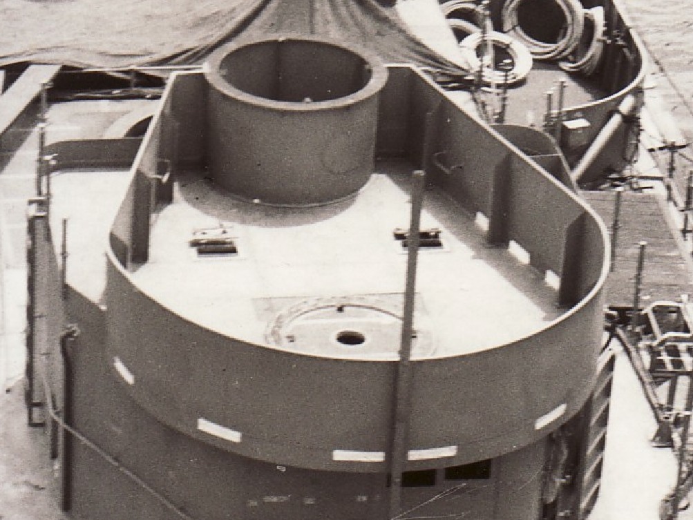

Technically the first FLETCHERS to get the "D-shaped" tub were LaVALLETTE (the first) and FLETCHER in July-August 1943. Then STEVENS and HALFORD in September-October 1943. NICHOLAS and O'BANNON, along with a whole group of other first-built FLETCHERs, came in for overhaul and upgrade in December 1943. I like to call this the "MINY-style" tub, because MINY was the ONLY yard known to modify FLETCHERs with this style of tub. The tear-drop shape was the "Standard" official design.
I know that O'BANNON and some others had the scallops, but not all D-Shape tubs had it. Look at the photos of FLETCHER. However after a quick review, it appears that many of the early modified units did have the scallops. However, those Anti-Kamikaze modified units in 1945 don't all seem to have the scallops.
As for missing details, the lip at the bottom on the lower edge of the tubs, both the Tear-drop and D-shape, still needs to be added on. See attached image for the MINY style of "lip" added to support and enclose the bracing underneath. I don't have any drawings or photos showing the bracing under the D-Shape tubs. There were two pretty substantial girders running under the full length of the deckhouse deck and extending aft becoming an overhang. They were 24-in off centerline both port and starboard. See attached image (aft is to the left). Remember that the early units with the original one deck higher quad 1.1-in mount tub, were modified to the lower configuration with D-shape tubs from scratch, so what MINY added in for bracing is unknown. So I would just use what was installed on the tear-drop shaped tubs. Other units that had the lower tub likely retained at least the original tub floor bracing. The Tear-drop bracing was pretty simple and can be seen in the drawing.
Several units had "external" spent rounds bins, but this is a variation hard to justify.

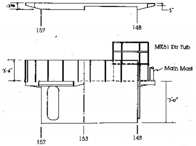

Maybe this drawing from Floating Drydock's Plan e-Book will help to understand what I'm talking about. I don't know about their dimensions, but this gives you a good idea of how things were arranged.

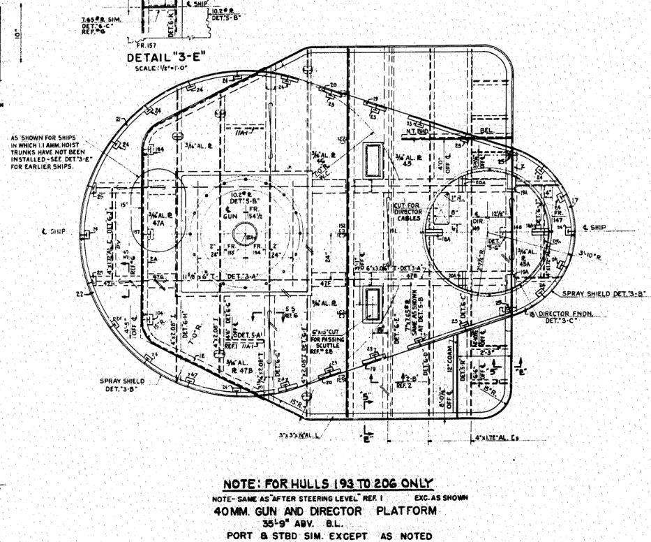

PostPosted: Sat Oct 10, 2015 10:39 pm
Posts: 3841
That looks good ... I'm drooling over the Mk 49 directors!!!

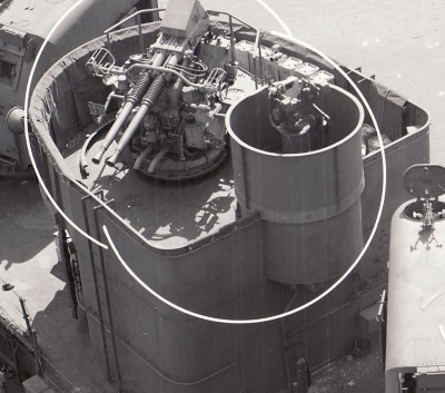

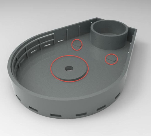

The only comments I have are the three areas I have circled.
The two small circles deal with those are shuttles ... holes ... not raised areas. They don't actually have to be holes, but sunken instead of raised as a depression.
The large circle deals with how high and/or the diameter of the twin 40-mm mount foundation. The hole looks fine. I'm just not sure about the size of the ring. Let me think about it and check photos. Look at the image of the tub under construction. You can see the foundation ring before the 40-mm mount foundation ring is installed atop it and see what I'm talking about. It is a shallow "washer" shape. Some kits have the mount's ring on the bottom of the twin 40-mm and some mold it onto the deck of the model. The last image is the best I could come up with in a quick manner of a twin 40-mm mount. I'll look for a better view when I'm less tired.
My concern is that if this "ring" is too high, the twin 40-mm mount will sit too high.

Okey dokey, fixed! The little scuttles looked like doors or hatches in the drawings, so I made them raised. It was a simple issue to do an Extrude Cut and make them recessed. Here are two more versions, one with the tub eight equal to the railing, the other with the extension with some stiffeners. I forget which ships they represent. My brain is too hazy from the painkillers. Seriously.
Anyway let me know. Thank you Mr Davis, for you super observations! I'm having issues with getting the CAD program to recognize the director assembly. It keeps ghosting out the splinter shielding but I'm working on it.

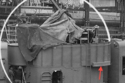

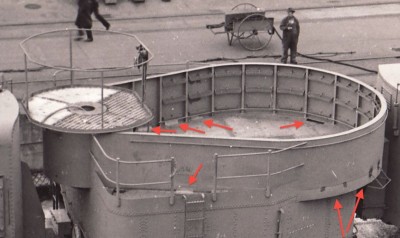

PostPosted: Sun Oct 11, 2015 4:11 pm
Posts: 3841

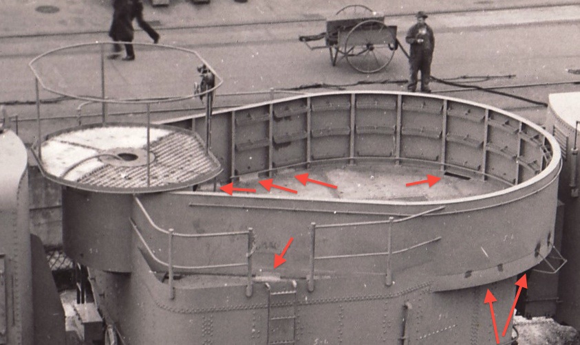

The extension looks a little to deep in the z-axis. Reference the attached image. The short "bulwark" outside the tub has a seam right about at the deck level of the tub. I didn't think of it before, but maybe it is a good idea to include the area outside the tub proper as part of the total part?? Don't do the railings, just the deck and short bulwark along the edge of the deckhouse. Modelers can cut and fit pieces to fill that in, but some will whine about doing so. :big_grin: Think about it.
There is still the issue of the rim at the bottom aft beyond the deckhouse deck. See the arrows to the lower right in this image. Remember that this "rim" (good name?) supported and confined the ribs that supported the overhang part of the "tub" deck.
The tricky part is that you are now interfacing with the kit deckhouse. Tamiya and Trumpeter could be slightly different in size and shape of the deckhouse. So the only way I can see doing this is to take a guess then get a "draft" part to check fit and then alter the final "product".
