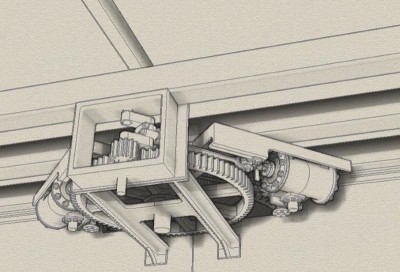

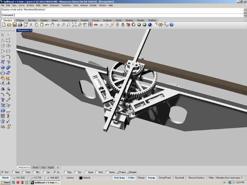

Rhino 5.0 beta has made it much easier to proceed. Everything loads, runs, and spins in 3D much faster. It also has a new feature called "artistic" mode which essentially turns your model back into a pencil sketch. I think it must be intended for making low resolution plans or presentations. It selectively drops out some detail and this seems to make the images easier to understand at a glance. I think it goes a little heavy on the shadows but I like the idea. Here is the turret drive as a "pencil" sketch.
. Here, on the other side of the bulkhead, is the spindle mount, butterfly flange, and turret lifting wedge.

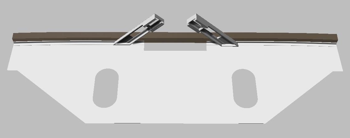

Take Two: Well, that was a little too easy. I re-checked the drawings and the engine frames do not after all abut the bulkhead. They stop about 3 inches short of the bulkhead, at a line defined by the angle iron bracing the deck beam.
Long vertical bolts will secure the engine frames to the oak deck beam, which runs along the top of the bulkhead but is turned off in this view.

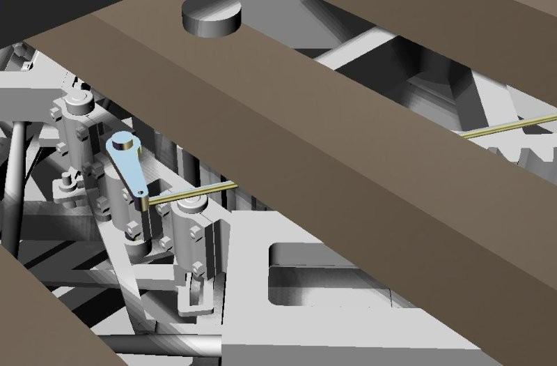

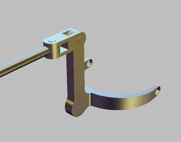

Working on the linkage Ericsson designed to control the turret engine from inside the turret. There was a hand crank mounted overhead, suspended from the turret's ceiling. When the handcrank was at the middle of its travel, the turret was stopped. When it was cranked all the way in one direction or the other, the turret would rotate at full speed in the chosen direction. At lesser deflections in the chosen direction, the turret moved slower.
Belowdecks, the motion of the hand crank could be observed as a raising or lowering of the "swash plate" collar shown here. The collar rotated with and was free to slide up and down the (massive) spindle of the turret. The handcrank's motion was communicated down to the collar by two rods running in keyways.
The vertical positioning of the collar was "picked off" by a yoke with rollers, as shown. The yoke was mounted on a pillar bolted solidly to the bulkhead.

Note that I flipped the yoke so that the output lever points up. The system anticipates in some ways the swash plate used to feed control deflections into the rotor heads of helicopters. Additional linkage was used to convey the deflections of the yoke to the reversing lever of the turret engine.
Below the main spur gear, the linkage connects arms on shafts that rotate on two different axes -- one horizontal, the other vertical. This called for a pair of double-jointed end connectors, one at each end of the interconnecting rod.
Here is a detail. A modern linkage might use ball and socket joints (tie rod ends) but Ericsson used these.
The vertical shaft carried the motion around the big spur gear. From the arm rotating in a plane just above the spur, it is a straight shot back to the V-twin steam engine's reversing lever.

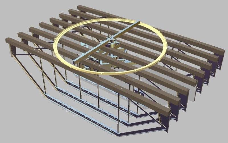

The turret bearing surface was a brass ring. It consisted of 12 brass segments, each covering 30 degrees of arc.
Below is a closer view, showing how the segments were bolted together.
The brass had two broad tiers. The upper tier was the bearing surface. The wall of the turret was laminated from 8 one-inch layers of armor, but only one of these (1-inch thick) protruded down to contact the brass bearing surface.
The lower tier of the brass was presumably used to bolt the ring to the deck. The planking under the ring consisted of 7" x 14" pine. The brass was 4" deep, and is shown here floating 3" above the oak deck beams. I assume the brass ring was mortised into the pine decking so that at its top, it was flush. Two 1/2 inch layers of armor plate overlaid the pine and the edge of the brass. Here is a pencil mode view of the ring. It emphasizes the junctures between the segments.
Finally, here is a view of the framed structure from below.
Notice the two stanchions flanking the crankcase. These two rods also served as the rear "legs" of the galley stove. As noted in an earlier post, the holes in the floor timbers were for ventilation. Note that the floor timbers were 15 inches high forward of the bulkhead, but 12 inches high aft of the bulkhead.

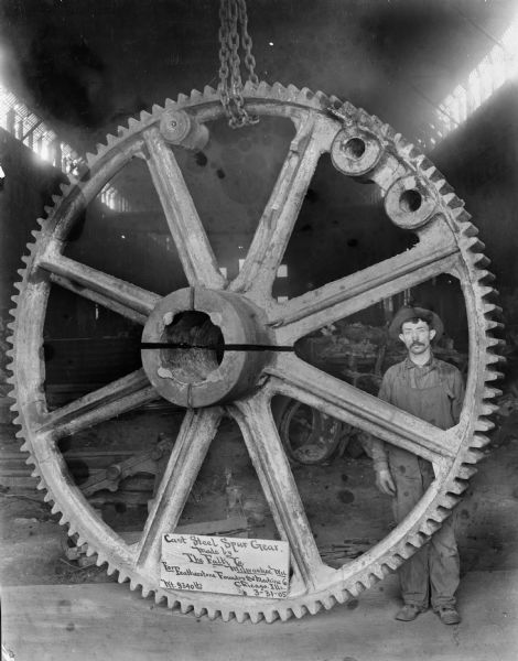

Good idea Dean. Never done a cutaway. I wonder if there isn't a plug-in that does the jagged edges. Cliff, thanks for finding and posting the Cheesebox. I had not read these. It is interesting to remark Capt. Peterkin's early contribution to that project.

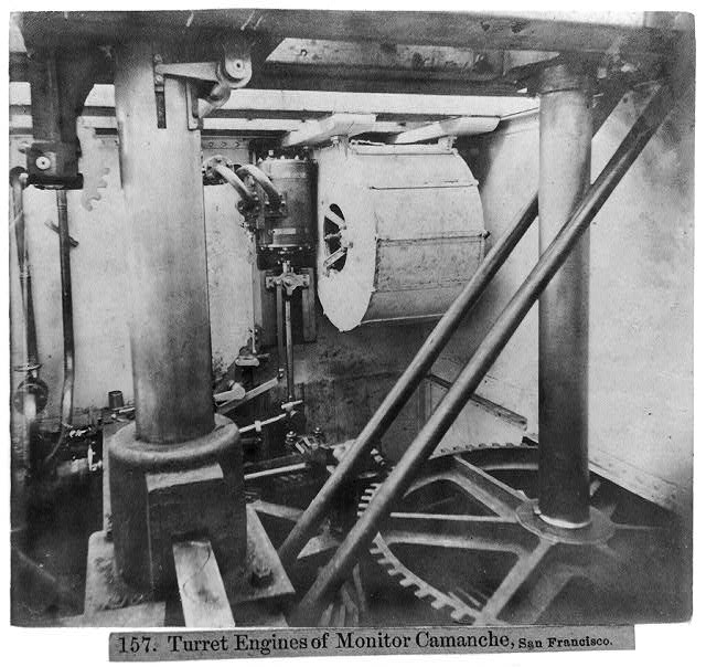

Every now and then you have to go back and tidy up. A problem with the current model is the gear train. The gears were drawn from a table of values reproduced in Peterkin's book. The Rhino3d sketches are numerically faithful to his table, but the spokes and details were just dummied up using TLAR. I guessed there were 8 spokes, and drew them as bars. Much later I found the Library of Congress image of the Comanche's gear set, reproduced here:
File comment: USS Camanche gear set. The spur used six T-form spokes.
I am going to use the Camanche gears as a reasonable prototype for the USS Monitor gears. The spur has 6 spokes, not 8, and the spokes are T-formed. There is a crown gear in this picture as well, and two pinions. The crown gear also appears to use T-form spokes, but they are inverted relative to those of the big spur gear. I found on the net another gear of this same general type:

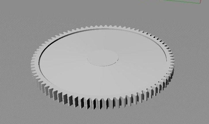

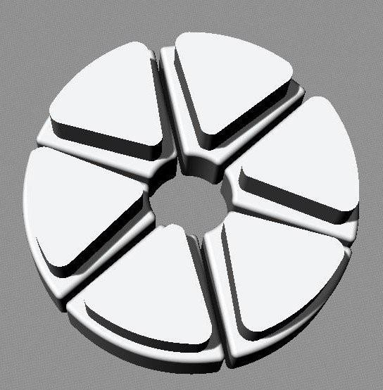

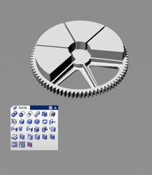

To follow this style in Rhino, I first made a blank spur gear, and then made a set of Boolean cookie cutters.
File comment: Blank for spur gear
File comment: Boolean molds, cookie cutters

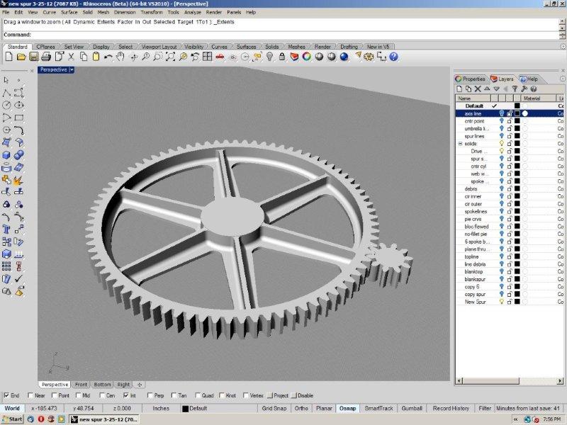

The cookie cutters are pushed through the blank gear, and then, using Boolean commands, subtracted out of it. This was done in order to draw fillets around the spokes, the rim and the hub. Here is how the operation looks in progress:
File comment: Boolean molding, cutting in progress
The net result is a new and and, I hope, more realistic impression of an 1860s spur gear to replace the modern-looking, Rotary Club gear I have been using. I will use the same technique to re-make and replace the bigger spur on the turret shaft.

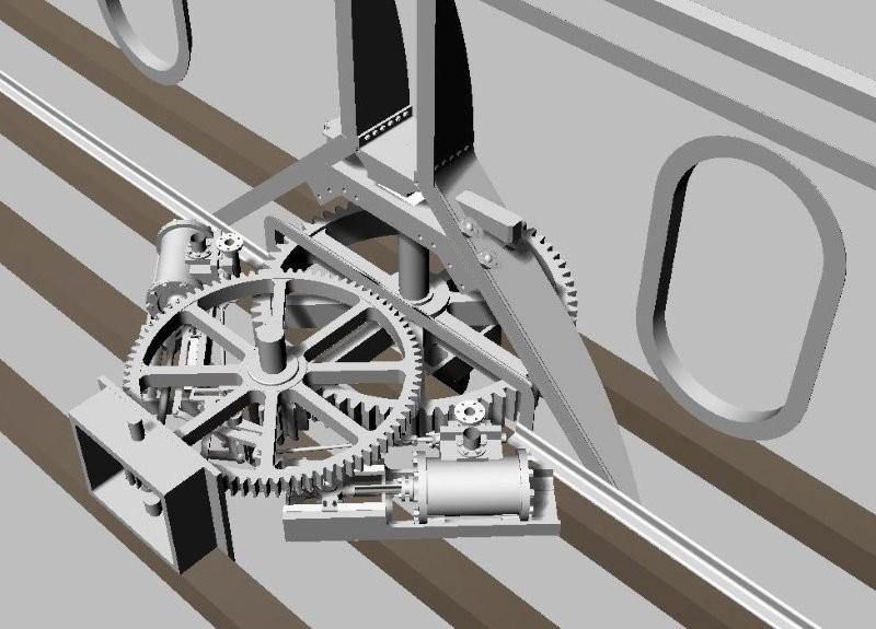

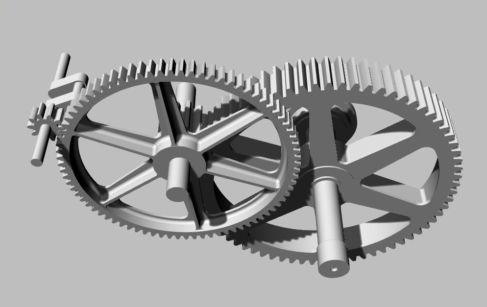

Update. Both spur gears are now re-done using the Camanche's gear set as a model. Each spur has 6 spokes, and each spoke follows a T-form. The gears look light but strong. The bigger spur reads from above, the smaller from below. Not sure why they should be inverted relative to each other, but this is the pattern established in the Camanche photos.
File comment: T-spoked gears viewed from above.
