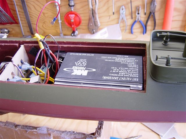

I know there are million things to consider at this point but here is a thought about the waterline.
File comment: Graupner battery, USS Katahdin for r/c
This is a 1:64 r/c model of the the semi-submersible ram, USS Katahdin. It was designed and built by another modeler. I owned it for a couple of years and it is now, I think, patrolling ponds over in New Jersey.
One problem with a low freeboard model is getting the darn thing to sink to its scale waterline.
For this particular model, the designer added to the carved-and-glassed hull's considerable weight with this heavyweight sealed battery from Graupner. The battery essentially defined the width and depth of the r/c compartment.
Like the USS Onondaga, the USS Katahdin had twin screws. These can be used differentially to help turn the long hull. The props could even be spun in opposite directions to achieve a bulldozer turn. I got a lot of help from the r/c submarine forums in setting up the ESC's to accomplish this. Nowadays....I suspect a programmable radio xmtr would make quick work of it.

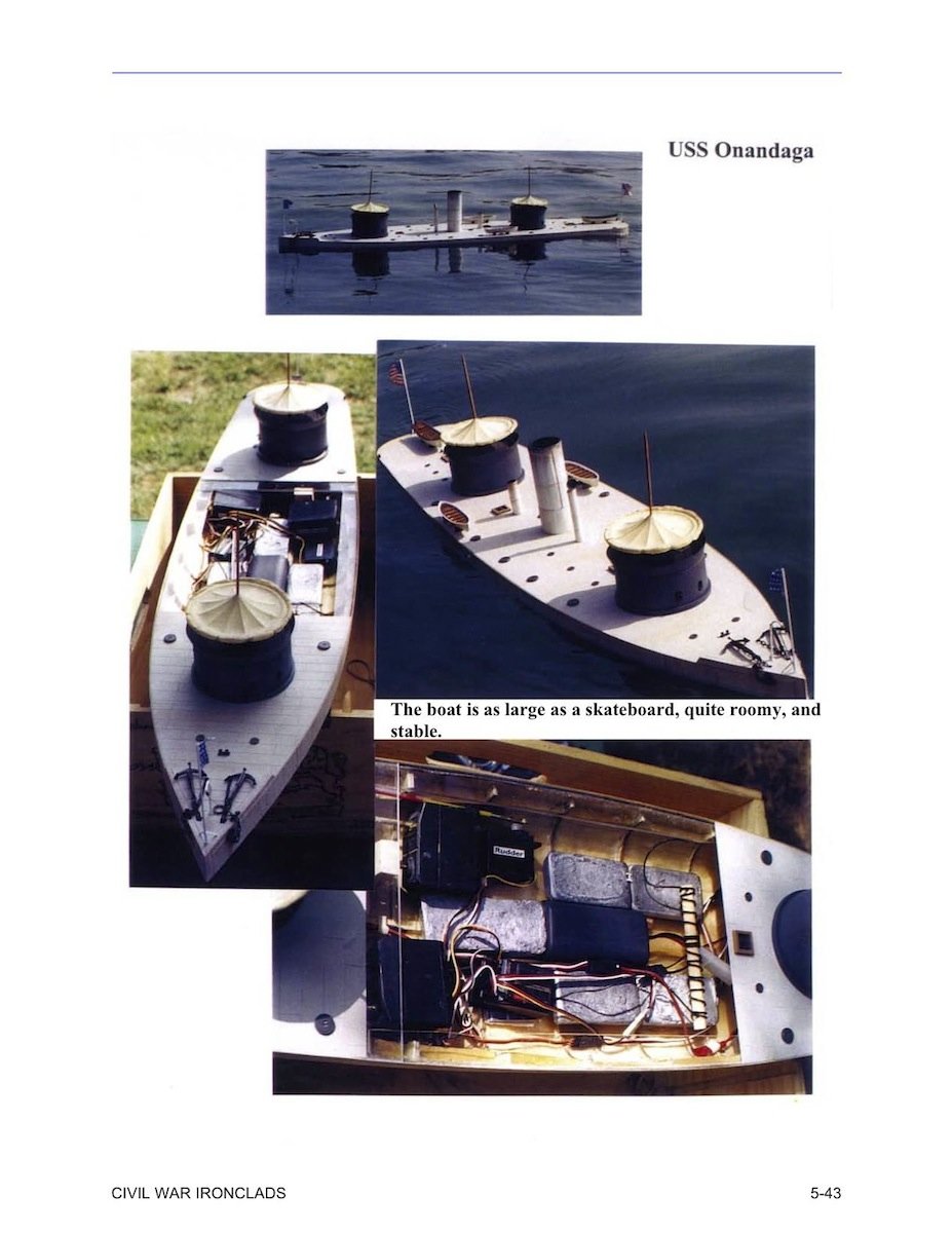

Yea, that should work but not sure how you'll get away from planking. Here's another of the hull construction for better reference.
For those who don't have Steve & Bill's book, you can download a free PDF copy at http://walternelson.com/ironclads.pdf
