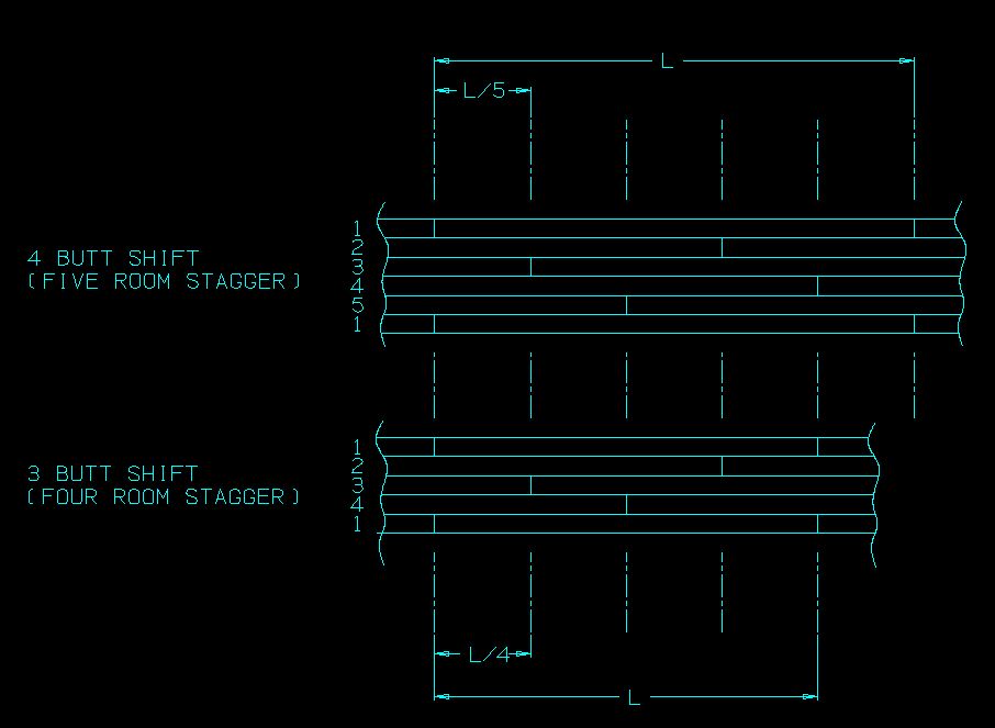

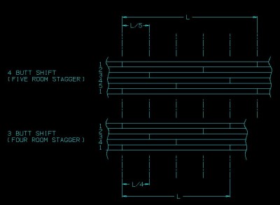

I know it takes a lot of work to get the planking patterns worked into the model (been there, earned the headache). However I have one suggestion that would take this from "stellar" to "knockout". If the plank butts aren't already set in stone, you may want to consider doing a five room stagger or a four room stagger.
Every shipyard had a different standard OP when it came to these, however, I've noticed that the Bismark decks were originally laid with the "three butt" (four room stagger)system. I.E. the plank butts matched every four planks. Most US ships had this originally as well, although it can be hard to find on the museum ships now, as the planks have been replaced so may times.
If you look closely at the deck I did for Nautilus, you can see the five room (four plank but) stagger, mirrored over the centerline. One of the renders in the tenth or so post down in that thread shows it well. I've attached a quick reference sketch I worked up.
Again, as is, this looks to be an awesome kit! looking forward to seeing the rest of it!

For Montana, I'd go by a contemporary like New Jersey. If you go to the Navsource page for her, then to the 1944 page: scroll down to
Japanese prisoners of war are bathed, clipped, "deloused," and issued GI clothing as soon as they are taken aboard the New Jersey (BB-62), December 1944.
This photo shows the plank butts on her original deck matching every fourth row, so the second pattern in the sketch would be appropriate.
For the H-class, again going by a contemporary like Bismark: looking at "Battleship Bismark" by Elfrath and Herzog, Looking at pages 41 and 43, shows the plank butts matching every five planks. So for her, I'd go with the first pattern on the sketch.
