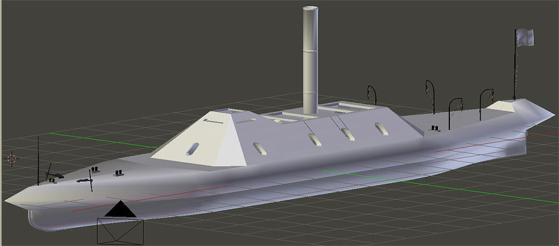

I'm starting a thread on this one as it should be a fairly substantial build. I'm probably going to do a casement interior.
Got some gunports on the fore and aft now. I'm going to do a lot of mesh segmenting to break up the casement and hull for easier application of smoothgroups. Right now the basic hull looks 'done' but that is probably a tad deceiving as I've got to engineer the interior of the casement and pilothouse and get it to all blend seamlessly into the hull yet :D

Ooh, that's looking good! This ought to be another great model, I definitely will be watching this. :yeah:

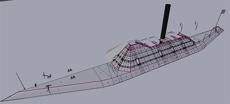

I've put this together for Dean, as it shows some of how I've approached putting the hull together. It's awkward in that the sides have to be be curved and the sides have to be very flat and that can cause problems with normals. So I've wound up applying a sub-surf modifier and now I've creased the major edges to keep them 'square'.
Here's a shot.
The area in front of the casement is still messy (nobody will notice that triangle, especially when it gets turned into a quad when the mirror modifier is applied :whistle: )
Once I've got this bit done, I can start thinking about the casement interior!
Well, thank you. :thumbs_up_1:
Pics with simple explanations like that are extremely helpful, especially so because I actually know what your talking about now. :big_grin:
Since you plan on doing the interior (with cutaway?), would it be easier keeping the casement sharp (and less problems with the cutaway) if it was separate from the hull? Just wondering.

That would be the case, but when you apply the sub-surf to one part of the mesh, it distorts it slightly to get the 'curve'. It basically plots a smooth curve between the normal vertices of your mesh. Unfortuately, when it does that, it leaves gaps between the smoothed mesh and the non-smoothed mesh. In certain instances you can get away with it if you build it in a certain way, but I went for speed and just creased what I needed.
I did try to separate the casement, but I got breaks between the curve of the sides of the hull and the casement.
One thing I've forgotten to add in the last pic is that I've dropped a lot of 'control lines' in on the lateral lines of the hull to get a nice sharp line between the deck and the sides.

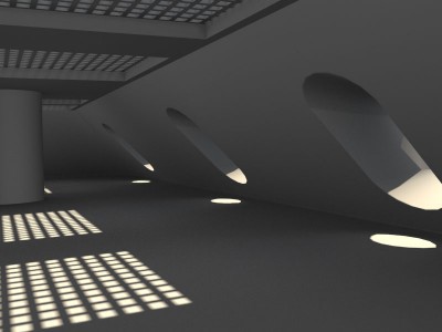

We have a gun deck :D
Owen

Very cool!!! I bet those grate vents were fun to make. :big_grin:
What reference are you using to base the interior on?

Actually. The grate wasn't too bad. I just created a beam, arrayed it, then duped and rotated and then booleaned. Saying that, the mesh is a tad messy, so I think I'm going to create a 'cell' and just array it in two directions.
The real pig was the gunports. I had no joy with the snap feature, so I had to dupe the gunport mesh from the outside and shrinkwrap it to the interior casement (after a bit of scale up). Then I used the bridge tool to 'fill in the blanks'.

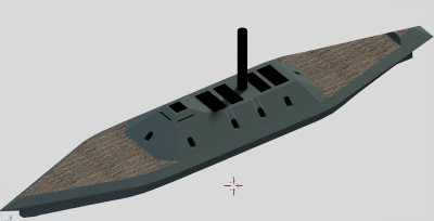

Got some progress here.
I've done some deck detailing. It's still all WIP, but it's moving along.
Owen

Looking good! :thumbs_up_1:
I'm curious, are you planning on using a bevel modifier to break up the sharp edges, or do it manually? Or just leave them sharp and let the textures take care of it? The reason I ask is I have a similar situation with the Palmetto State, where I just added a radius to the sharp edges. Granted, I'm modeling it in SolidWorks and not Blender, but I'd still like to know how you plan on doing it for future reference.

I may use the bevel modifier. Blender's modelling tools are very much in flux at the moment. To be honest, they are making a new Open movie, and everyone has been pulled off modelling tools to work on that. So they have their new mesh system in place, and some new tools for it, but the tool chest has quite a few gaps yet. I'll have to try it and see how it goes.
The textures are going to be interesting. I've assumed till now that I'm going to be just applying a bump to get it looking good for the iron plates, but the more I think about it, the more I'm thinking that actually arraying some plates along the side may be actually less work, and look better, than trying to get all the different UV sets for the different sides of the casement to match up together. Again, it's going to take some tests to see what works best.
