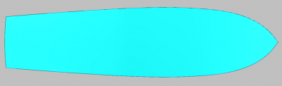

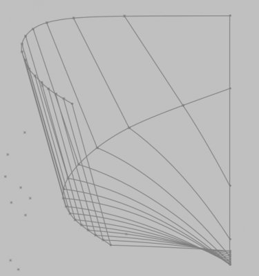

some screenshots

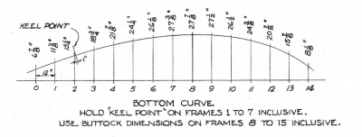

yea i been sorting through them there are abt 4 different vessels in that collection

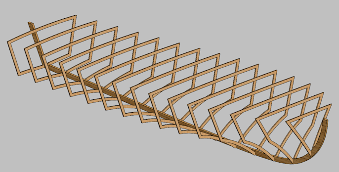

right now I am just trying to figure out the transom set up. I re lofted the hull as i was doing it backwards was why i had several different short lofts. then once i get the transom finished I need to see if I can find how the keel and frames were built
PostPosted: Mon Nov 28, 2016 3:44 am
Joined: Fri Nov 12, 2010 3:19 pm
Posts: 213
Location: Moline Illinois

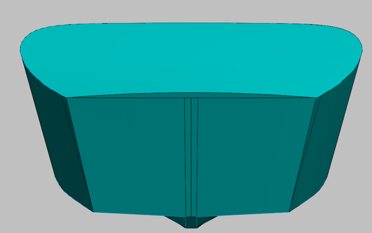

Ok got the transom set and the top deck so now I have a completed shell for all my stations. need to try and find info on how the keel was fabricated and that the station bulkheads looked like. I am guessing Higgins kept most of his boats very similar for cost control and efficiency. if that was the case it would be lamination of oak and mahogany for the bulkhead stations.

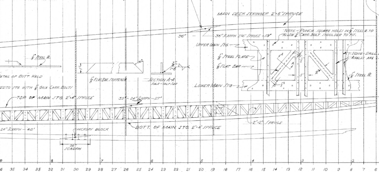

Ok guys I dont get what this drawing is or what it means. it is on the same sheet as the layouts and the offsets. can someone fill me in?

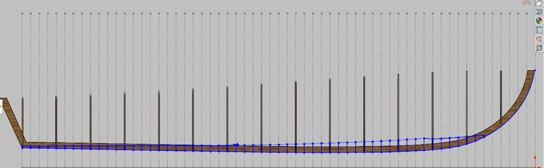

Ok have the stringer sheet need to try and figure out what everything means next

Ok a Closeup of the table box saying what they are. i still dont understand what they talking about but did the Bottom Wing First and it looks like the Bottom part of the drawing

drew bottom edge of main stringer (above keel) used bottom of keel now rereading it it should be top of keel however I still dont know how tall the keel should be

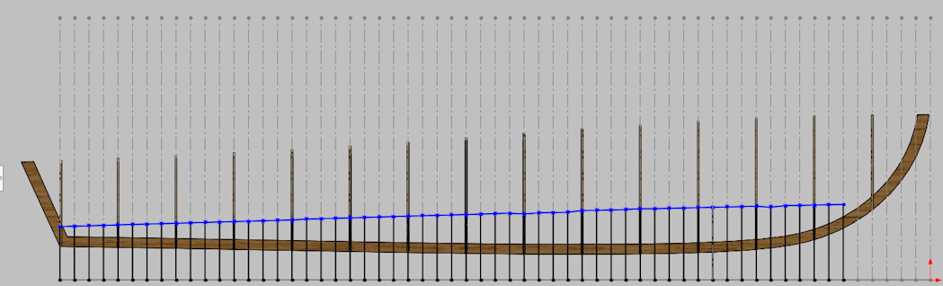

Drew Top edge of main stringer (above Base)
still not sure what for but will get them drawn first then sort through the other drawings see if they show something

PostPosted: Tue Nov 29, 2016 1:09 am
Posts: 1677
Joe,
"LL" means long length. Longer than stock lengths.
"Bottom Plating" is that part of the shell plating that is below the water line. The immersed plating from bilge to bilge. "Bilge" is the rounded portion of a vessel's shell which connects the bottom with side.
I would guess the "bottom curve" is the curvature of the hull bottom plating from keel to knuckle, from frames 1 to 7. Aft of that the buttock lines set the curvature.
A "stringer" is a fore and aft girder running along the side of the ship. It makes up the framing of the ship along with the vertical frames. Hull plating is attached to this framing.
The "bottom stringer" rests on the top of the keel. The top of it is straight and probably supported the lowest deck.
A "wing" is the outboard part of a ship. Looks like the "wing stringer" was at the knuckle between the bottom and sides of the boat.
I came across an invaluable little book years ago at a used book store - "Ship Structure and Blueprint Reading" by H. L. Heed, printed by the Cornell Maritime Press, New York 1942, 258 pages.
The inner dust cover says "This book is written for the sole purpose of teaching the men who are building the ships to read the prints."
It has chapters describing the parts of ships and how they are drawn in blueprints, a list of abbreviations, and a glossary. It looks like it was the draftsman's bible for ship building in the 1940s. It is small enough (5 1/4" x 7 1/2") to be carried in a large coat pocket.
On many occasions it has helped me to decipher the hieroglyphics embedded in ships blueprints. I keep it on my work desk.
No, I won't consider selling it!

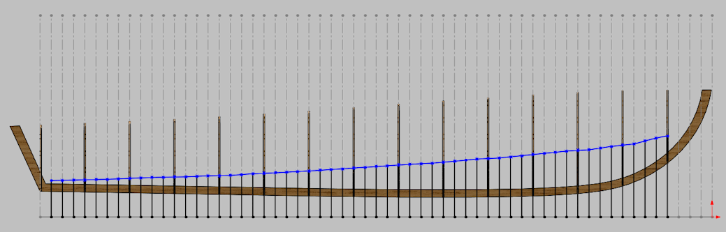

ok off tomorrow so going to work more. tonight I drew the Bottom edge of Inter Stringer
looking at the sheets in more detail at work today I have somewhat of an idea where they all go
