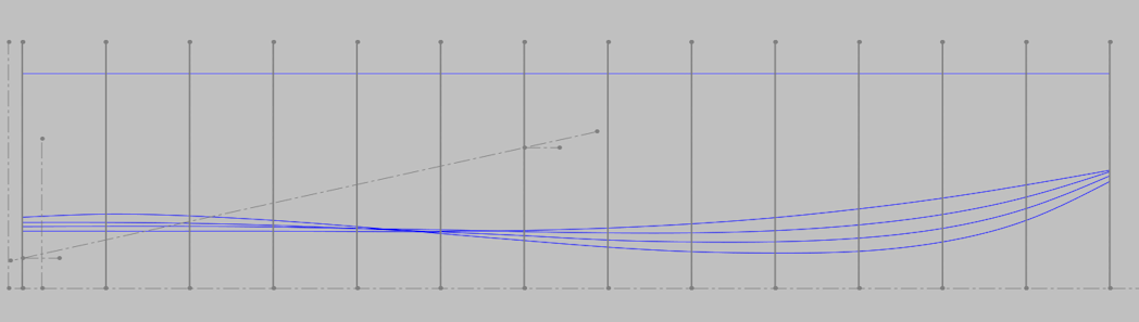

PostPosted: Mon Nov 21, 2016 3:53 am
Joined: Fri Nov 12, 2010 3:19 pm
Posts: 213
Location: Moline Illinois

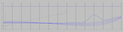

Ok got the chine and sheer curves up they look good top down however the chine has a lump in it I need to double check some figures

PostPosted: Mon Nov 21, 2016 4:06 am
Posts: 213
Ok seems was an easy fix. station 4 was off by 20". even though all the offsets were correct according to the documents they were in fact wrong

I have never seen a Table of Offsets that did not have errors. The numbers were calculated by someone with an adding machine and recorded by hand. These lists of numbers were compiled into the Table of Offsets in the drawing by hand by a draftsman. Lots of numbers and plenty of chances to transpose numbers and for other mistakes. Especially with large ships where there are thousands of numbers.
But when you run them trough a CAD program the errors are obvious. Normally they are either a mistake in the feet, or inches, or eighths. So the erroneous point will be out of place by X feet, Y inches, or Z eighths. In one case I found an error for one value in both the feet and inches. Had to scratch my head a minute or two on that one.

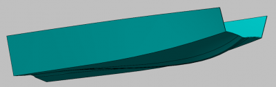

PostPosted: Wed Nov 23, 2016 9:41 pm
Posts: 213
Ok tonight I got the main Hull Lofted and thickened. it turned out really good and smooth. now the PIA will be setting up the transom guides
